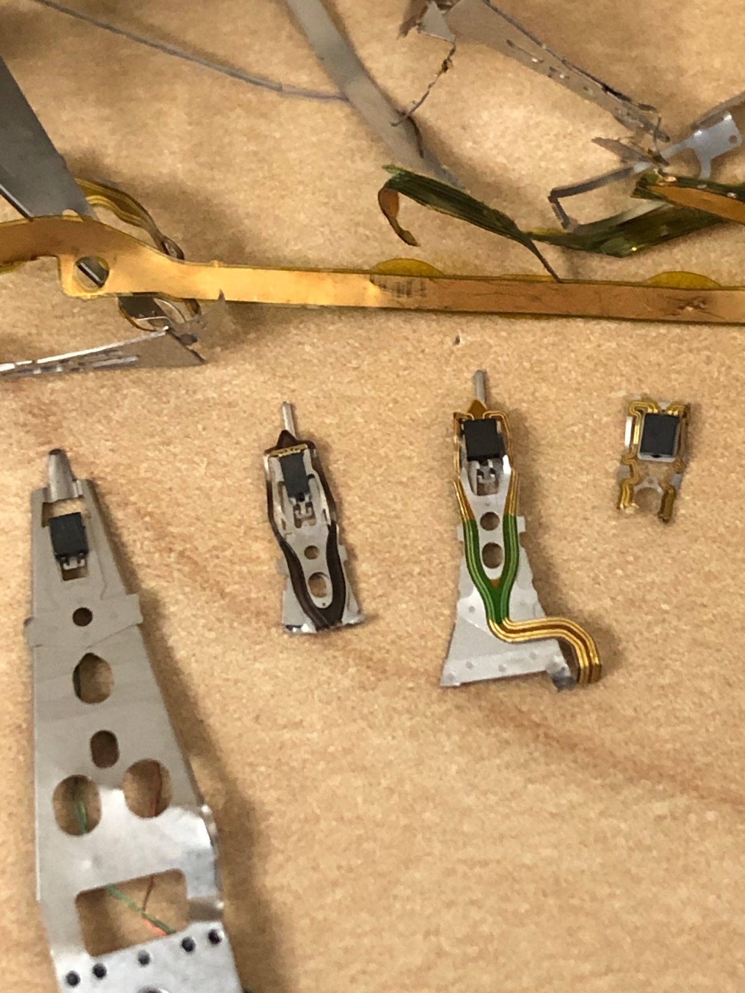

Lost,
I too have a good amount of hard drive actuators that i pulled the tips, wire, and little control boards. My question is must you pull the little square head off the metal or can you simply snip the end of the reader head with metal attached?
And you mentioned the boards, are you referring to the small boards mounted to the side of the actuator arm?
I attached a photo to show you what i mean, is the one on the far right acceptable or must it be removed from the metal? Thanks Lost!
PostPosted: Fri Jul 24, 2020 1:16 pm
Posts: 10616
mjm316 wrote:
If you are sniping for rhodium there not much of a loss in just snipping the metal end while. I found my current buyer only “fees” on it about 6%. Just minimise the extra metal to stay in recovery vs breakage.

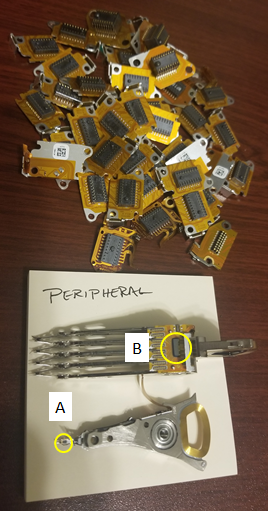

Two questions for clarification that was discussed in this thread.
1) This pile up top is considered peripheral? Yes?
2) Ok... where is this Rhodium that everyone is mentioning? I'm assuming is the A circle, but no idea what the B circle is.
PostPosted: Wed Nov 11, 2020 3:27 pm
Posts: 10616
1 yes
2 on the right track.
Inside the outer shell is a small magnetic bead that contains a piece of rhodium.
The head itself is tiny and the rhodium bead even tinier. But... at $15000 high and 8000 avg today, clean, it doesn’t take much to get a refinery interested.
I’m personally pulling the neodymium magnets and permalloy from drives which requires me to pull out the arm anyway.
So I use a pair of super scissors to snip the arm ends into empty pill bottles.
You need a LOT of drives to reach an ounce pure. But for anyone already refining at home or those selling scrap jewellery there’s no reason to /not/ spend 10 seconds cutting arm heads off.
I tried to make the two important issues clear. This is THE most expensive thing in escrap. This is NOT going to make you rich.
Read head trimmings are running around $600 per pound (commercial bulk) which should help you understand just how much you need to make money.
