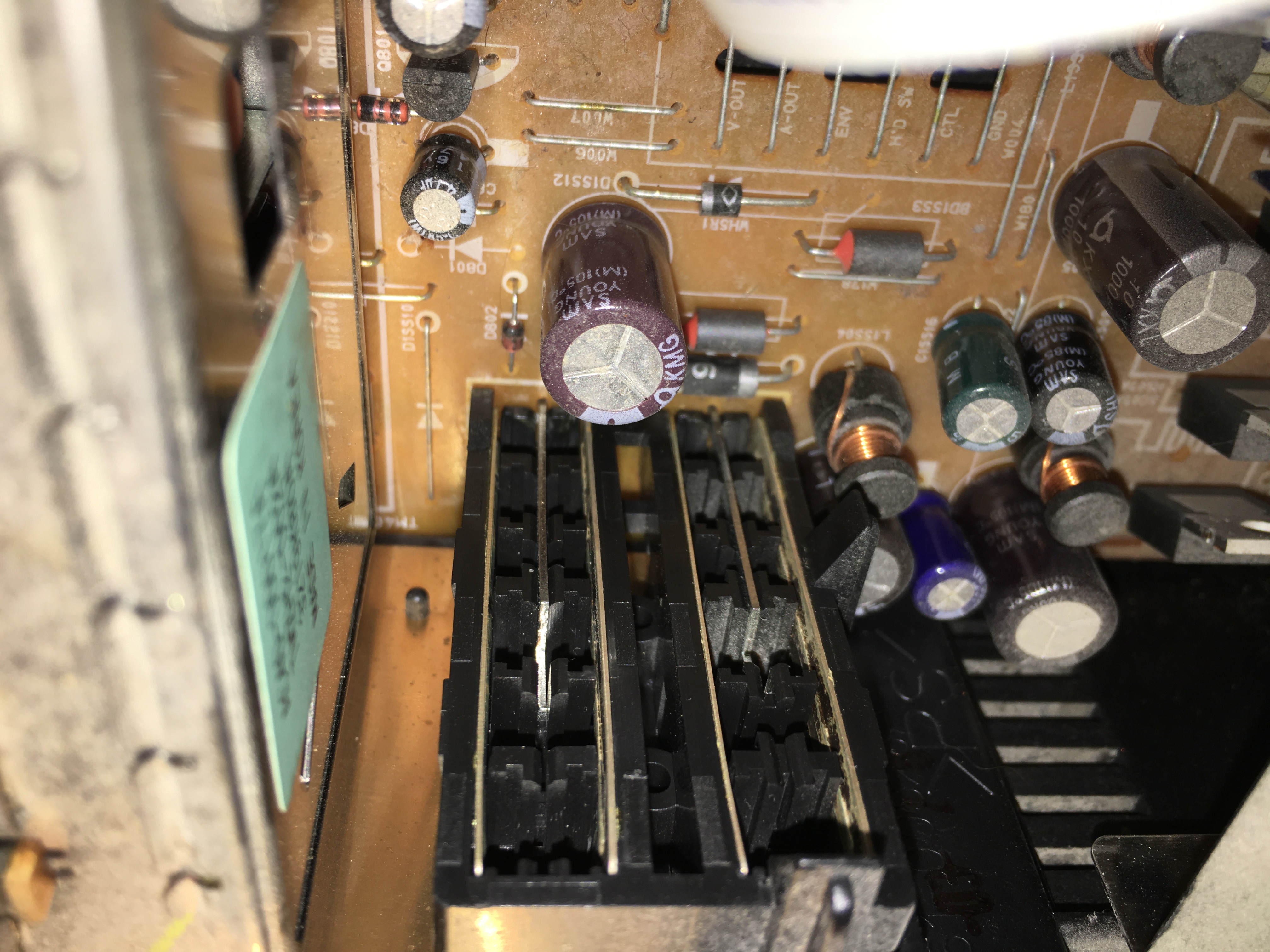

I popped the lid but can’t for the life of me figure out how to pull the board out without breaking something. So as-is this is all I can see of the jack
 Post subject: Re: Dvd player
PostPosted: Fri Dec 13, 2019 9:09 pm
Posts: 10618
Oh joy. Looks like a compact unit. Not an easy fix.
I’ve scraped these before but rods and rails are not something I ever got to work. The io panel has pressure snaps; one you can see in the photo. Which will let the rear. Just pull the snap loose gently and pull the panel away. Move on to the next snap and the next part of the panel. Etc
The board is screwed into the base. Usually four externally and 4-6 internally. You’ll need to remove the disc reader to remove the board safely.

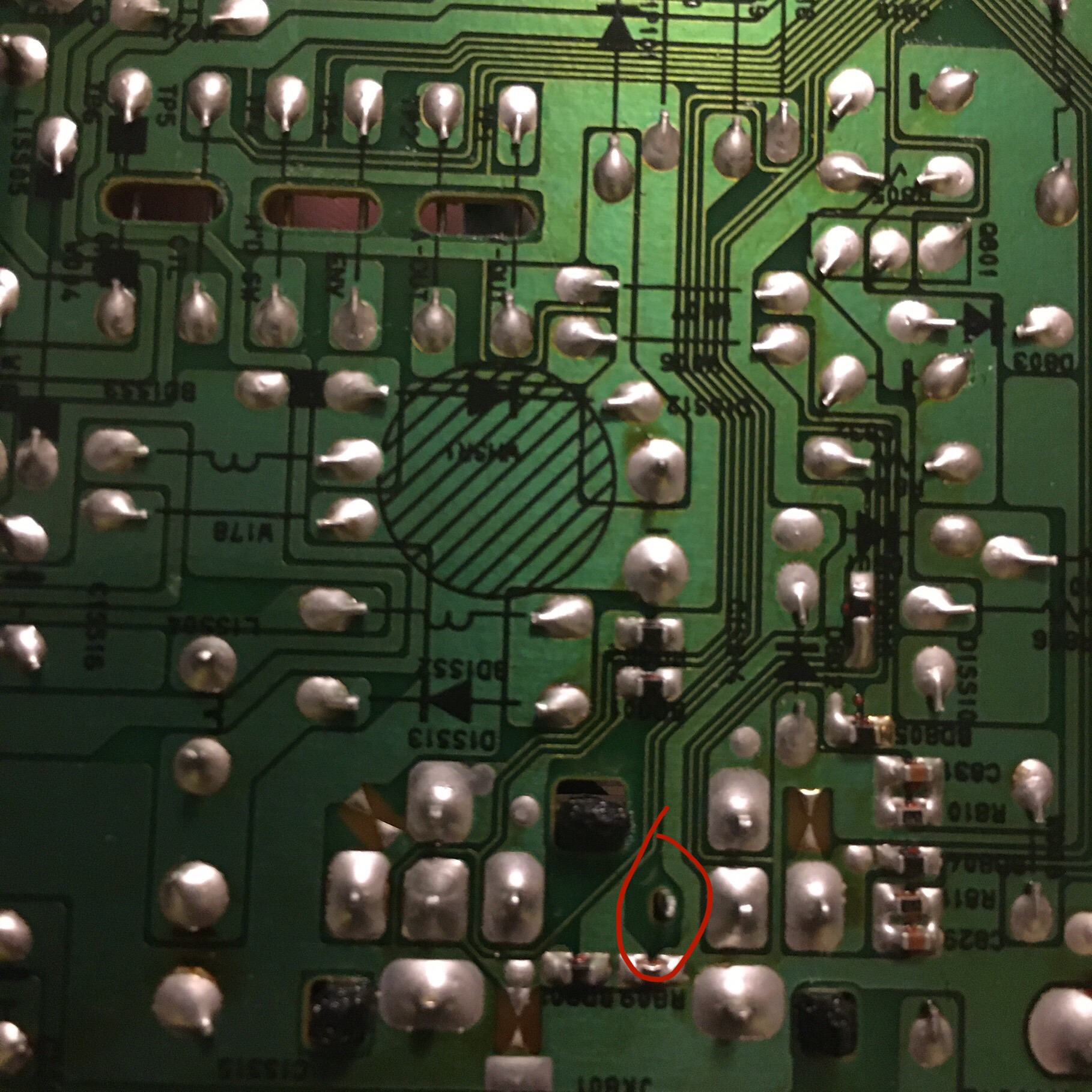

Finally got the stupid thing broken down and only broken one mostly insignificant plastic peg in the process lol
I know nothing about how electronics work but here’s the reverse side under the jack component. I noticed one leg isn’t soldered...meaningful or nah?
PostPosted: Sat Dec 14, 2019 1:08 am
Posts: 10618
I don’t immediately see anything but that’s just visual.
The one that’s not soldered doesn’t need to be, it’s a support pin. Though they are usually bent over or twisted to add strength.
I don’t do well this this compact design. I tend to break as much as I fix and they turn into drawn out projects I often ultimately give up on anyway
Unless it’s a high end upconverter or a dvd-r/dvd-rw I wouldn’t put the effort in. You may get $50 with shipping. $100 at most. If you want to play around with it for fun and maybe get it running have at it.
I bring it to a repair shop friend of mine to fix the DVD burners since they flip for well over $150. Which makes the discounted $50 charge worth it.
My guess is still on a loose solder joint just from long term experience. If it fires up and everything else appears to work that’s a very common issue.

Ok. That unsoldered support pin happens to also be on the side with issues.

Op said the video jack was the only one not working.
The problem with this design is the ports are all put into a widget (I know) thing first. Then placed into position and soldered by machines.
Purely from my own experience the whole output piece is going to be $10-$15, pre retail price on the low end. High quality ones can shelf price at $50 or more.
My personal issue with these is they are very inconsistent.
The one pictured was obviously a faulty build from day one that may or may not have worked for any time. The analogue output gaggle (is that right?) has 3, 4, or 6 support pins under the board. In a high quality build the pins will be twisted then soldered. In lower quality builds they just twist the pins. Here it doesn’t look to even be properly twisted.
Without the proper mounting insertion and removal of cables is putting pressure directly on every pin of the whole unit. There’s movement in the whole box. Add inexpensive $1.99 gas station etc cables to the mix, which tend to be too big by a few um, and you make the force that much worse.
If that’s the only (most common) issue The reflow method I described above will reset the solder enough to reconstitute a connection
My issue is I tend to have trouble getting the entire thing properly removed. I don’t have the right wick for these. So some force is necessary on my part and I often cause fractures in the through holes.
