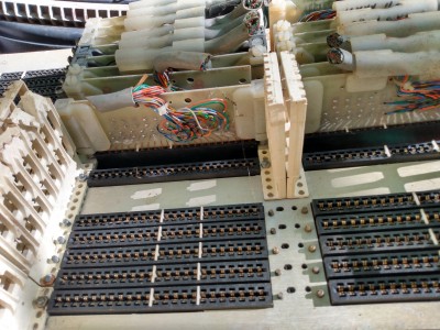

Back in the late 80's I bought a couple pickup truck loads of vintage telephone switching stuff. Included were these wired card slots, screwed onto an aluminum cut-out frame. Nothing complicated: plastic slots with pins for receiving a simple card, well spaced apart gold fingers on a card with solder traces connecting finger to solder point for the telephone cable wires. Card holders appear to be nylon: impossible to beat them loose without removing the nylon screw. The unit as show weighs about twenty five pounds, and is roughly twenty inches square.

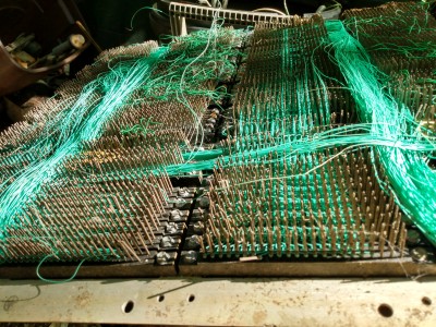

There is some gold flash on the connectors where the cards gold finger contact it. The overall pin itself is about two and a half inches, wire wrapped on the back, is oxidized to a light hazelnut brown, and appears to be a white metal, rather stiff, but breakable with about six deep bends. Non-magnetic.
Early next week, I intend to take some of the pins to my local yard for RFA?, shoot them with the gun, to determine composition.
Basically, what I have after removing the cards from the slots, is connector ends mounted on an aluminum frame. Wiring on back wire wrapped pins appears to be tinned or silvered copper (dark oxidation on bare wire, silvery soft moon like on fresh stripped)
Question apparent is do I need to remove the "connector ends" from the aluminum frame. Of course, the back wiring and cards and nylon supports must be removed. No board at all in this setup.

Thanks Lost, but you missed the point that there is no "board." Just a bunch of sockets hanging on a metal cutout frame. Pins while large have only a minimum of gold flash at the contact points where the cards insert. I will post some comparisons of socket plastic weight vs removed pin weight on a couple sockets and show closeups of the cards and closeup photo of the pins.

UPDATE. Aluminum cutout frame, to which are fastened card slot sockets, with heavy pins protruding from the back of the sockets with wire wrap.
I delivered to Boardsort last Friday, and at the last minute threw on one of these twenty pound units to cover the top of a box of smaller boards, to keep them from flying off in Mid Kentucky. Decided to take it and ask specifically what it would classify as, and if it would benefit from stripping, parting out, or further processing.
The particular unit I grabbed was trooublesome as it did not have gold plating on the pins, but a weird not silver/not copper/not aluminum/not what I don't know, a weird brownish oxidation/ on the pins.
Turns out "boards" don't always have to be seven layer fiberglass. In this case, just a large array of many components viewed as "one board".
The one I took was given a "non published class" rating as palladium wirewrap board" which brought a smile to my face, as the total payout on this one item was over a Hundred dollars, when I had resigned my self to maybe getting connector ends price. The bad news for my payday is that I had four more identical boards at home. The good news is I have four more boards weighing total 80 pounds ready for my next load...Oh, and when I walked in the door back home, found the latest MB box I had just finished for this trip sitting there, along with the GF cards and memory sticks...

The board shown in the thread will probably go as gold wirewrap pinboard since all the pins of this one is gold plated, unlike the "non-gold" one I sold.
