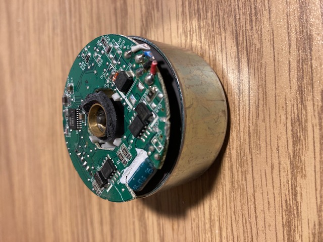

I understand that Boardsort requires than fans be "completely removed from the fan assembly. Motor only." Does that require that the steel housing that several of the PC fans reside in. If that's the case, are there suggestions about how this is best done?
 Post subject: Re: Fan Assembly
PostPosted: Sat Jan 22, 2022 6:01 pm
Posts: 10554
I believe that’s not the standard motor but a floating motor.
Personally that’s where I’d stop and send as a motor.

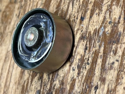

Under the board the centre post is attached to a star spindle wrapped in copper spools. Which sits inside a magnet glued to the steel shell.
Since all the pieces make up the motor I’d say motor as is.

I'm not sure if rvanover posted about fans before or if it was someone else, may be repeating myself...anyways...
Inside the center you have a post/drive pin/whatever you want to call it that will have some sort of clamp to secure it and the bearings. If you can get that clamp off (may be difficult depending on the construction) you can get the bearings, plastic, brass, motor windings and circuit board apart from each other fairly easily. I will do this when I get a dozen or more fans that I can do all at once. The brass can add up pretty quick and is probably the main reason I take the time to do it.
