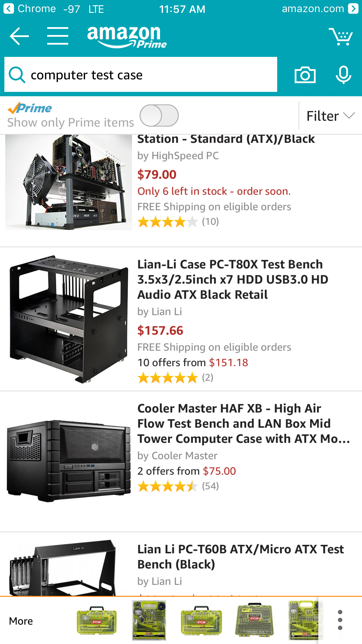

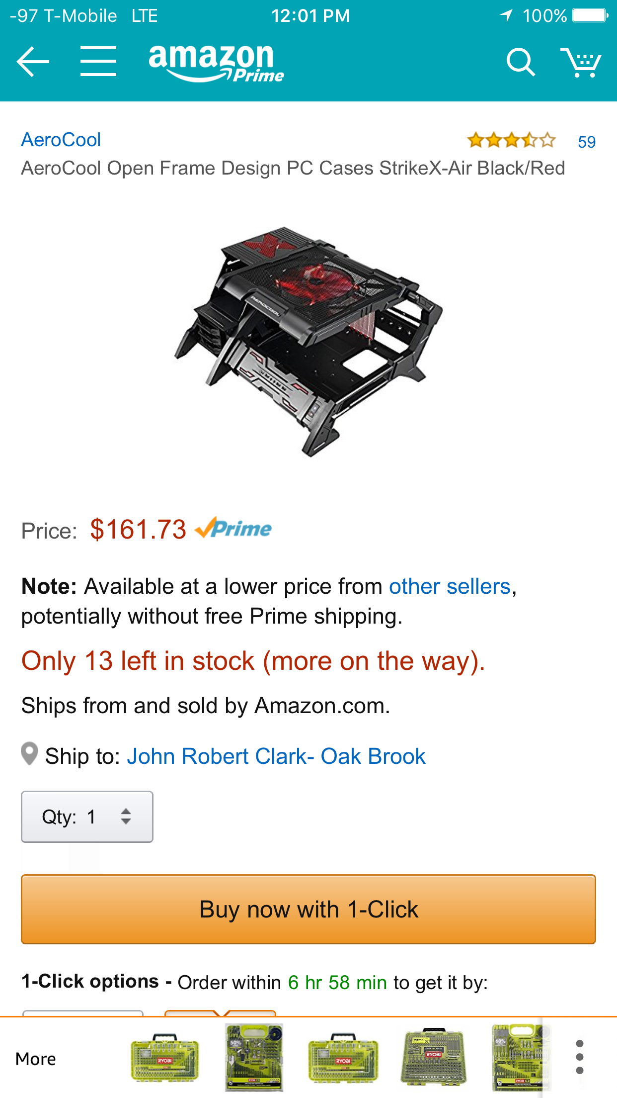

I'll hit addin boards and motherboards today.
Things begin to get more convoluted here so you'll definitely want to buy, or as I did, make, one of these from the photo
I made my own based on the first photo by buying a bunch of server cases from a local scrap yard, cutting the parts lose, some minor cleanup and light welding and I had my own. My first one though was the first photo, which I cloned when I made my own.
A loose open design like this makes swapping out parts a breeze!
You'll also want an antistatic dust cover.
