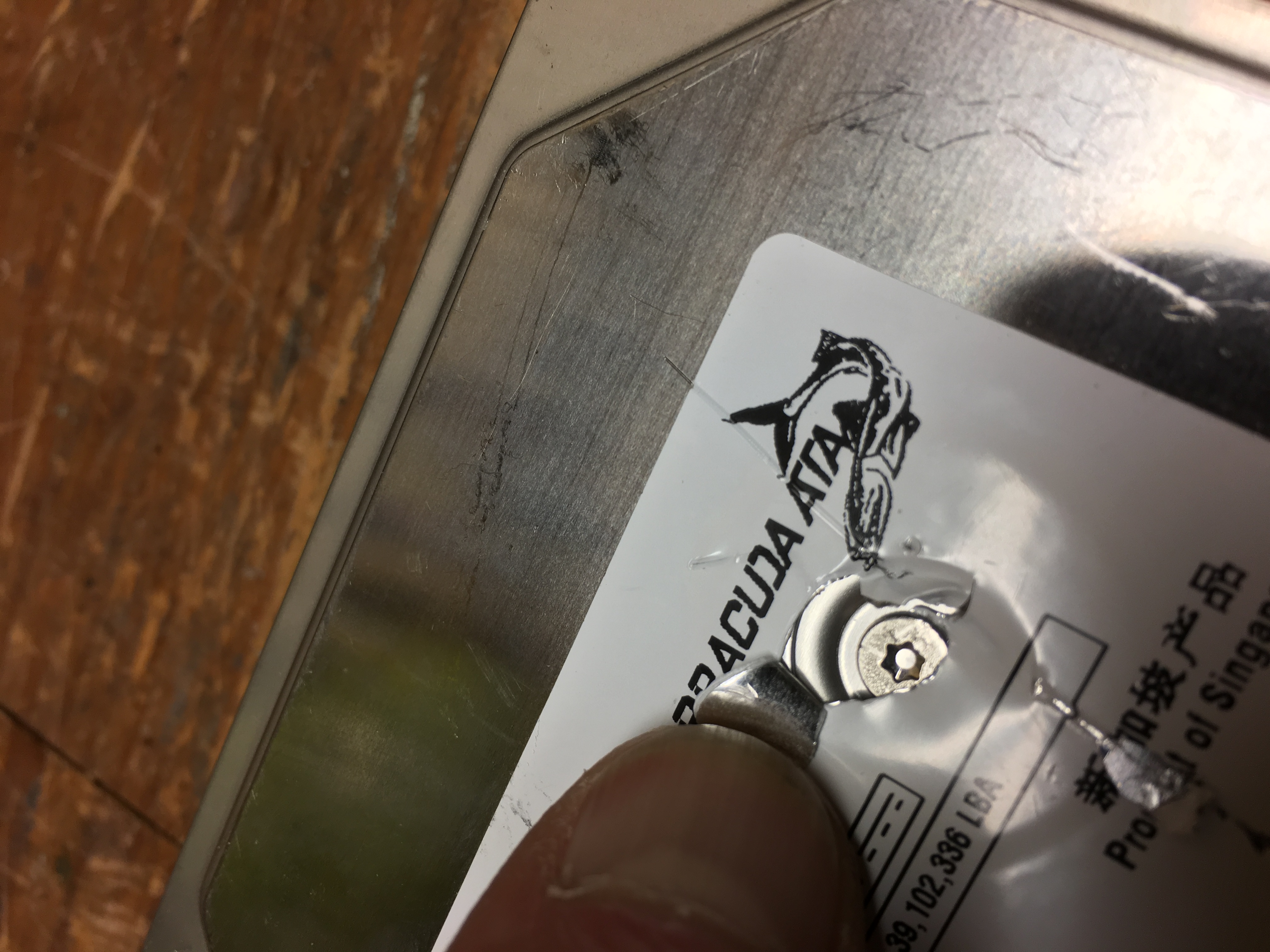

2: Continue using the precision screwdriver set to remove all the screws holding the top cover of the drive on. There is at least one screw that is hidden under the drive label. Use the screwdriver to poke around the label until you find any round holes that may be covering up screws. Remove any hidden screws that you find.

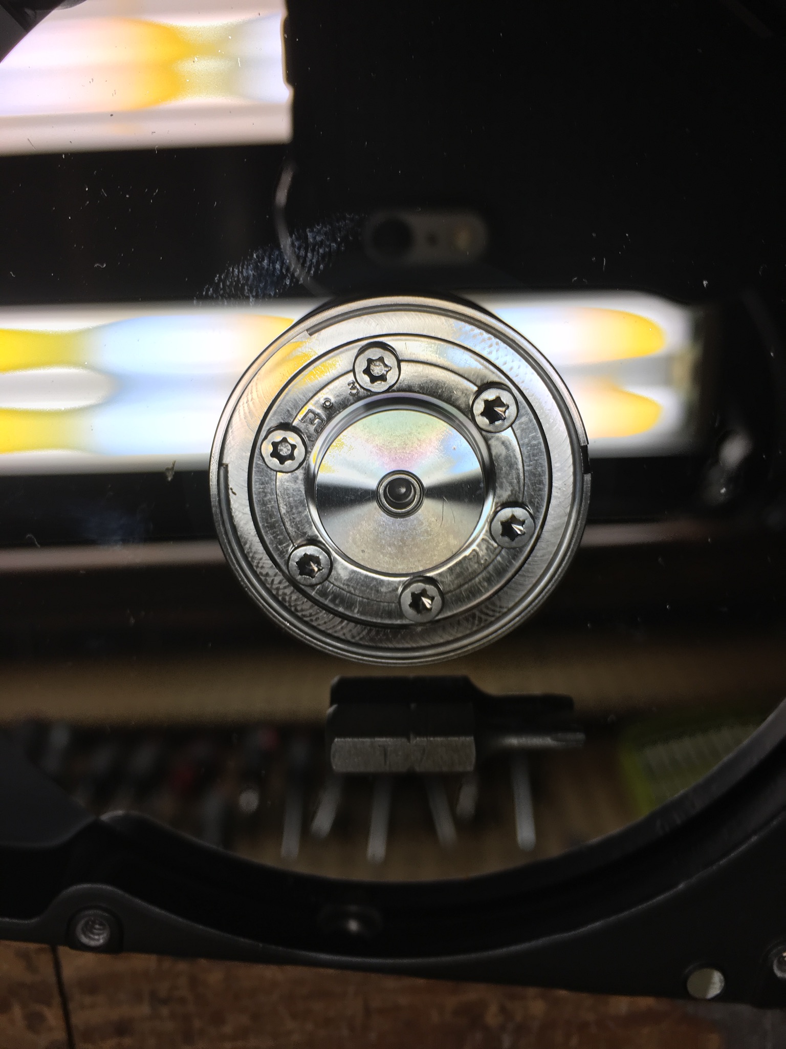

I pulled apart and photographed a seagate drive to add to this.
[I give you permission to do so. The goal here is to educate your average scrapper on proper methods of destroying drives in a secure manner so no sensitive data is compromised.]

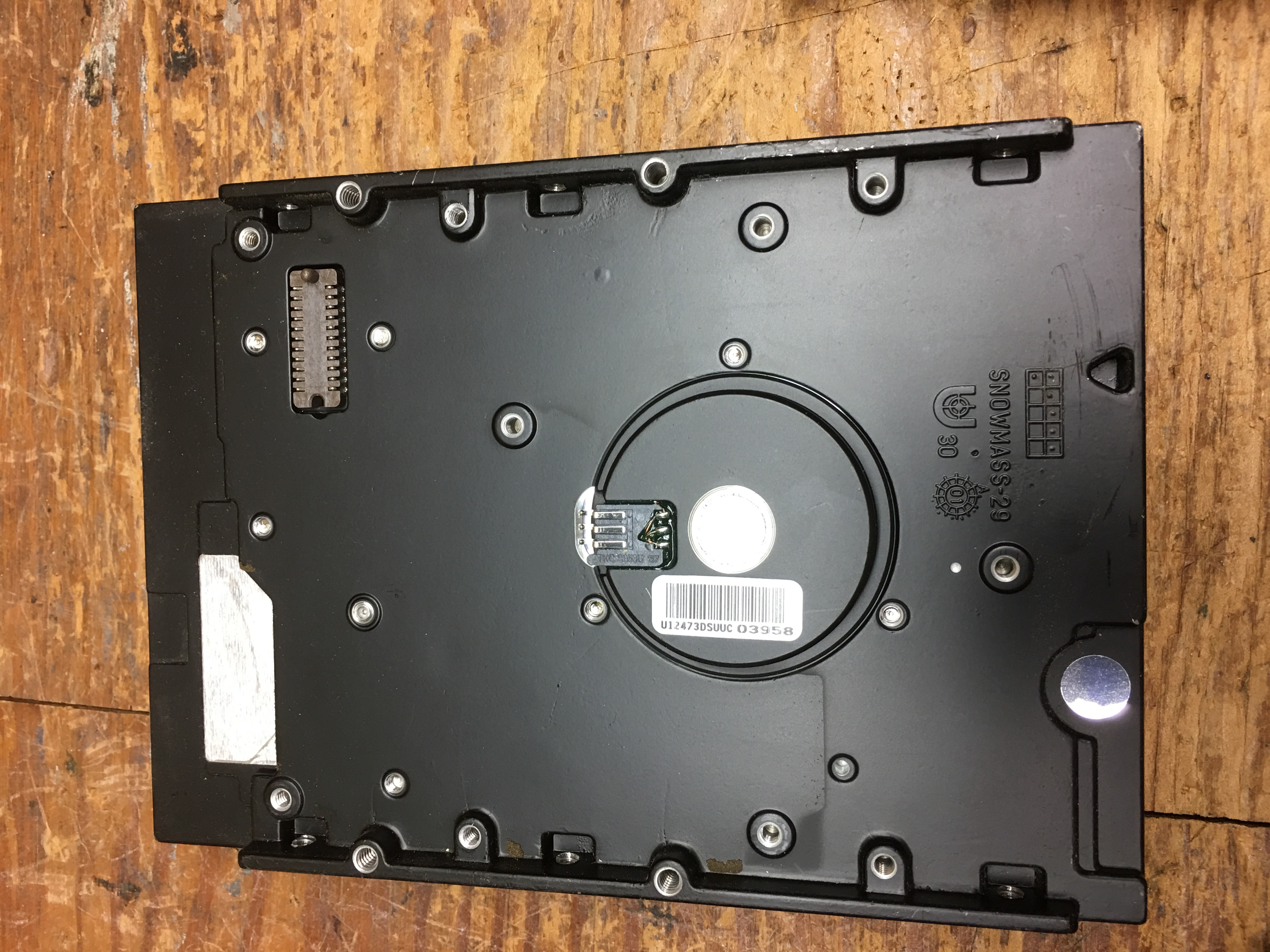

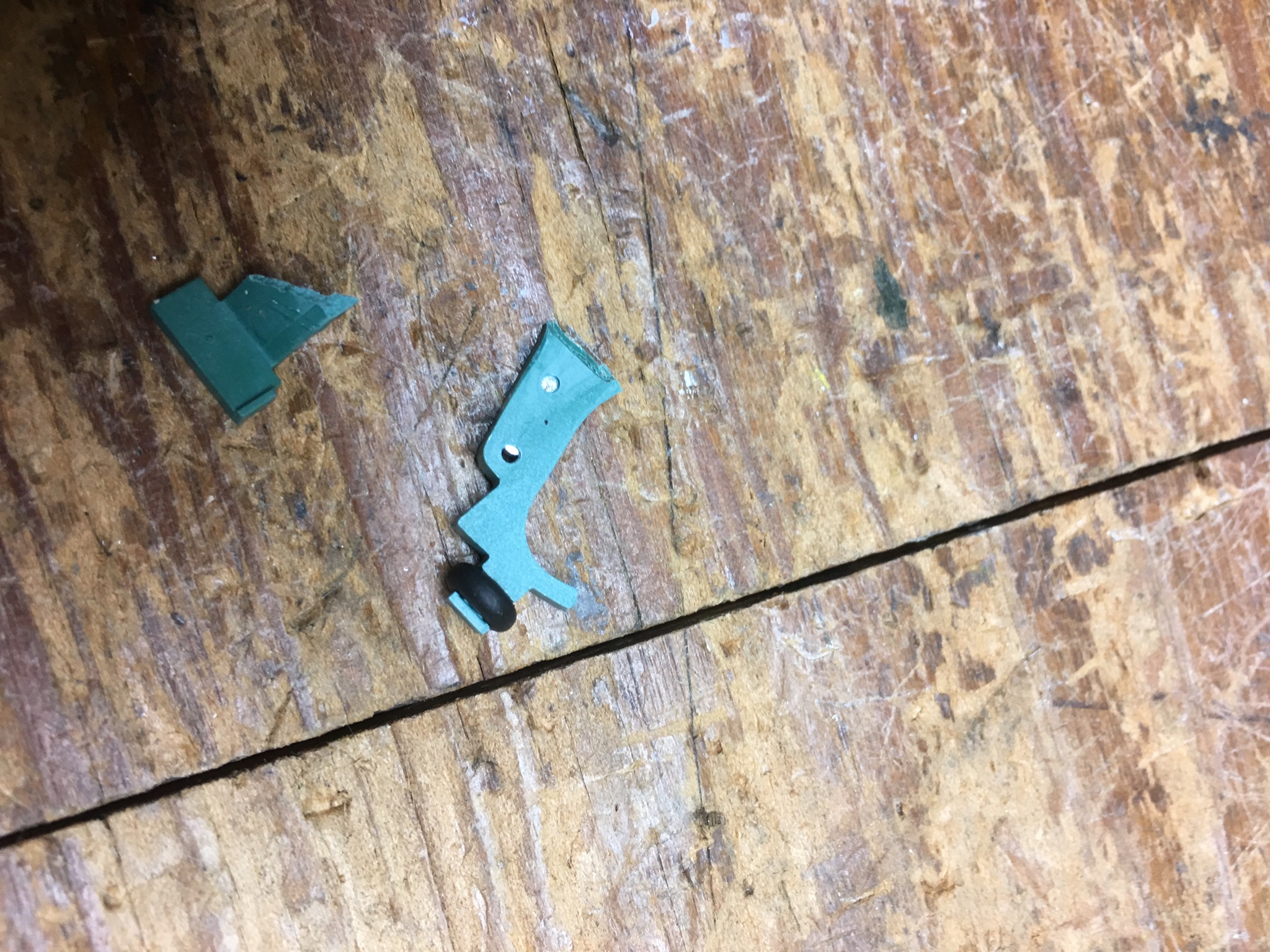

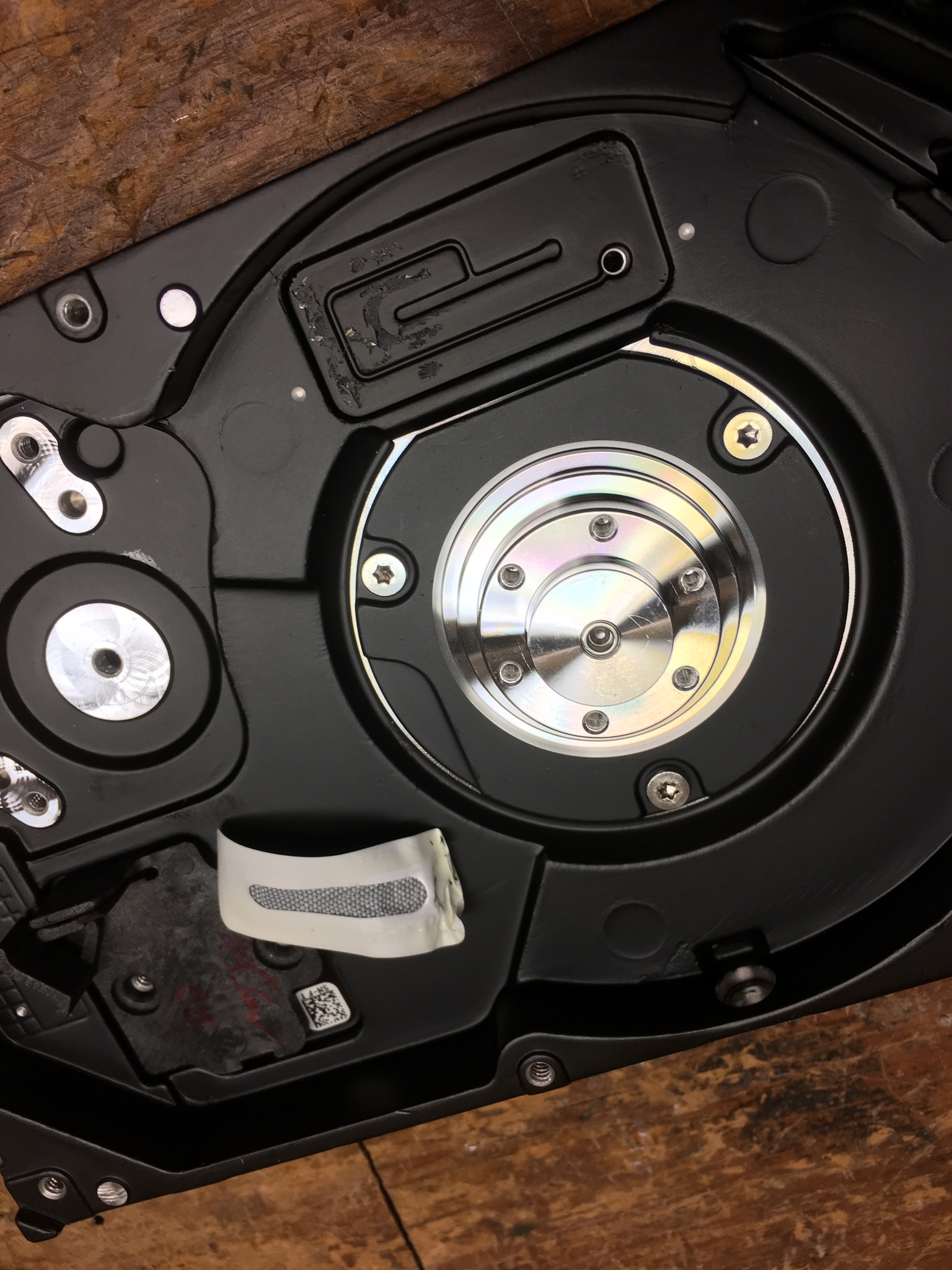

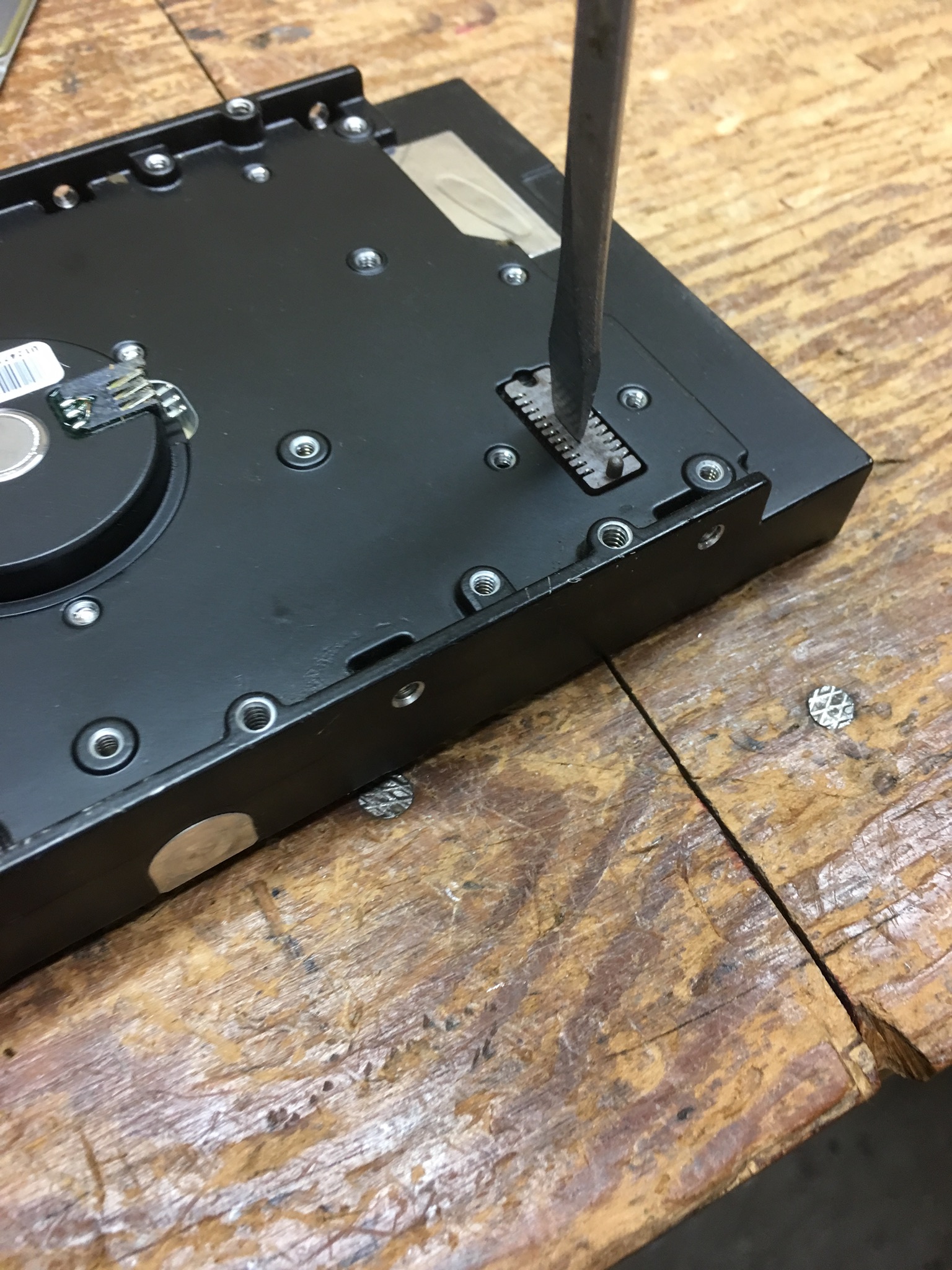

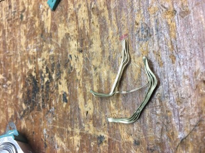

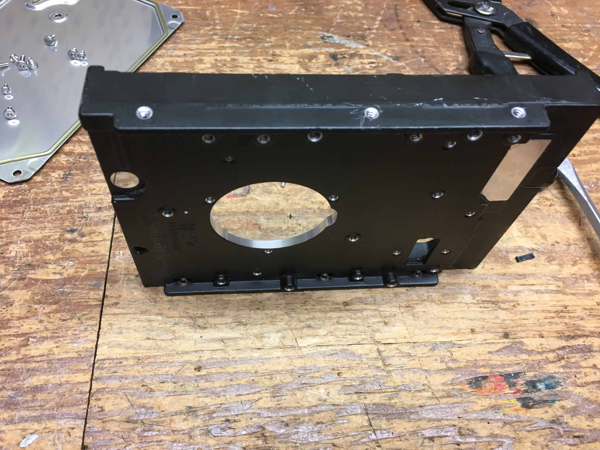

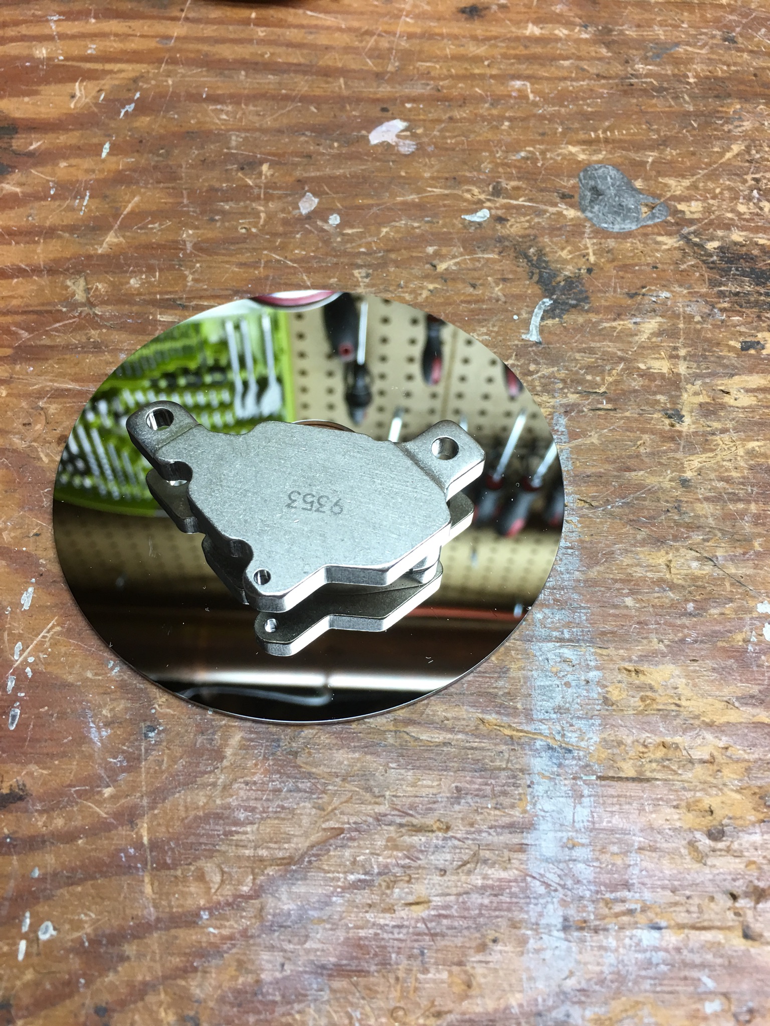

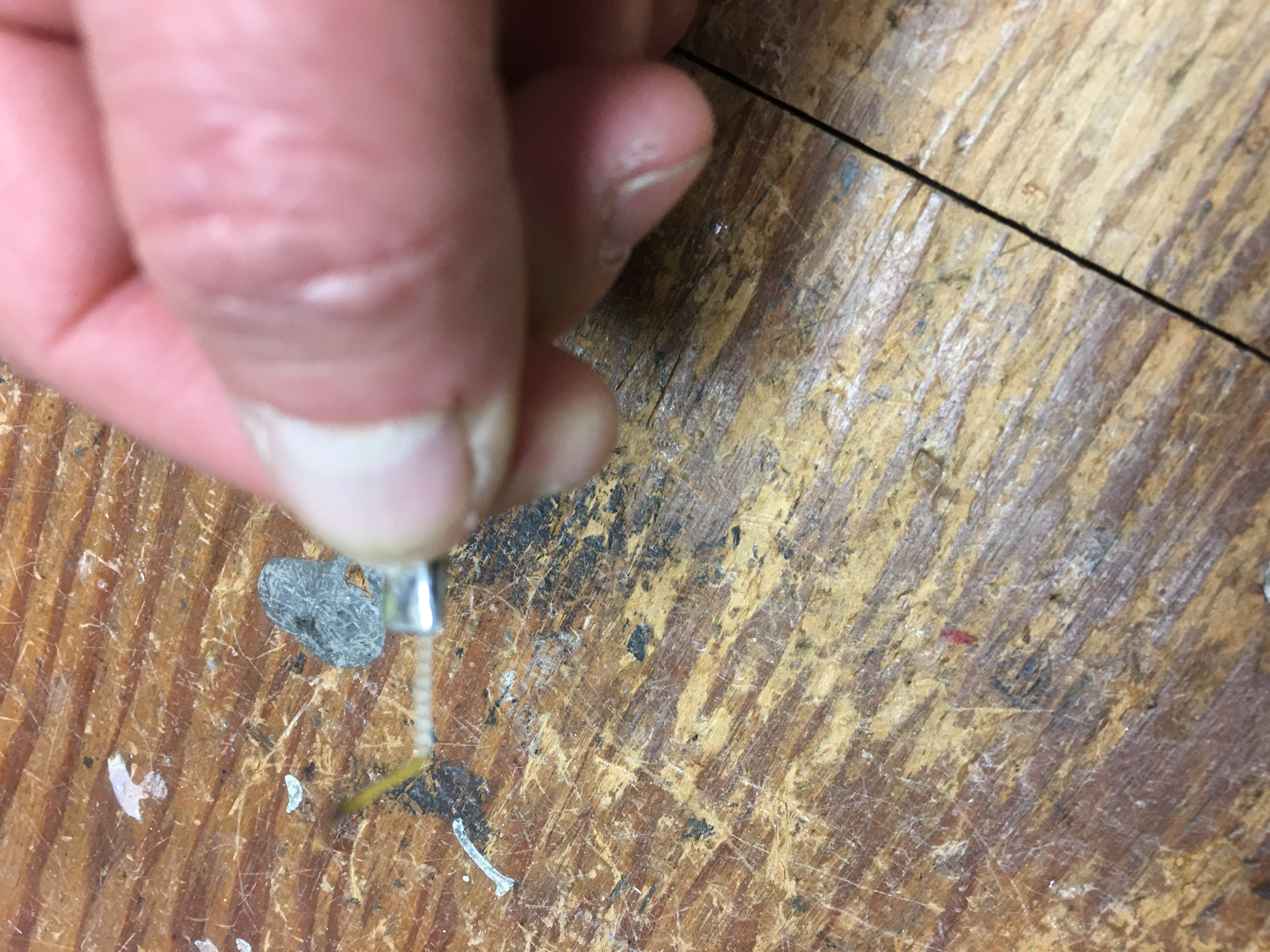

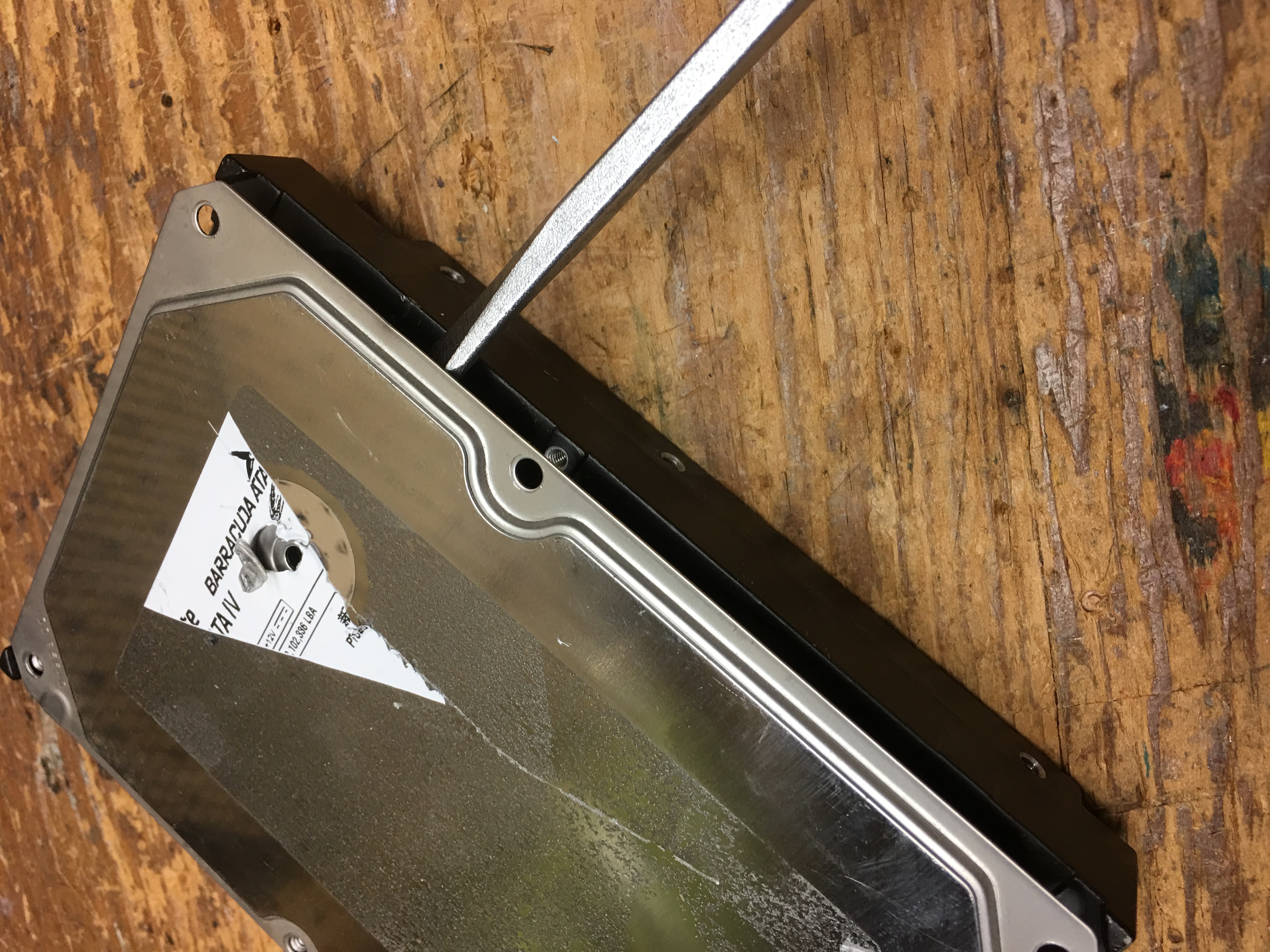

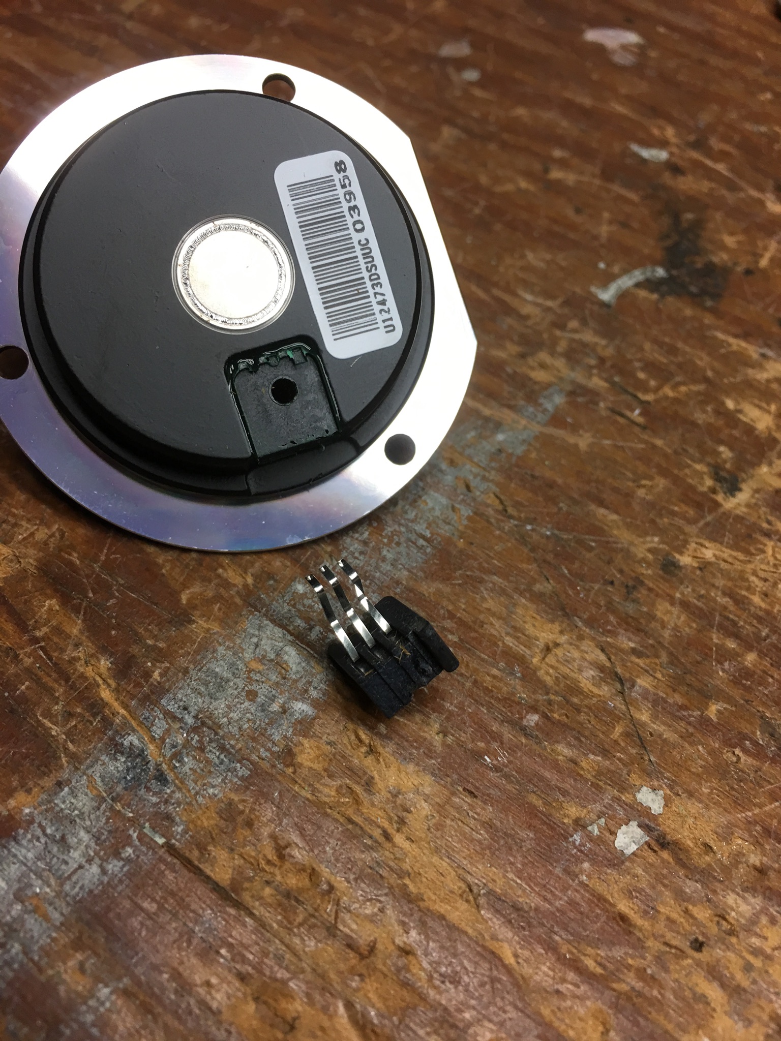

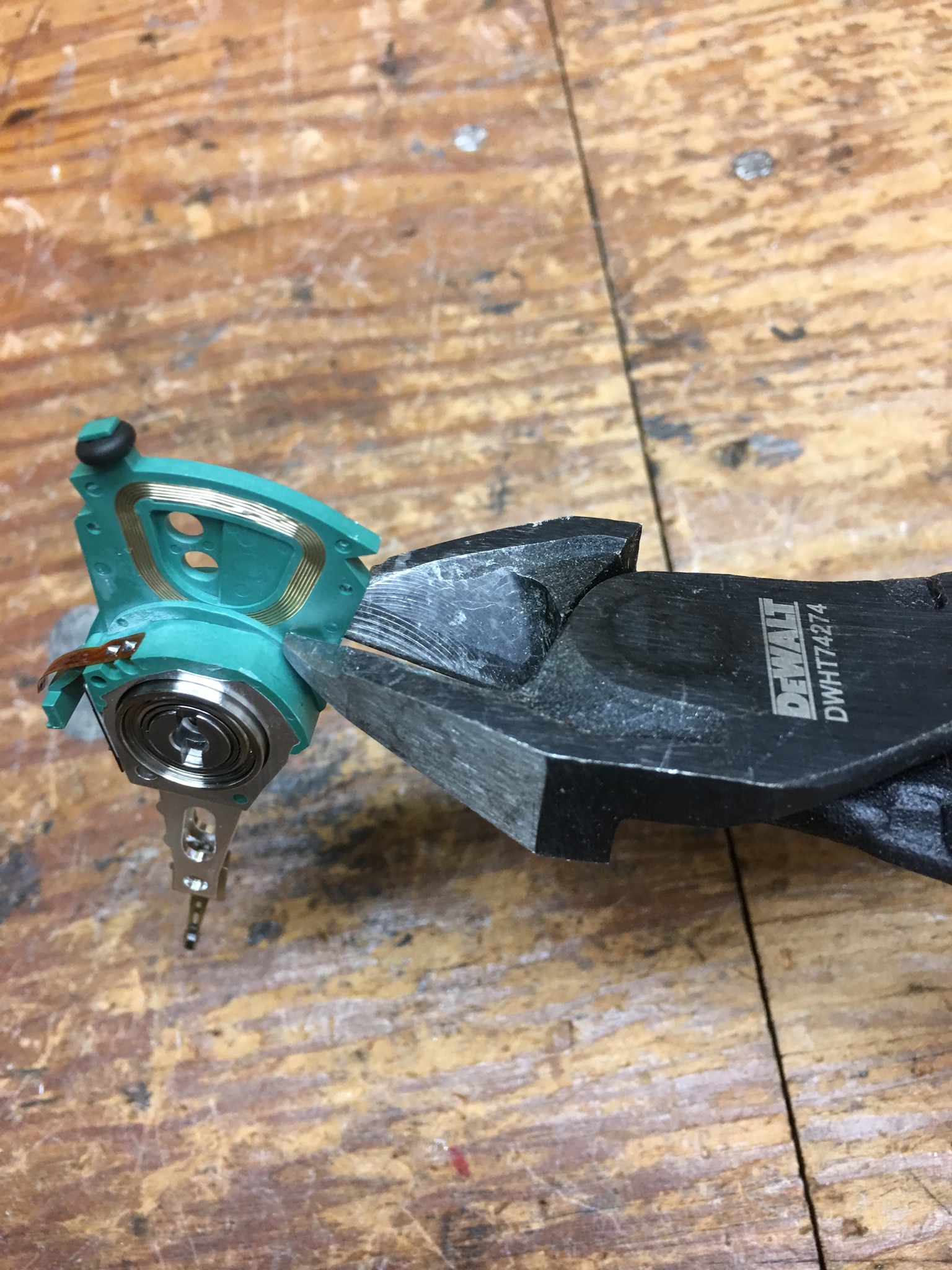

PostPosted: Sun Feb 19, 2017 9:13 pm
Posts: 10556

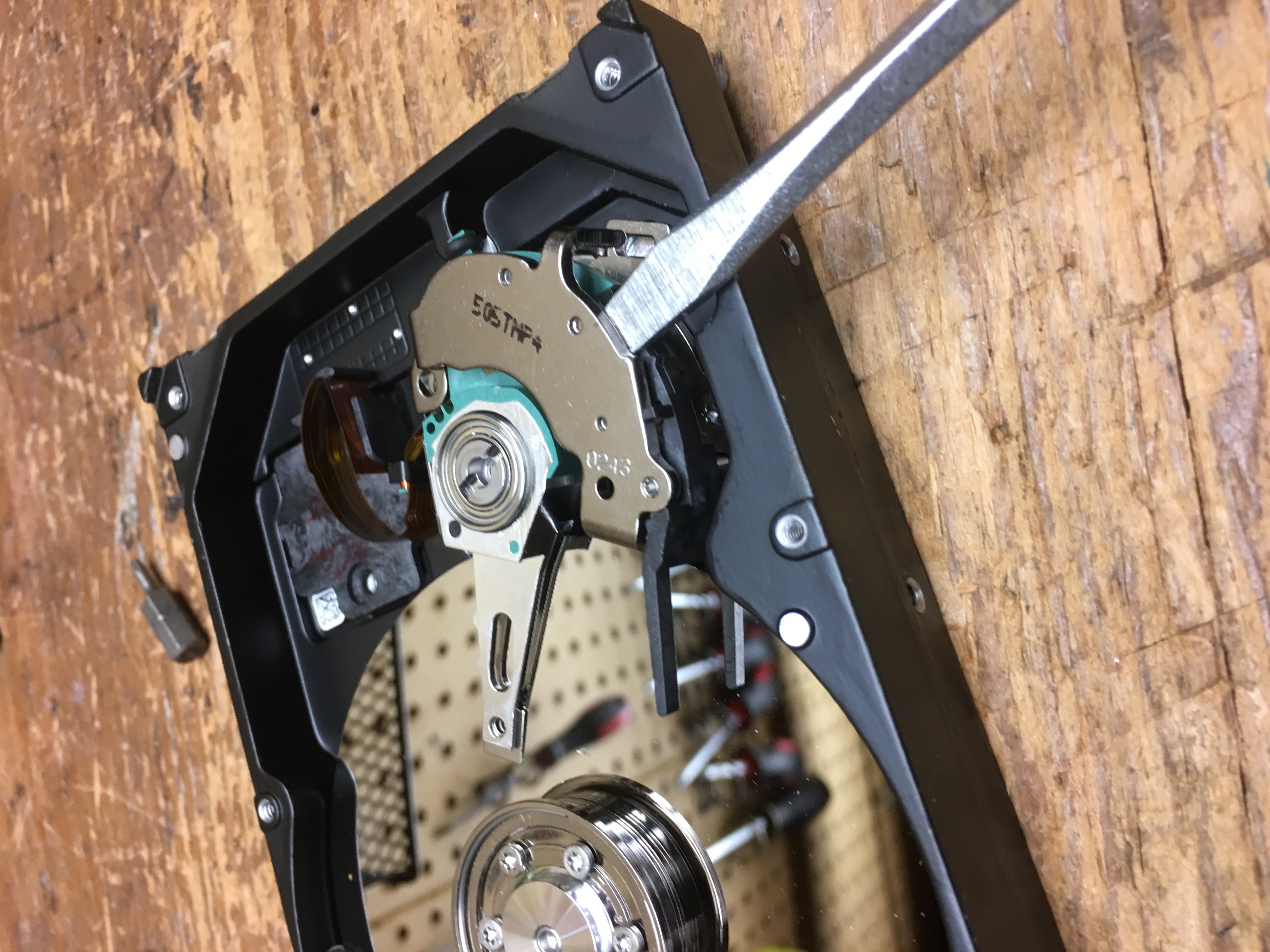

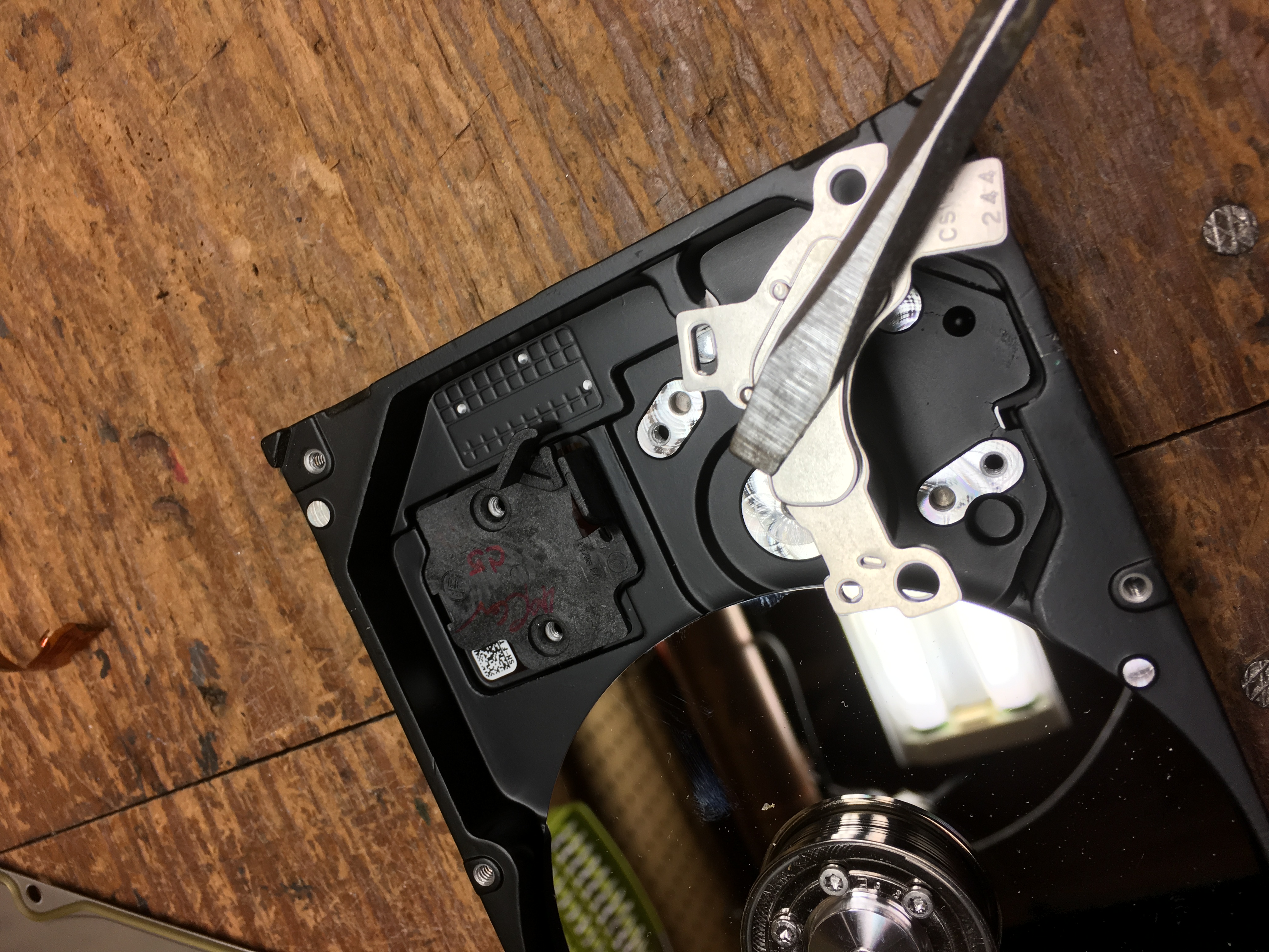

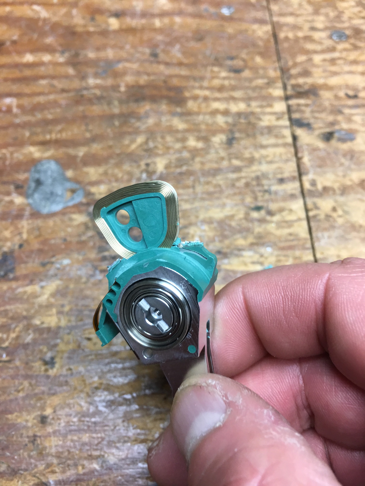

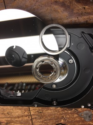

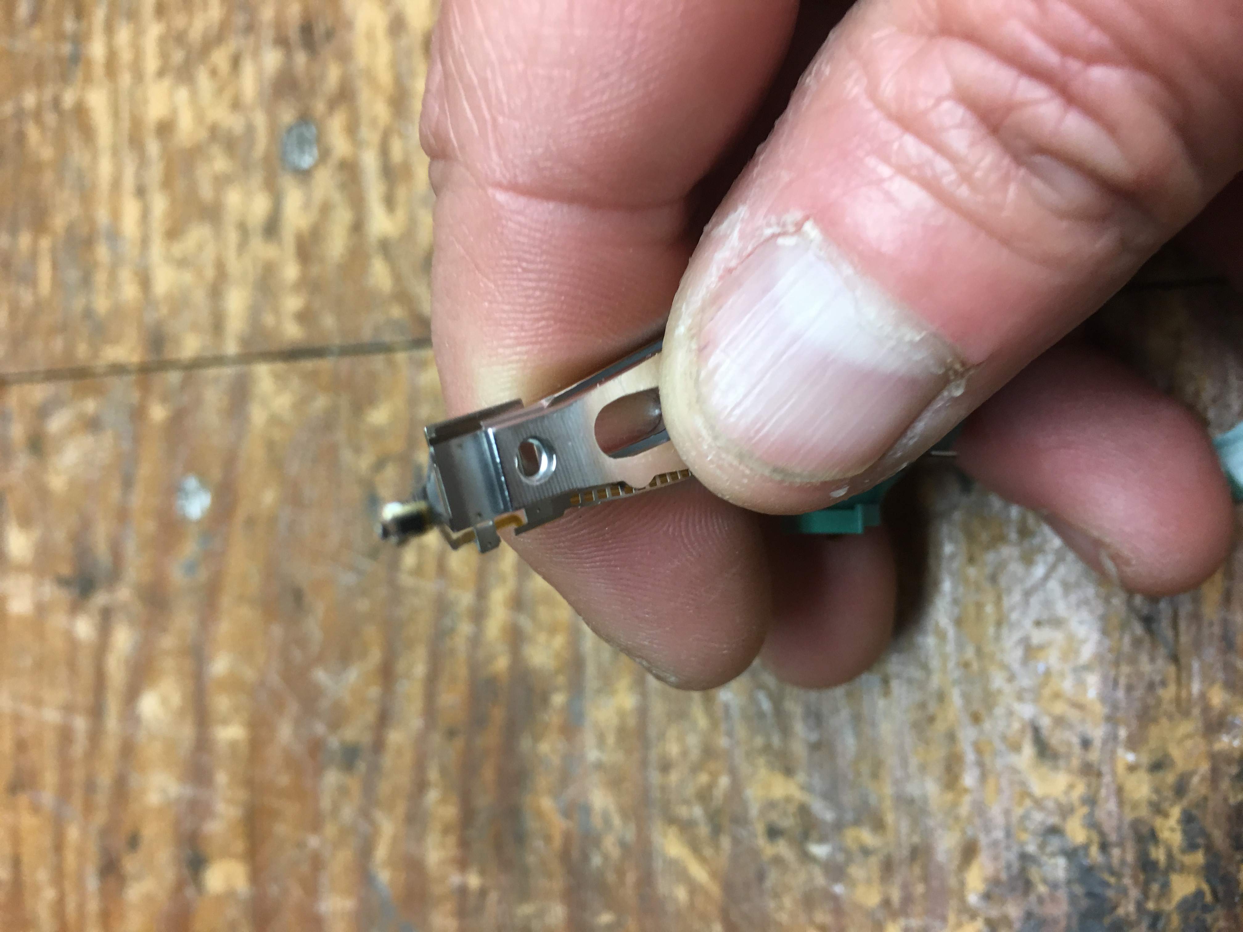

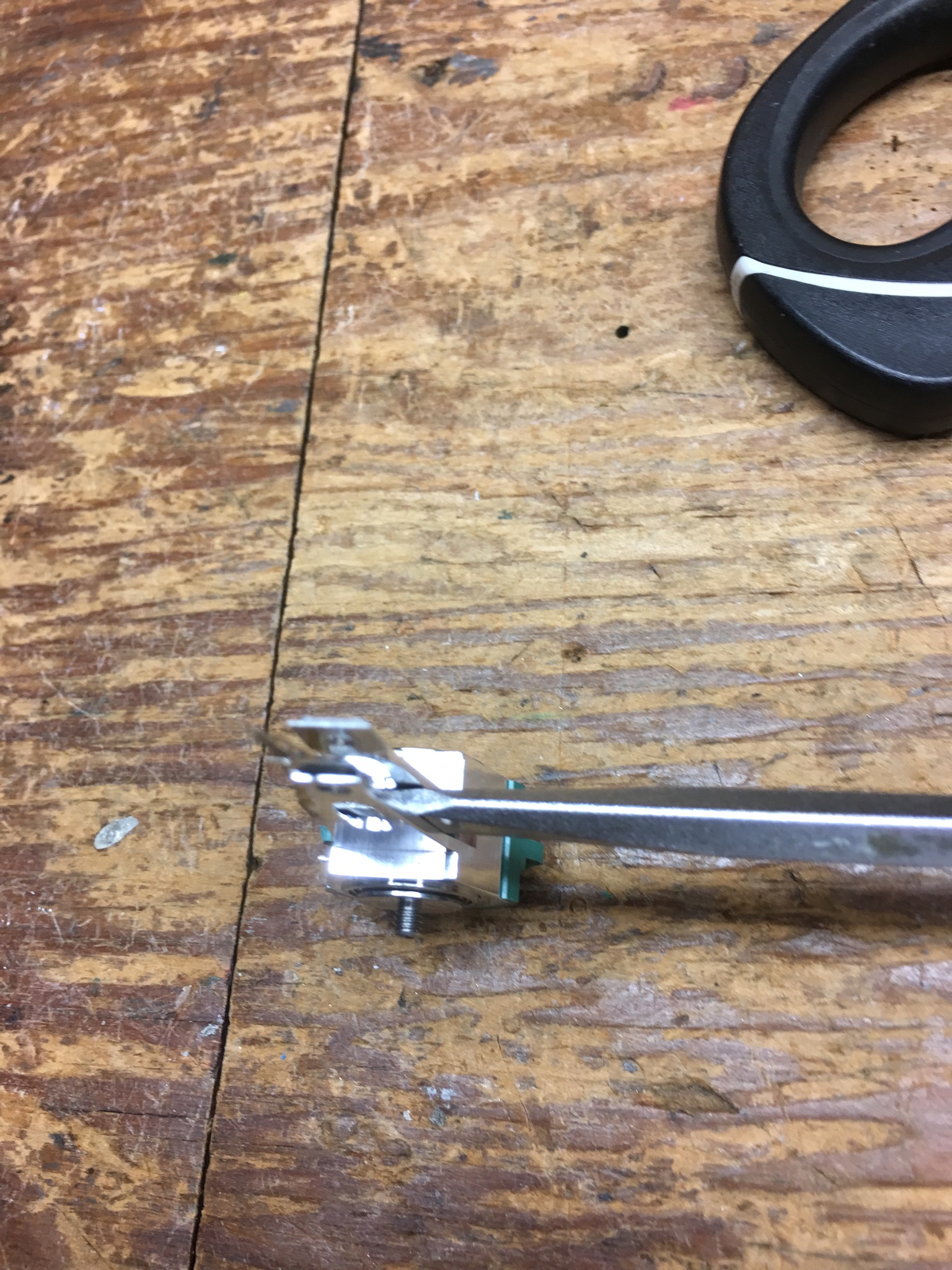

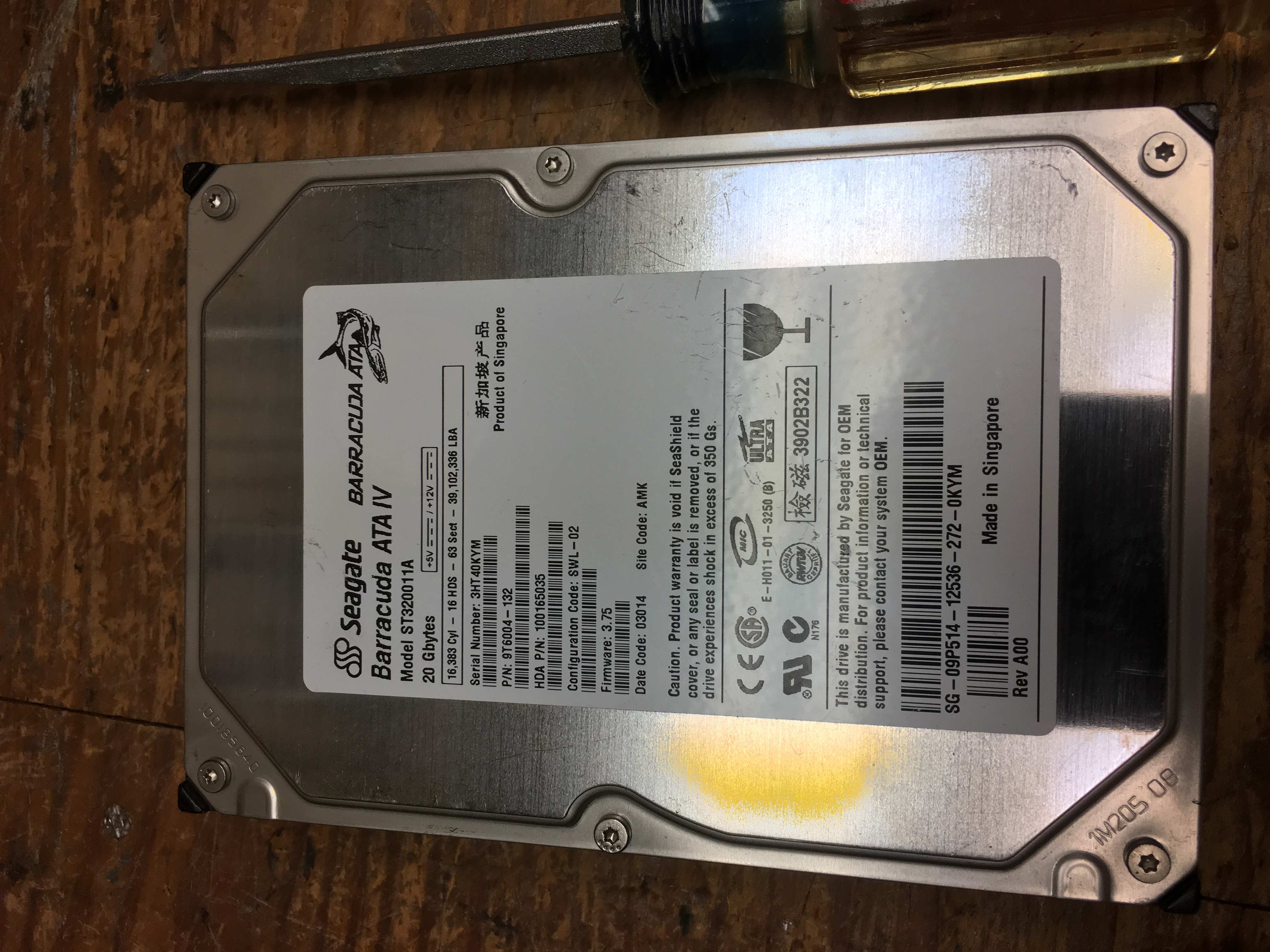

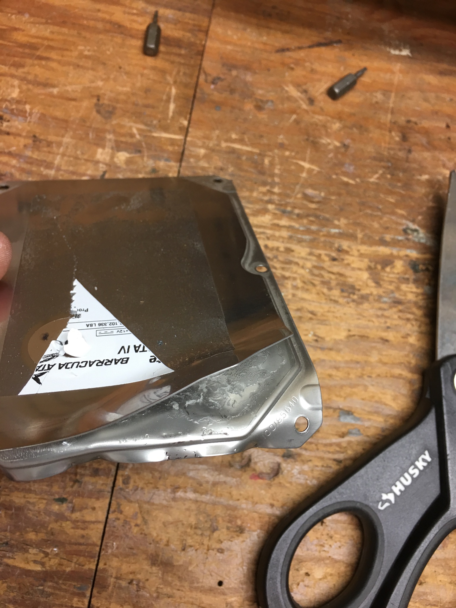

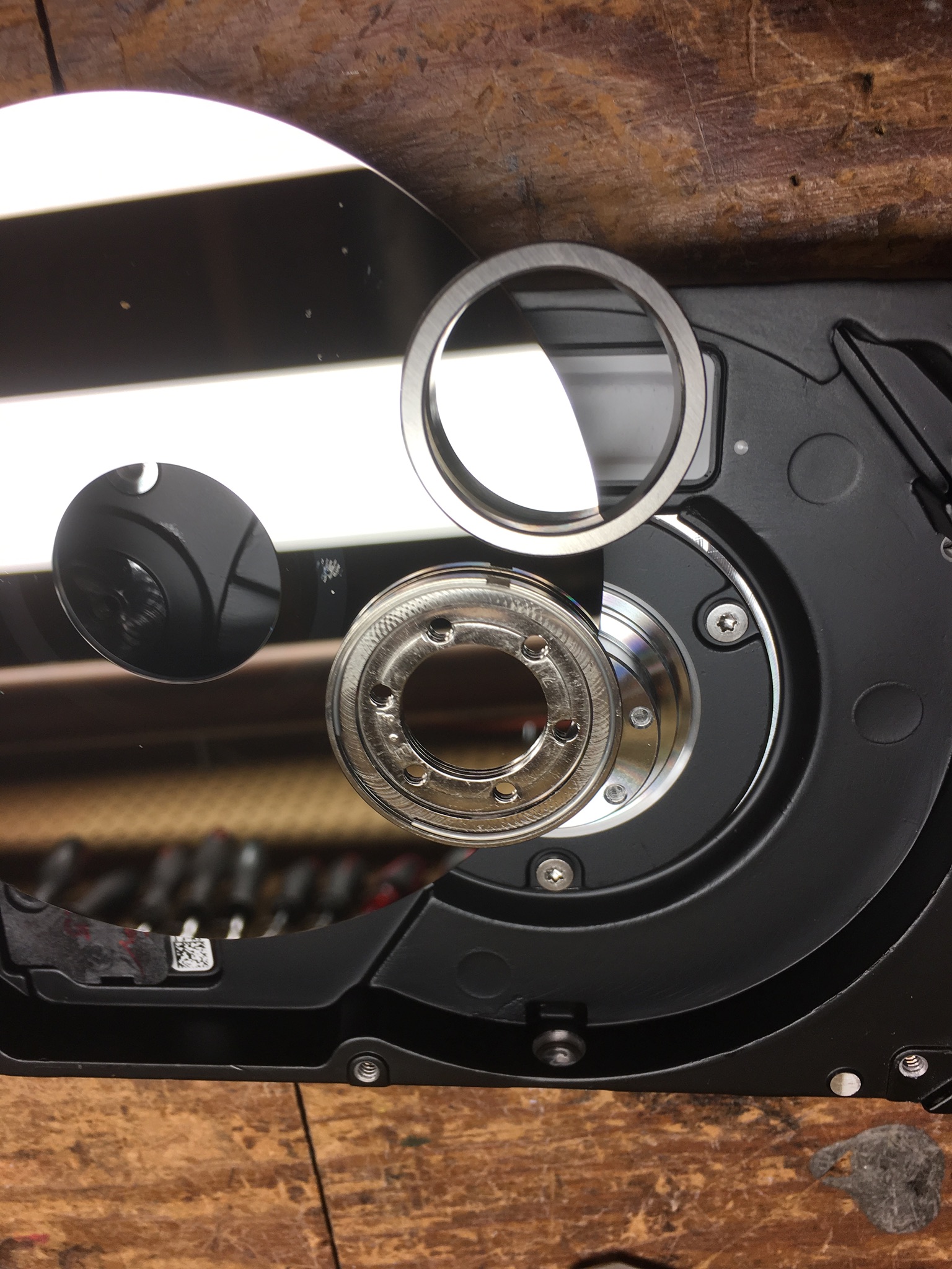

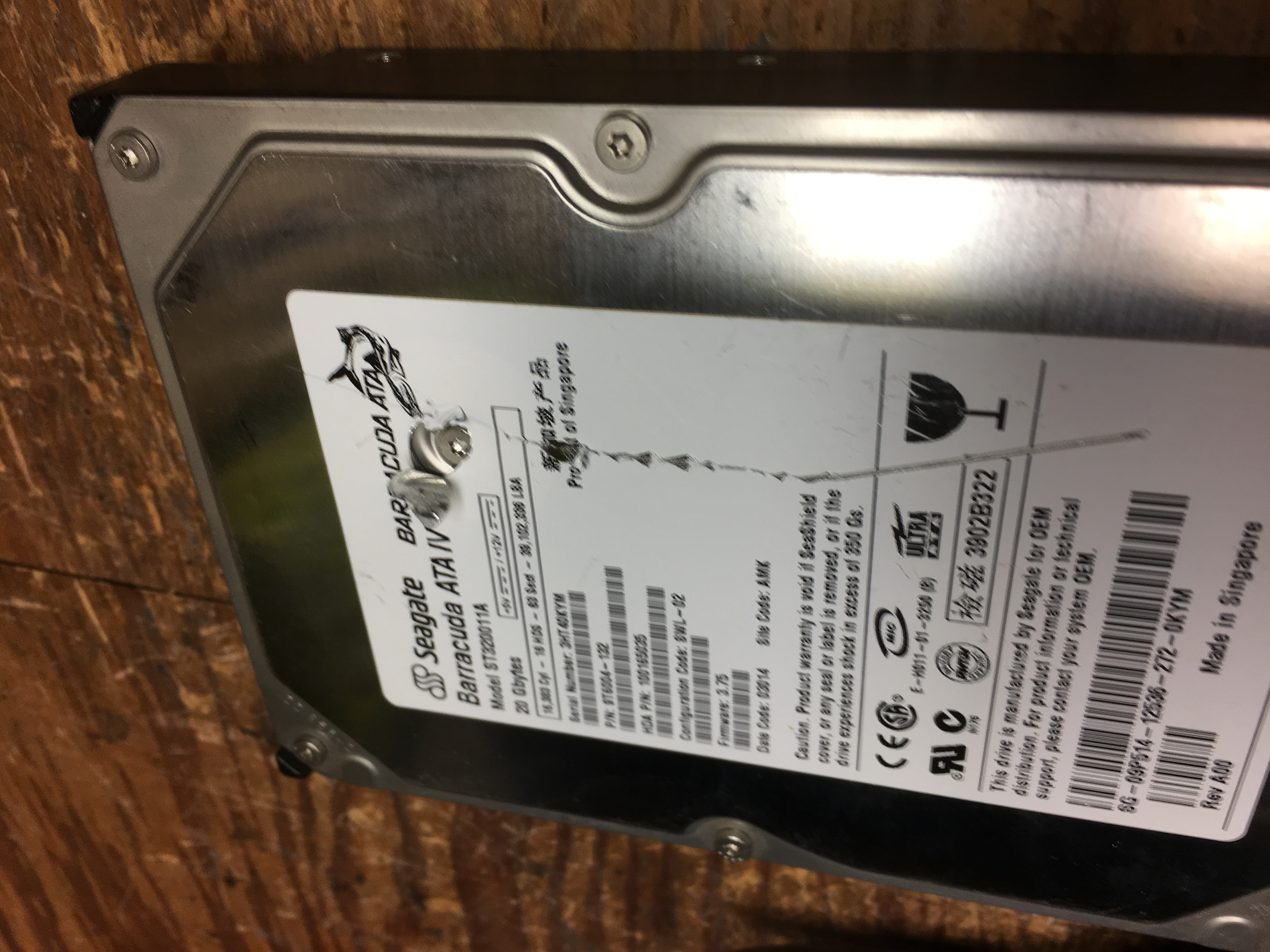

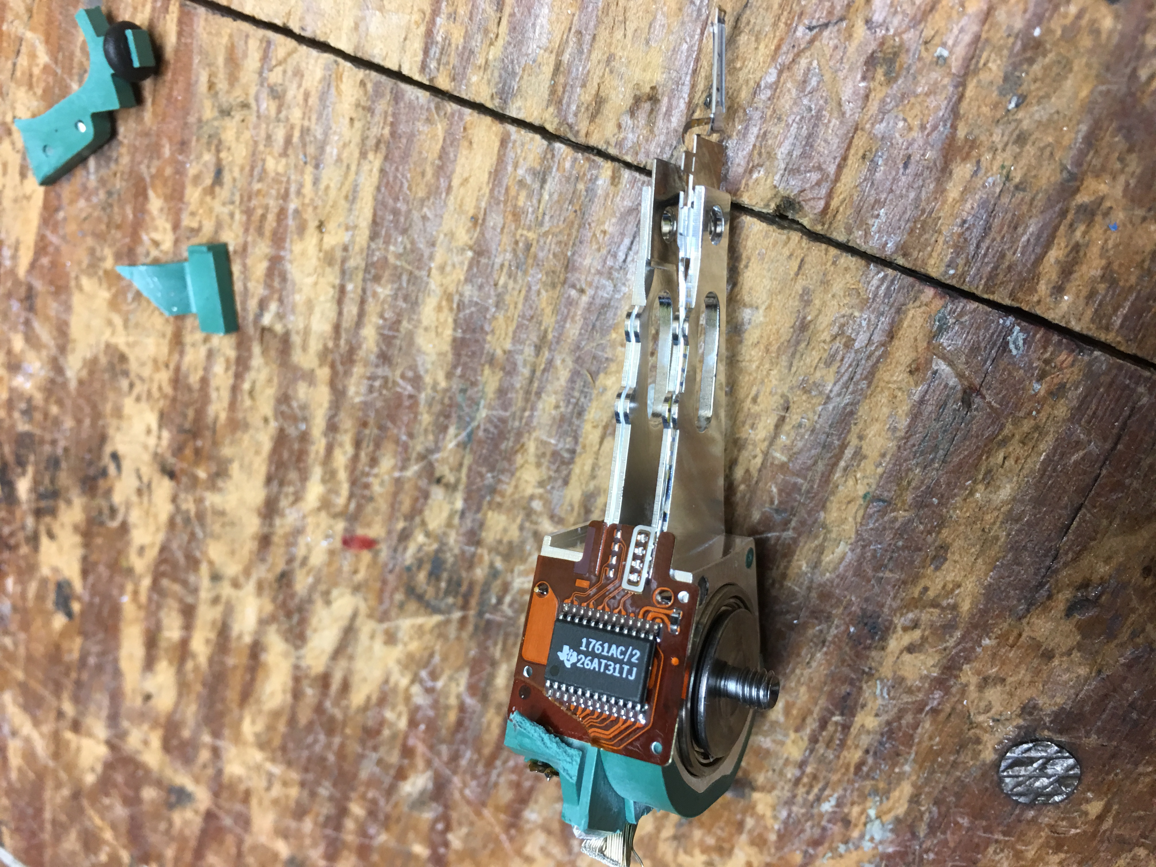

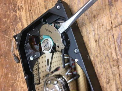

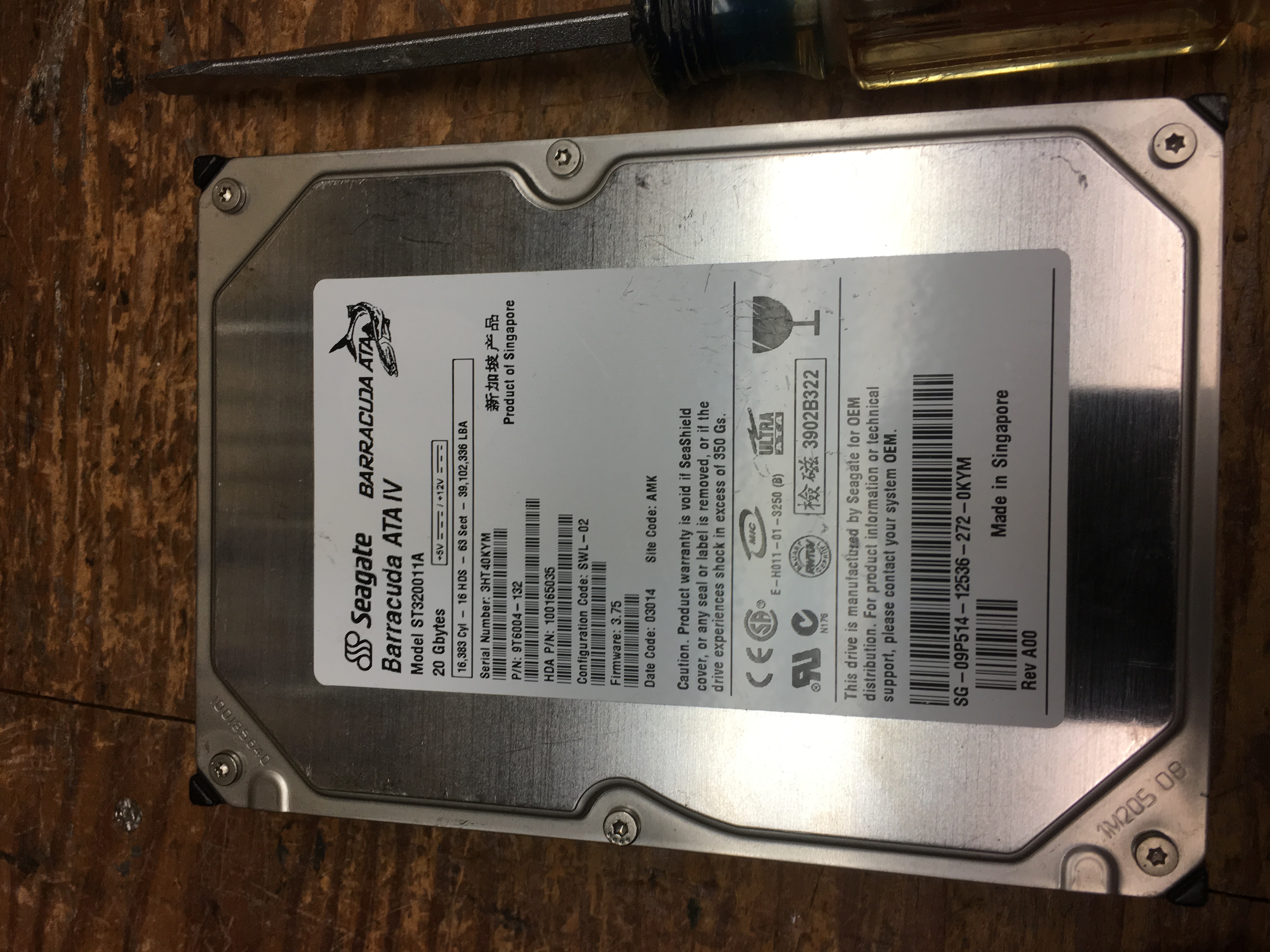

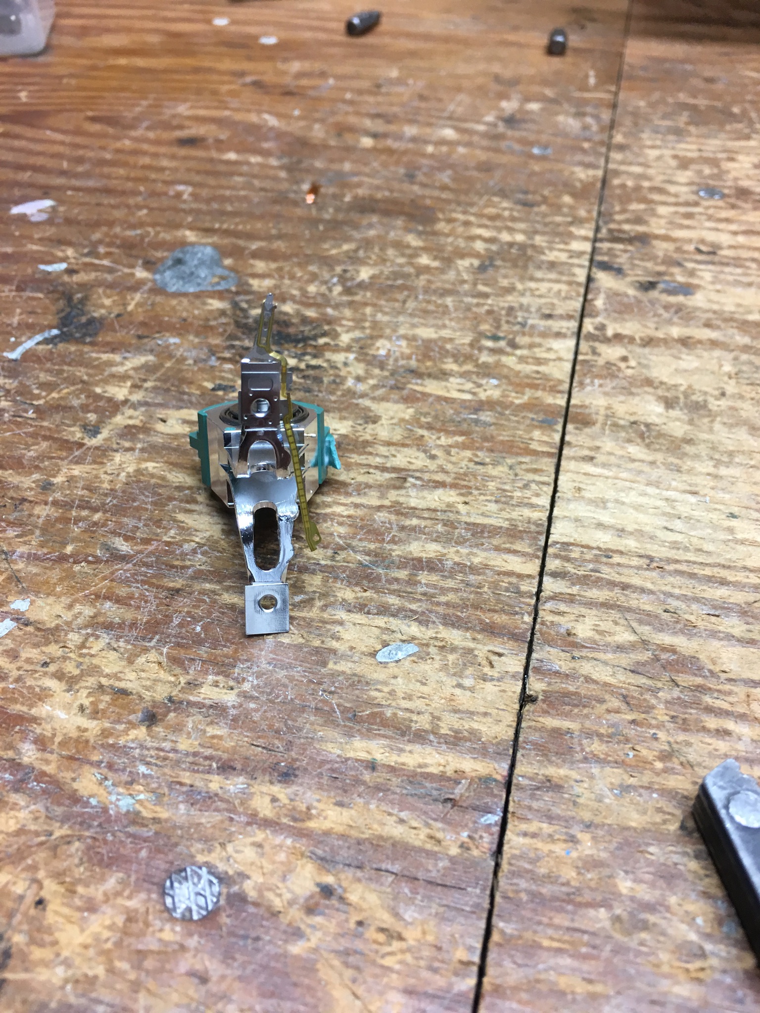

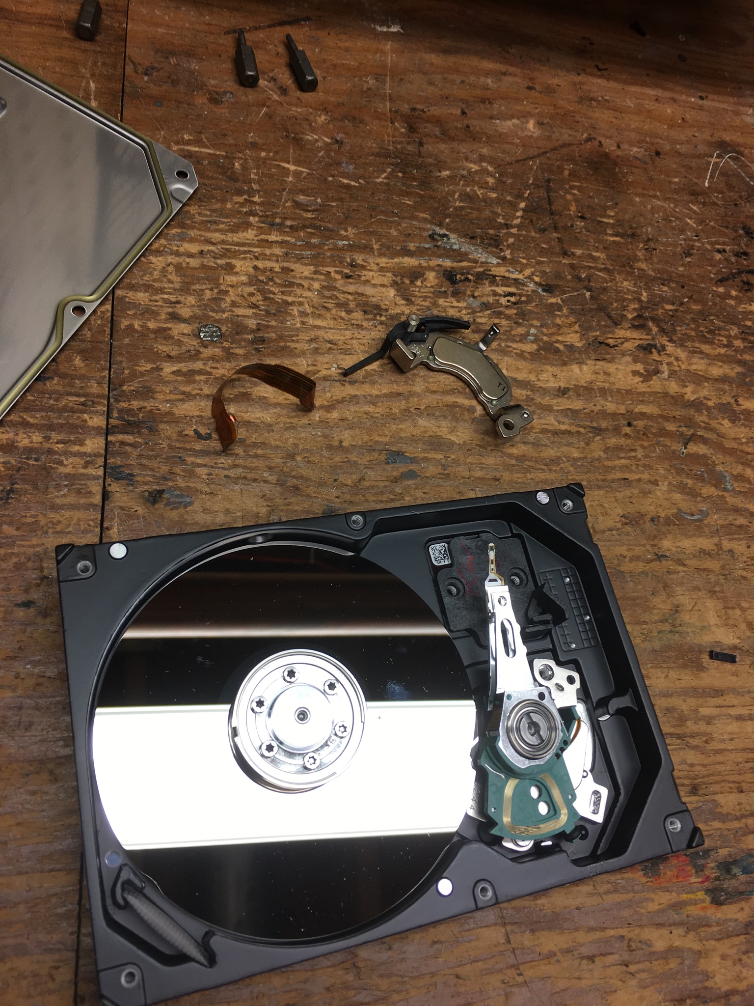

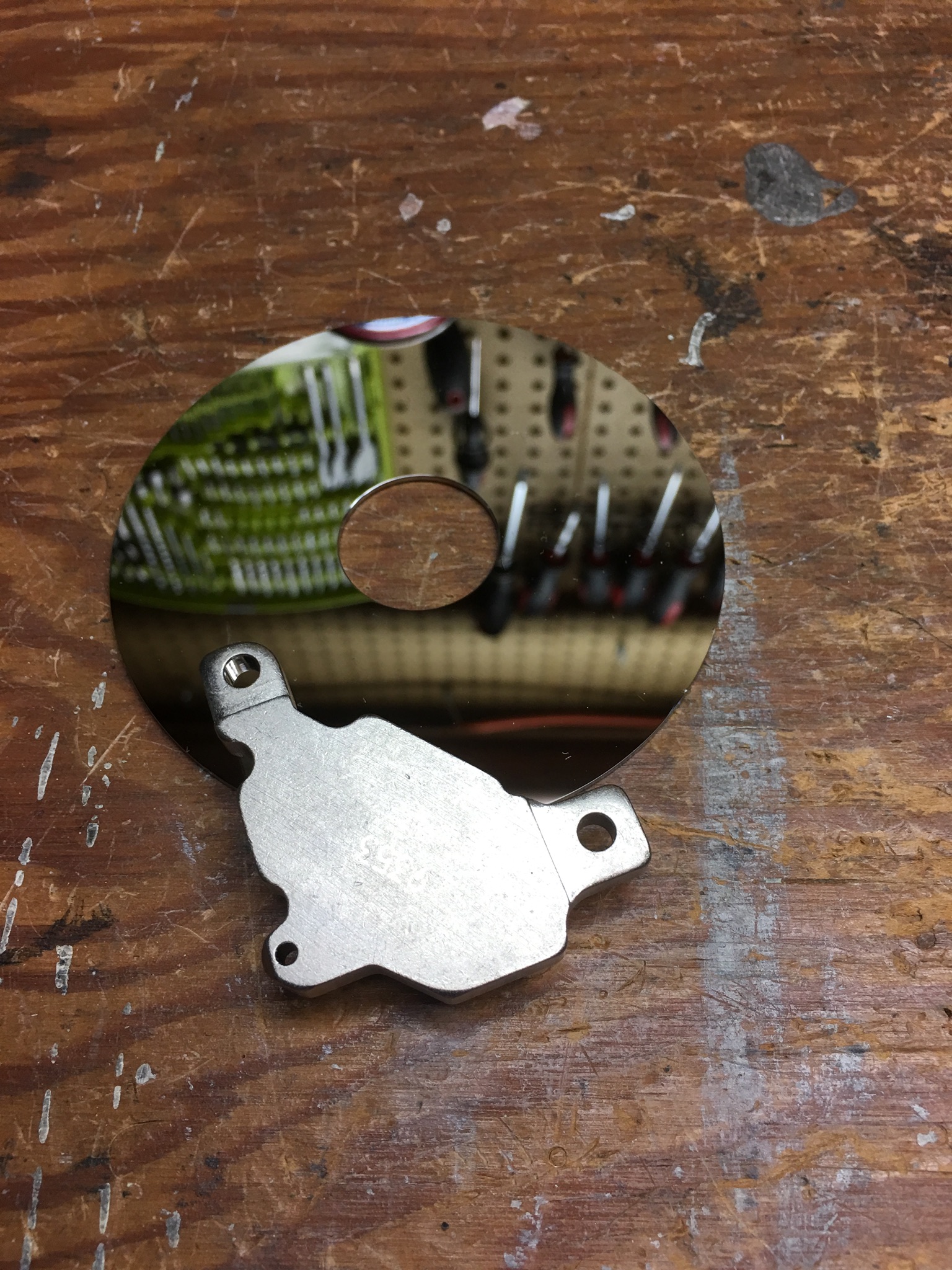

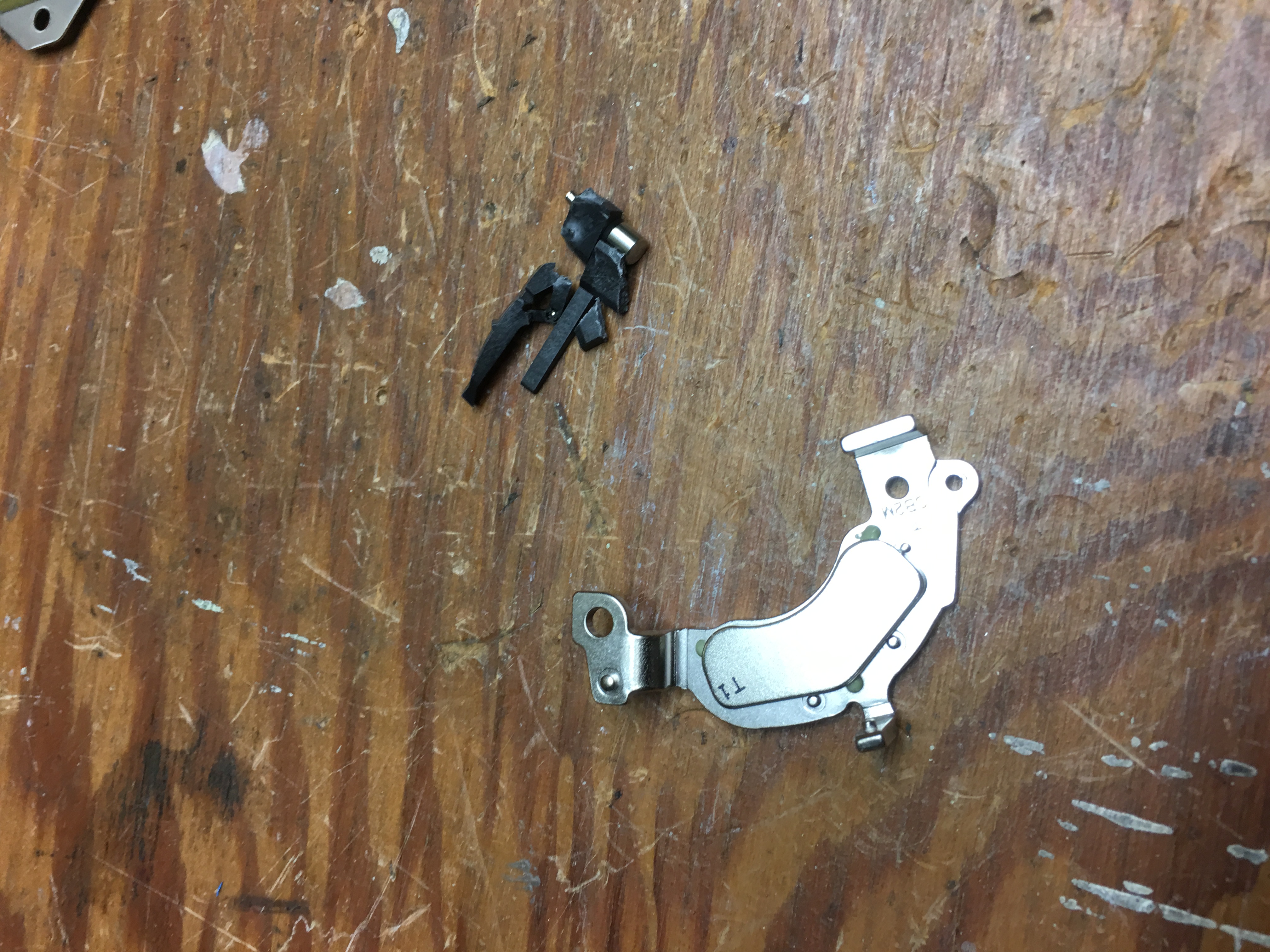

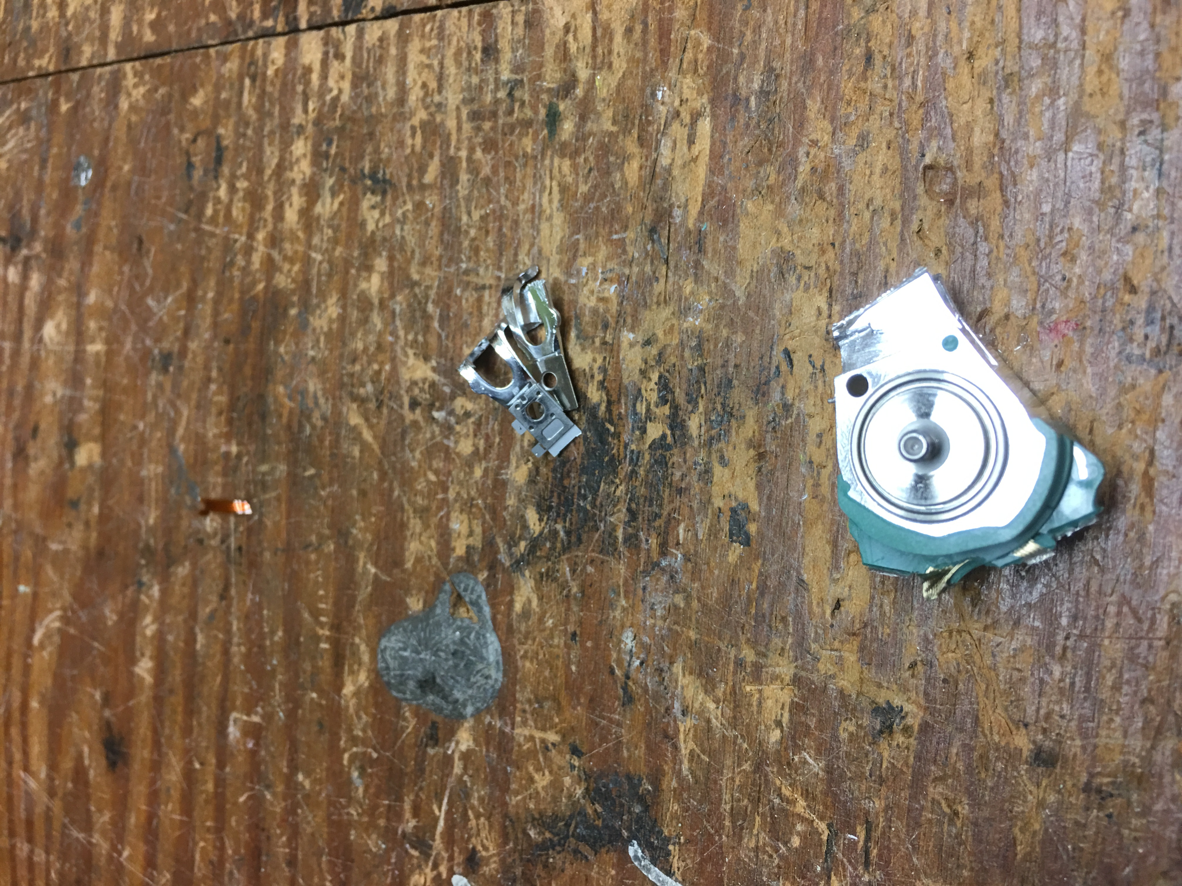

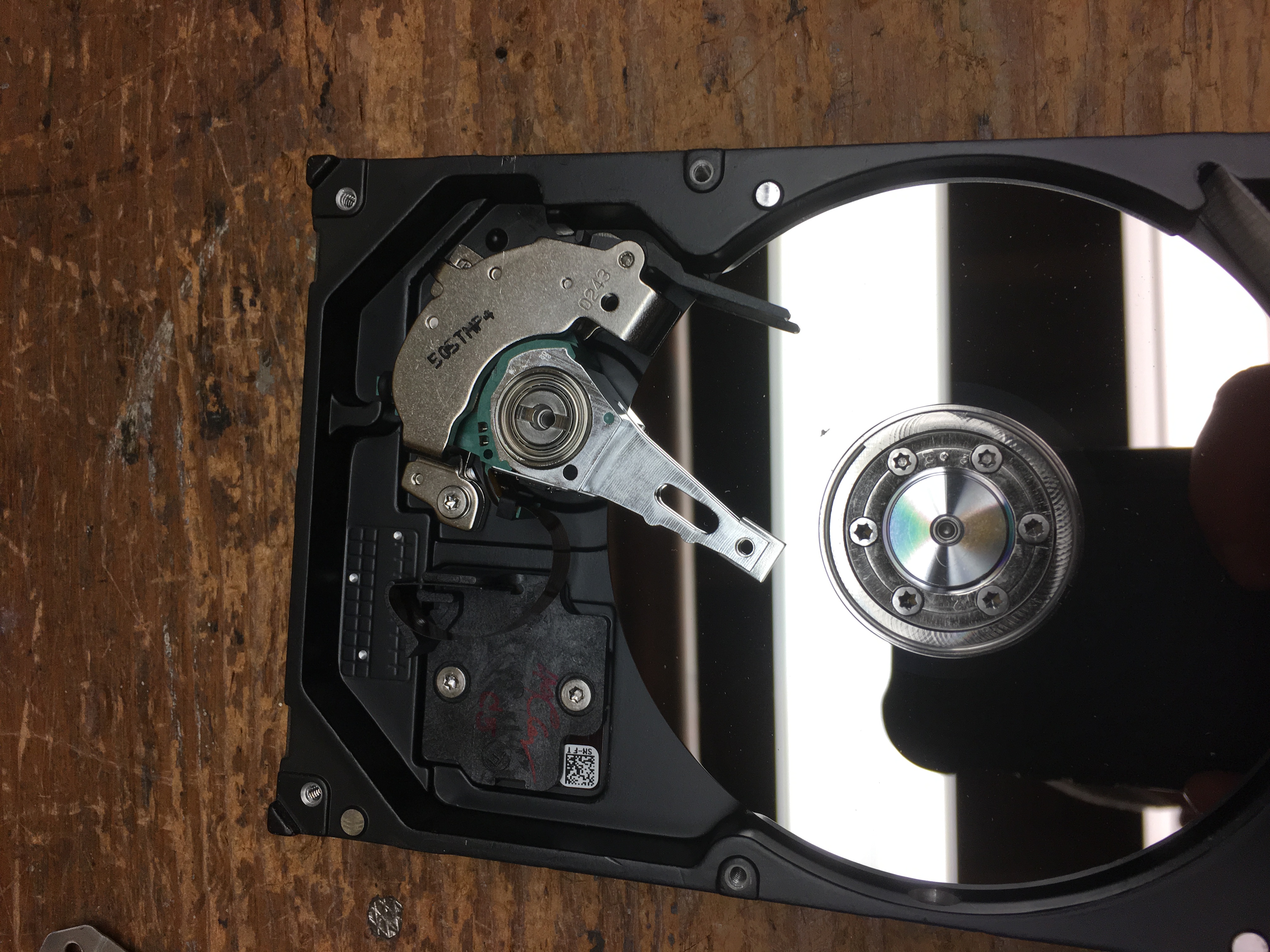

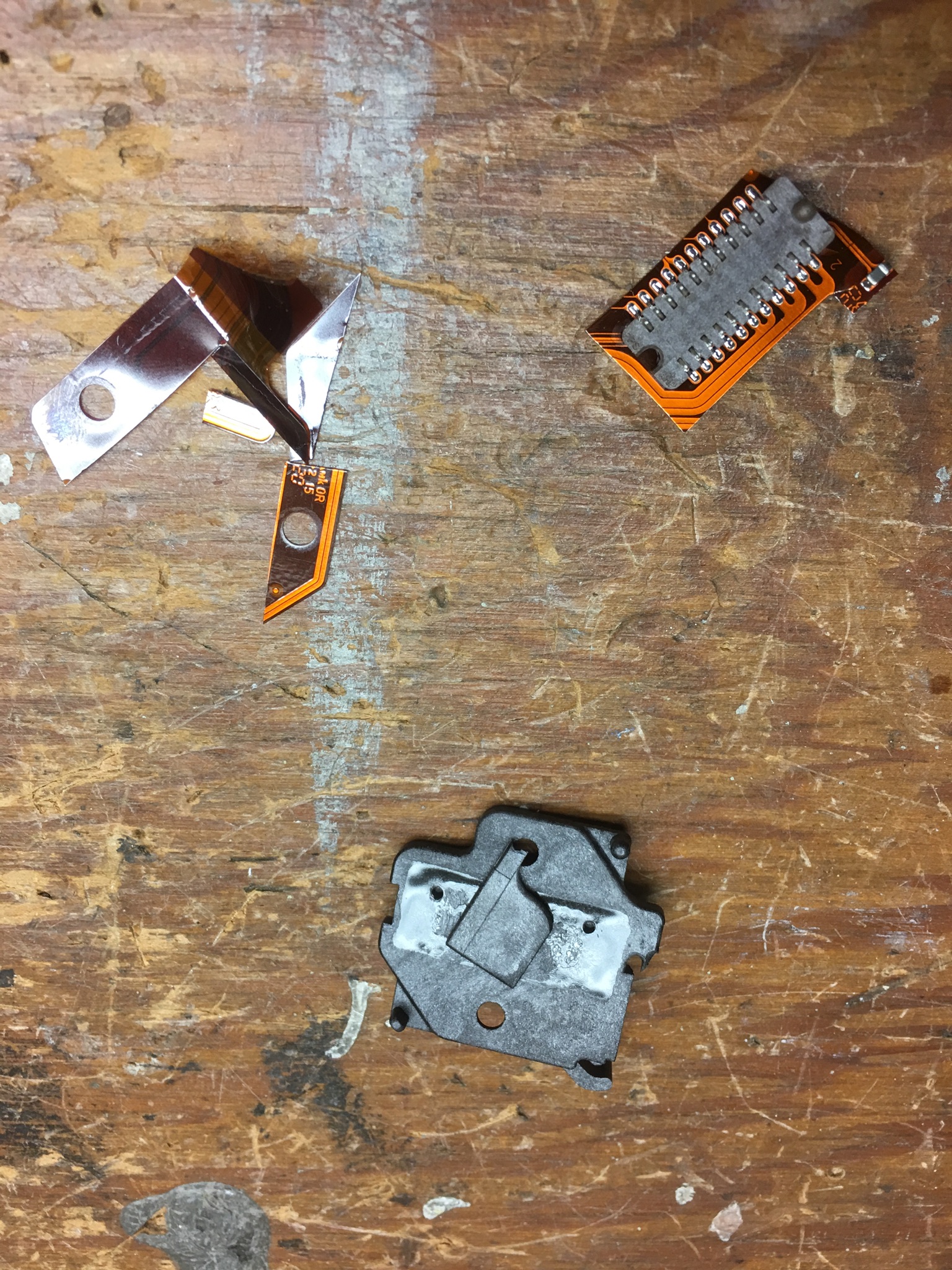

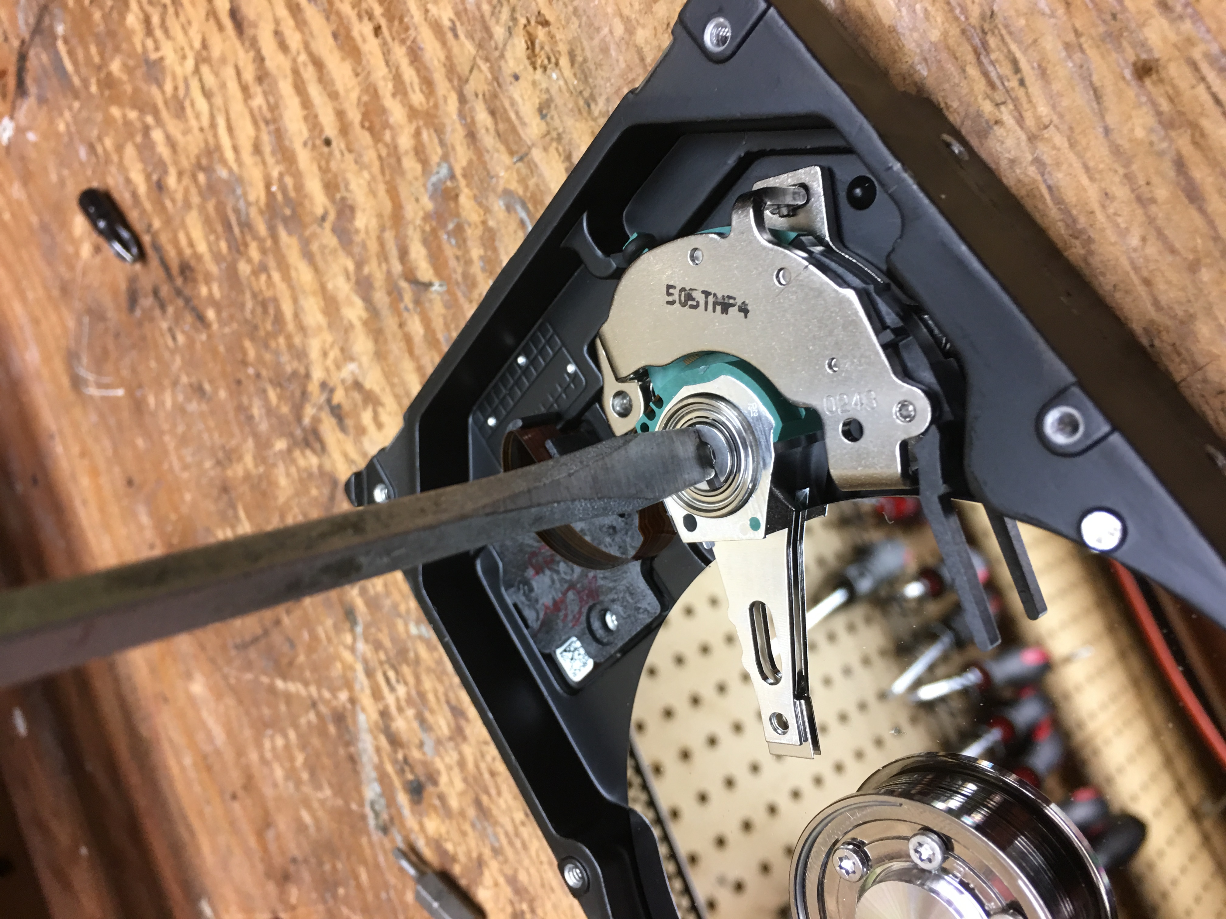

In photos
PostPosted: Mon Feb 20, 2017 10:21 pm

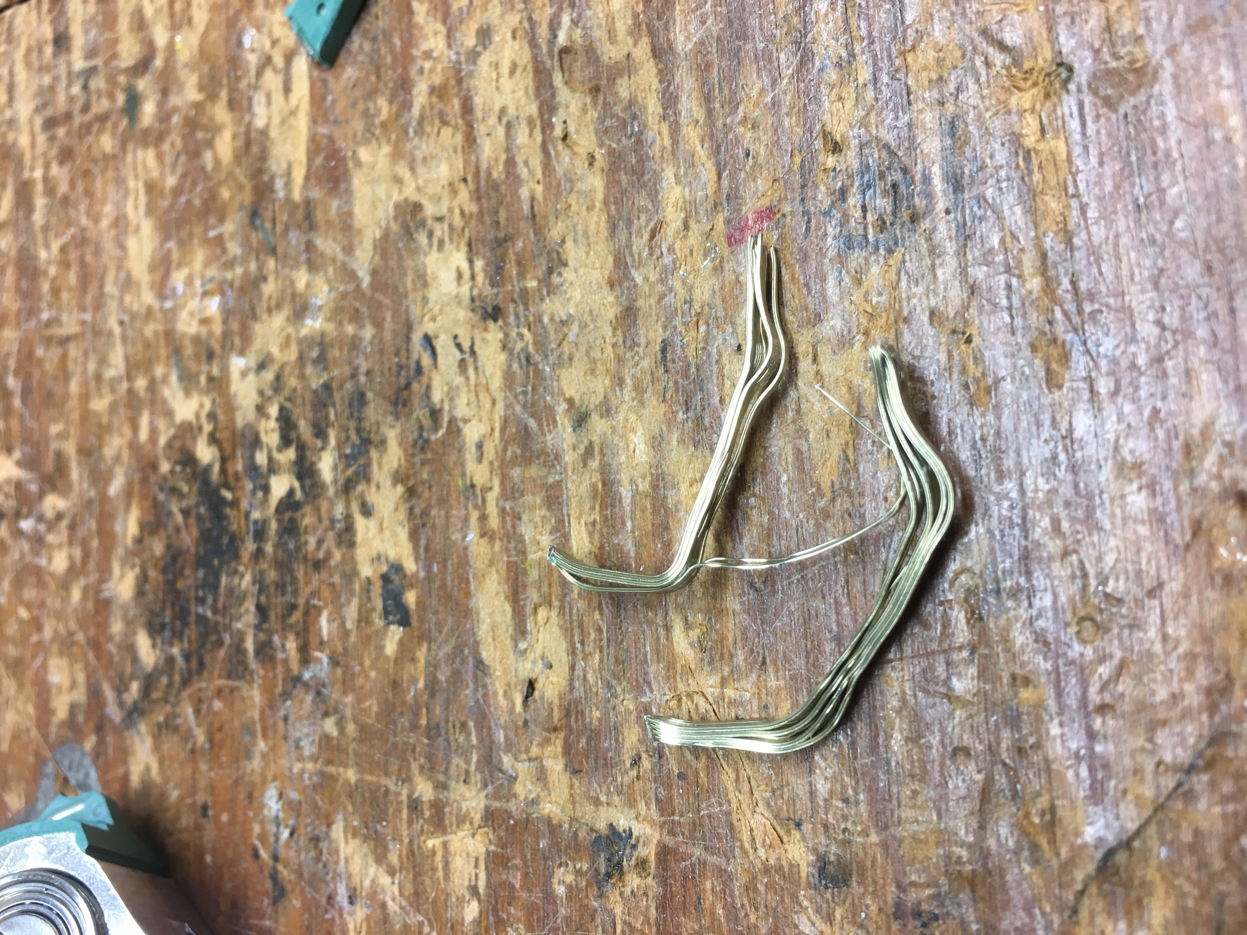

I feel like such a dummy, I have scraped a a lot of HDD's and throwed the heads in with my dirty aluminum assuming that wire was aluminum.

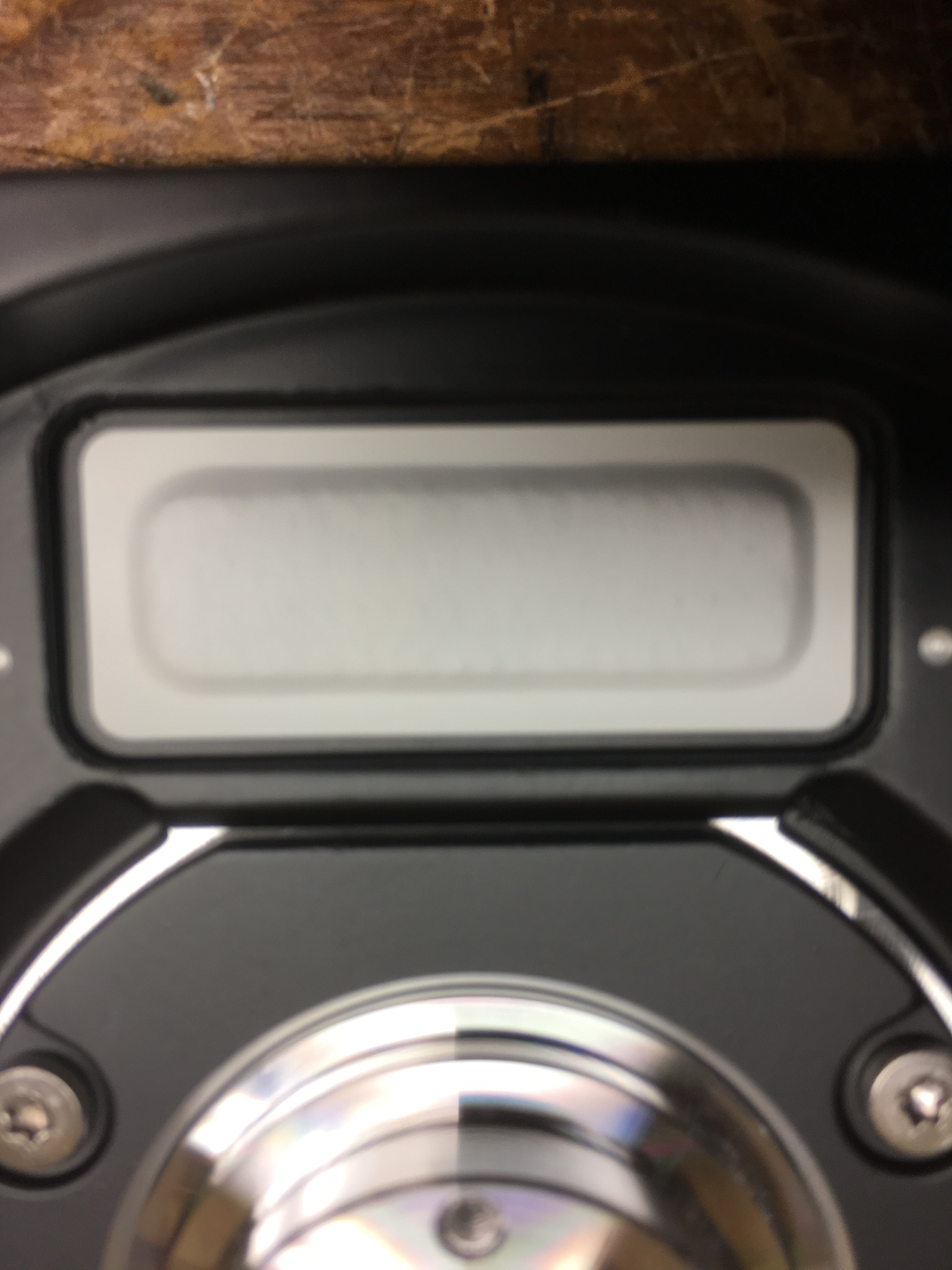

Lostinlodos wrote:
Remove this, there's pellets in it
I have always wondered what those pellets do (anti-vibration?) and what they are made of.
Thanks.
An answer to a problem that is correct and efficient yet pleasing to behold is that problem's elegant solution.
PostPosted: Wed Feb 22, 2017 1:25 am
Posts: 10556
Supposedly it's part of the filtration. I've found carbon by accident but with all the strange stuff out there I'm not sure on I do my best not to break them.
I just toss the whole thing sealed pellets plastic and all in shred
Someone smarter than me may be able to tell you exactly what it does.
Filtration makes no sense in a SEALED plastic strip bag.
