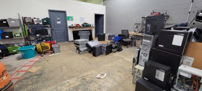

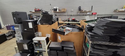

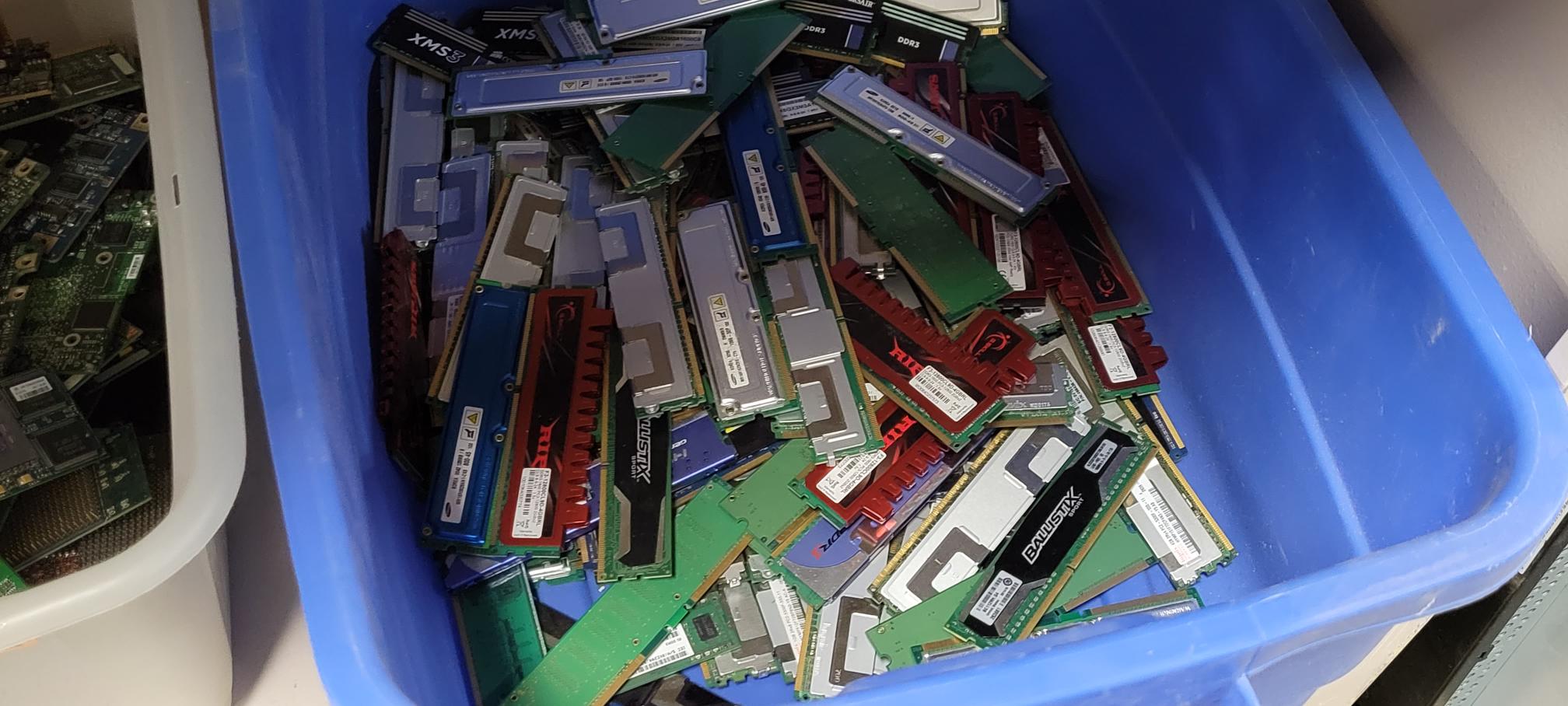

Hi everyone! I started working for a non profit about 3 years ago, and they have an e-rec dept as a way to generate funds. i have received little training, and I was essentially given a price sheet, and was basically told to figure it out. which I have done pretty well, if I don't say so myself. recently i was promoted to coordinator. so I'm not quite a manager, but I'm still responsible for everything that happens in the dept. its pretty small, its just me, a one other full timer, and a seasonal part timer. we make most of our money through ebay sales of used stuff people donate, and i would love to increase the profitability of our scraping. Or just give me any thoughts and ideas about the operation we have going right now.
just some raw info about it, we get about 10-12 gaylords of assorted stuff a week, no consistency to it other then we get a lot of it. we get so much that i have my guys focus on breaking down the most profitable tech, laptops, desktops, and what our current buyer calls "mid grade" which is like anything with HDMI, ethernet, usb ports and like tv control boards. low grade stuff vcr's, old DVD players, beauty products, cooking appliances, etc. all gets the wires cut and thrown in the metal.
I'm always interested in niche buyers, currently we have someone that buys all our videogame stuff, excluding gen1 Xbox 360's. we also have some guys that are into older audio gear, receivers, speakers, amplifiers that kind of stuff....
so i guess ill post some pics and.... yeah, I'm just really looking for anyone that's willing to talk to me about this stuff, their ideas, things they are interested in, their offers and rates, etc.

Memory, if it’s current (DDR4+) or older than DDR, it’s got potential untested or dead, and value tested working.
Never scrap EDO memory. Value is market-fixed and doesn’t change much but it’s in short supply.
