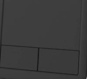

Trackpads? Like these?

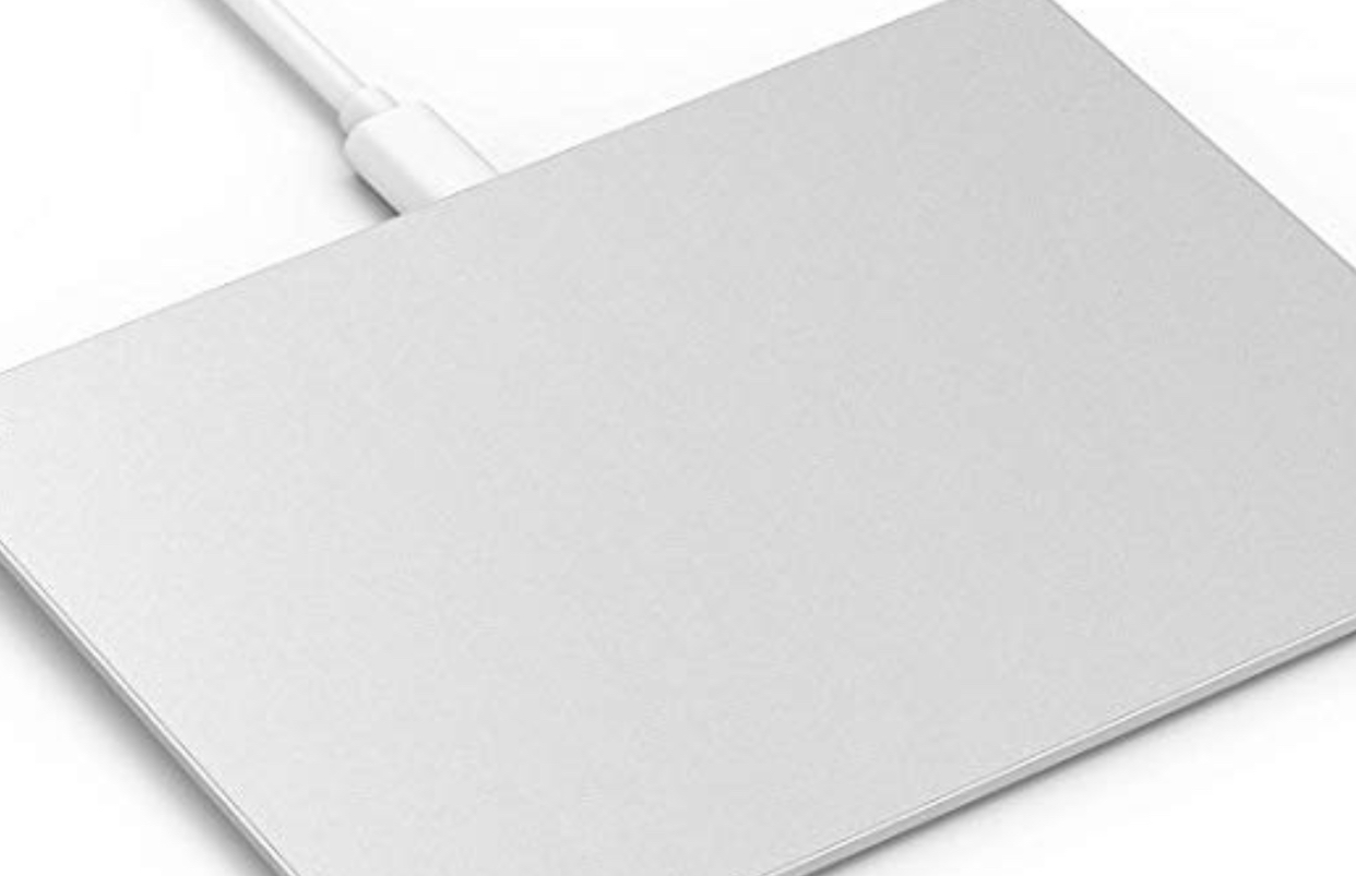

PostPosted: Mon Feb 17, 2020 8:10 pm
Posts: 10624
Omg. I laughed so hard I got a cramp in my side.
More along the lines of these:
...and more specifically the board inside them.
