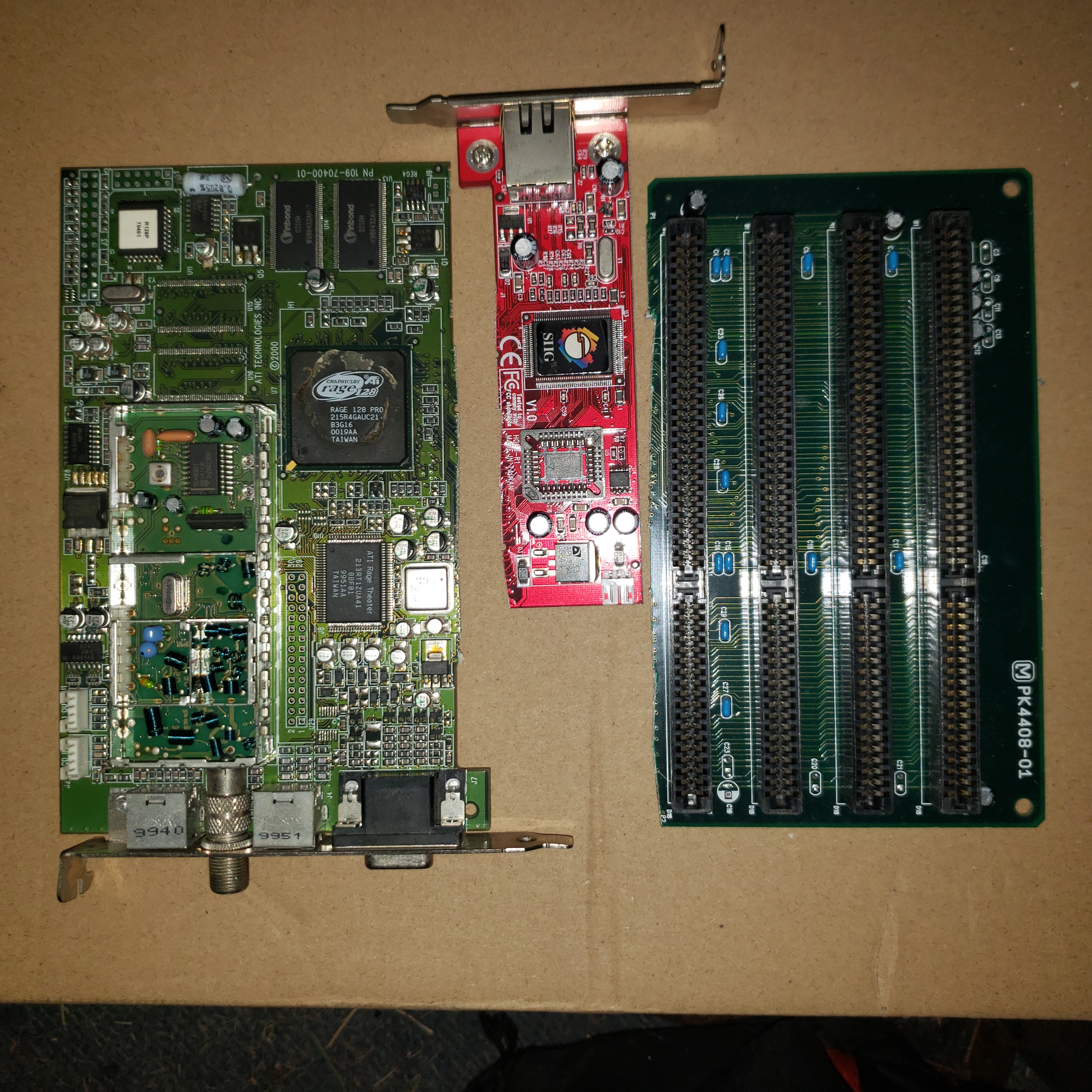

As far as cd dvd most of what i have is 90s early 00s other than the random dvd player for the living room. Only external type drives i have are floppy and a Zip drive.
On the boards in this picture. The bottom is trimmed fingers now some sort of expansion type i suppose. Would it even fall into finger board area?
The red one is trimmed an owner prior removed the bios chip. Is it still a trimmed card or would it be more like low grade?
The ati card it has that other board on top of it does that need to be removed before sending it?
I ask too many questions. What is a good rule of thumb to put cards in their respective categories?

I know it says that the brackets are okay, but is their a higher payout if they are removed?

Cards without the connector go as trimmed finger cards
The riser, if the pins are gold it’s still backplane.
If not it will likely be midgrade.
Removing brackets and 100% of shields and steel/aluminium framing
Quote:
Gold Finger Card Clean NO Fan NO Sink NO Bracket
Must obviously have the edge ‘finger’ connector still
And it’s ohkay to remove SOCKETED chips from all/any cards unless it’s high telco or above.
