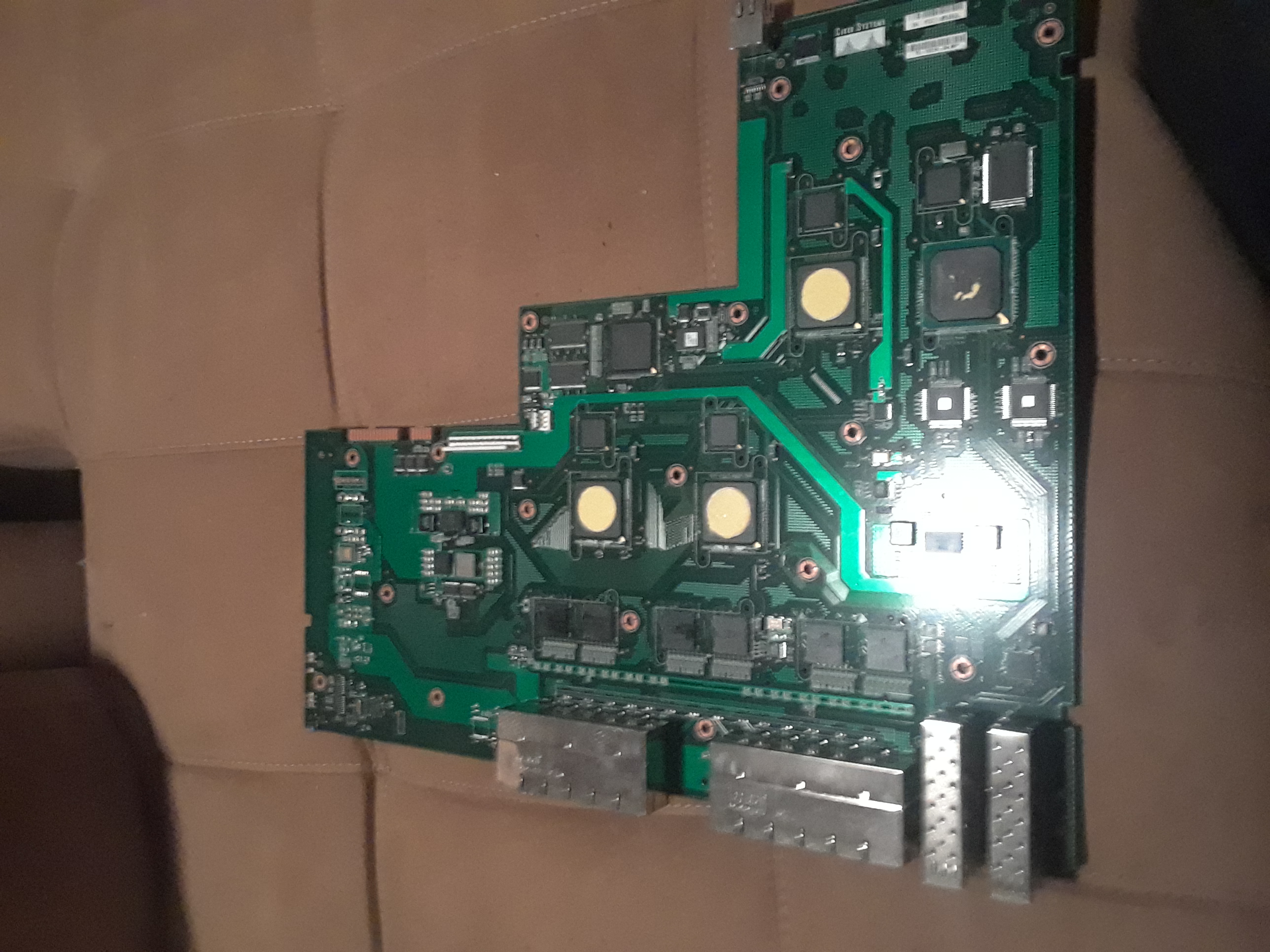

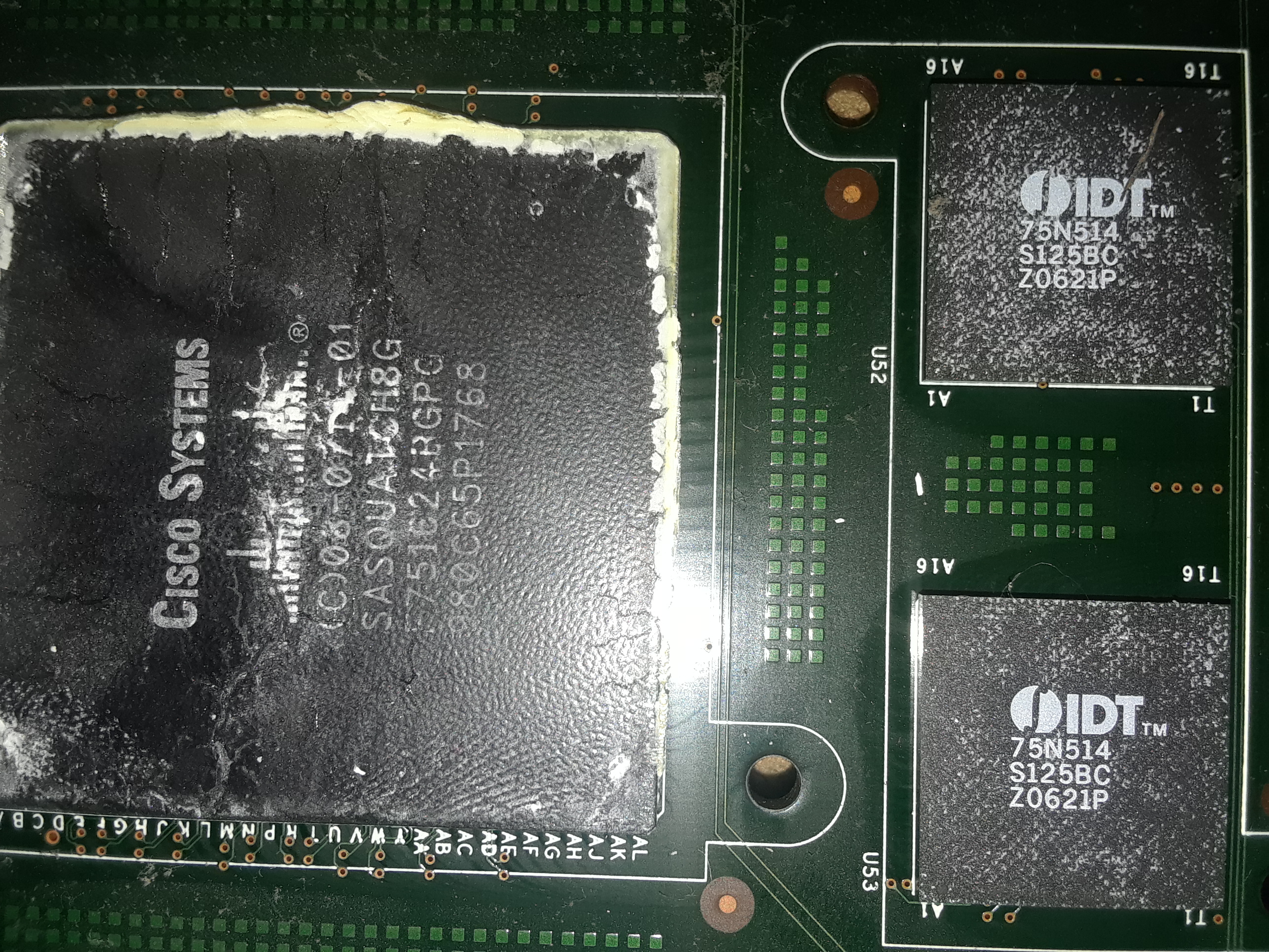

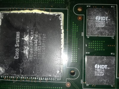

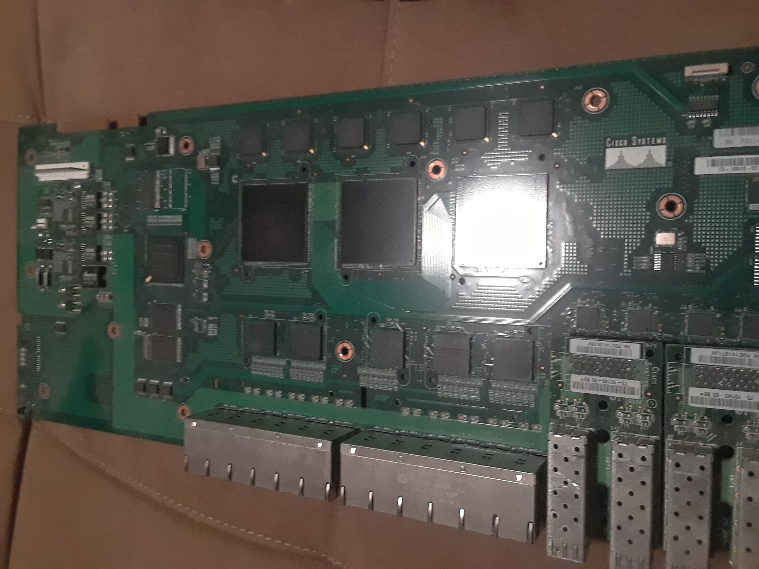

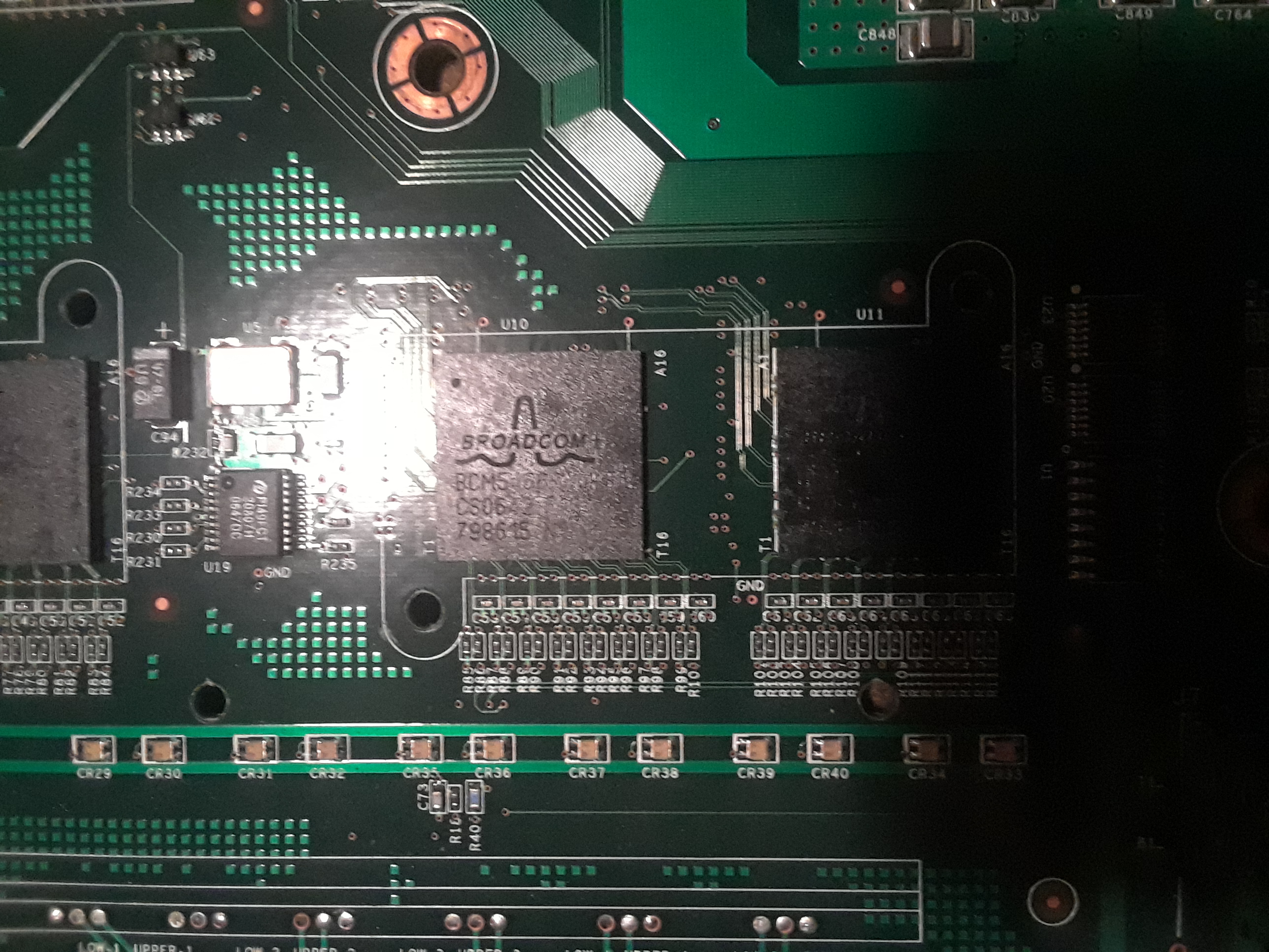

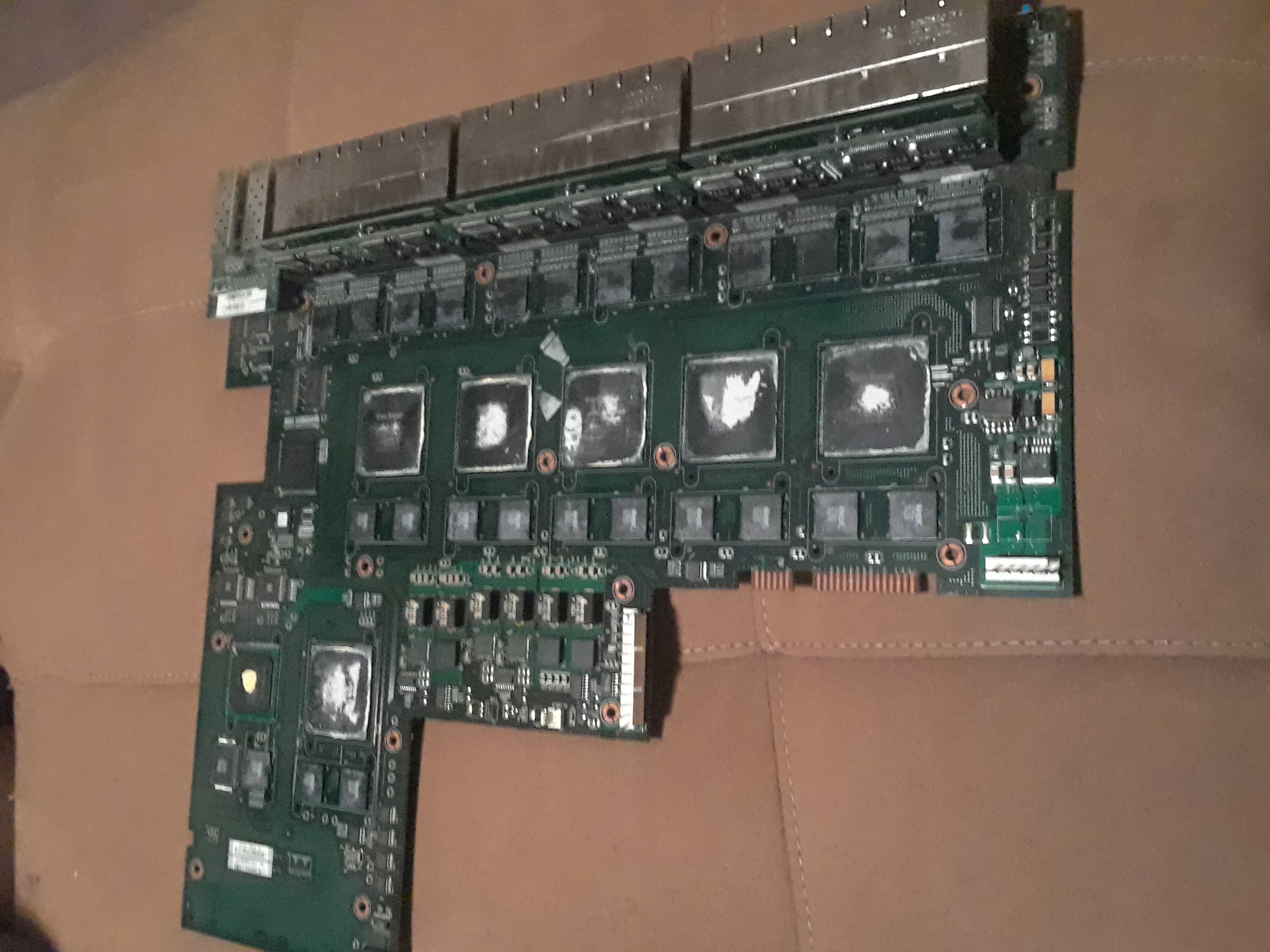

I Am new to Board Sort and I wondering what these boards would be graded as? I have several telecom boards from some older Cisco Switches- would these be considered high grade telecom boards or some other grade?

PostPosted: Wed Oct 03, 2018 12:56 pm
20180930_195518.jpg Is peripheral
20180930_195307.jpg Is telco
With network switches it’s often hit or miss. In fact telco in general is a difficult grade.
Telco is designed to be the top of the mixed board classes. It’s better than the stuff below it but doesn’t fit the requirements for the type classes above it.
It’s a way to recognise occasionally some boards are are worth more than others.
In the listed comparison the (technologically) lower quality design of 07 with the implementation of the controllers as multiple chips adds to the value with the many extra chips; the more advanced design of 18 shoves into just two.
