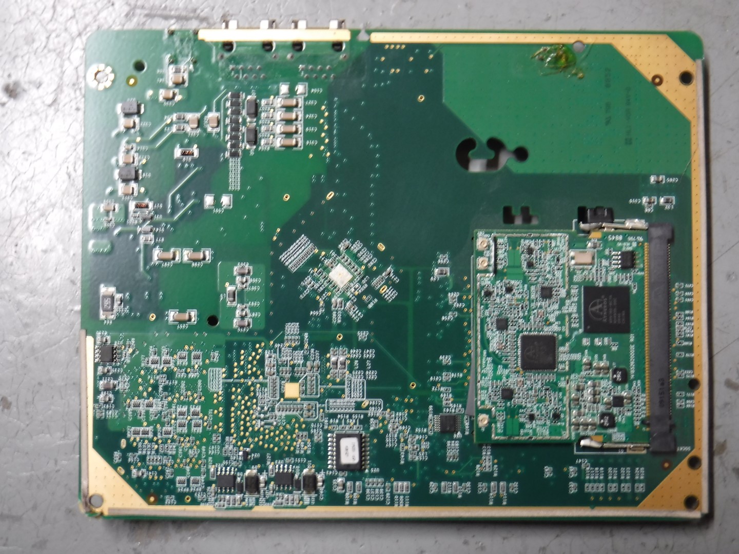

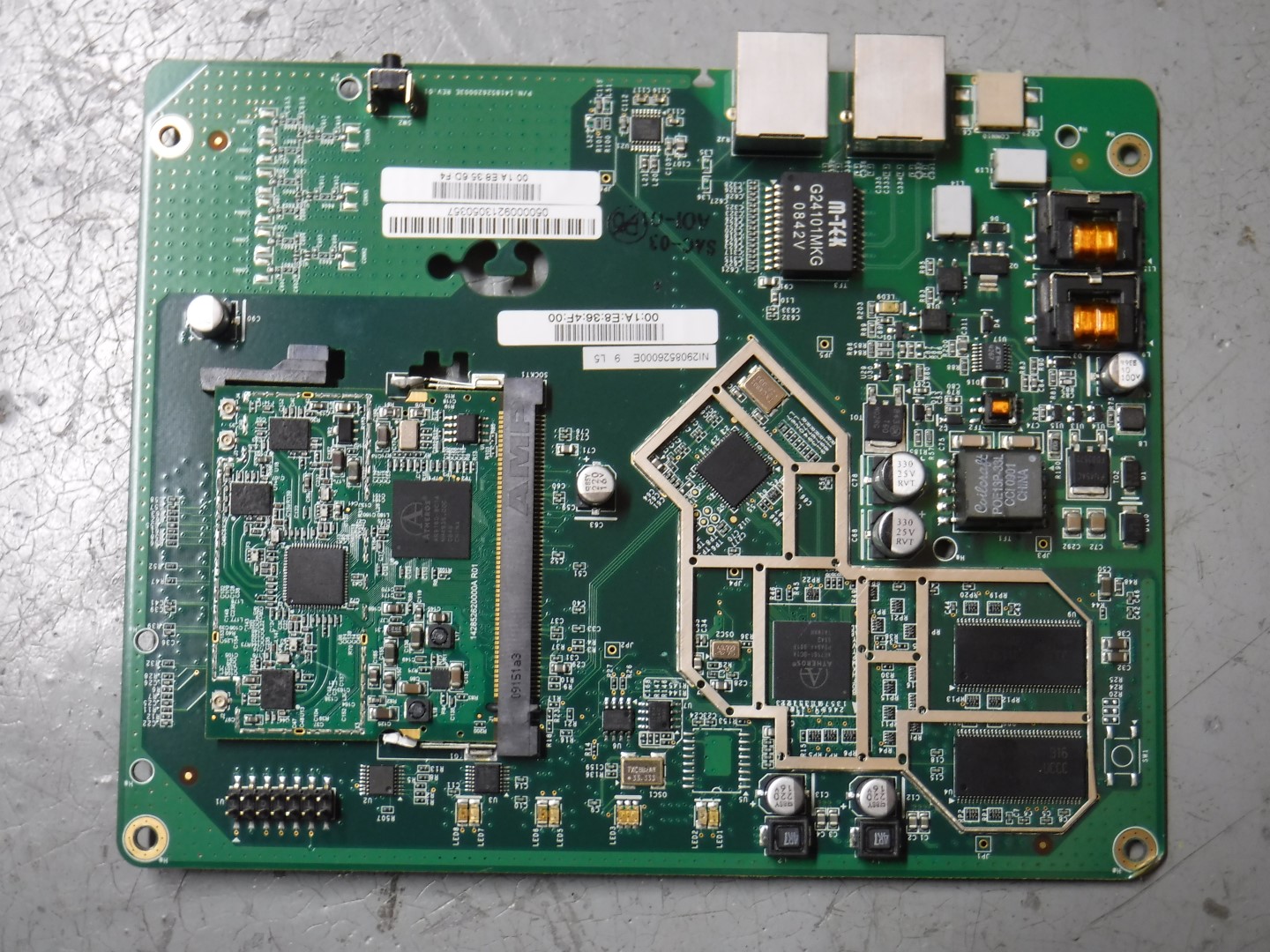

1 and 2: Siemens WAP, includes two large(ish) gold-fingered WiFi cards. Do those two cards make a difference in the grade, or should I remove them?

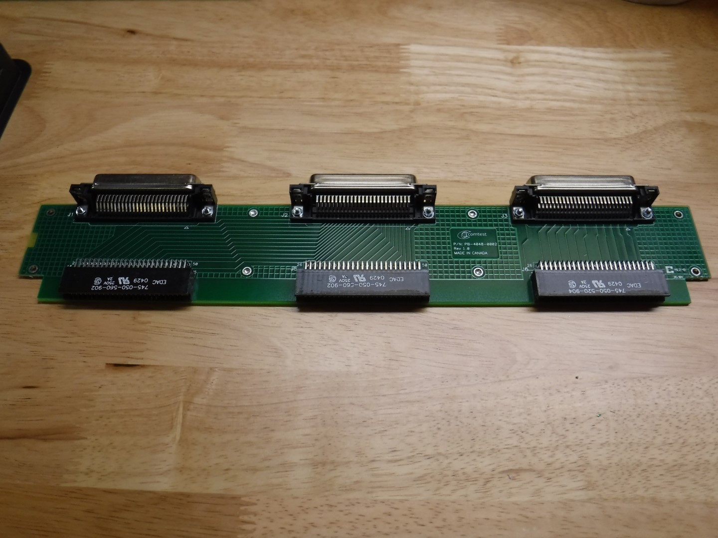

3. POE board: I'm guessing fairly low grade, def. not telecom, probably not even peripheral

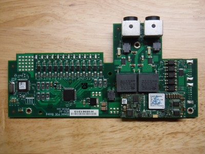

4. This board is a bunch of small transformers under metal covers.

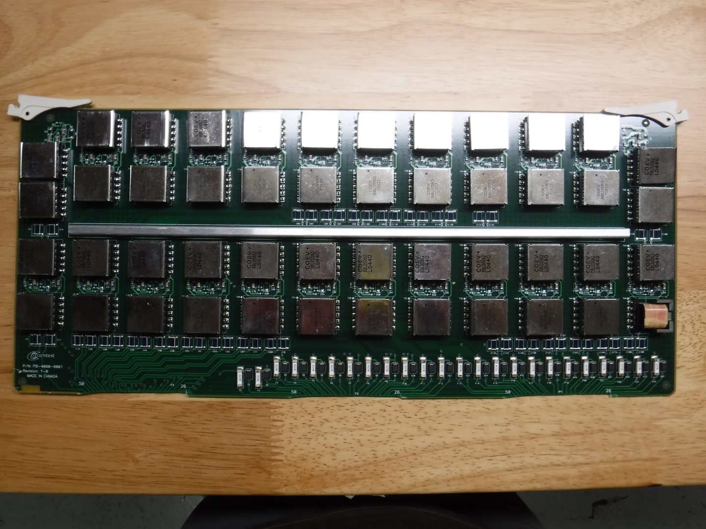

5. Not sure if this one would qualify for backplane or not.

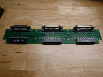

I realize the photos are going to be in reverse order.

5) Low Grade Peripheral; could go higher.
4) Midgrade; there is a chance that this could be upgraded to Low Grade Peripheral.
3) Low Grade Peripheral
1 & 2) High Grade Peripheral; definitely remove the cards since they will go as Clean Gold Finger Cards.

5 is Backplane and 3 is High Grade Peripheral.
