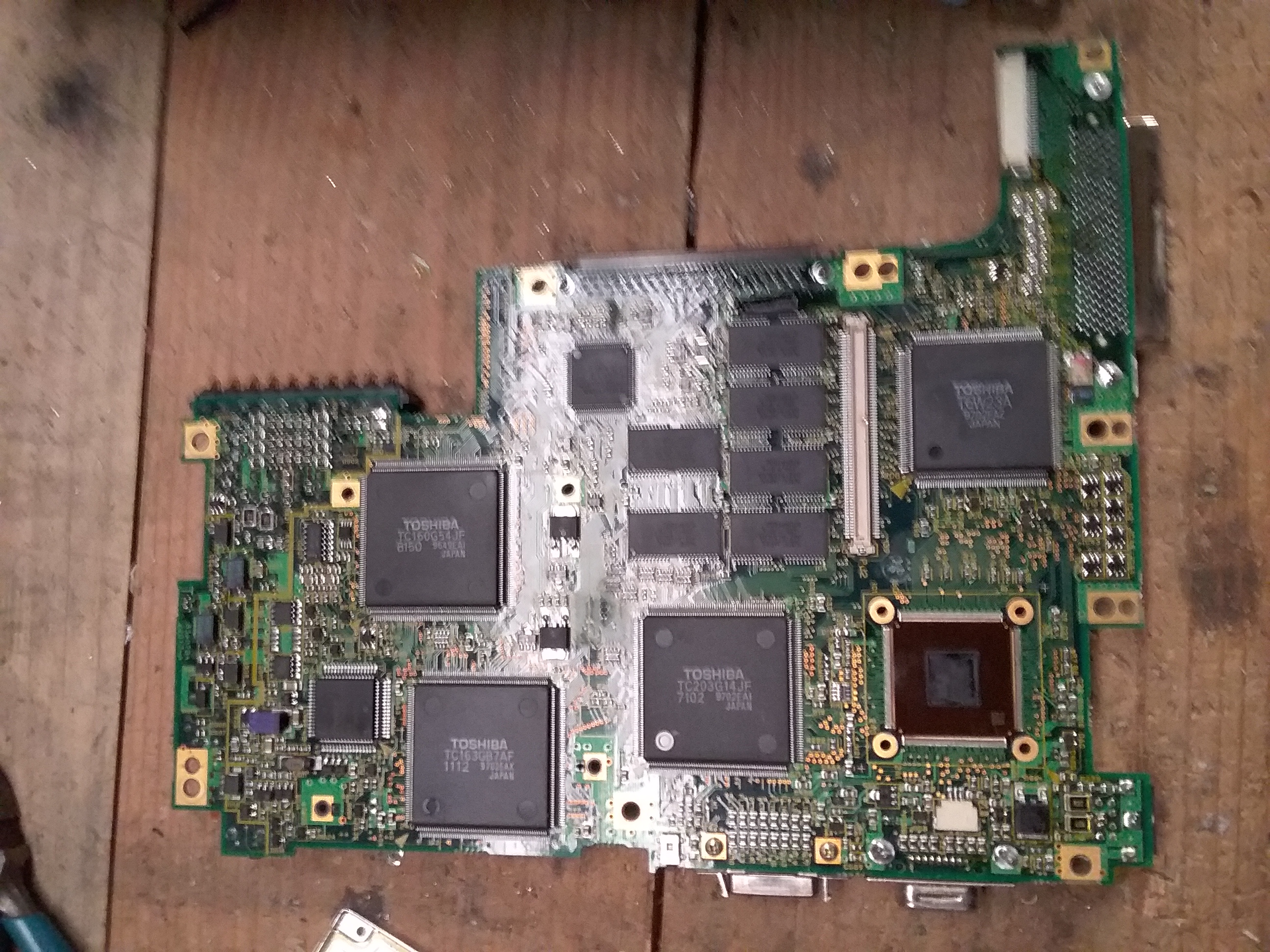

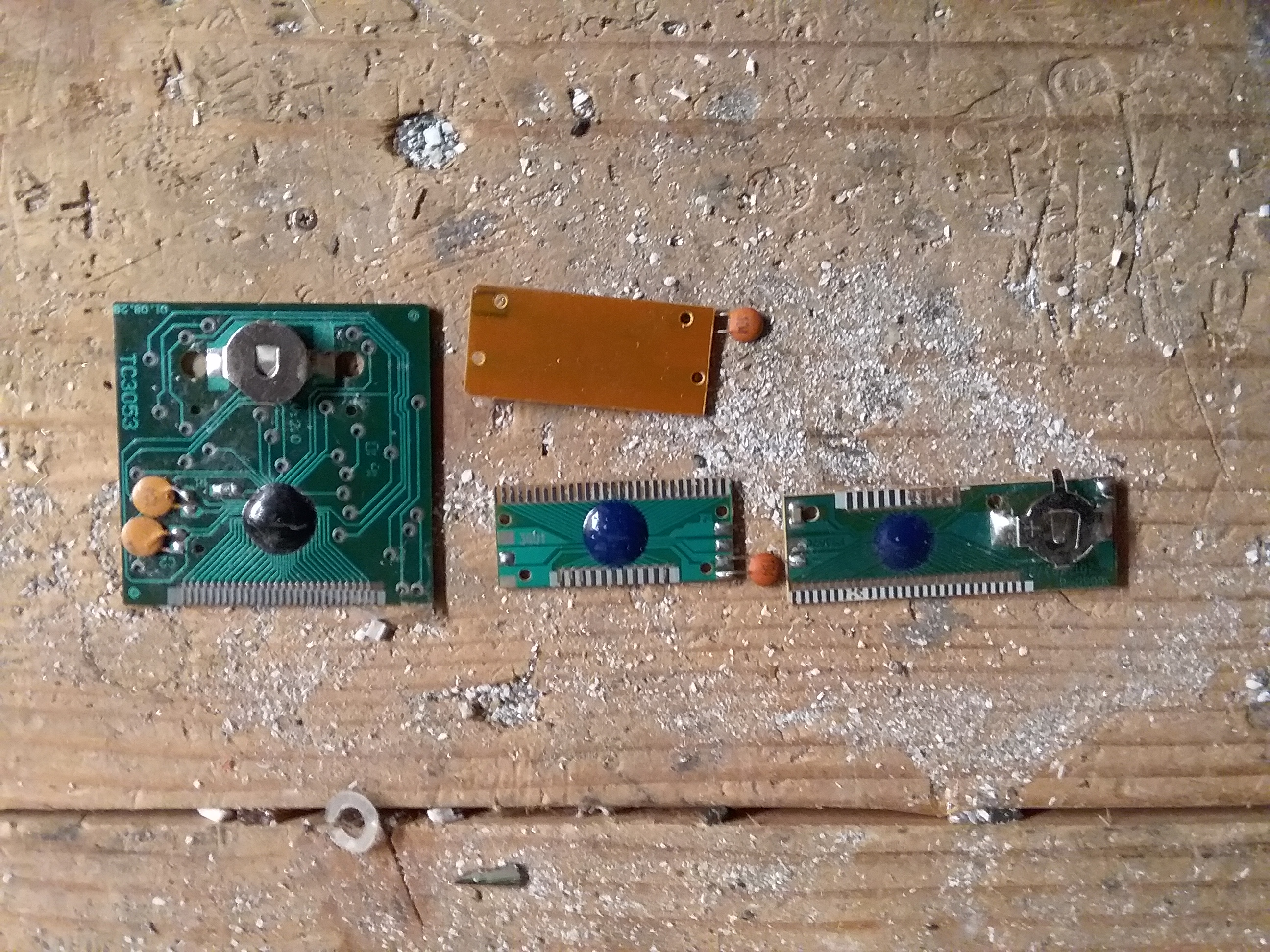

For the bottom board I was thinking peripheral, for the laptop motherboard I am assuming large socket, could I put the heat spreader in with my gold pins? For the calculator boards I was thinking midgrade. All help is appreciated.

Assuming the little brown one is front and back :
Peripheral, please remove batteries
Soldered cpu, bridge chips, controllers, internal and external connectors, and soldered ram. Looks like these should survive small socket motherboard.

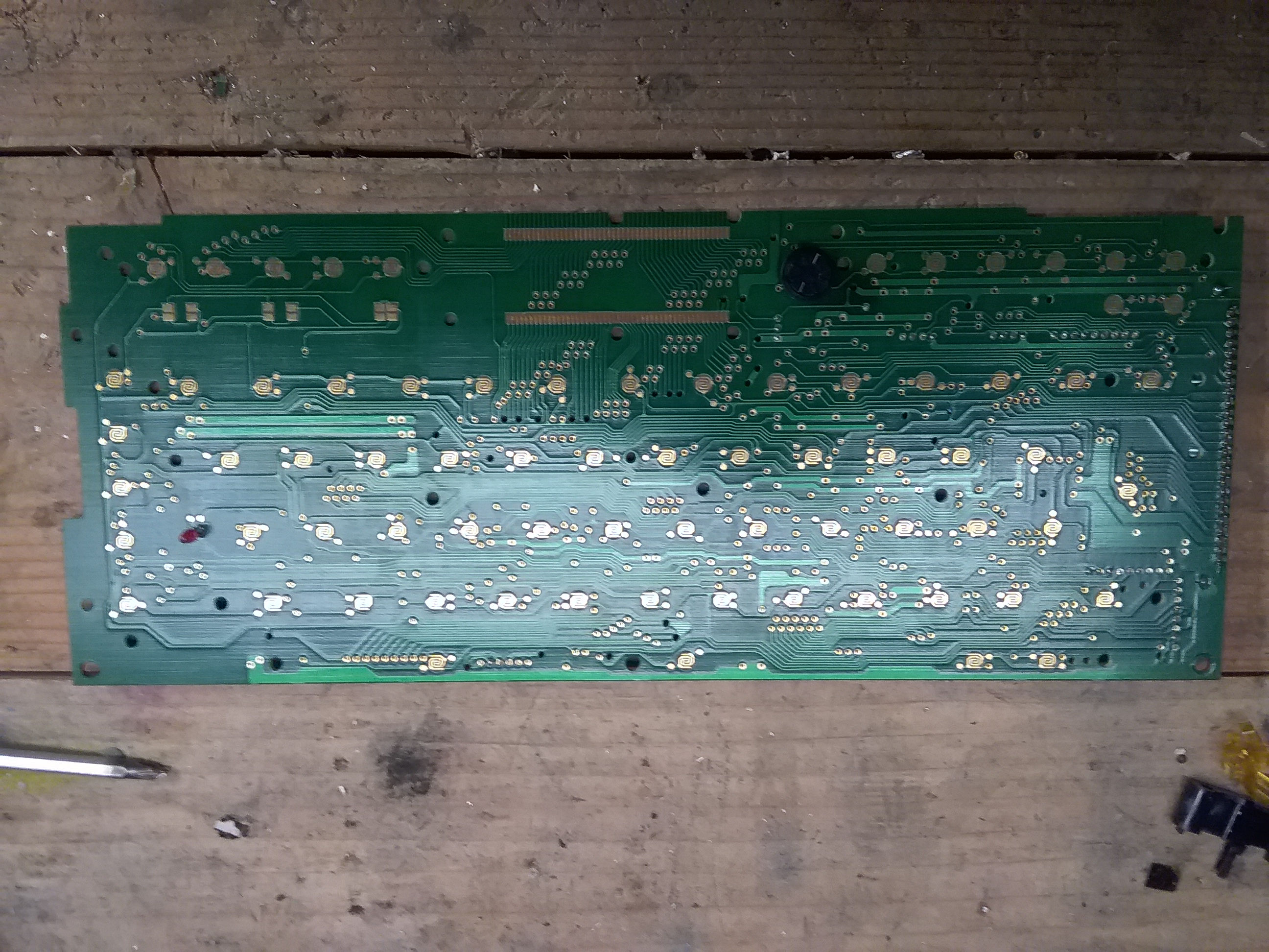

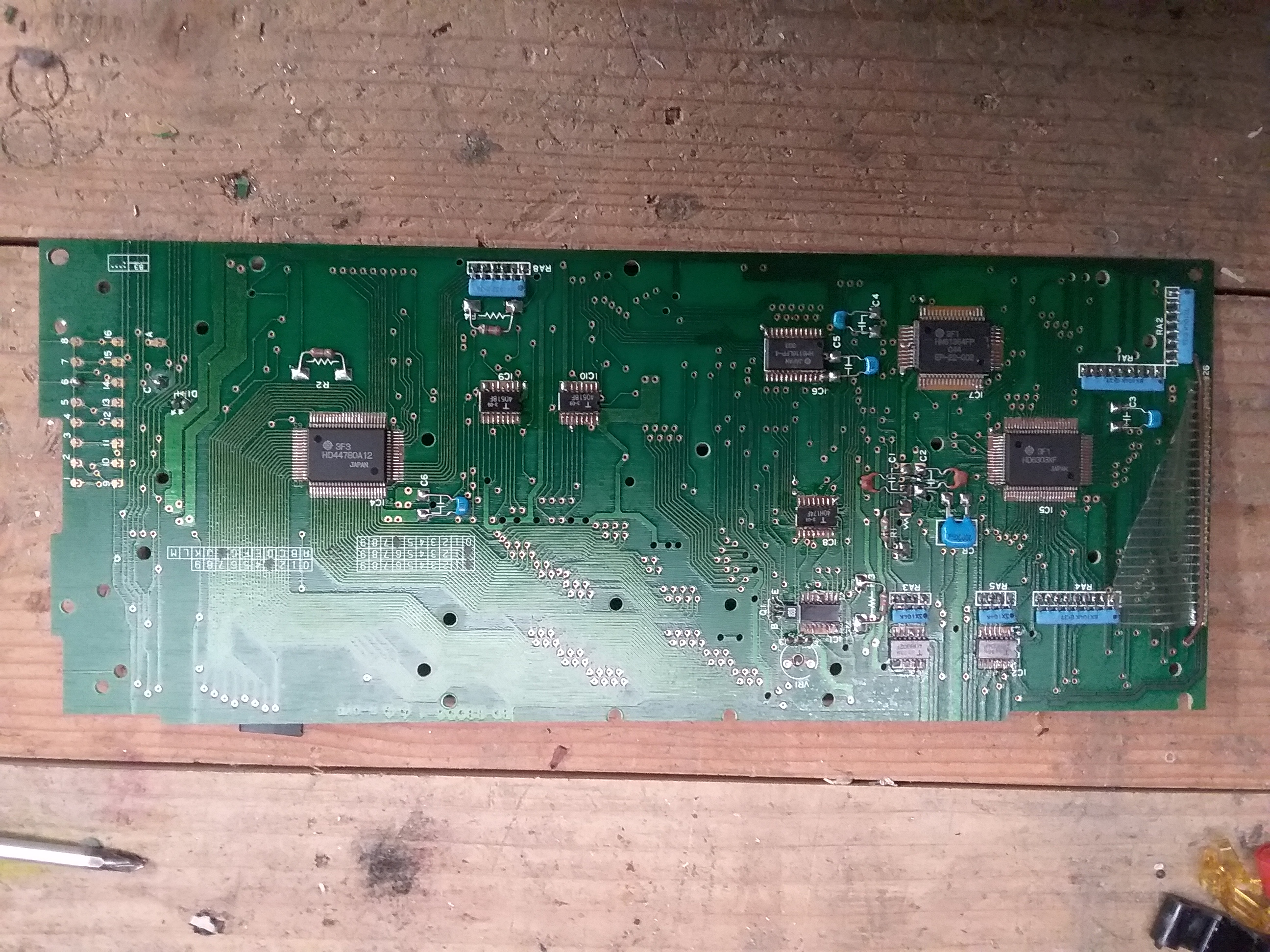

Last set
Looks like a keyboard. Flashing. No extraneous weight. Good for peripheral.

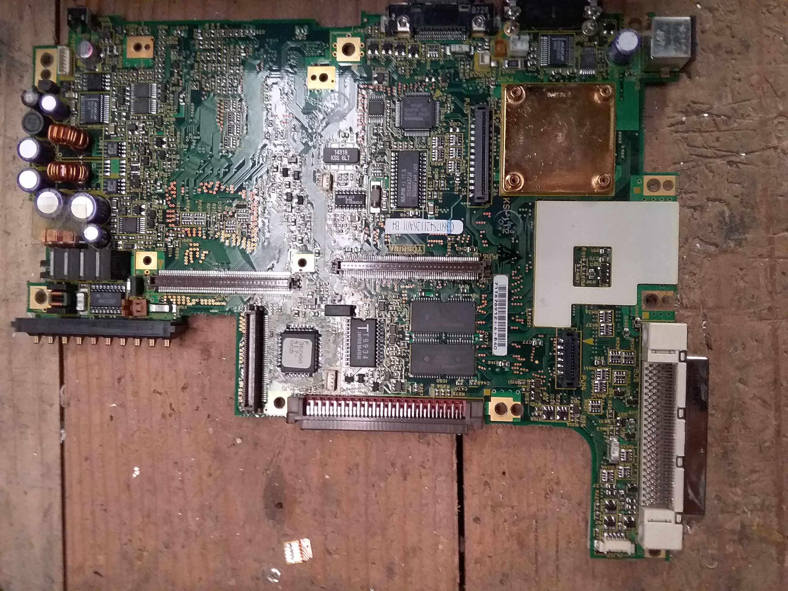

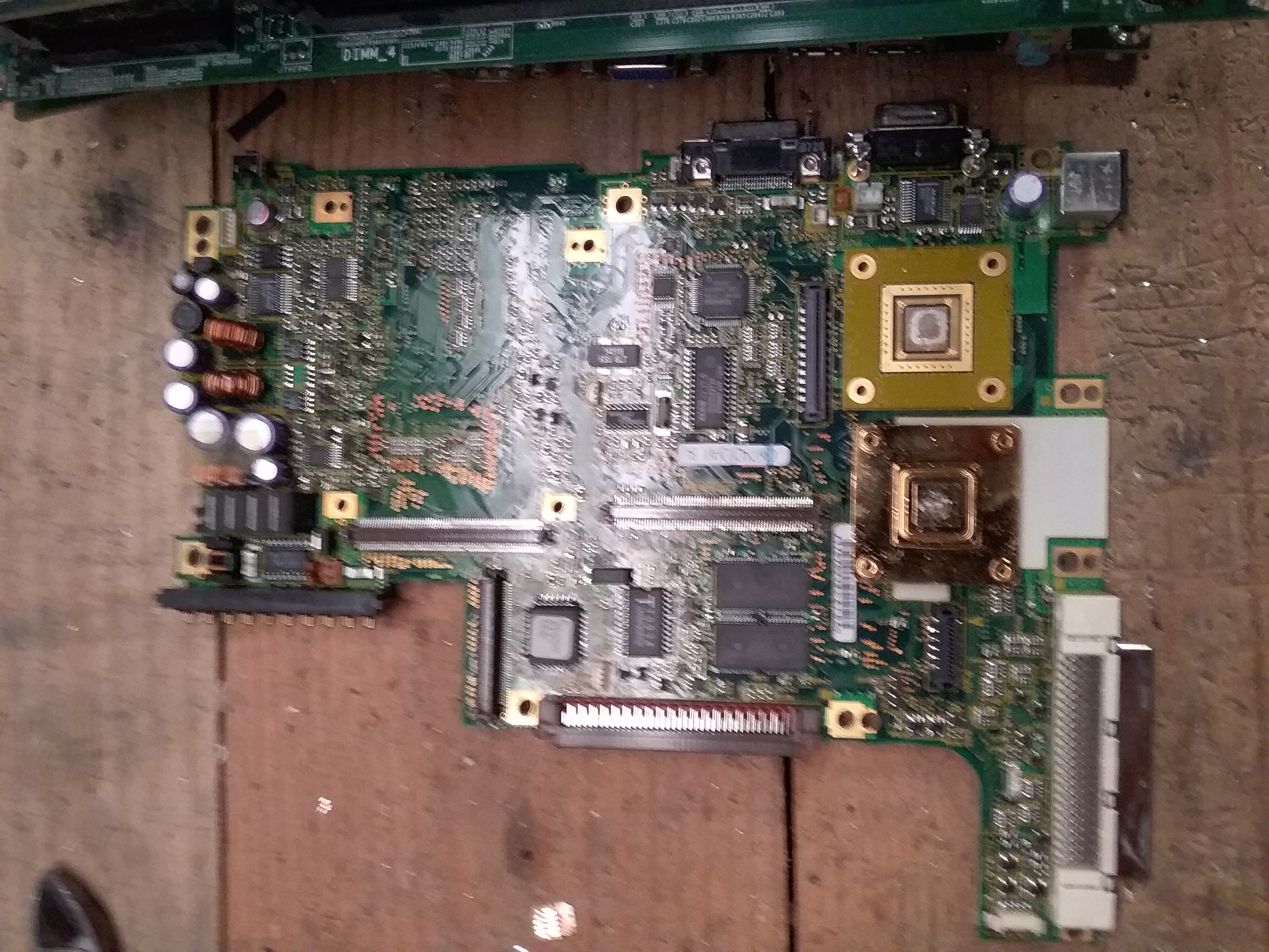

Second board came from a vintage laptop, decent amount of I.C chips with older gold bonding wire.
You might want to double-check with Chris on that one, unless grading has changed so significantly that some old laptop boards would now go as small socket.
It is a laptop motherboard, I have pulled one before from a few years back but how its buyer would grade it as scrap material regardless will all be up to him, just try and see what he says.
Good Luck.
PostPosted: Wed Aug 21, 2019 6:34 pm
Rubble has a point. This is right at the edge between a full fledged laptop board (large socket) and a high end modern netbook or embedded board (small socket).
I’ve had similar boards, from all the above, fluctuate across the threshold. While I still suggest quoting as small socket I’d also suggest bundling them together separate from the other stalls as they could get an upgrade.

I have put it aside to ask, it came out of a old Toshiba laptop.
