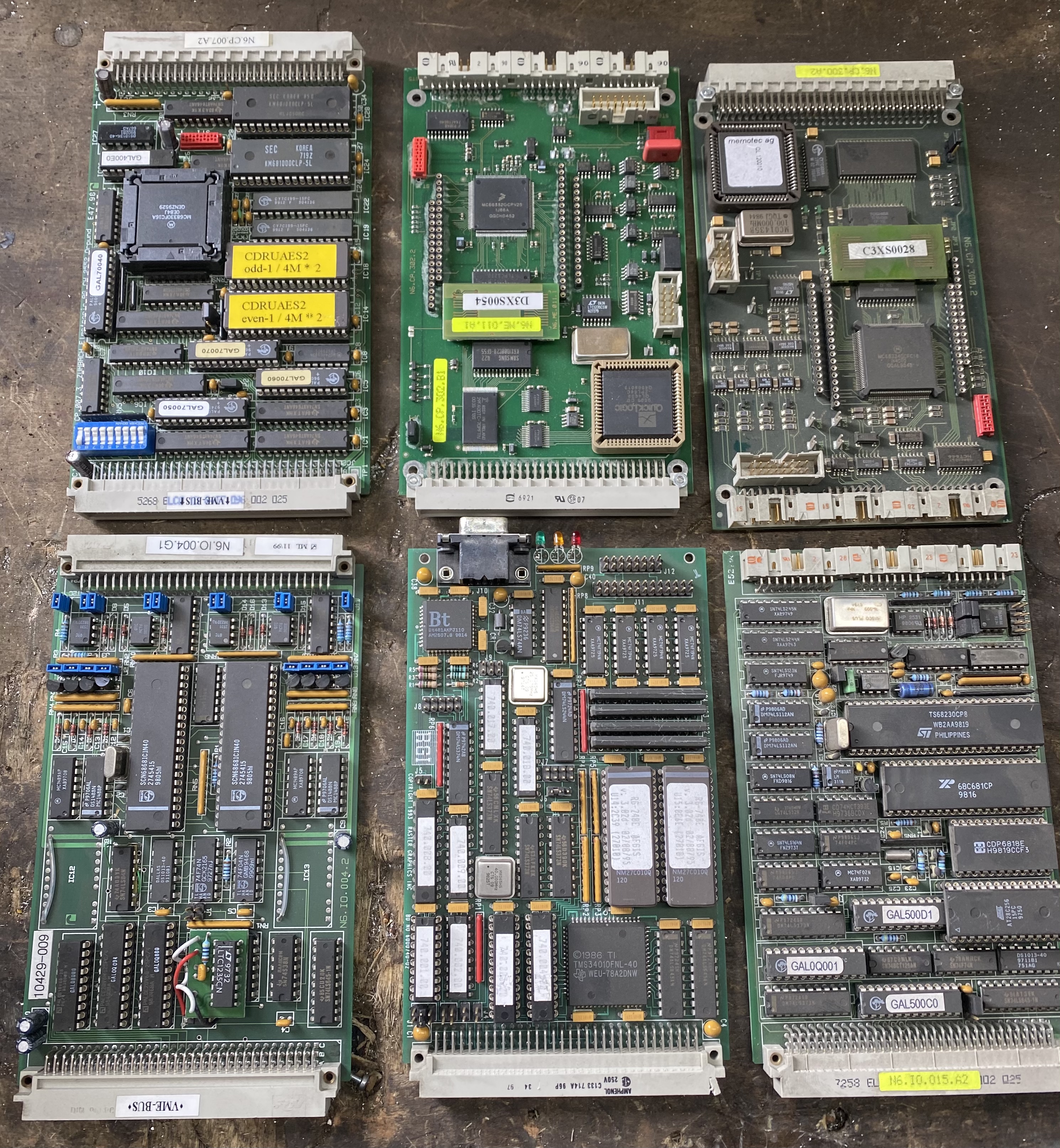

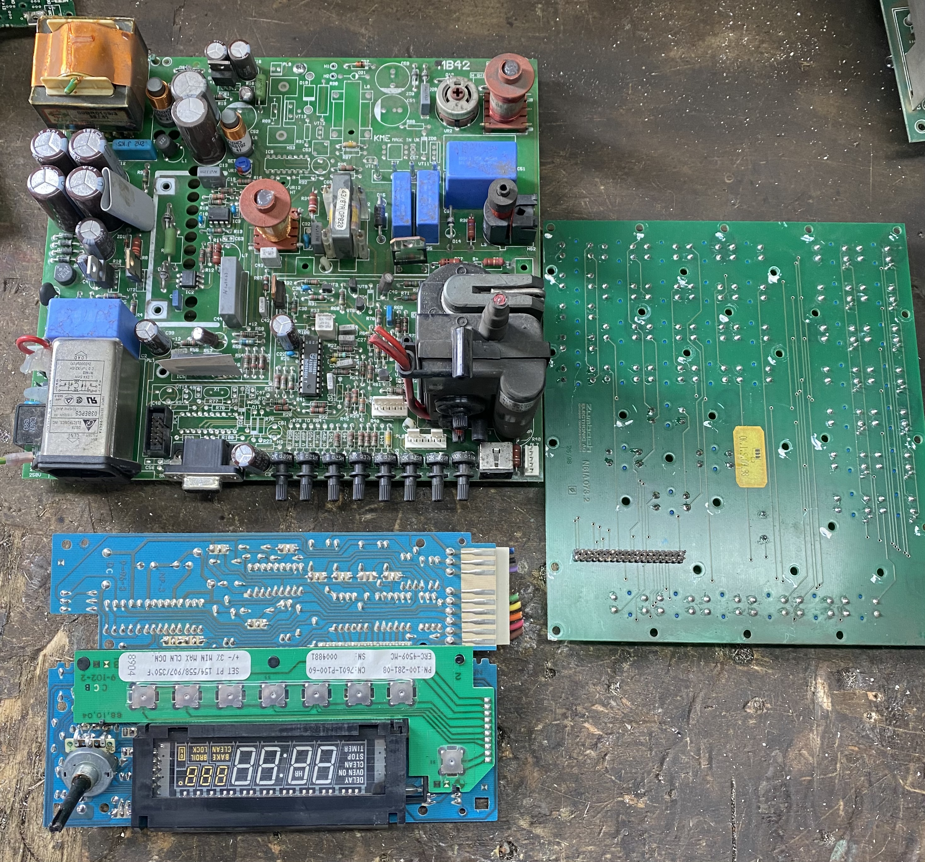

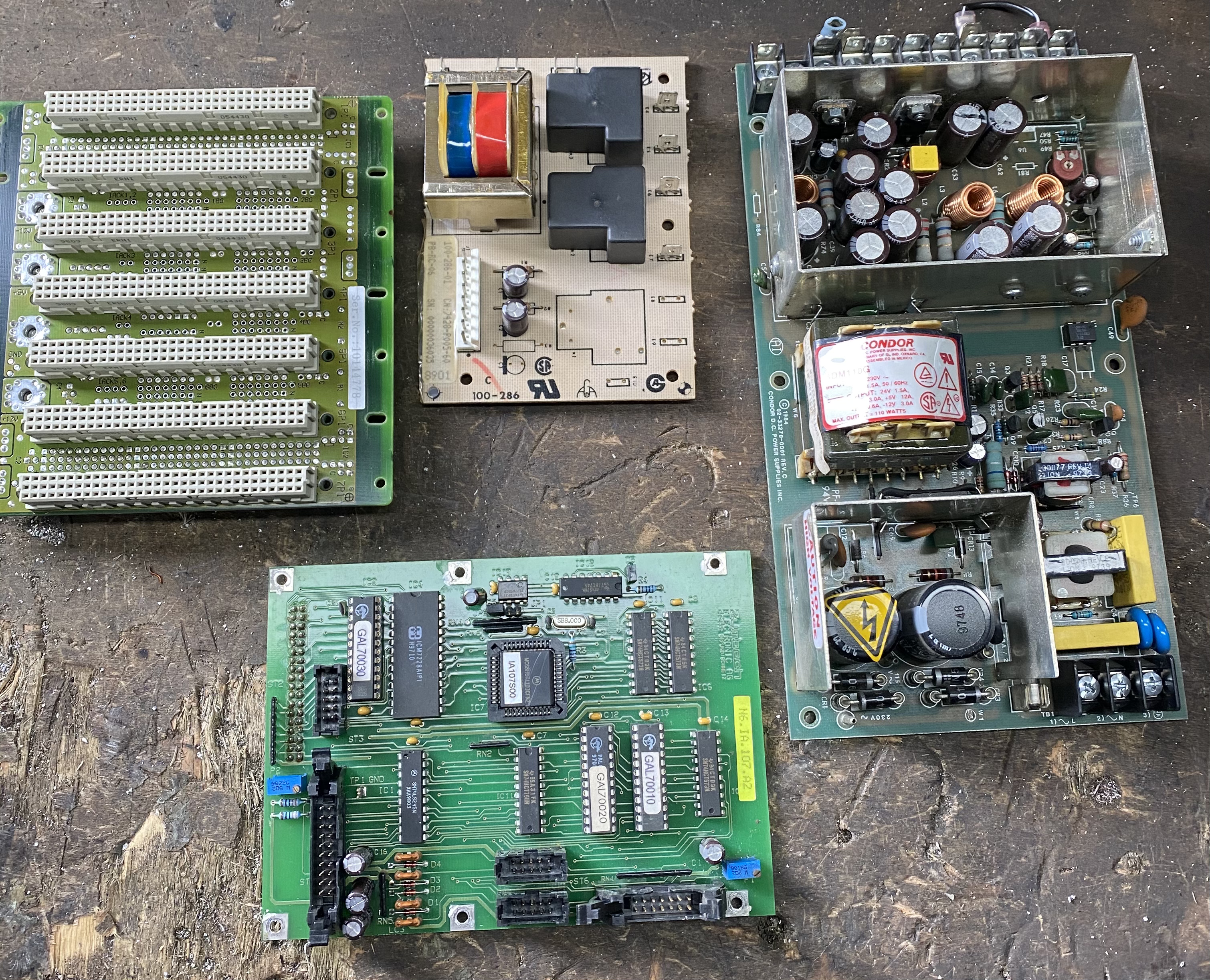

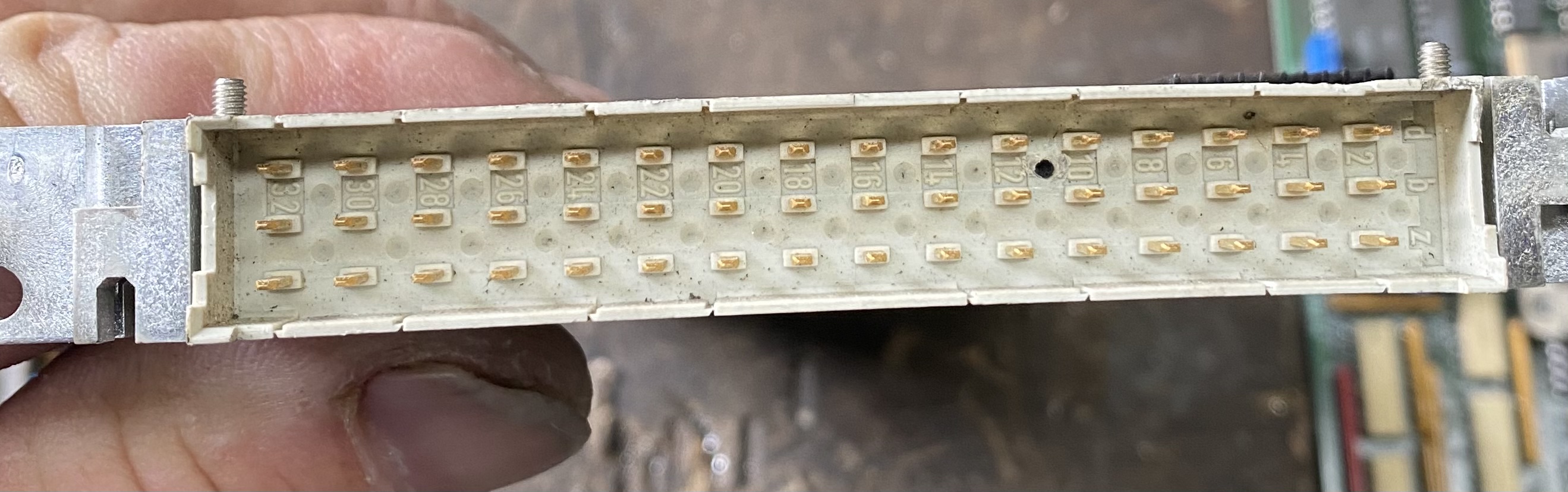

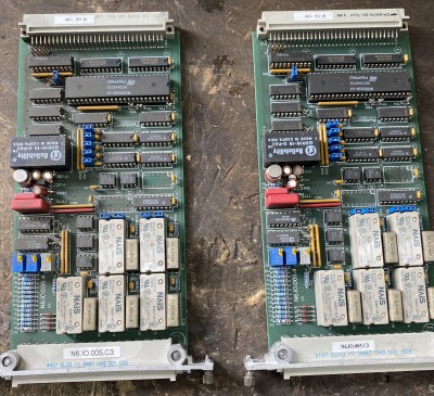

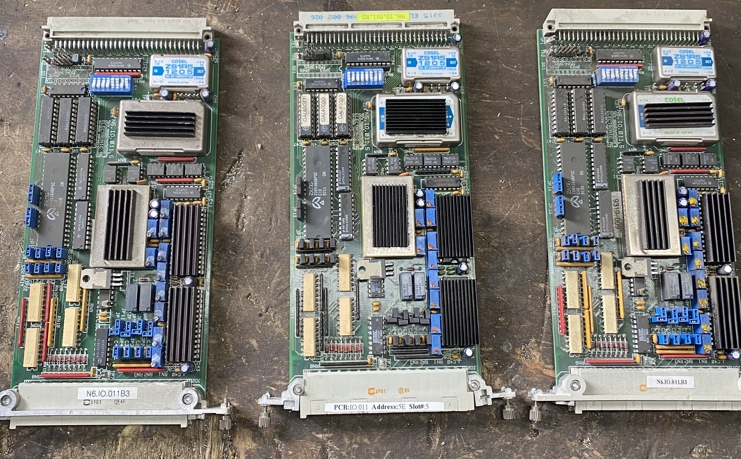

Are these worth sending in?

1st Picture: All Midgrade
2nd Picture: Low Grade Peripheral/Midgrade/Midgrade/Midgrade/Midgrade
Midgrade/Midgrade/Low Grade Peripheral/Midgrade
Midgrade
3rd Picture: Both High Grade Peripheral
4th Picture: If you took off those heat sinks, they could probably go as High Grade Peripheral.
5th Picture: High Grade Telecom/Low Grade Telecom/Low Grade Telecom
High Grade Telecom/High Grade Telecom/High Grade Telecom
6th Picture: Backplane/Low Grade/Low Grade

Midgrade and Low Grade Boards aren't usually worth sending. Peripheral boards and above are usually profitable to ship.
