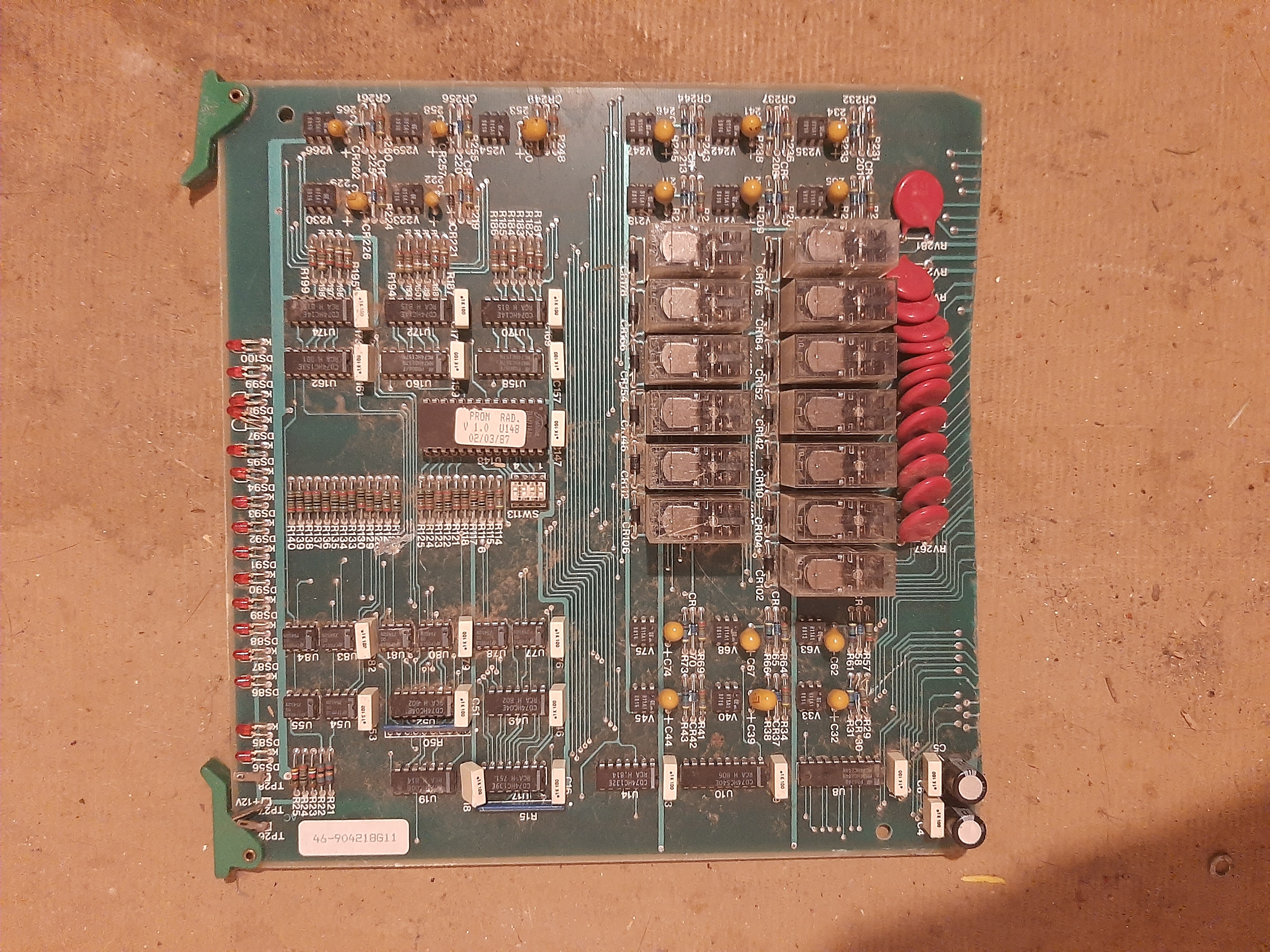

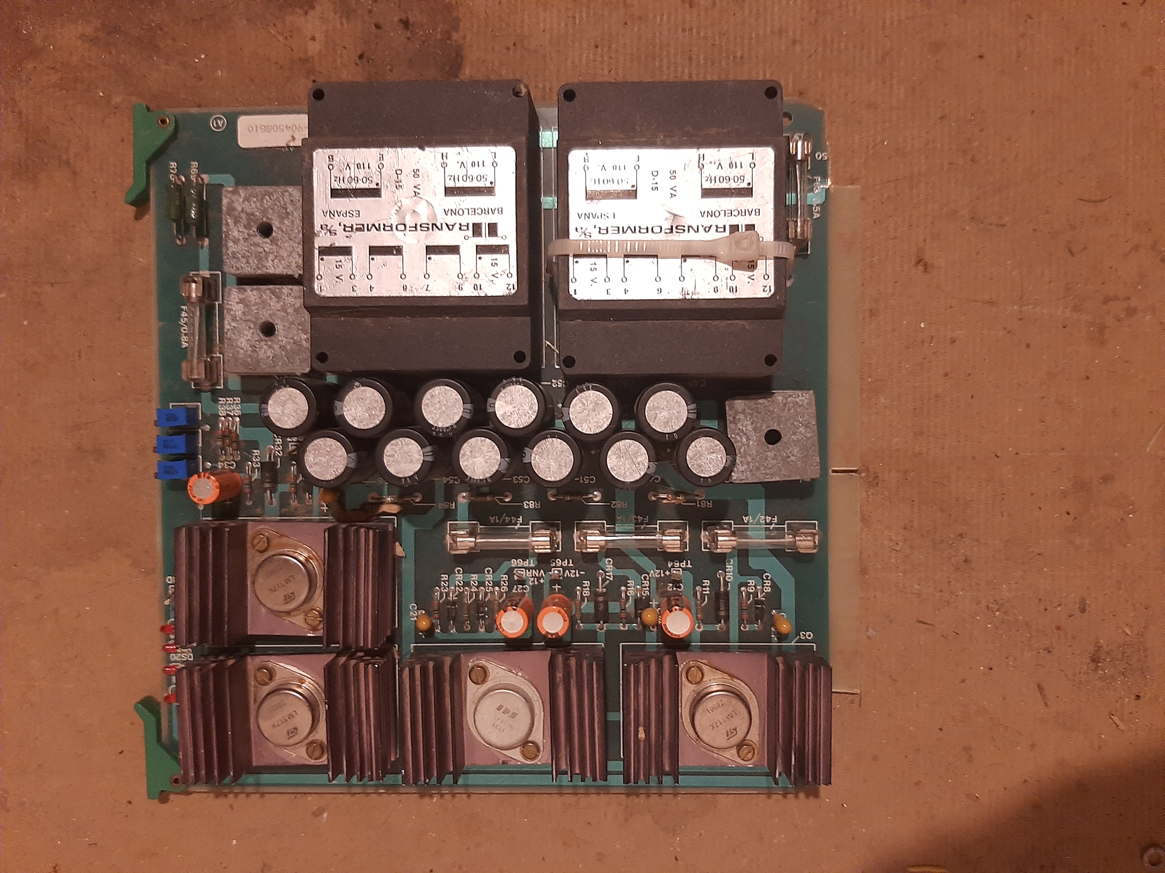

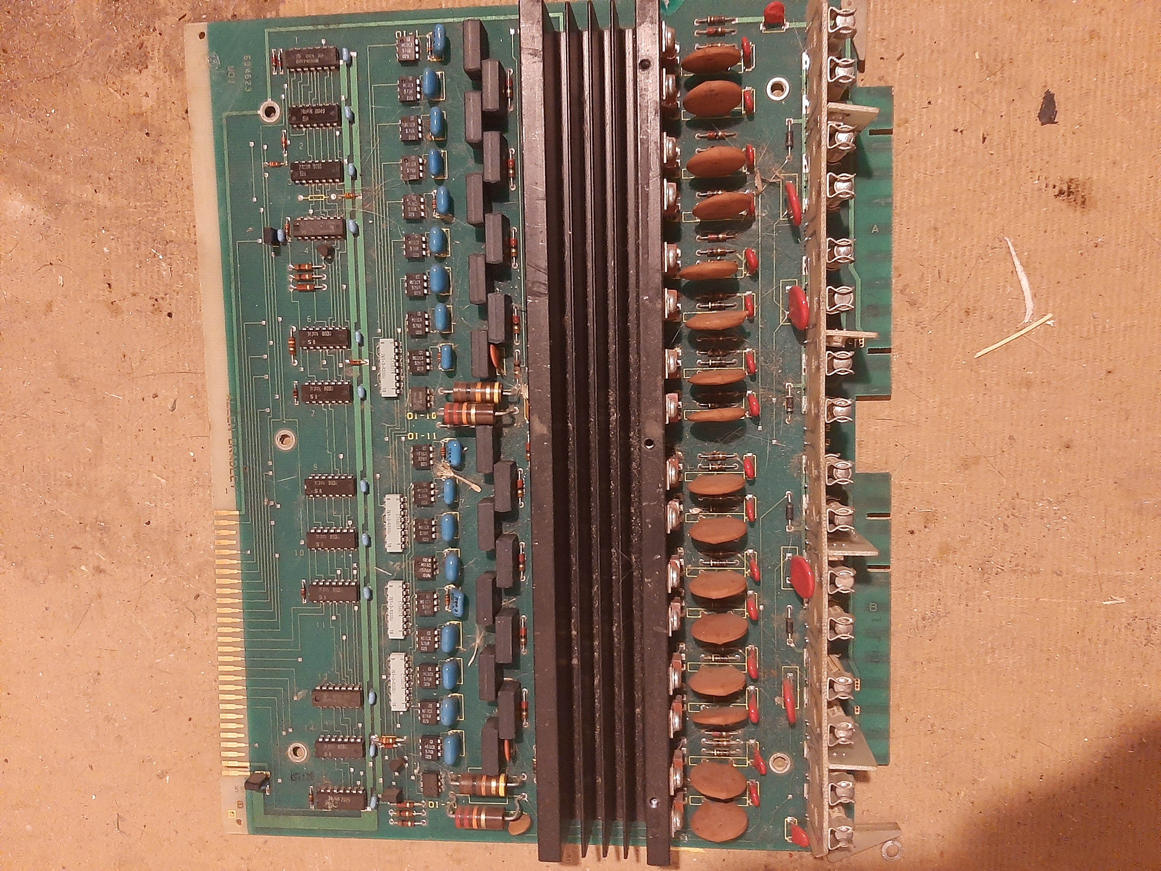

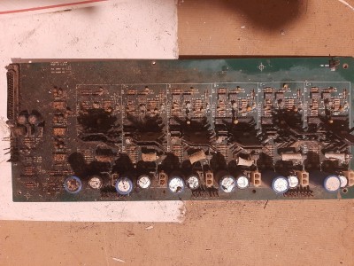

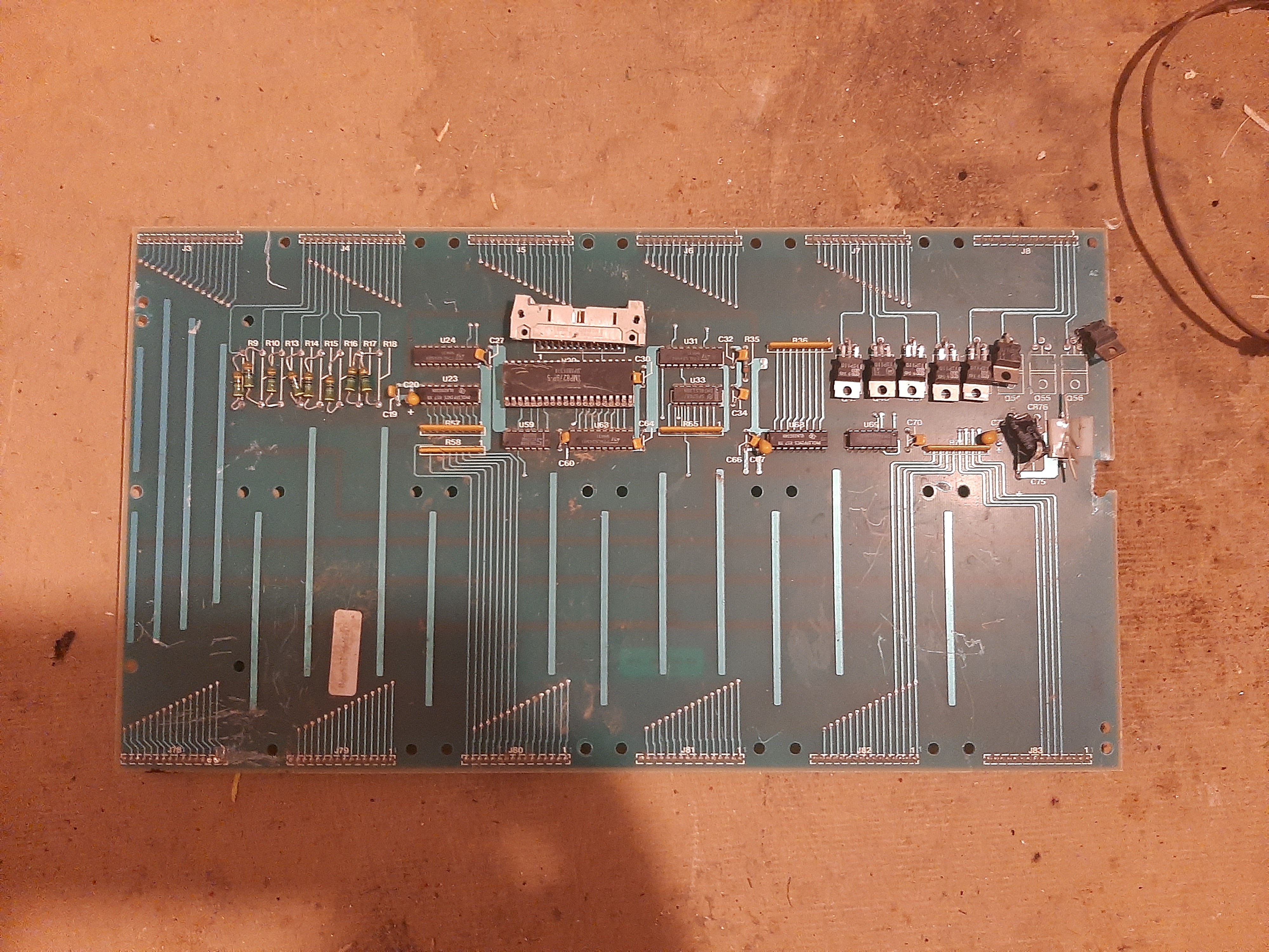

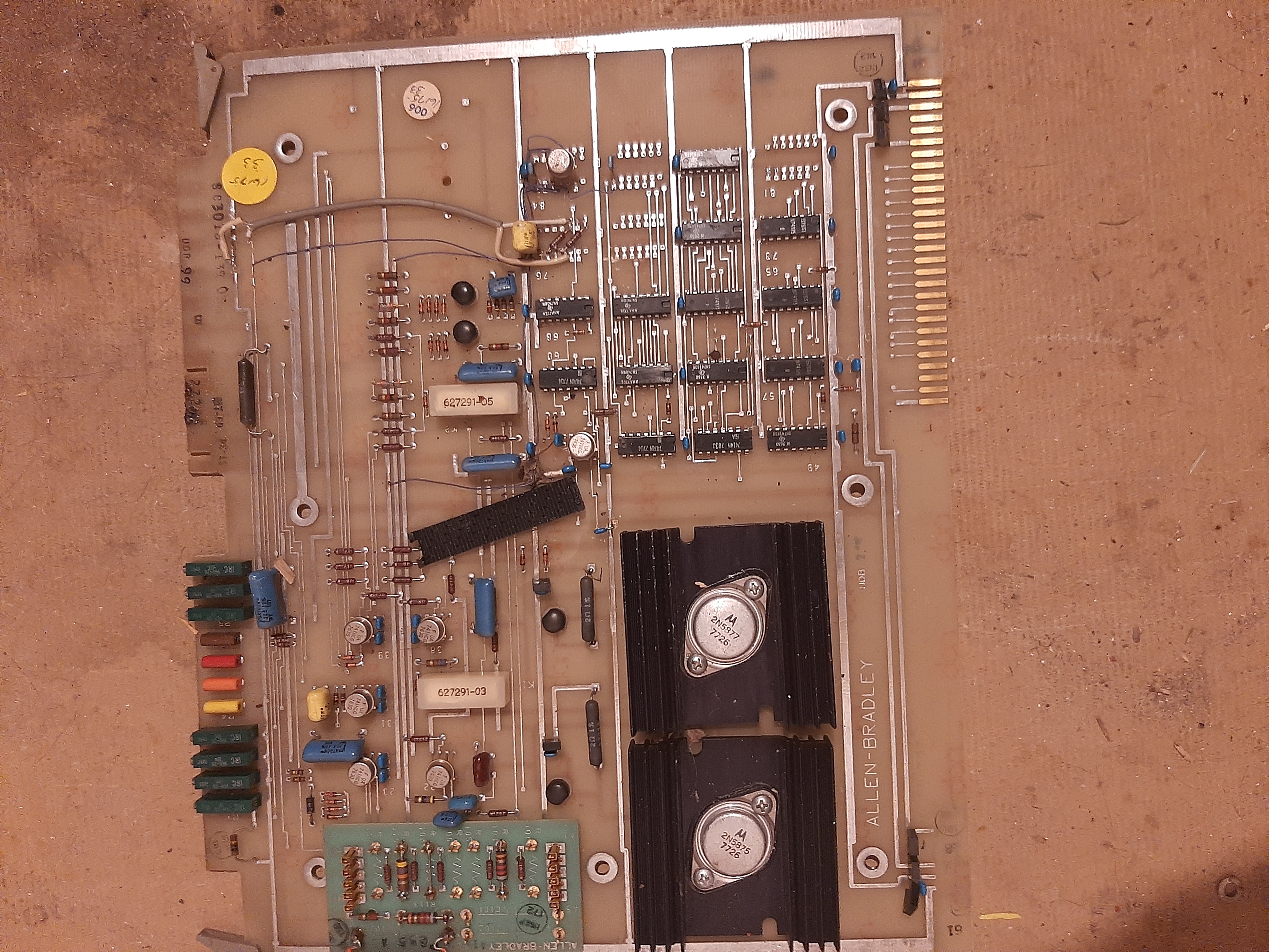

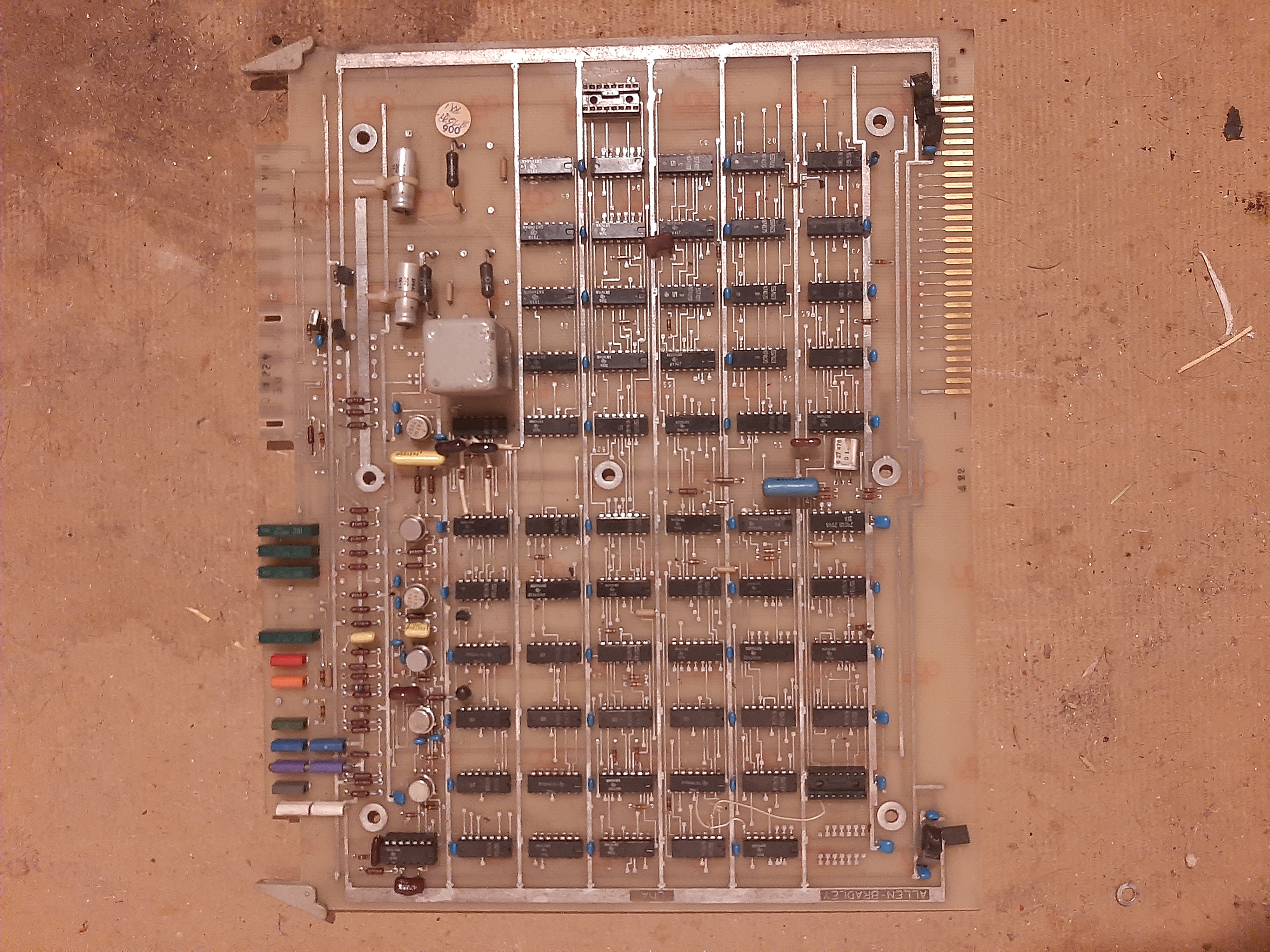

Wondering what this boards would go as
PostPosted: Mon May 31, 2021 7:35 pm
Posts: 2707
1-2. Midgrade or low peripheral due to the aluminum heatsinks and fuses (assuming they're glass). Get the heatsinks/fuses off and you may be looking at high peripheral
3. Midgrade, I don't think there's any way around it
4. Low peripheral, too bad the gold fingers are cut off
5. Midgrade, possibly better but again the aluminum weight keeps the grade lower
6. High Telco, I think there's enough IC population along with the gold fingers (am I seeing more fingers on the back?)
7. Low Peripheral, there's a lot of empty board so I don't think it can go higher.

PostPosted: Mon May 31, 2021 10:25 pm
Posts: 557
On board 1 I see 3 gold cap chips, they look really dirty and rust covered so they are hard to see in the picture. So that will have some effect on the grade.
PostPosted: Mon May 31, 2021 11:15 pm
Posts: 2707
Good catch, even after you said it I had trouble finding them.
PostPosted: Thu Jun 03, 2021 10:18 am
Joined: Thu Jul 27, 2017 2:05 am
Posts: 12
On board 3 them black boxes are extremely heavy so should I remove them
PostPosted: Thu Jun 03, 2021 10:21 am
1) Still checking with Chris
2) Migrade
3) Midgrade
4) High Grade Peripheral
5) High Grade Peripheral if you remove the black heat sinks.
6) Still checking
7) Low Grade Peripheral
PostPosted: Thu Jun 03, 2021 12:15 pm
Chis says:
Boardsort wrote:
1) Wow, I would not have seen those under the crud. If you clean all of the metal (and the crud) and the tall blue and/or black capacitors, then yes, that would be a Gold Cap Chip Board.
6) If you pull that metal box off, I will buy the this board as High Grade Telecom.
