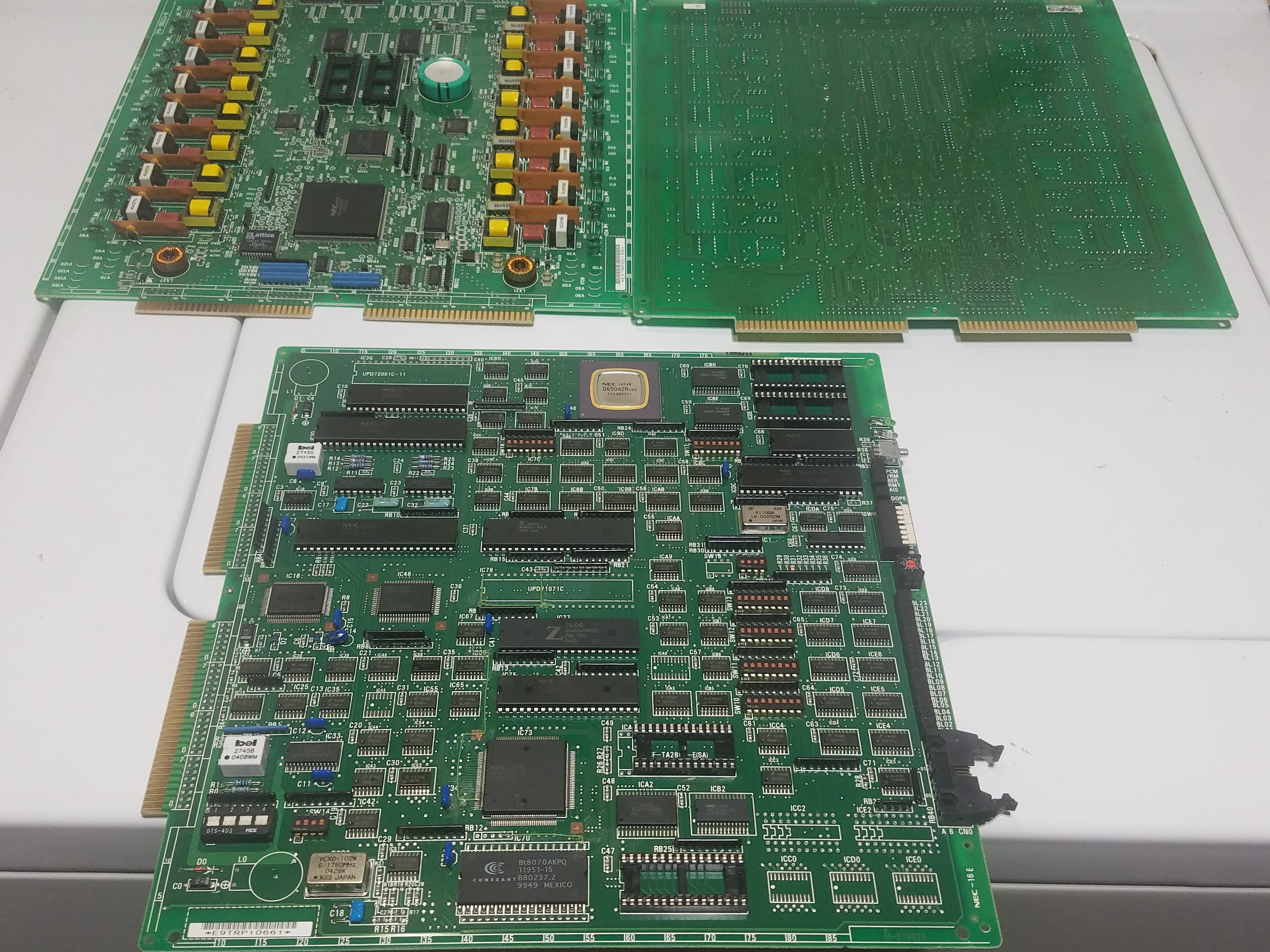

Please grade these boards

The board with the ceramic chip should definitely be High Grade Peripheral. I think you can remove the fingers and still get the grade. The other board is either High Grade Peripheral or Low Grade Telecom, not sure which. I'll check with Chris.

I think ccussins might have meant high telco on the ceramic chip board.
PostPosted: Sat Jun 12, 2021 9:26 pm
Yeah, that's what I meant to say. I'm just so used to typing "High Grade Peripheral". :)

Chris said:
Boardsort wrote:
Technically, you are not to remove any gold from a board without it being a downgrade, particularly on such a higher paying grade as a Gold Cap Chip Board, which this is.
The other board would be Low Telecom as is, but the green battery must be removed. If the fingers are trimmed it, would be High Peripheral, again without battery.

The green cylinder in question looks to be a capacitor but if you can't confirm that then better to remove it as Chris advised.

Green capacitor removed, Thank you
