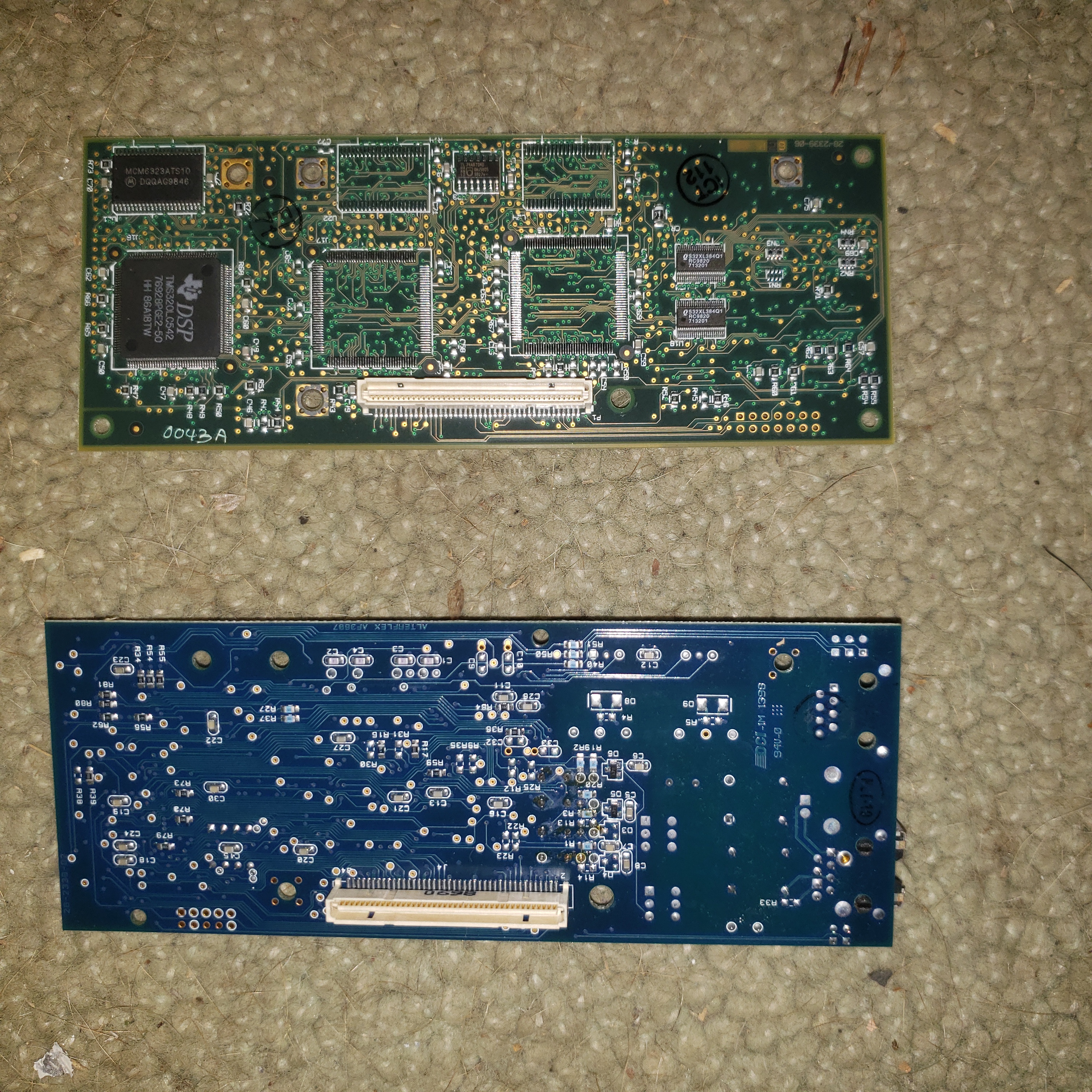

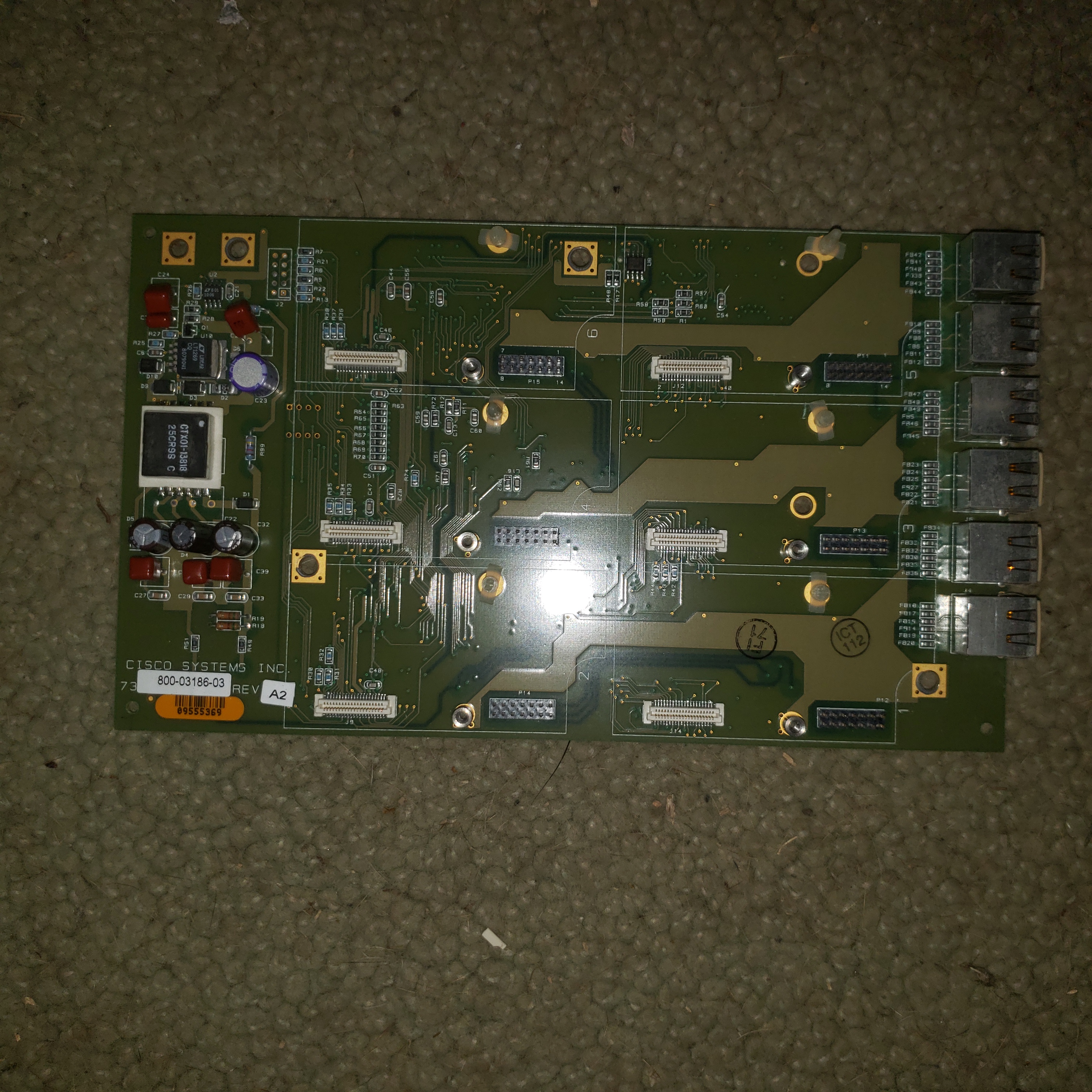

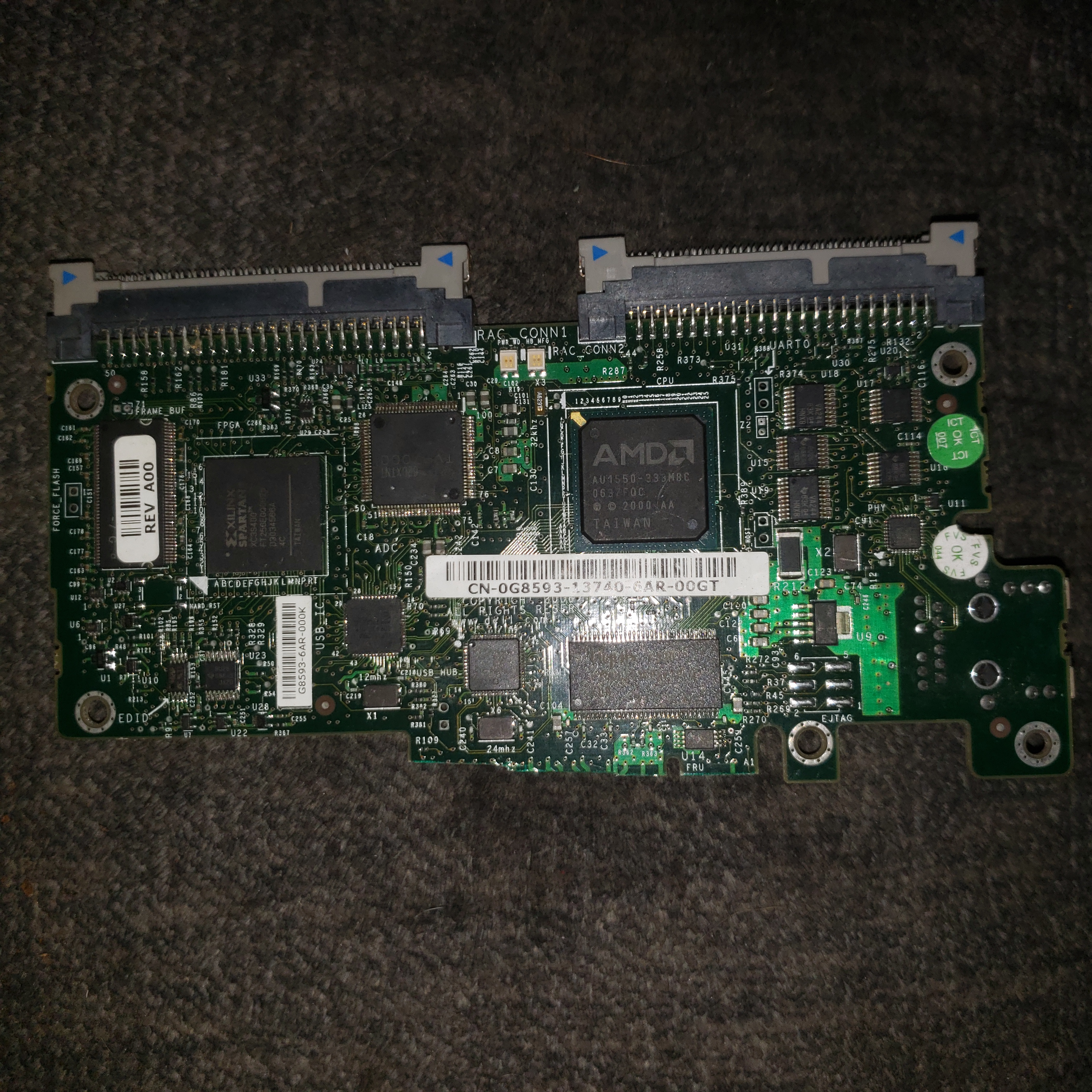

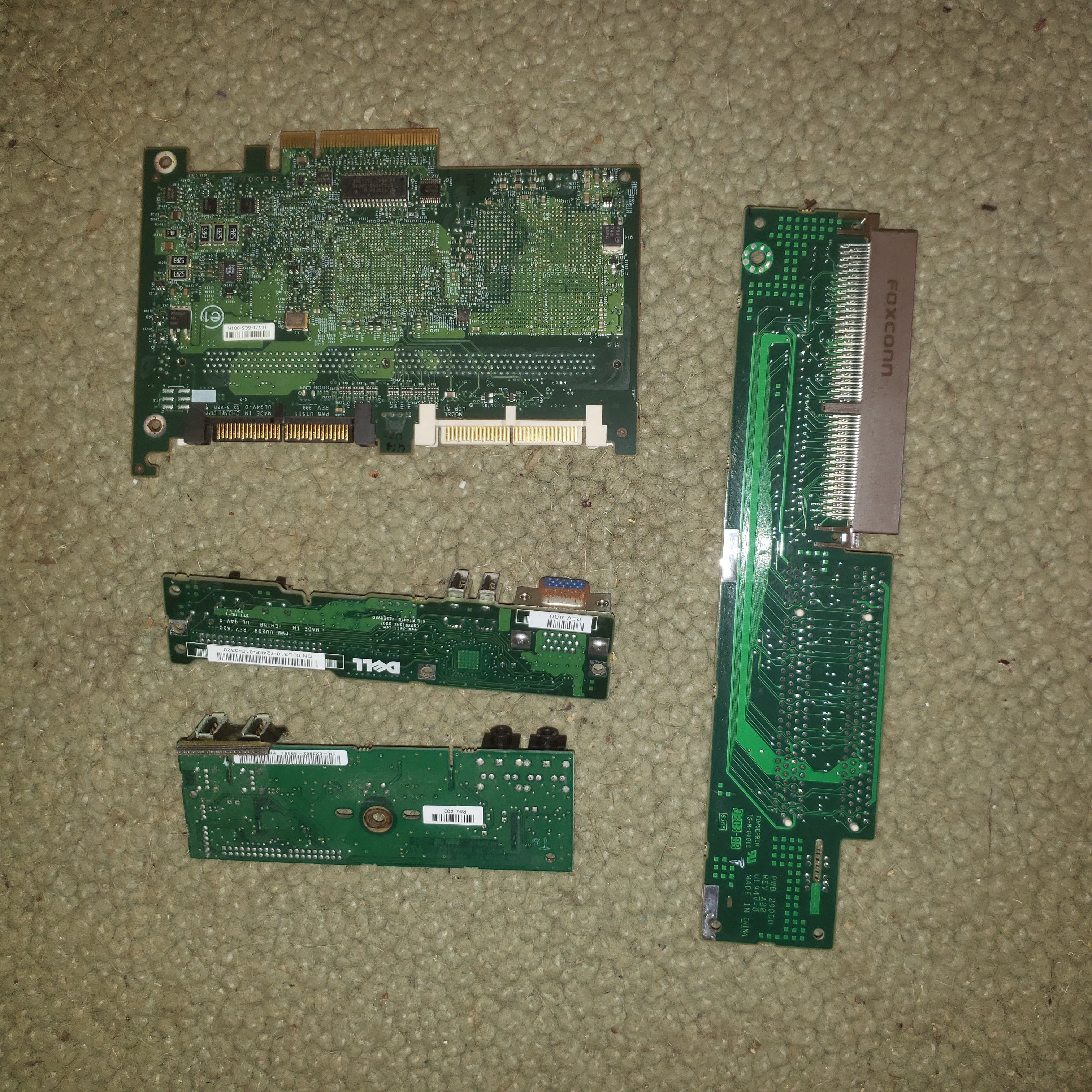

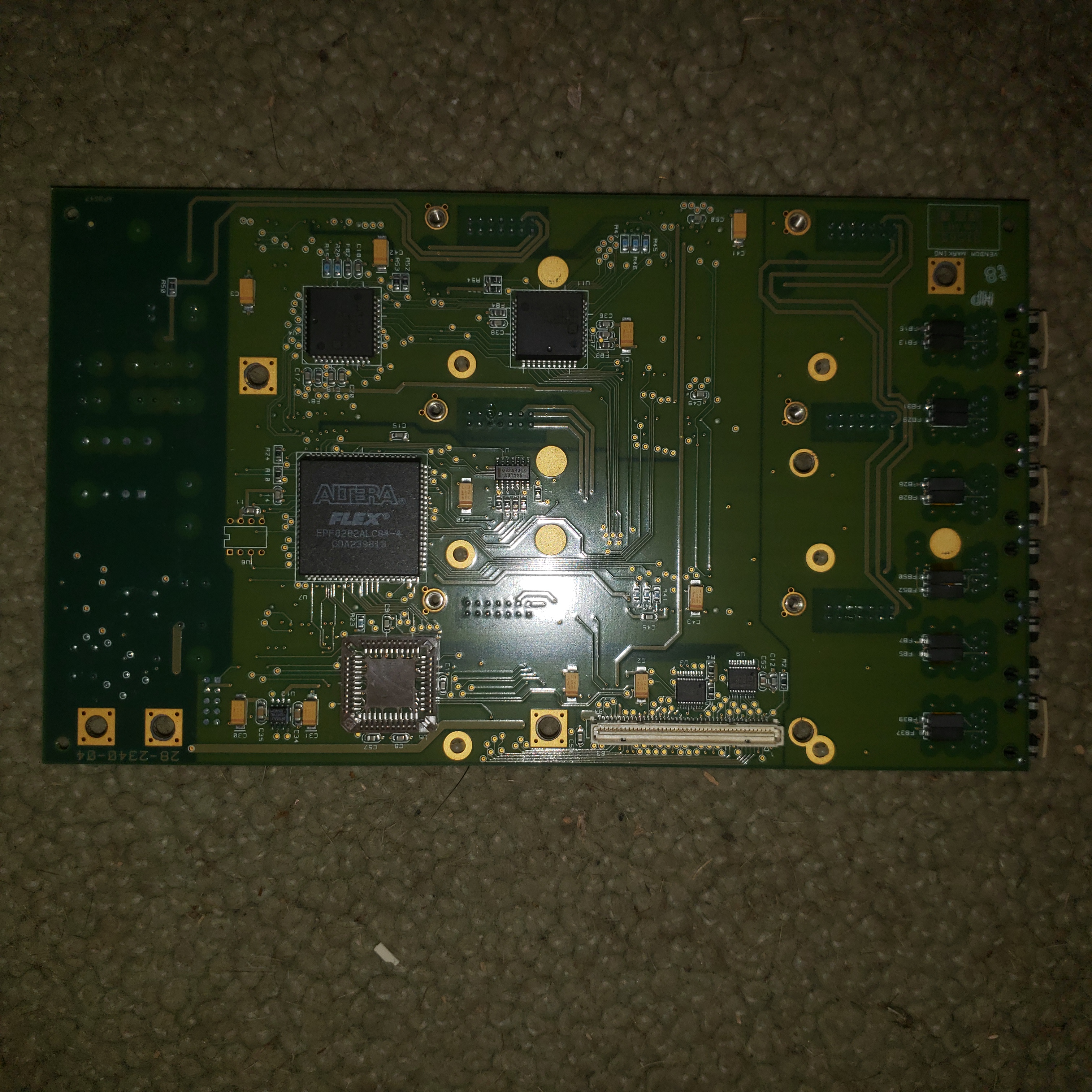

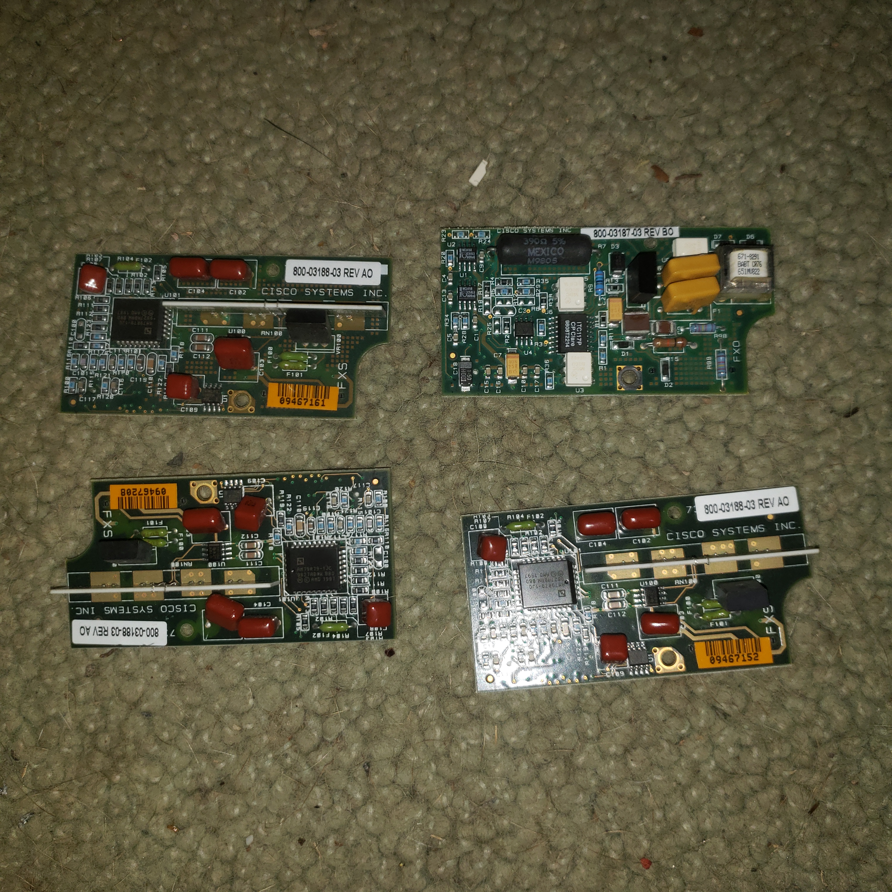

I am trying to understand what makes a board each different type. Telecom, peripheral, how removing something upgrades the board.im trying to learn because I have alot of e scrap to get through. Once I get a understanding I wont have to ask so many questions. I appreciate you all for taking time to help. I apologize for there being so many.

1. Low telecom, but you will need to take it out of the housing
2. My guess will be all midgrade
3. Both low telecom
4. Is 5 the other side of the same board? If so, high peripheral. If not, midgrade.
5. High peripheral
6. High telecom
7. High peripheral
8. A. midgrade, B. High peripheral, C. Gold finger card D. Backplane
