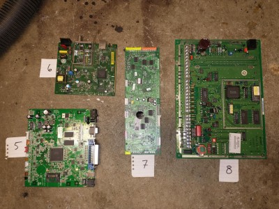

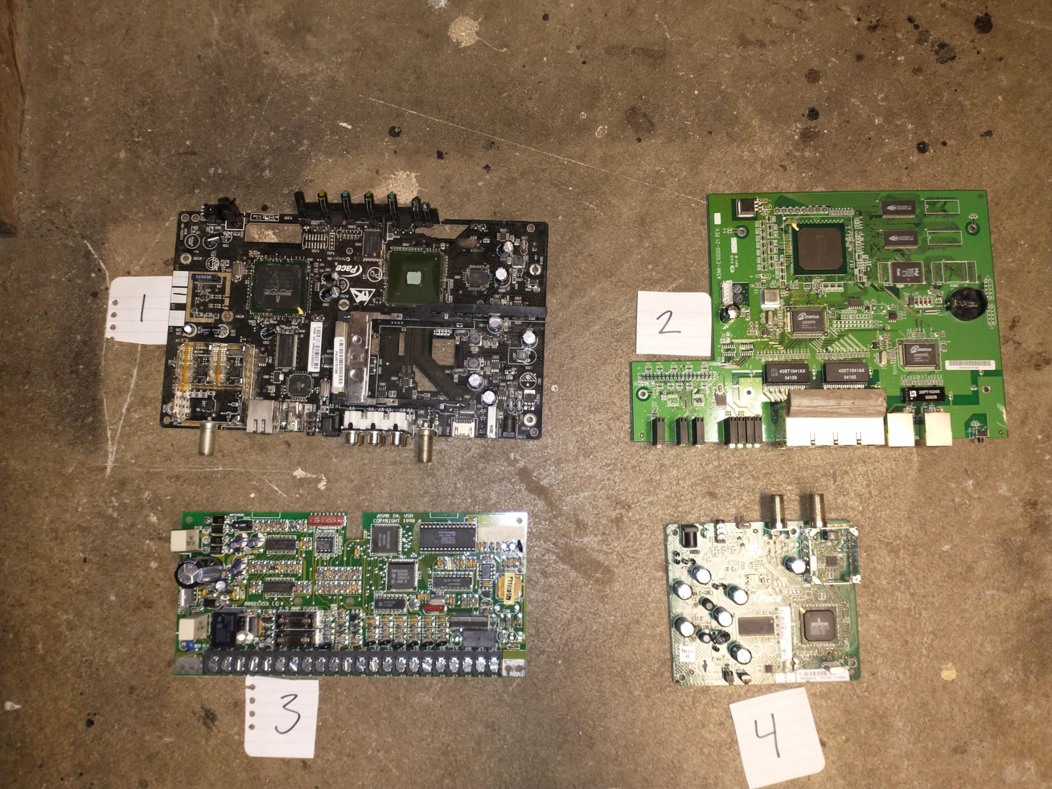

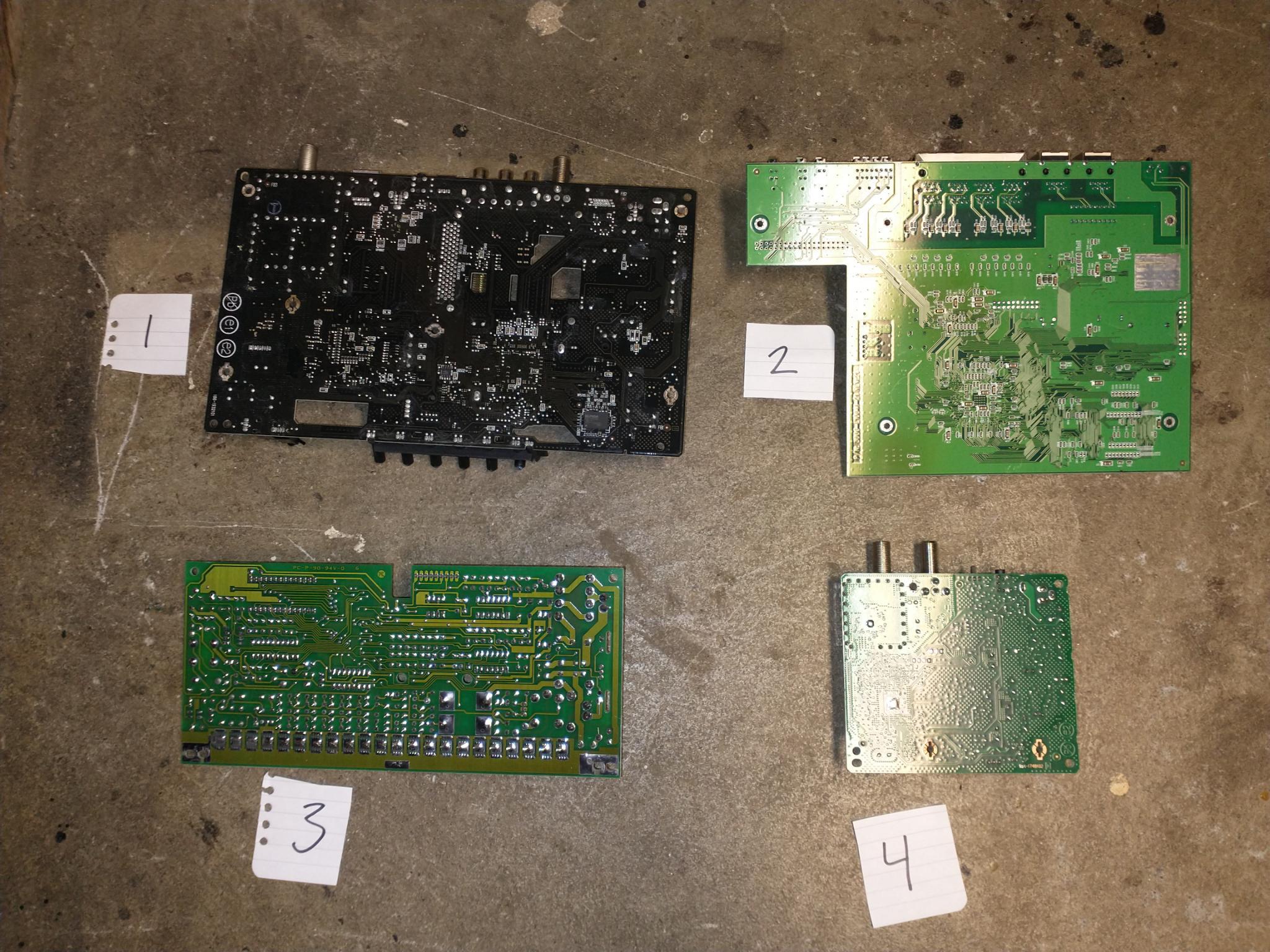

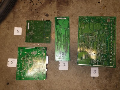

I threw these in with low grade telecom, can anyone let me know if I'm wildly off base (and maybe why, if you have the time and inclination, so I can learn)? Not a lot going on on the back sides of these boards so maybe they're high peripheral instead? Thanks!

The high Peripheral boards in this collection are 1,2 and 5. The remaining are Low Peripheral.
Thanks Chris!
PostPosted: Tue Oct 11, 2022 4:20 pm
Posts: 810
It's always great to get a solid answer from the Boardsort guru! With that said I am wondering why 8 and 3 don't fall into the high grade. They seem to have multiple ICs on them and that is what I use to determine high vs low peripheral.
PostPosted: Tue Oct 11, 2022 10:28 pm
Posts: 2668
The screw terminators on 3 & 8 are going to add a lot of weight so that makes sense.
PostPosted: Fri Oct 21, 2022 1:16 am
Joined: Mon Apr 26, 2021 12:50 pm
Posts: 14
Huh. If I removed the terminators would that push them into high?
