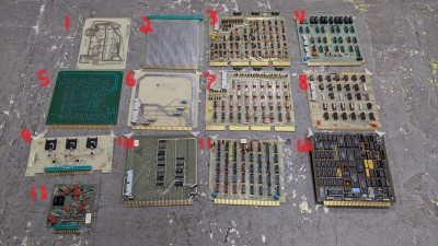

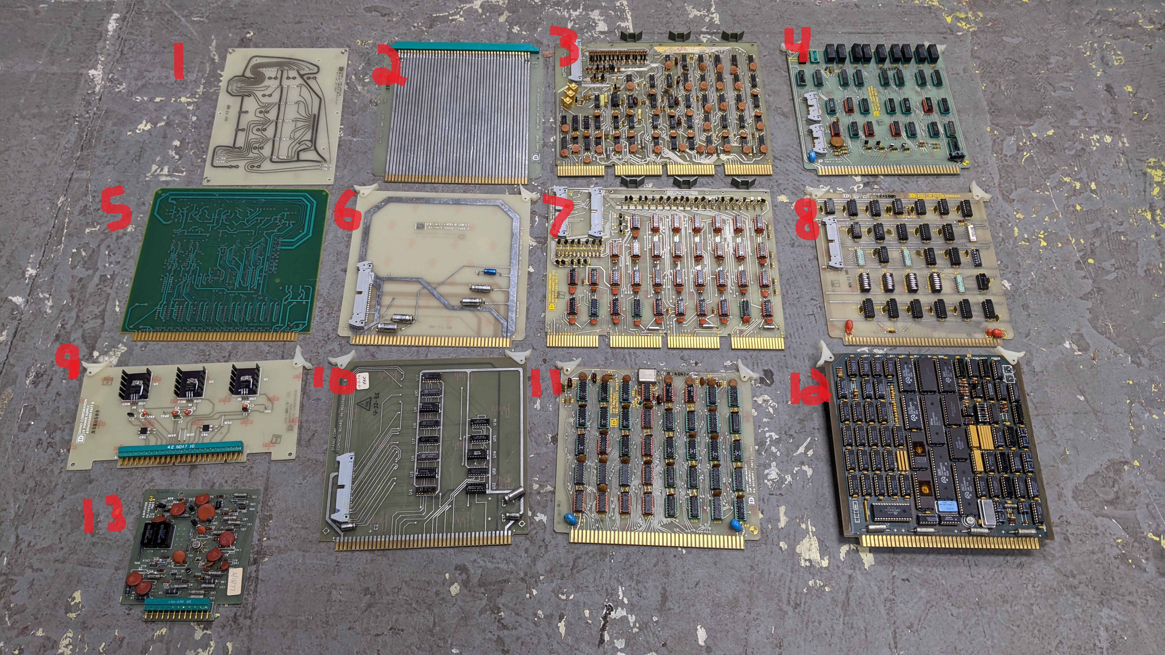

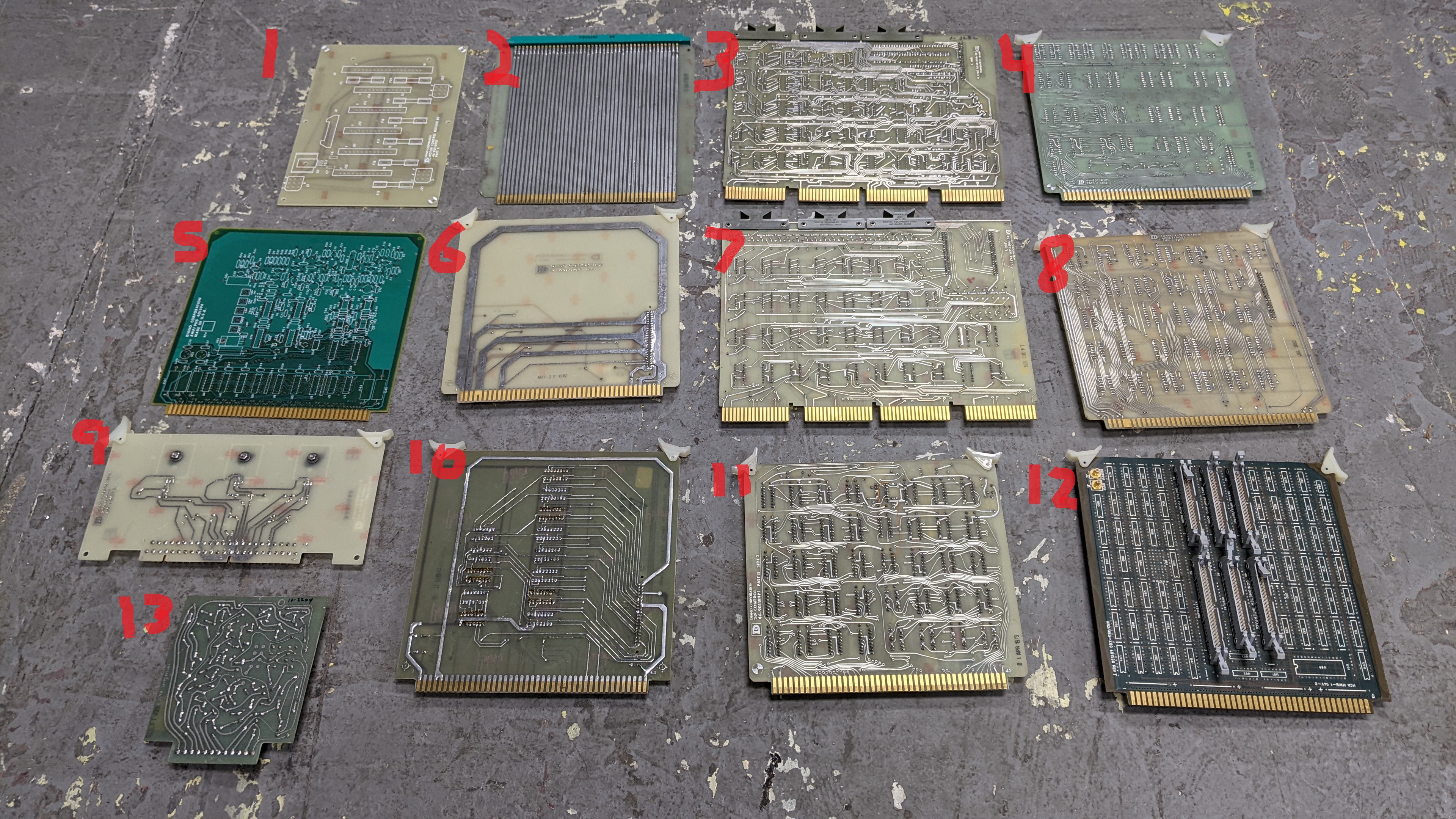

Here's another big set of boards I'd appreciate feedback on. This is a representative sampling of the ~150lb of this stuff we got recently.
There's a big range in how populated each item is, so my big questions are;
- What do you you think a ballpark per-pound price ought to be on the whole load? I'm guessing $4-$7, but there's a lot here I'm not familiar with.
- Some of the backing/printing looks like silver or tin. Can anyone tell me what that is, and does it much affect the value?
- Should I bother removing the IC chips that are socketed, or would that greatly de-value the boards?
And I've already found some 'mercury-wetted-contact' items I'll need to hazmat, but if anyone sees anything else of note/concern, please let me know. Any and all advice is appreciated.
Thanks very much.

Boards in picture #1. Very good you did front and back.
#1 low grade. If indeed boardsort buys it.
#2 Cut gold fingers off. Remove connector. Trash board.
#3 Remove clips. Submit High Telecom.
#4 U2 thru U10 remove if relays. Submit High Telecom.
#5 Remove gold fingers. Trash board.
#6 Remove gold fingers and connectors. Trash board.
#7 #8 #11 #12 High Telecom.
#9 Remove connector. Submit board low grade.
#10 Low Telecom.
Boards in picture #2
#1 Remove connector and piece of gold. Submit board as low grade.
#2 Low grade. As is.
#3 Low Telecom. As is.
#4 Remove transformer. Submit board as High Peripheral.
#5 Remove glass fuses. Remove heatsink. Submit board as Backplane.
#6 Remove gold pieces. Submit board as Low Grade.
#7 Remove connector. Submit board as Low Grade.
#8 Remove Heatsink. Transformer. Large cap. Submit board Low Telecom.
#9 High Telecom. I see gold pin ICs. Leave them there.
#10 Low Telecom as is.
#11 Remove gold fingers. Trash board.
#12 Remove connector. Submit board as Low Grade.
#13 Remove the key caps. Leave key body. Submit High Peripheral.
#14 Unknown.
