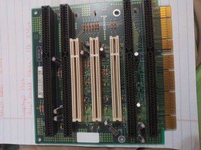

This board has no chips of any kind that I see. On the back there is nothing. Would I classify it as just a gold finger board?

Sometimes backplane boards with gold fingers can be gold finger boards and sometimes not. Check out board #1 in the first post, then check out picture #3 in the second post.
viewtopic.php?f=4&t=21700&p=43653&hilit=clean+gold+fingers#p43653
viewtopic.php?f=7&t=21656&p=43483&hilit=Clean+gold+fingers#p43483
In this case I don't think there is enough other PM to make the jump to gold finger card. I think you can trim off the fingers and and still classify this as backplane (but I could be wrong).

Thank you. I had considered backplane but wasn't real sure.

This had me thinking about a post from AAK2. After searching a bit I found it. Take a look at the board "P". It looks just like yours and AAK2 says it goes as gold finger card.
viewtopic.php?f=4&t=21861&p=44230&hilit=backplane#p44230

This whole post is super helpful to me! Thank you for sharing. I tried looking through a lot of older posts in this thread but there are so many.

I agree! My search was a bit easier because I remembered the author of the post. I added it to the post "explanation of different board sort categories" under backplane.
