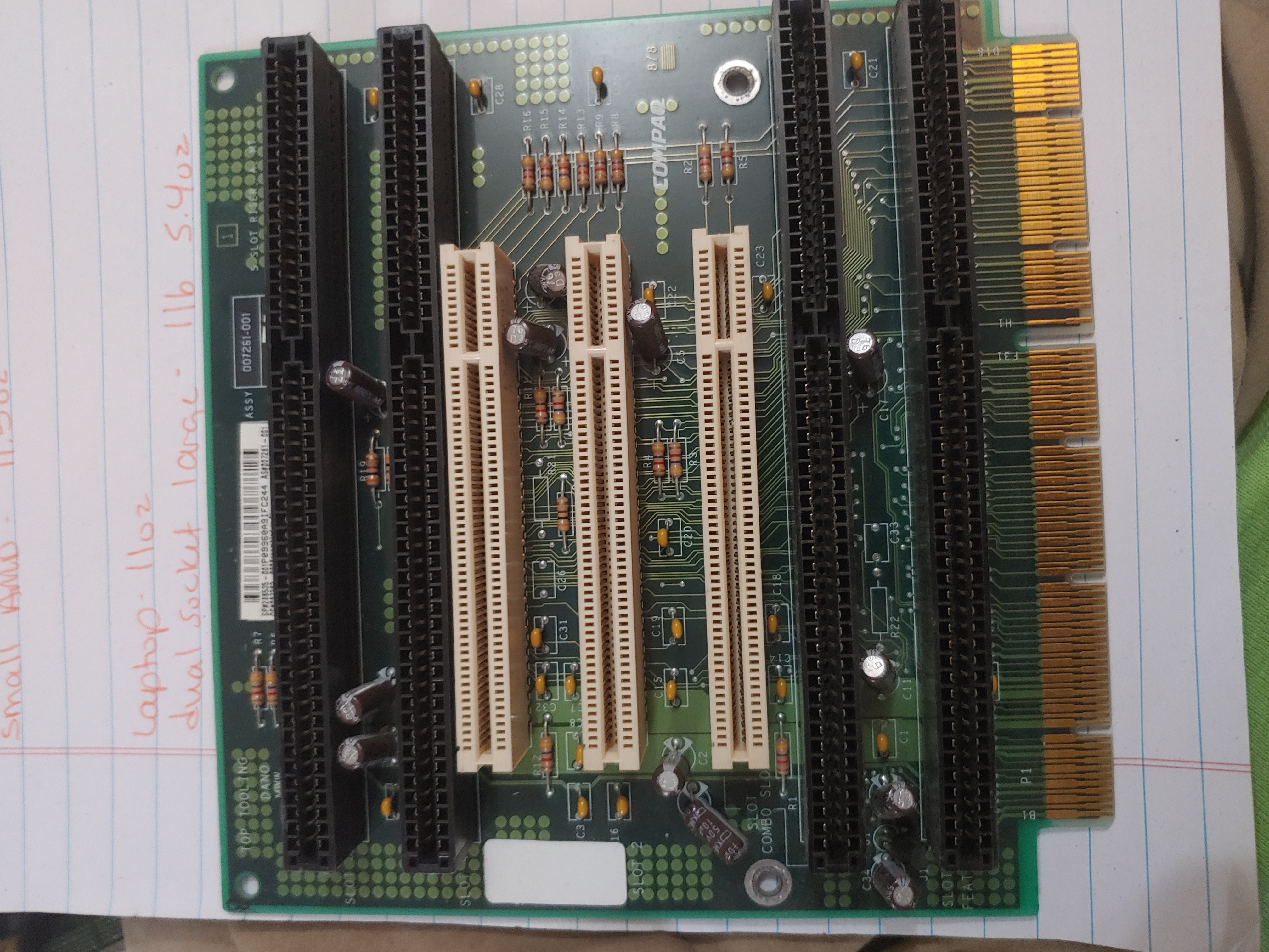

This board has no chips of any kind that I see. On the back there is nothing. Would I classify it as just a gold finger board?

Sometimes backplane boards with gold fingers can be gold finger boards and sometimes not. Check out board #1 in the first post, then check out picture #3 in the second post.

In this case I don't think there is enough other PM to make the jump to gold finger card. I think you can trim off the fingers and and still classify this as backplane (but I could be wrong).

Thank you. I had considered backplane but wasn't real sure.

This had me thinking about a post from AAK2. After searching a bit I found it. Take a look at the board "P". It looks just like yours and AAK2 says it goes as gold finger card.

This whole post is super helpful to me! Thank you for sharing. I tried looking through a lot of older posts in this thread but there are so many.

I agree! My search was a bit easier because I remembered the author of the post. I added it to the post "explanation of different board sort categories" under backplane.
