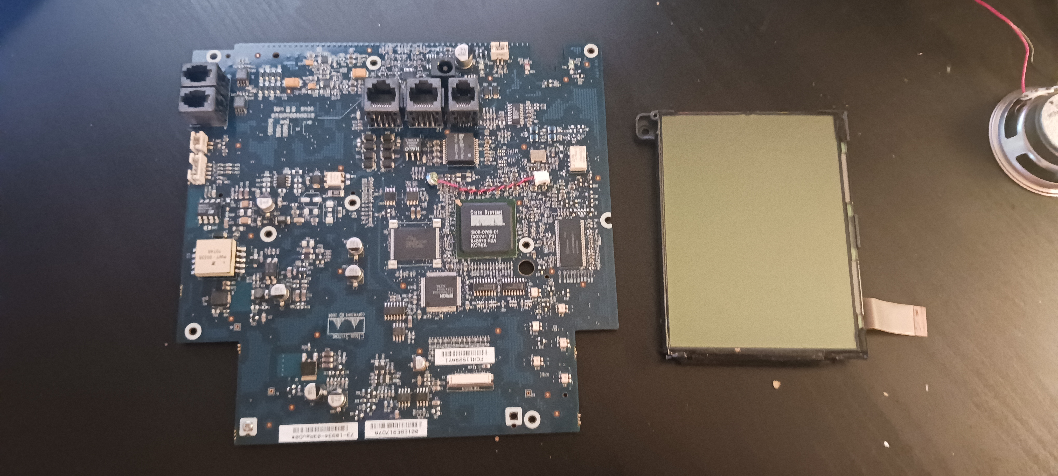

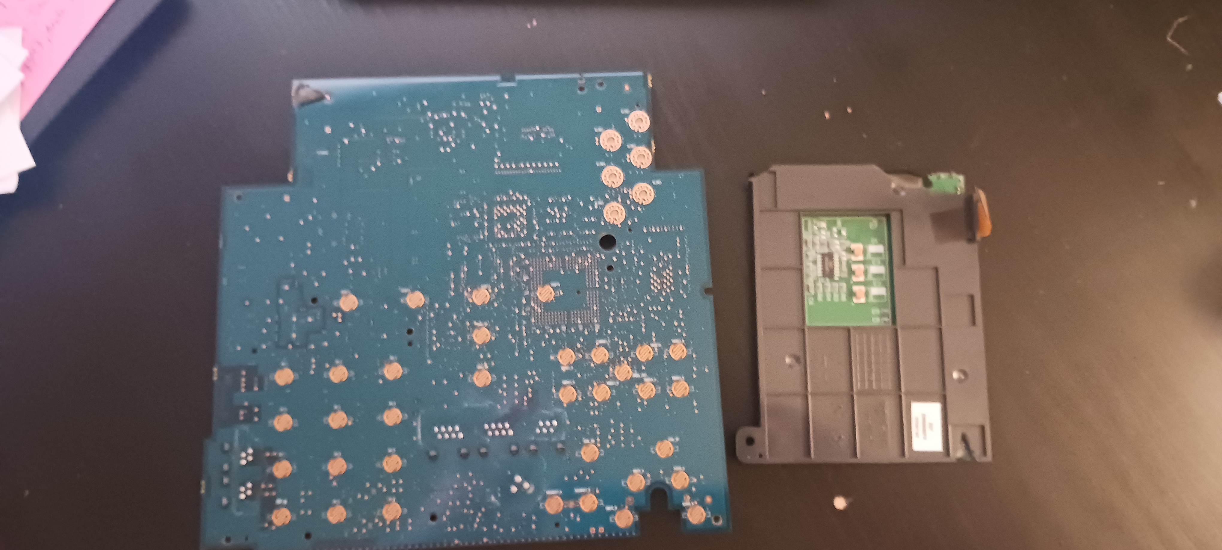

Hello all,
I got a bunch of Cisco VoIP phones, and upon disassembling one of them, this is what i got. How can that board be classified? and, can Boardsort take the smallest one, that has the crystal screen?
Thanks!

These boards will almost always (as long as you remove the junk, i.e. metal, batteries, ect.) be graded as high grade peripheral.

Did you ever get an answer on whether the small display has any value? (I assume not but I'm curious.)
I've done these before and you would have to remove the board from the screen and plastic backing as well. There's not much to the board so I assume it's low peripheral at best once cleaned.
They use a sticky double sided tape to hold it together if I recall so takes a bit of flexing of the plastic while holding the board down then that will expose the screen better to remove it.

With a BGA gold corner, it’s high peripheral
PostPosted: Sun Nov 17, 2024 3:00 am
It’s high peripheral
I’ve sent many hundreds of these if not thousands
