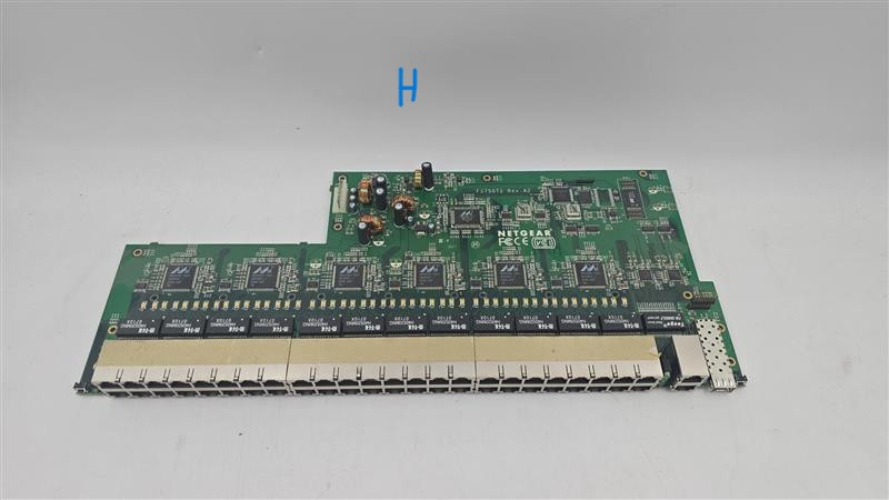

File comment: Network Switch Board H

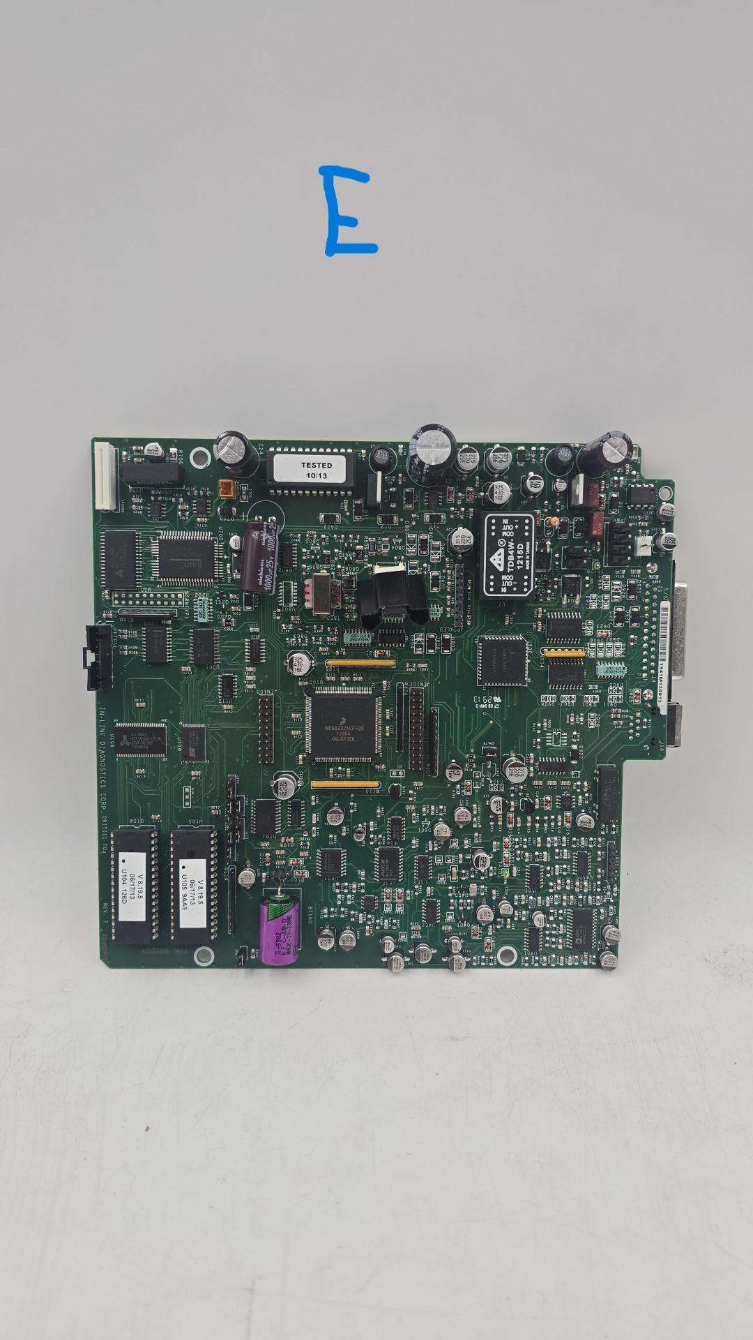

File comment: Telcom Board E

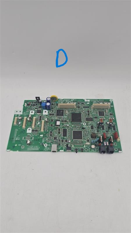

File comment: Telcom Board D

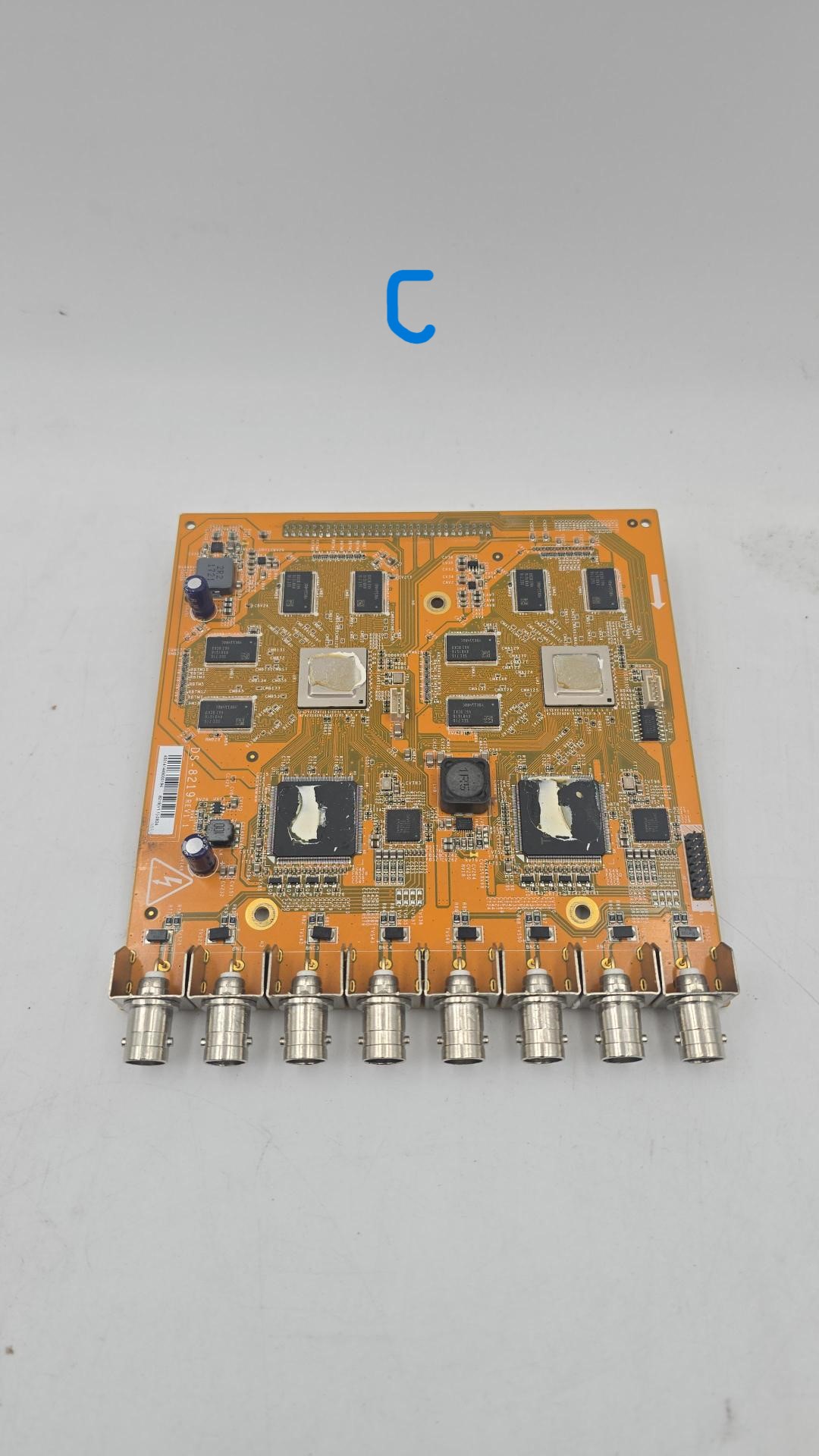

File comment: DVR Board C

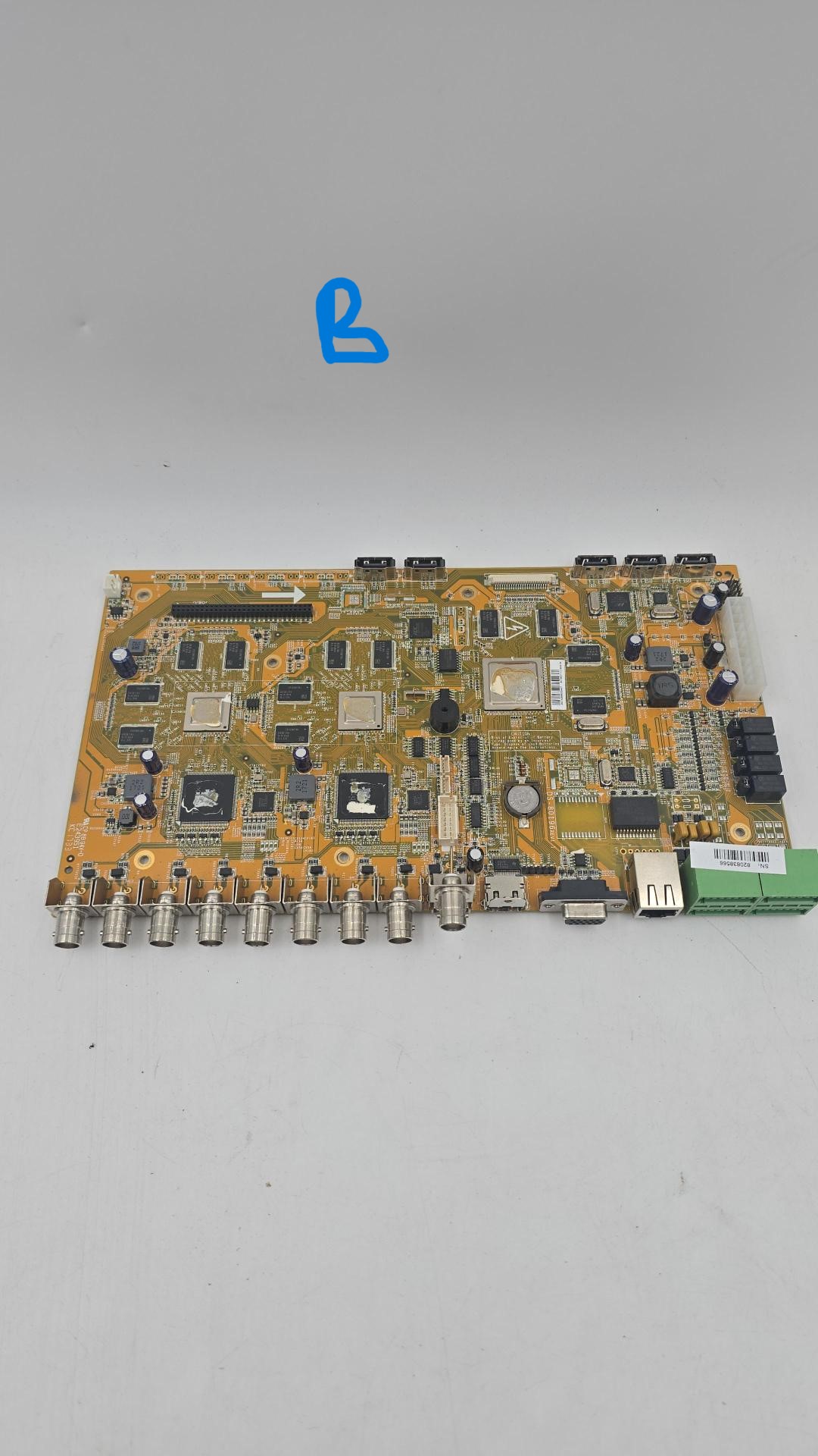

File comment: DVR Board B

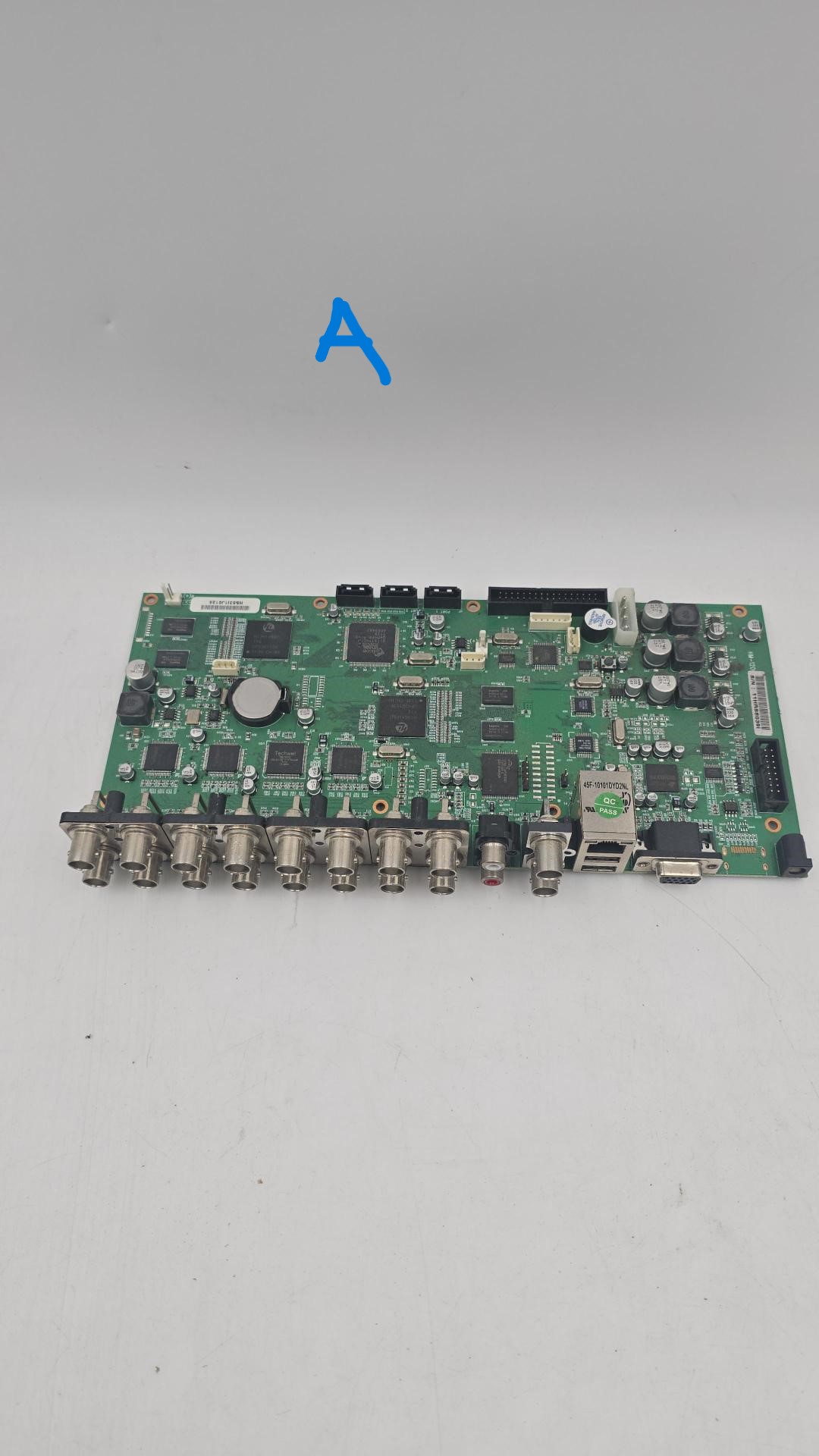

File comment: DVR Board A

I can see disc batteries on A,B, and D(the yellow disc mounted vertically in the back.
Also the purple cylinder on E. That's a battery. Labeled TL-5902.

A-C) My gut reaction was high peripheral, mostly because I see a lot of heavy lower value metal. If the metal connectors aren't as heavy as I think (which is hard to convey in text) it may get into low telco.
D-E) More inclined to think this can get low telco but not definite on this one either.

H) Similar to above, low telco seems safe but may be able to clear high telco
