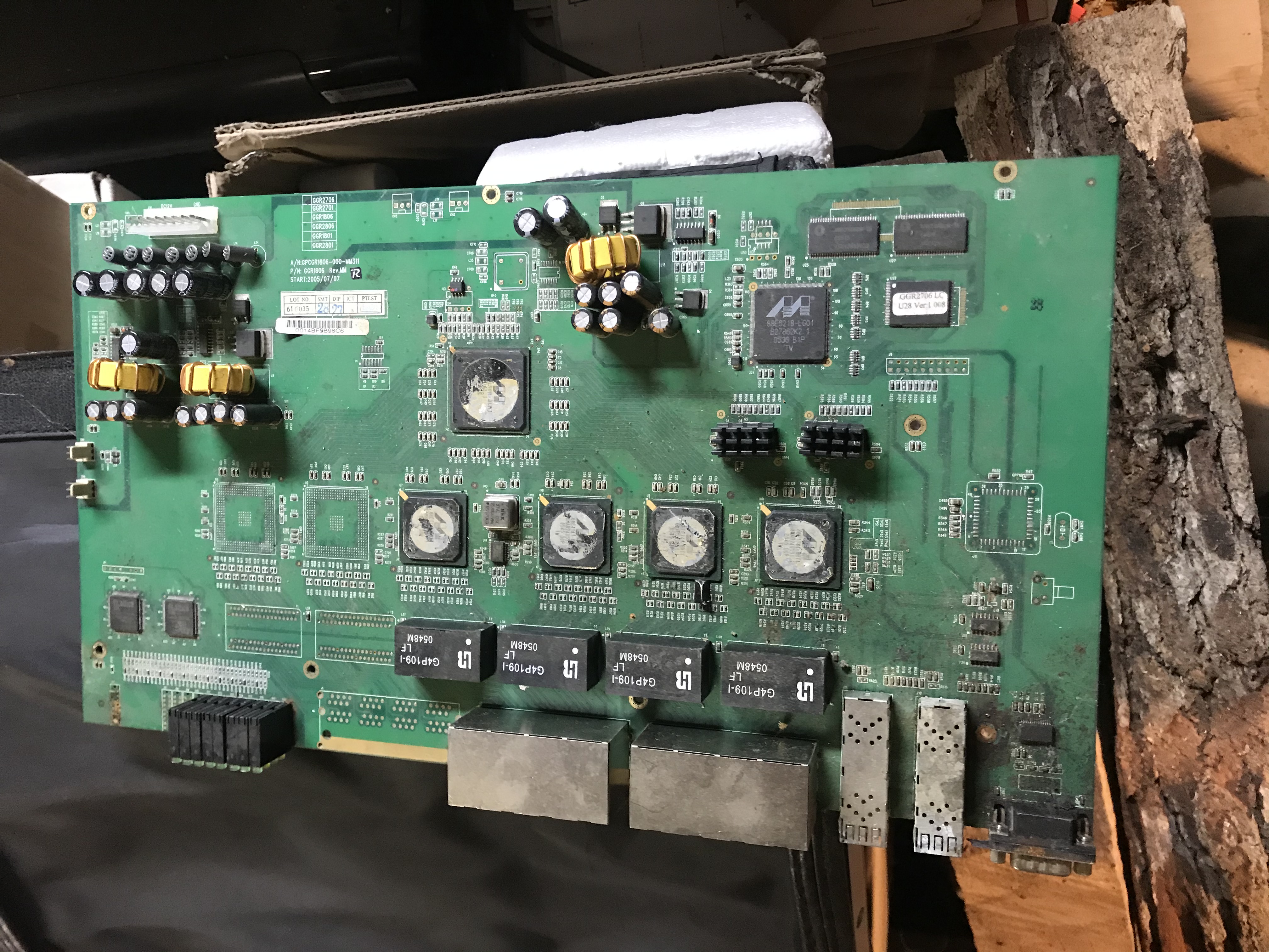

I figured I was likely over thinking it. Would you consider this a peripheral board, as is? I had it ID'd but not by any admins.

This one's high peripheral.
I sort the parts post removal into different classes and they go to different yards in bulk monthly.
One actually buys any layered boards even if blank. (layered, having a flashing on top or a metal layer in the middle). I get electric shred which at the moment is 2-5 cents depending on grade and amount of weight.
for the rest of the world:
It's missing two chips but looks like they were never installed. the dual controllers run the I/O bank and the missing bank was clearly not installed. So I'll go with this not being modified.

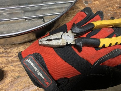

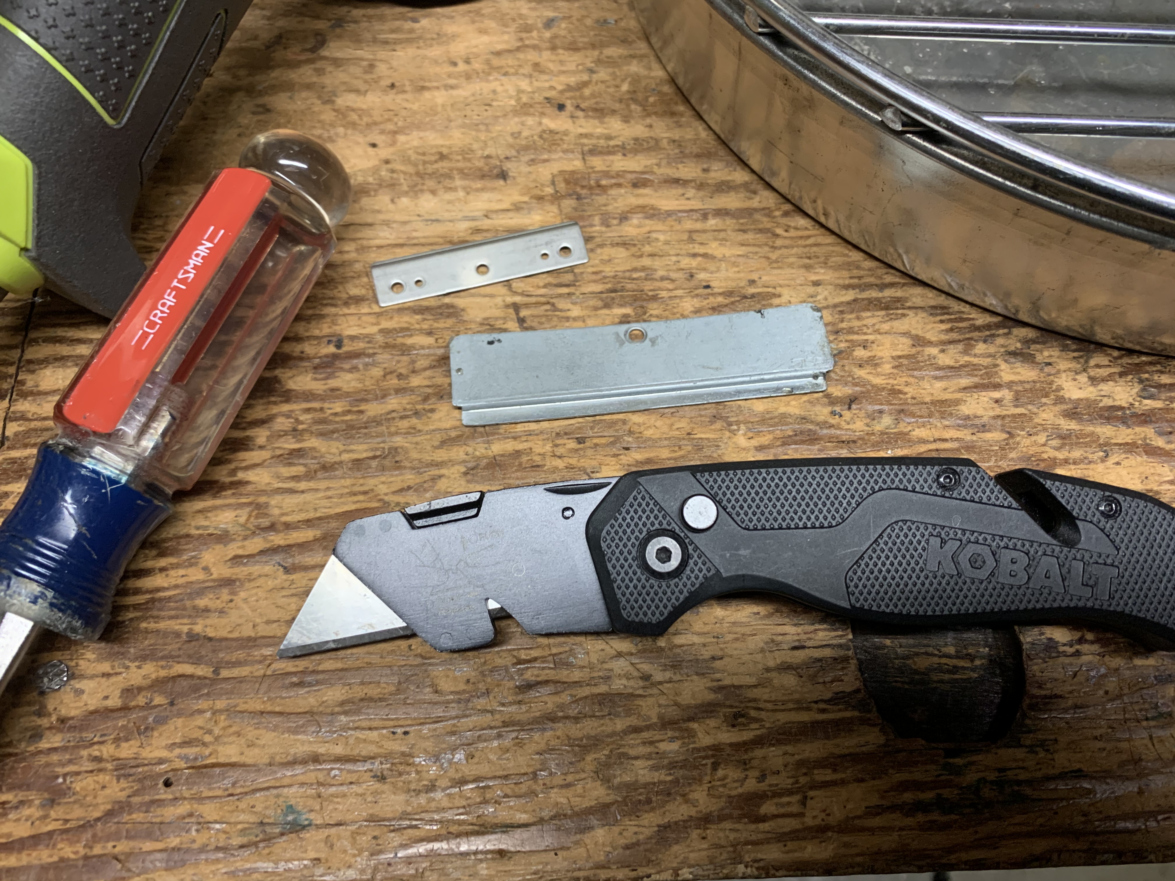

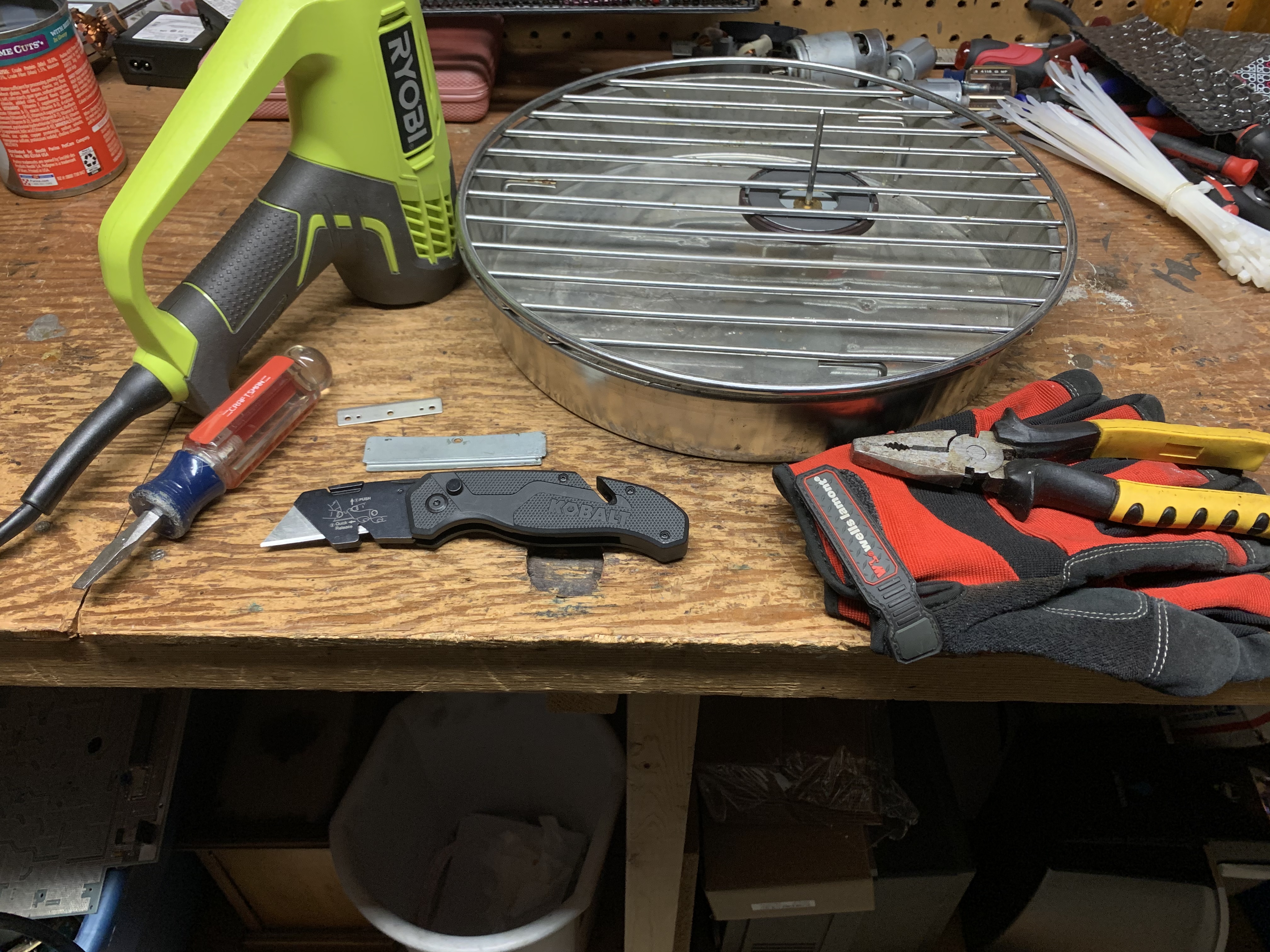

Most suggest an air chisel or electric chisel.
That definitely works and quickly: but it’s destructive and you should still remove liquid/oil canister capacitors first.
There’s no fumes in this method so a plus there.

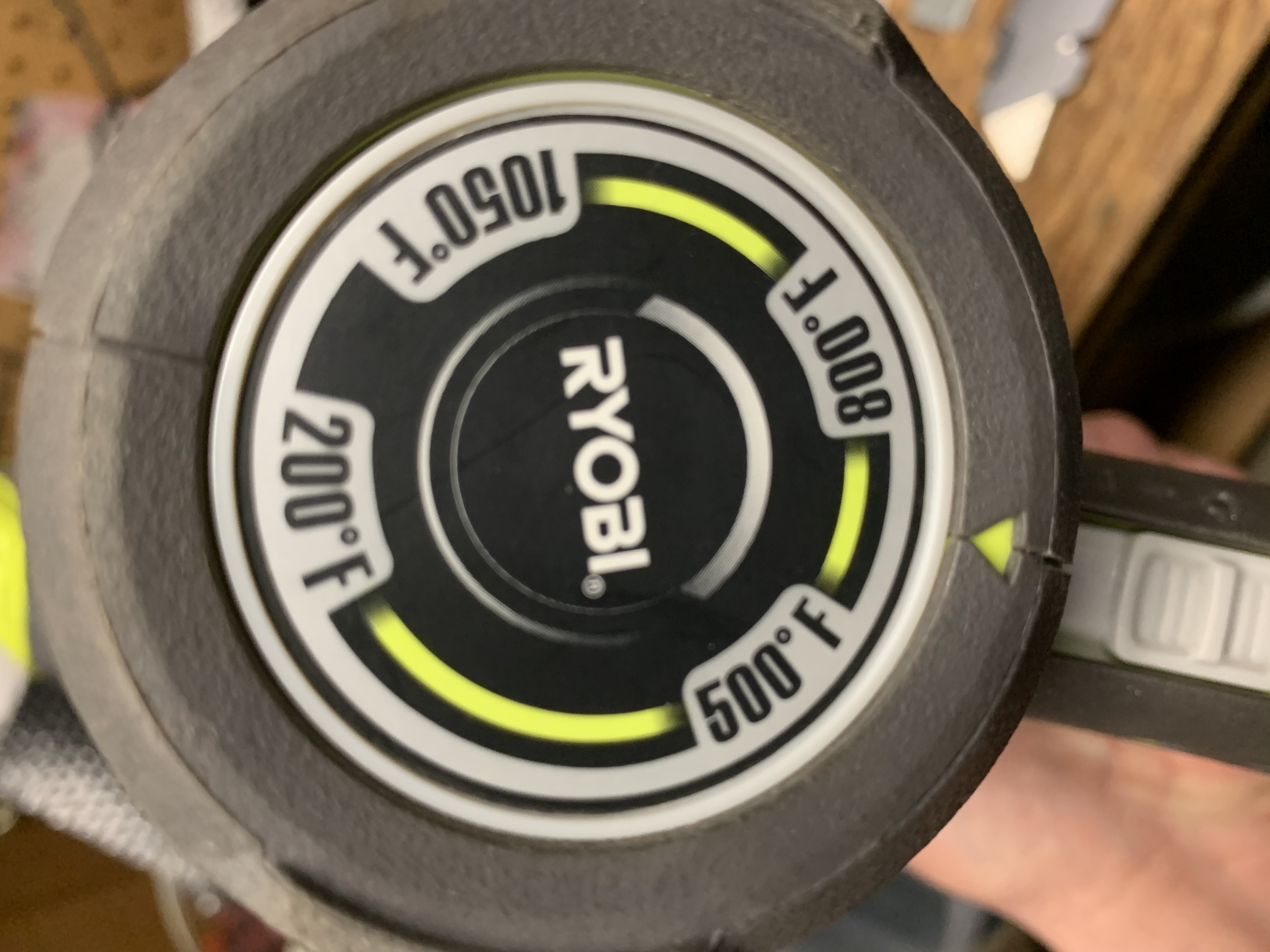

Personally I prefer a heat gun. Each gun is slightly different but generally somewhere between 750-850 is just right to melt solder at about 6” distance.
You can go higher for faster removal but you start melting plastic components. Anything above 900• and you can set the board on fire easily.
If you use a heat gun do so outside or, if inside, with good strong ventilation, preferably with a commercial air purifier. You will make fumes.
