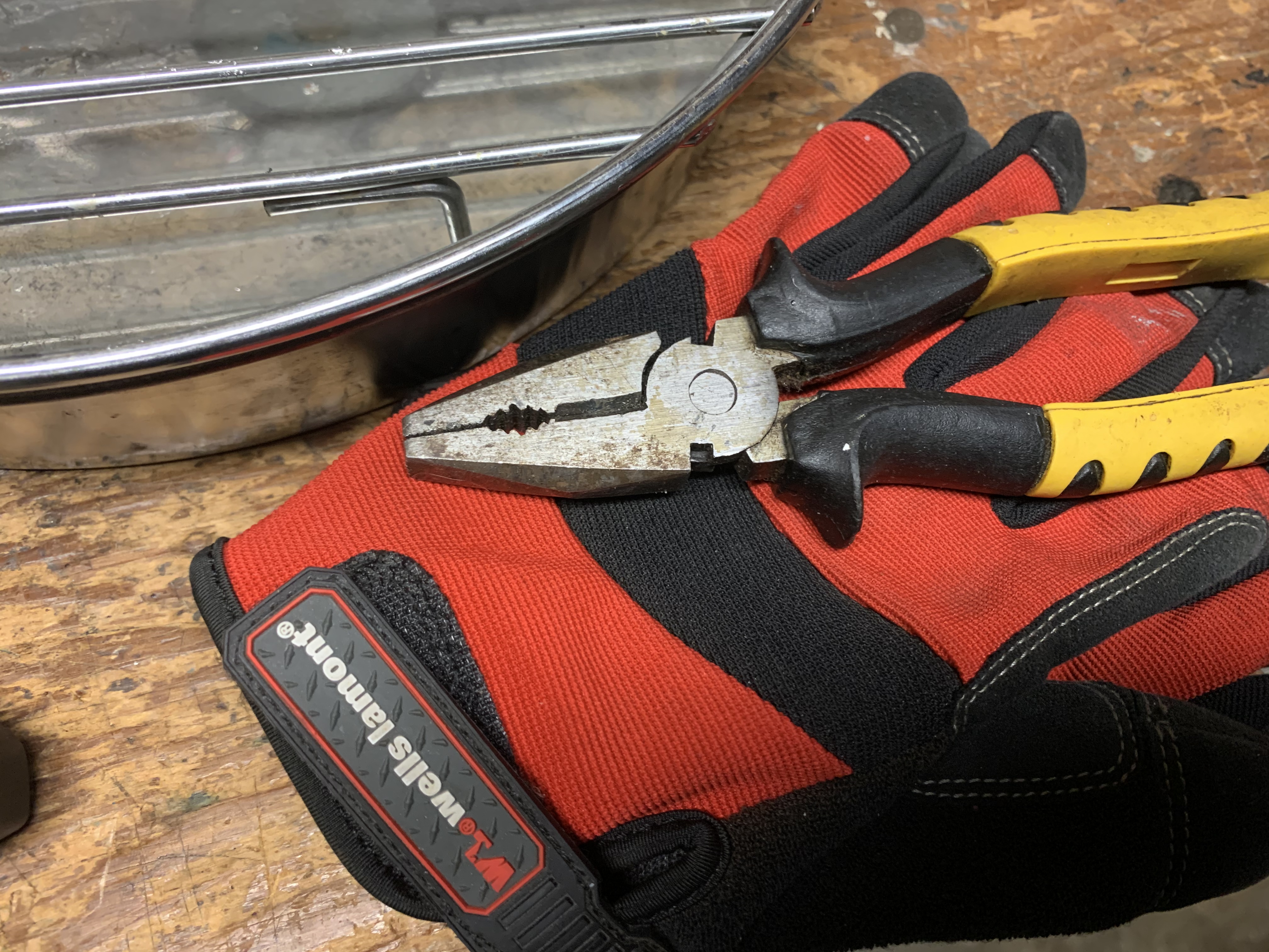

I'll see if I can post a photo of my setup again since I've long forgotten what post I had the old photos in.
 Post subject: Re: Removing Flatpacks
PostPosted: Fri Feb 12, 2021 4:22 pm
Posts: 10554
Most suggest an air chisel or electric chisel.
That definitely works and quickly: but it’s destructive and you should still remove liquid/oil canister capacitors first.
There’s no fumes in this method so a plus there.
Personally I prefer a heat gun. Each gun is slightly different but generally somewhere between 750-850 is just right to melt solder at about 6” distance.
You can go higher for faster removal but you start melting plastic components. Anything above 900• and you can set the board on fire easily.
If you use a heat gun do so outside or, if inside, with good strong ventilation, preferably with a commercial air purifier. You will make fumes.
