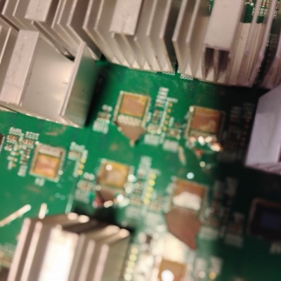

200 Ant Miner units followed me home today, just begging for me to
full hashb.jpg[
give them some attention. Some of them may be functional, while some are obviously burned out with the task of digging up non-existent coins. If they wore collars, one could claim they got hot under the collar but I think it was just job burnout.
One pallet with about 60 whole units had 30 loose hashboards already removed. These boards have about 60 small aluminum fins heat sinks on each side of the board. Underneath the heat sink is a tiny chip. The problem arises when one attempts to remove the heat sink, as it is firmly glued to the chip, which is attached to the board. Sometimes the chip splits and part of it remains attached to the board, showing the tiny precious metal traces, or totally detaches and remains on the removed heat sink, while other times the heat sink pops off clean with damaging the chip. DDDoes anyone know a trick to easily remove the heat sink without damaging the chips?
A topic on the antminer hashboard was posted previously a couple years ago, and one reply said if the heatsinks were not removed, it would be a mid grade board, another person said it would be peripheral low grade with the sinks removed. I asked Chris a few months ago, without specifying the 120 heat sinks, but don't remember what he said. I am having trouble geting a photo loaded to OSCAR.

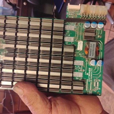

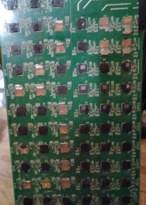

I finally got two more photos upload showing one side clean pops and other side damage, just prying, no heat . I dont think the total weight of all 120 sinks would be more than an ounce or two on the one pound board

Finally got a couple pics loaded onto OSCAR. I gave him four tries with the same board, just different angles and sections. He first declared it definitely high telecom, but with large heat sinks so only graded as Low telecom. Next try, still a telecom but no huge heat sinks, just lots of them. Next go, he thought it was a cryptocurrency mining board, even guessed Antminer, but said it was a goldfinger card (my fingers were holding the board) but unfortunately it had a huge cooling fan and heat sinks, so would only go as a GFC with oversize fan and heatsink. I may insist when I get my load delivered in person, I may demand OSCAR do the grading. LOL. Years ago, a new scrapyard opened near me, and I took a cast iron bathdtub across the scales. 300 pounds, and cast was bringing 3 cents a pound. I got to the pay window, and the cashier handed me 90 dollars. I refused it, and insisted she check her figures. she checked, assured me $90 was correct. I persisted and had her go over the ticket with me. Being new on the job, and the scaleman had written up the ticket as "cast" she assumed it was cast Aluminum at 30 cents a pound, 90 dollars instead of 9. Was I wrong to not profit from their error? I don't think so. A short time later, the owner sent 3 semi loads of CRT monitors and computer towers, etc to my house, no charge

Freezing works. Hashboard left in refrigerator freezer compartment, which only gets down to about 20 F, allowed me to knock the sinks off if hit from the end. From the side, no. Popped most of them off cleanly, but sometimes took a couple blows. I will try one in a regular freezer which goes down to near 0 F to see if that improves weakening the bond. Later will try toasting the sinks with propane torch, electric stove eye and even oven, although the oven would probably not leave the little chip in place on board.

Bare board Oscar now says high peripheral. This board side was heated on electric stove eye for just a few seconds, then the white aluminum sinks came off easily. The other side that look more like chrome or stainless still stuck tight.
