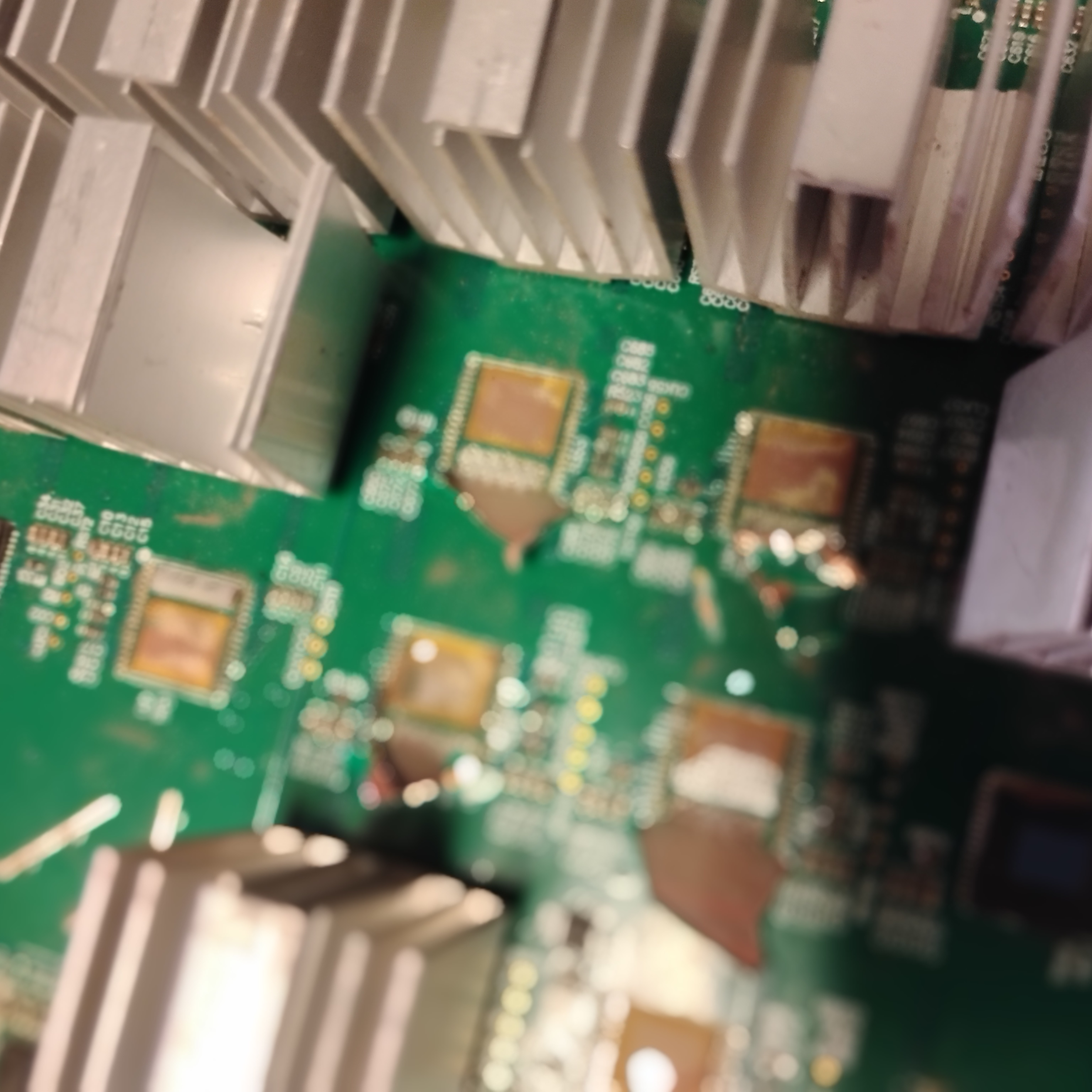

One pallet with about 60 whole units had 30 loose hashboards already removed. These boards have about 60 small aluminum fins heat sinks on each side of the board. Underneath the heat sink is a tiny chip. The problem arises when one attempts to remove the heat sink, as it is firmly glued to the chip, which is attached to the board. Sometimes the chip splits and part of it remains attached to the board, showing the tiny precious metal traces, or totally detaches and remains on the removed heat sink, while other times the heat sink pops off clean with damaging the chip. DDDoes anyone know a trick to easily remove the heat sink without damaging the chips?

I finally got two more photos upload showing one side clean pops and other side damage, just prying, no heat . I dont think the total weight of all 120 sinks would be more than an ounce or two on the one pound board

Freezing works. Hashboard left in refrigerator freezer compartment, which only gets down to about 20 F, allowed me to knock the sinks off if hit from the end. From the side, no. Popped most of them off cleanly, but sometimes took a couple blows. I will try one in a regular freezer which goes down to near 0 F to see if that improves weakening the bond. Later will try toasting the sinks with propane torch, electric stove eye and even oven, although the oven would probably not leave the little chip in place on board.

Bare board Oscar now says high peripheral. This board side was heated on electric stove eye for just a few seconds, then the white aluminum sinks came off easily. The other side that look more like chrome or stainless still stuck tight.
