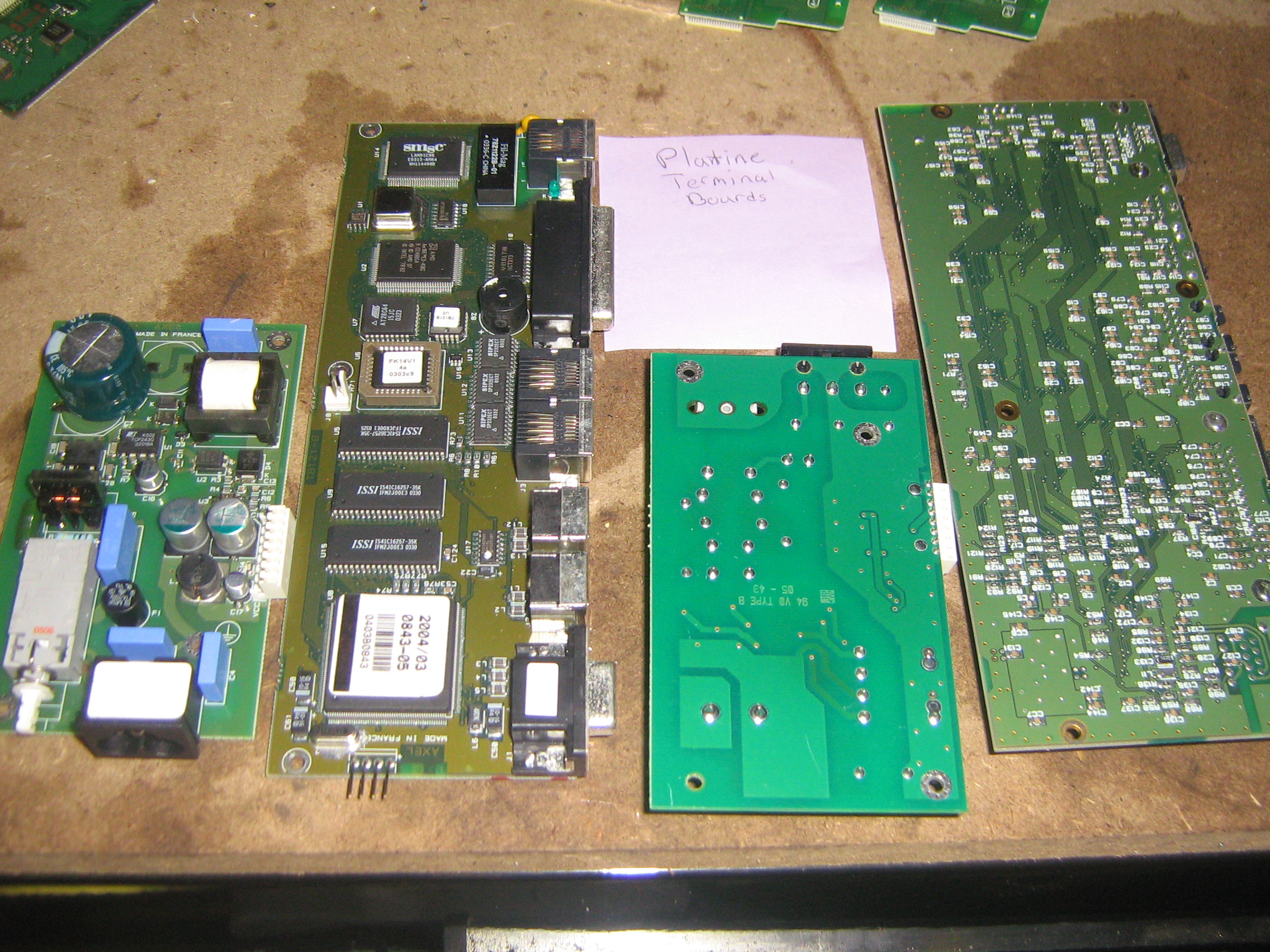

thank you for the help and if there is an easy way to tell what i have i don't need to post a bunch of pics and get annoying i have a lot of pics out of a variety of computer parts and drives

Bogie2929,
No problem with the pictures. This is what the forum is for. For every picture you post is one more answer for someone else with the same question!
The following boards (referenced by the filename) are going to be Telecom ($4.00/lb):
As you can see in the pictures the surface area is highly populated with IC chips and there are very little to no resistors, capacitors or transformers on the boards. They also have connectors that hold a nice array of gold pins. That is why these boards are considered Telecom.
The remaining boards are considered Peripheral Grade ($1.40/lb):
These boards are considered Peripheral grade because of the lack of IC population with respect to the surface area. In fact a few of the boards may be midgrade because they are so lightly populated, particularly the little blue one and the top two of the sony boards in IMG_8596.jpg.
Thanks for the look!

Here is what I see in the above pictures as referenced by the file names:
IMG_8586(87,88).jpg = Peripheral Grade ($1.40/lb at the time of this post)
IMG_8607.jpg= Peripheral Grade
IMG_8605(06).jpg = Smaller Board is Peripheral, the larger board is a CD/DVD Rom board ($2.95/lb at the time of this post).
IMG_8601.jpg = Peripheral Grade
IMG_8604.jpg = Peripheral Grade
IMG_8597.jpg = Peripheral Grade
IMG_8585.jpg = Peripheral Grade (even though it is technically a connector end, it is worthy of the $1.40/lb grade)
IMG_8594.jpg = Peripheral Grade (even though it is a technically connector end, it is worthy of the $1.40/lb grade)
IMG_8599.jpg = Smaller board is a Mid-Grade board ($0.35/lb). The larger board is Peripheral Grade.
Thank you for the look!
