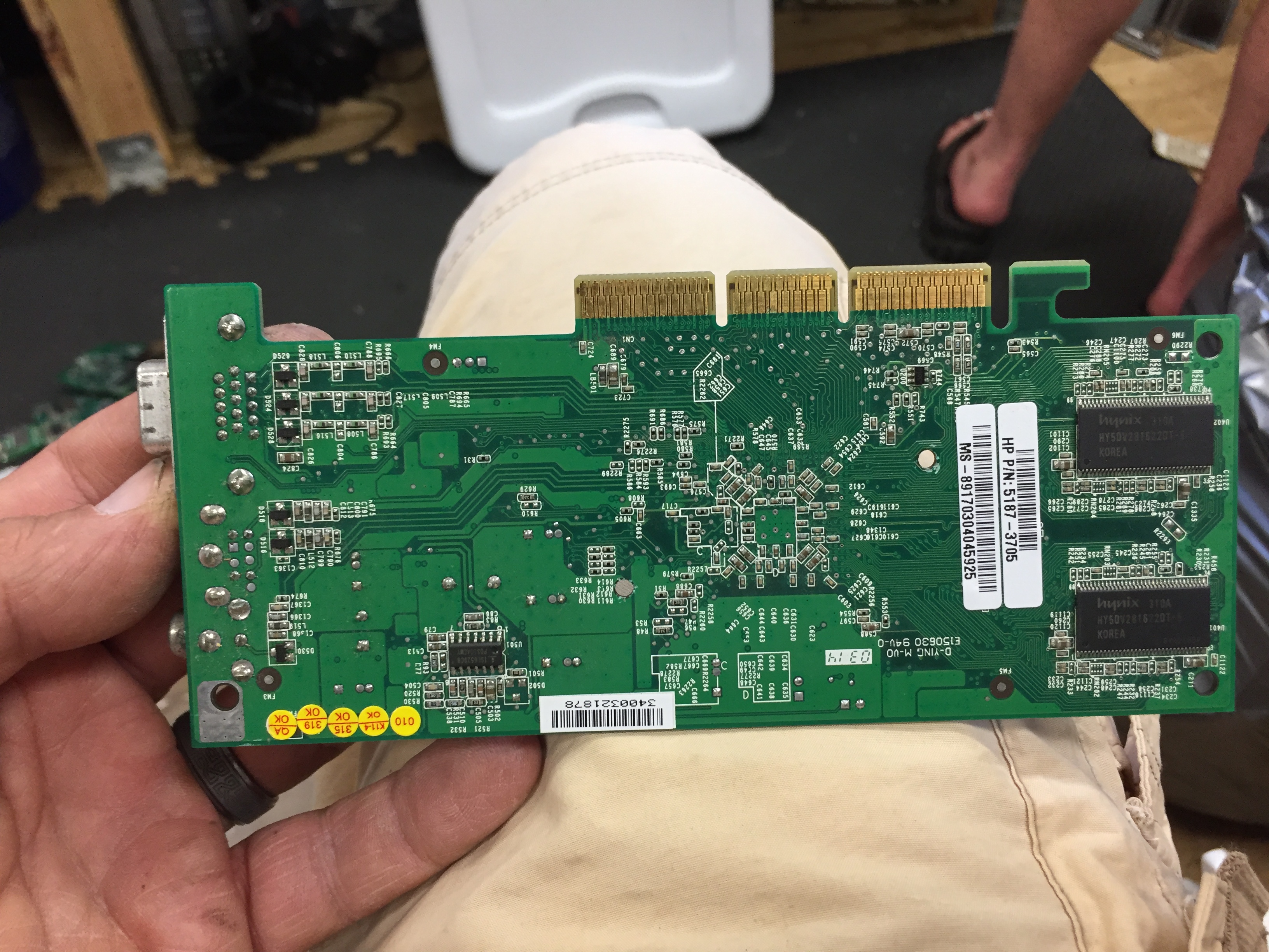

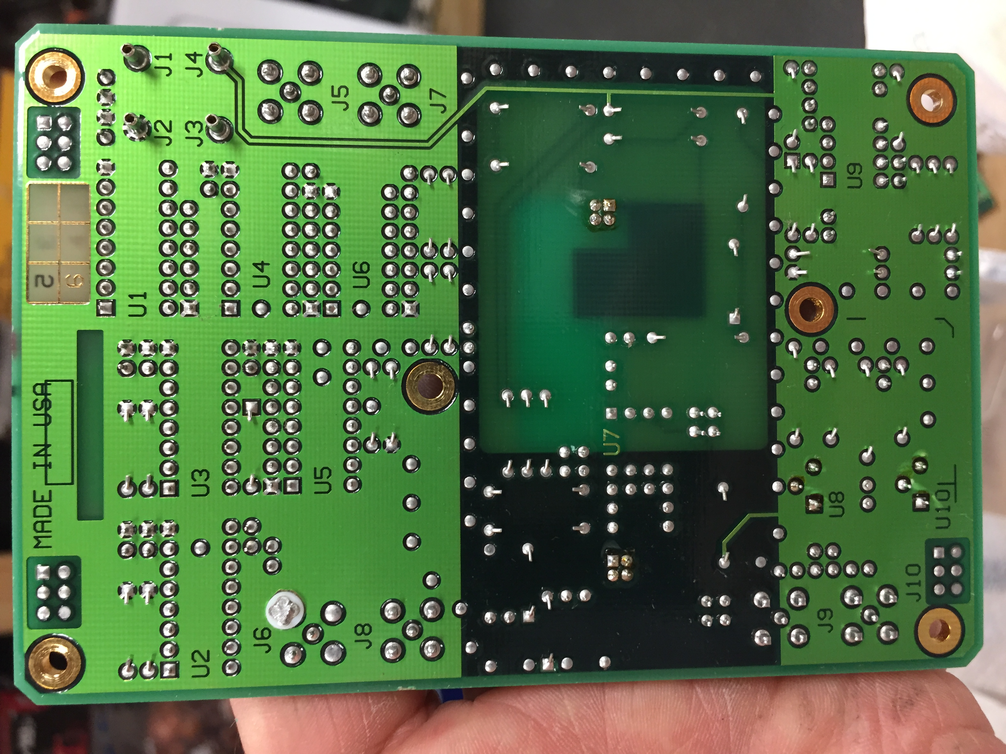

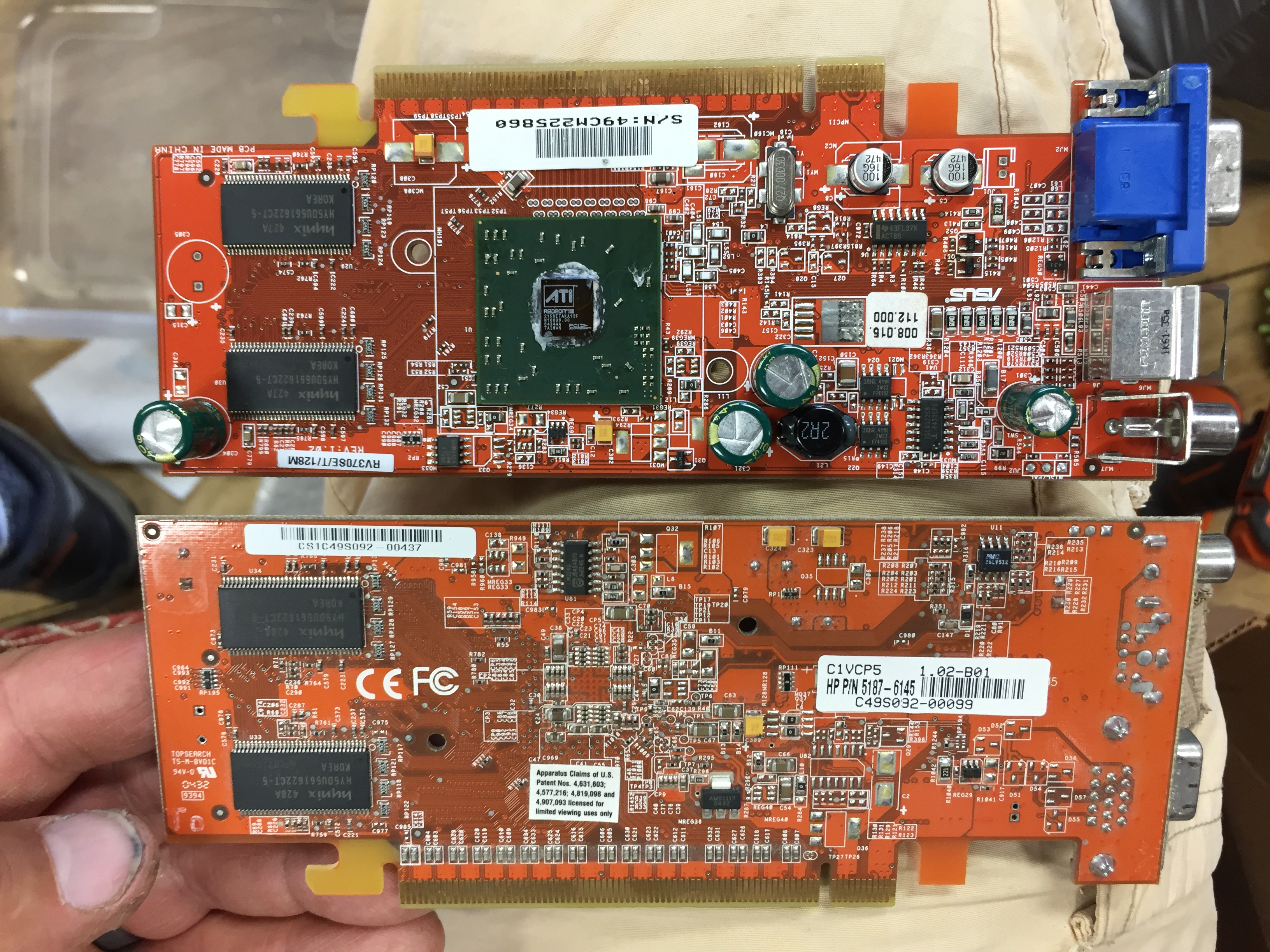

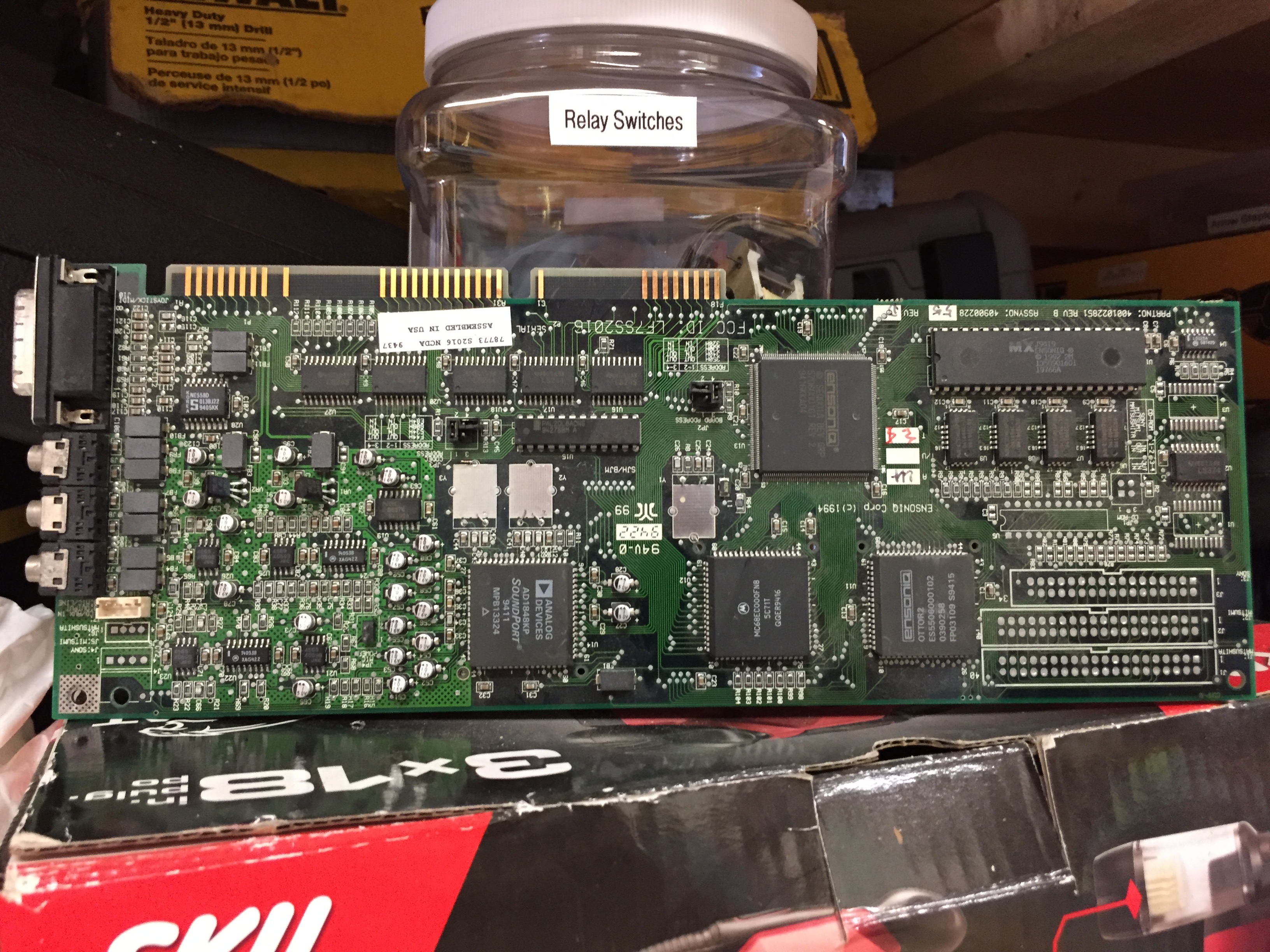

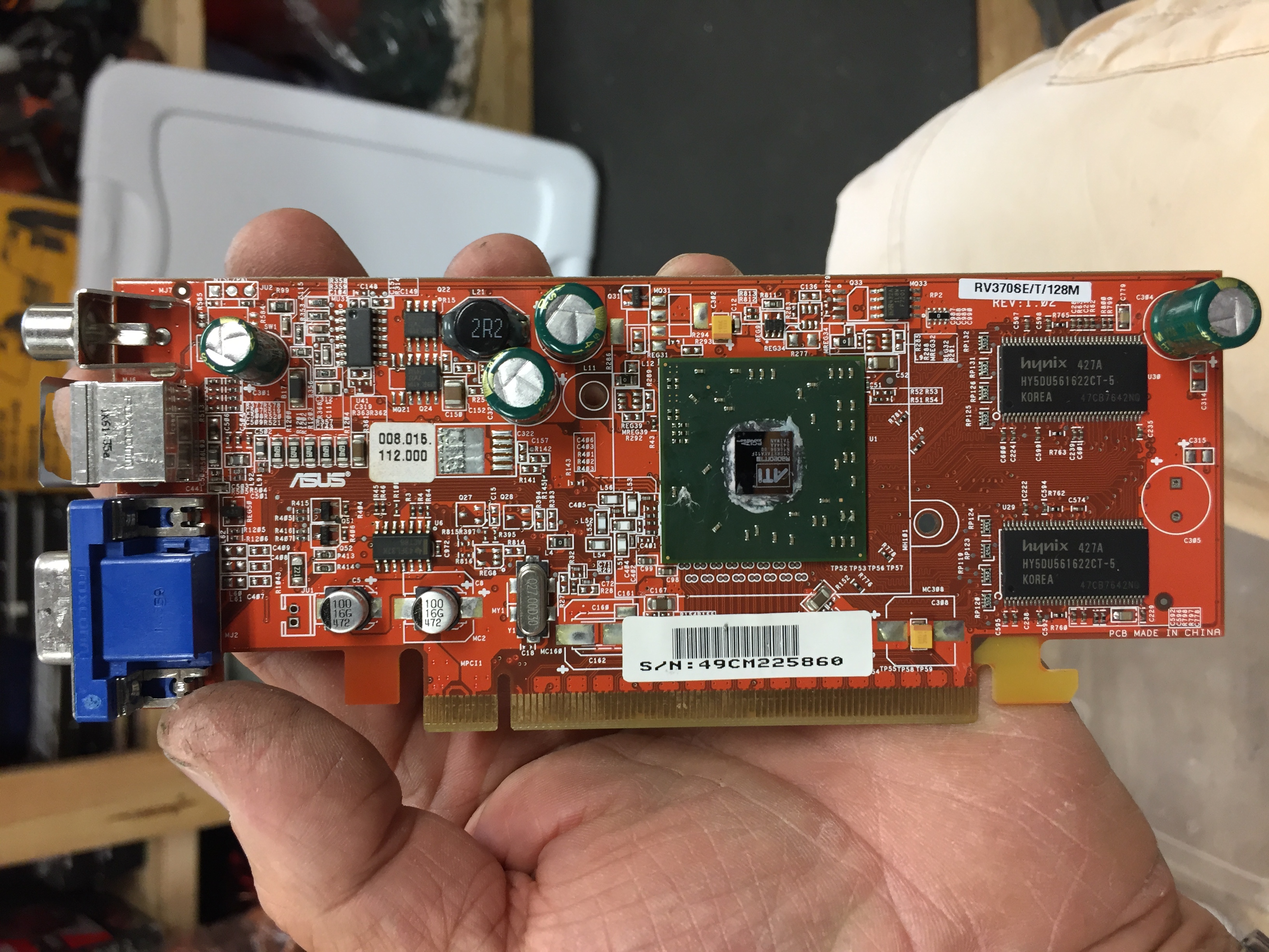

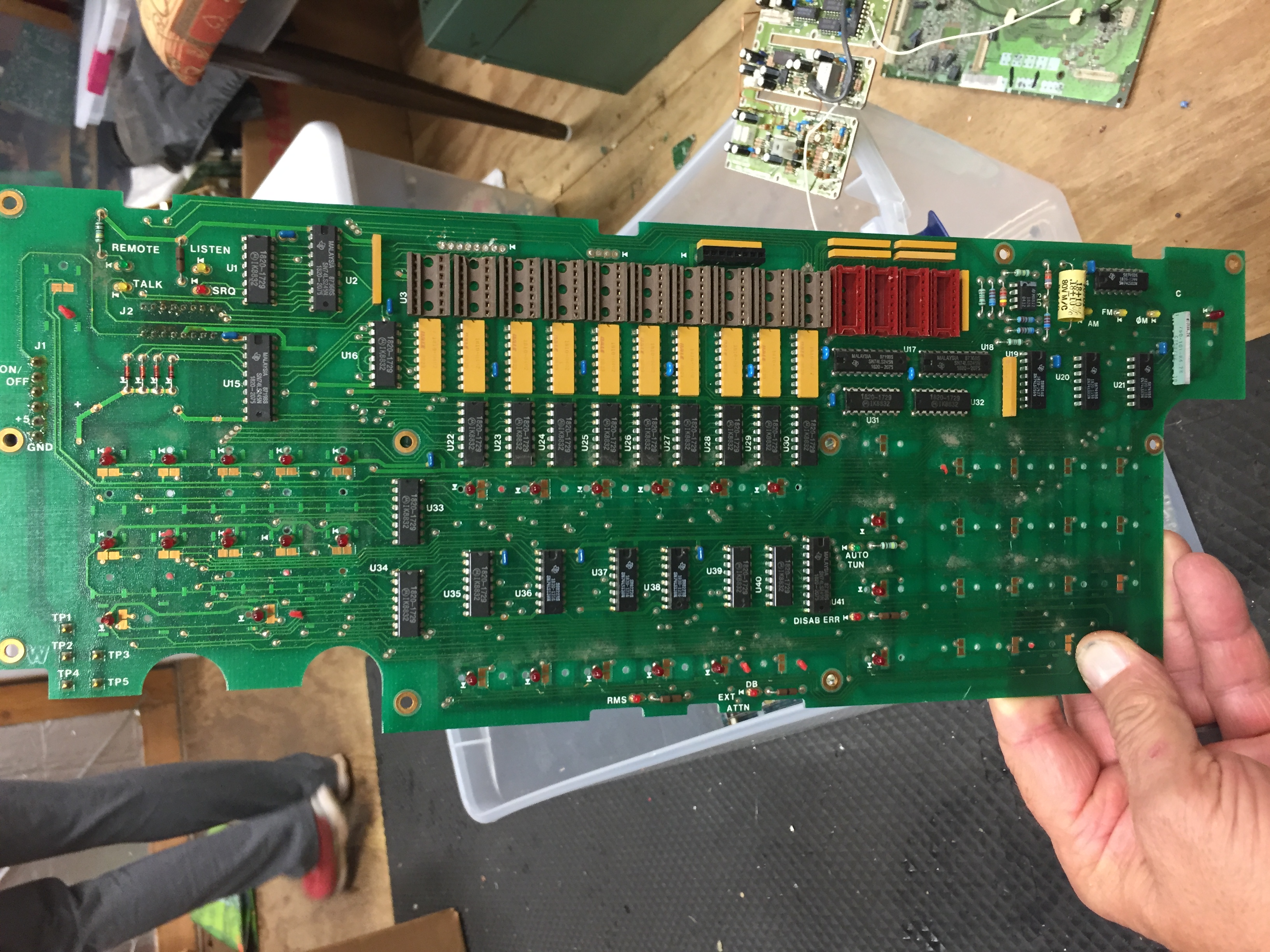

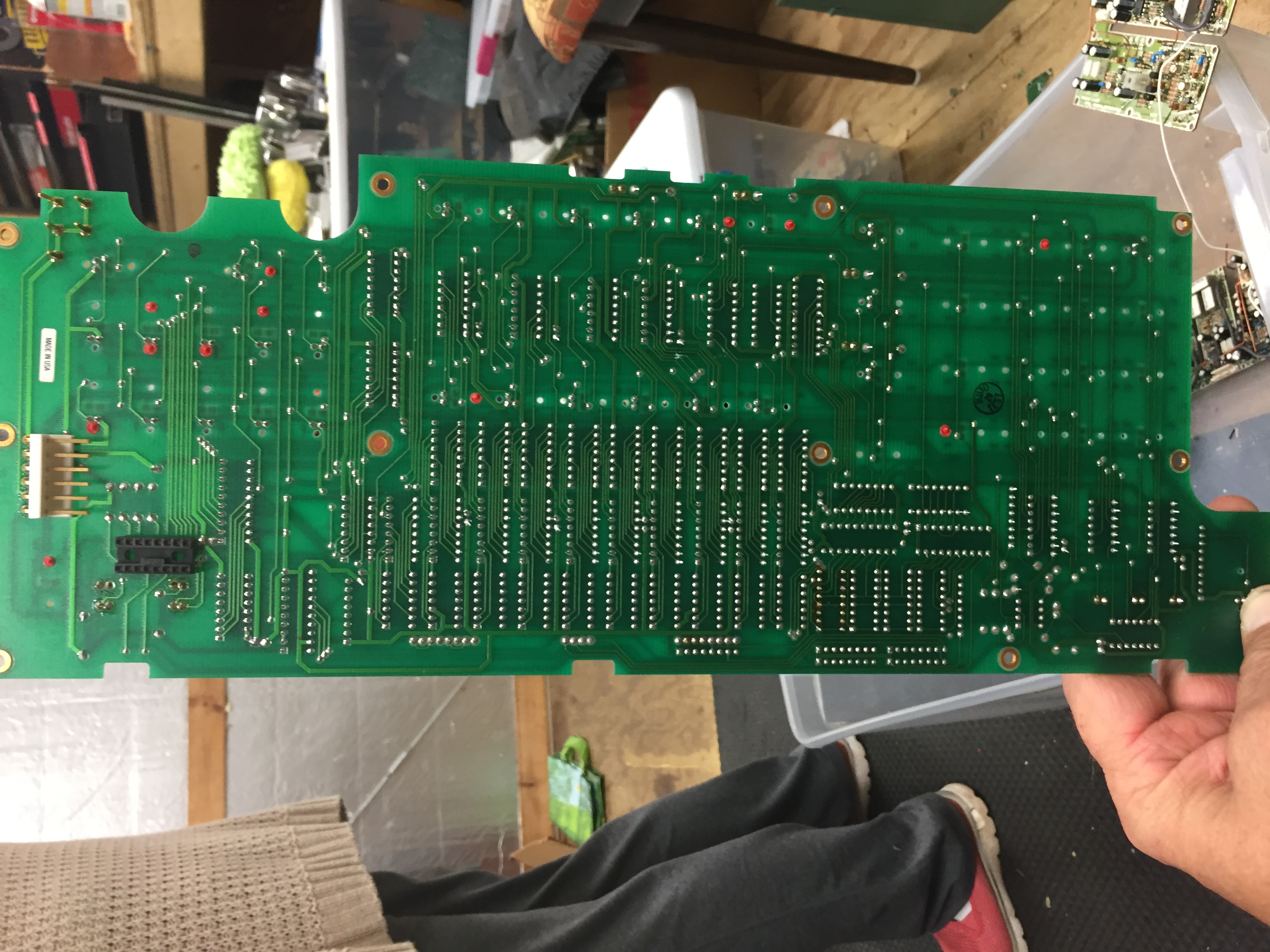

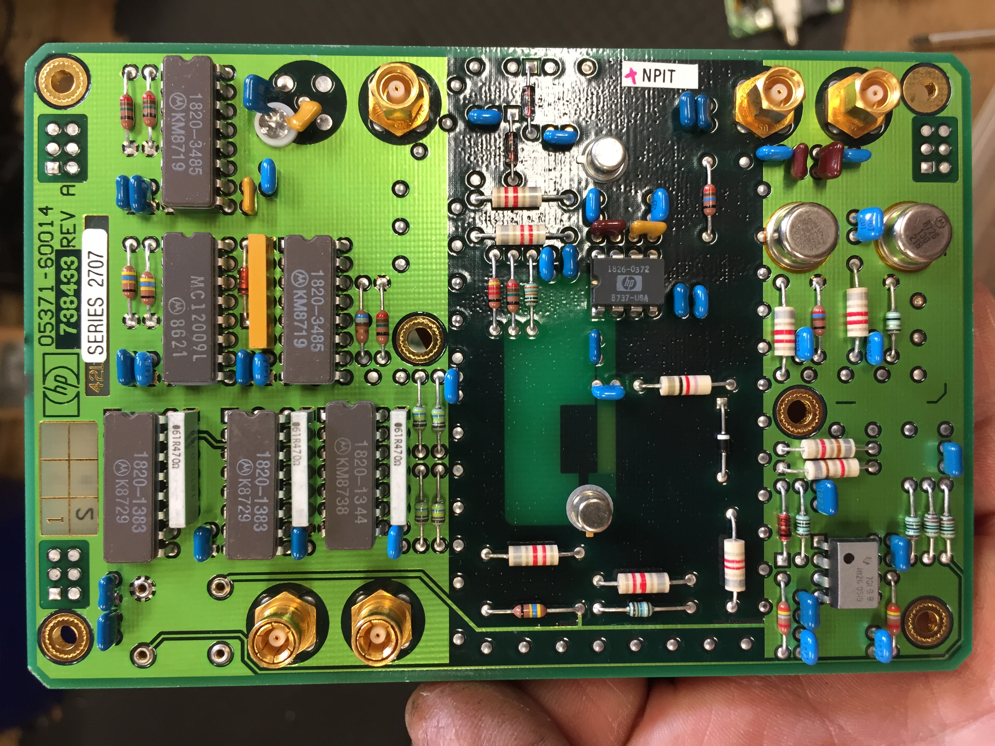

I have one or two in this lot I'm really not too sure of.
While it has gold fingers, it also has a number of ICs, would this push it up to Telco? It's number 8410

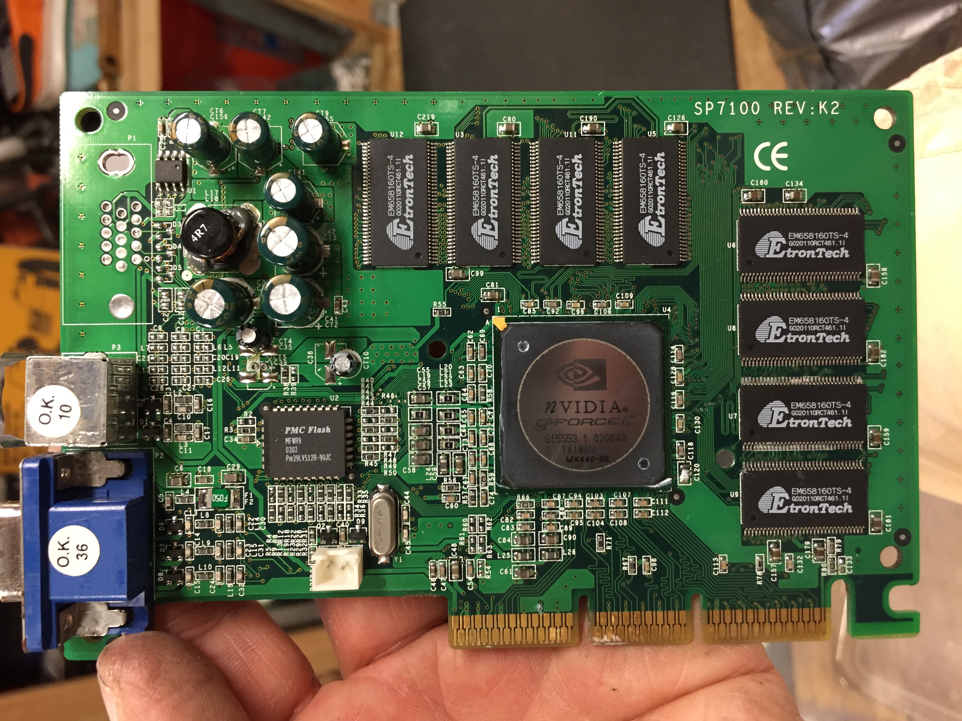

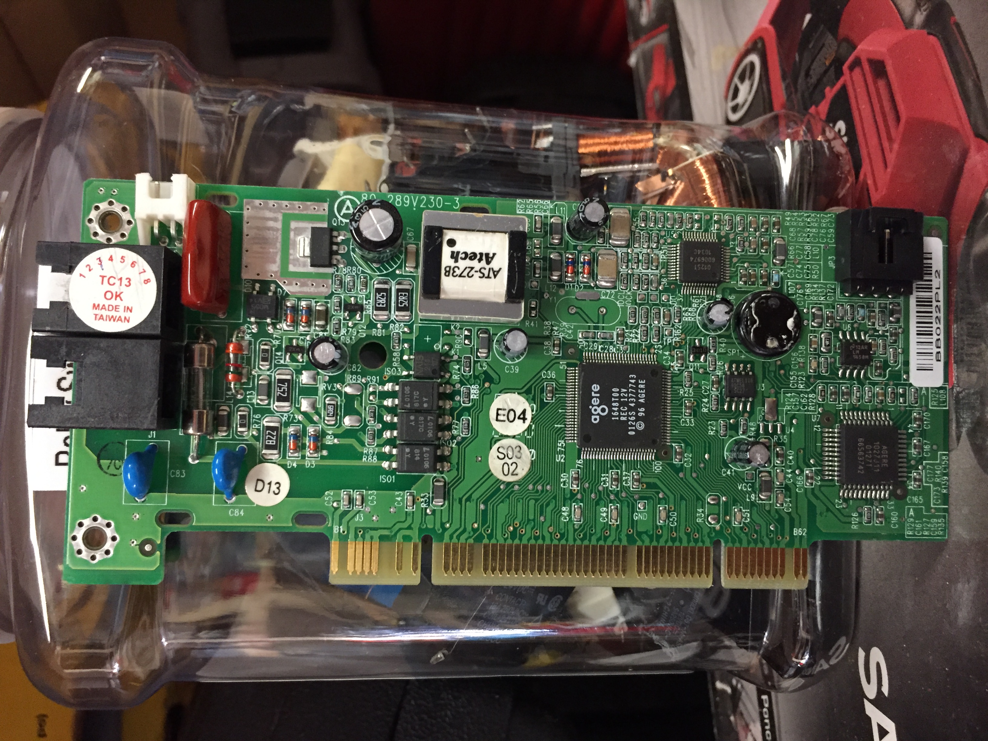

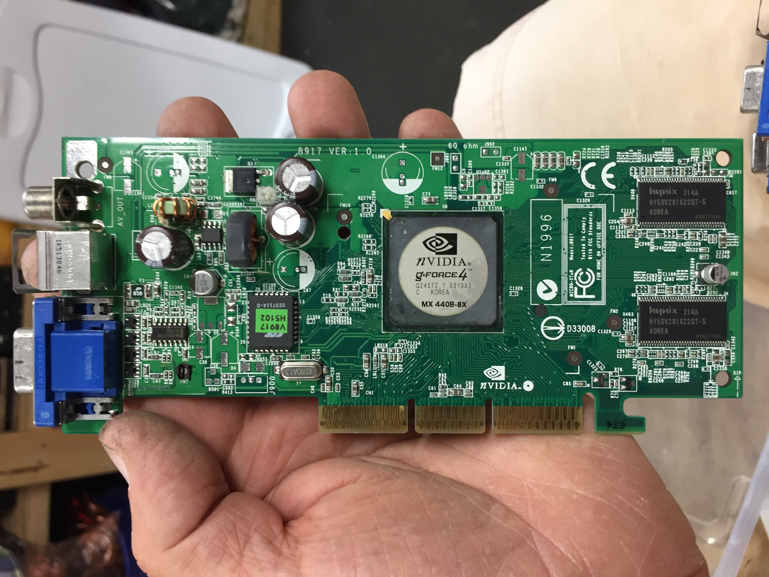

Also, there are four with what I believe is a processor of some sort and the gold fingers. Do these remain gold finger? Or another class of boards?
#s 8417, 8418, 8421, 8422/8423

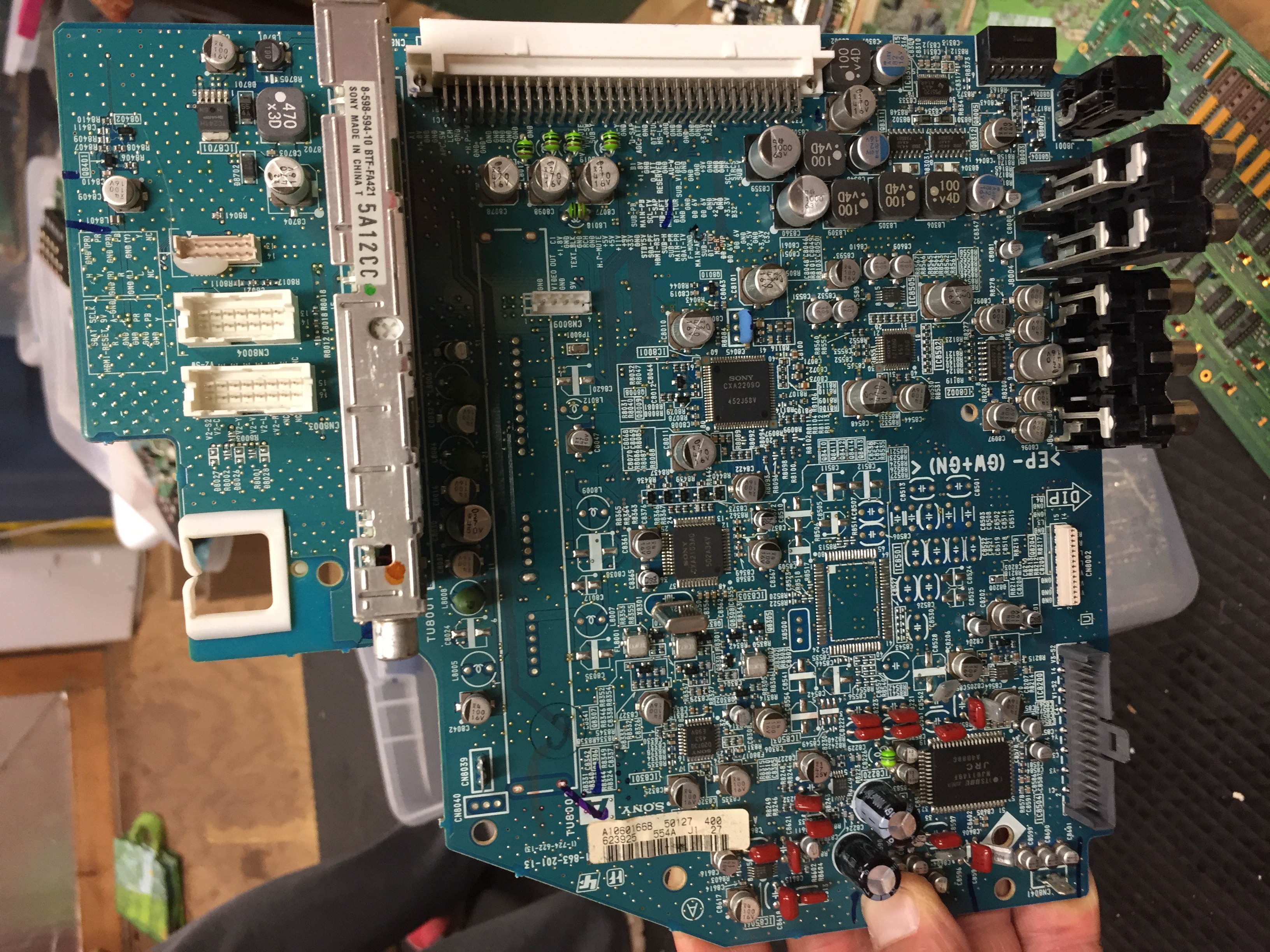

Then there are several that I would otherwise suspect to be low grade boards. However, they have large white connectors on the sides that have gold pins in them. Since I'm not shipping any low grade boards, is it best to cull the ICs and clip the gold pins from within the connectors?
Thank you,
RustyFuryIII
PostPosted: Sat Sep 29, 2018 3:30 pm
8427)peripheral, ever so barely
8426)back
8425)peripheral
8424)peripheral
8423)back
8422)Gold Finger Card
8421)Gold Finger Card
8418)Gold Finger Card
8417)Gold Finger Card
8416)Gold Finger Card
8415)back
8414)peripheral
8410)telco
8409)telco
8408)Gold Finger Card
8407)Gold Finger Card
8406)Gold Finger Card
