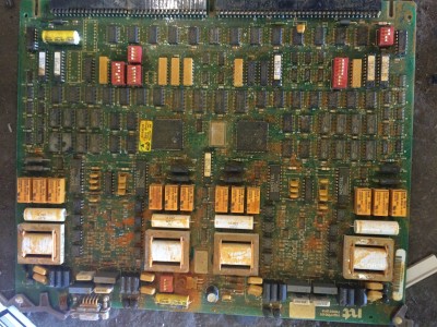

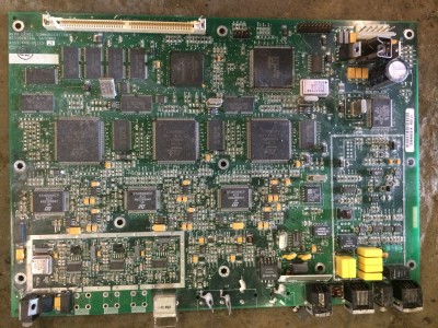

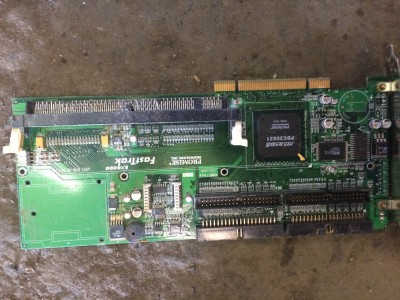

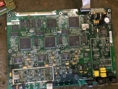

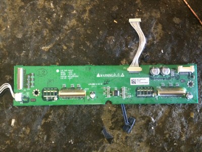

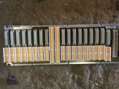

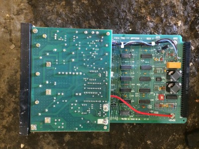

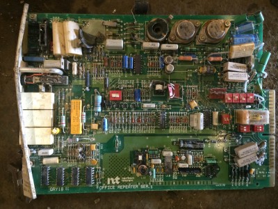

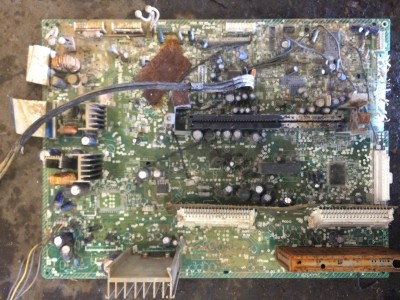

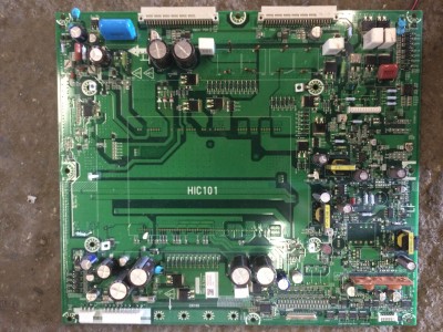

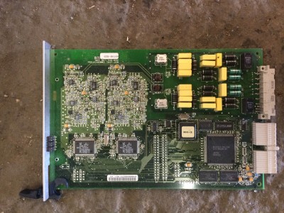

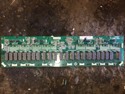

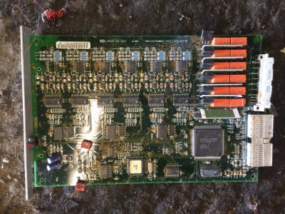

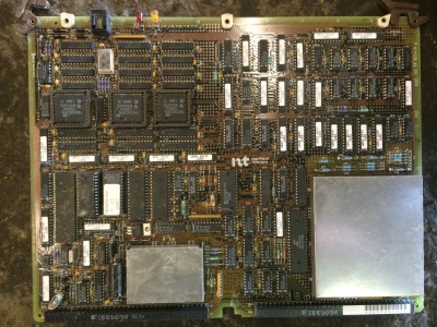

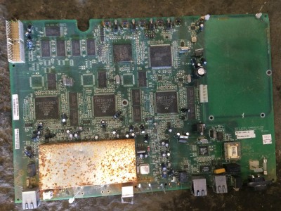

Can i get some assistance on grading these, have almost a ton of e-scrap to bring up but want to make sure its separated correctly. I apologize if that's too many to grade
File comment: 15
File comment: 14
File comment: 13
File comment: 12
File comment: 11
File comment: 10
File comment: 9
File comment: 8
File comment: 7
File comment: 6
File comment: 5
File comment: 4
File comment: 3
File comment: 2
File comment: 1
PostPosted: Mon Oct 27, 2014 4:10 pm
1: peripheral
2: peripheral
3: peripheral
4: mid grade, would like a photo of the back side to check for IC population.
5: backplane
6: peripheral
7: fingered card
8: telecom
9: peripheral, but if you cut the board horizontally above the transformers, you can sell the piece with the IC chips as telecom and the cut piece as mid grade.
10: telecom
11: peripheral
12: peripheral, but you will need to separate the board on top from the board on the bottom and check the top board for IC population.
13: telecom
14: peripheral
15: low grade or mid grade, depending on color of the board on the back side. If brown, it's low grade otherwise mid grade. Strip the heatsinks off and sell to your local scrap yard.
PostPosted: Mon Oct 27, 2014 5:12 pm
Posts: 85
On #15 try periph, if those or gold plated plated pins, kinda like a floppy drive board.
PostPosted: Tue Oct 28, 2014 8:35 am
Joined: Mon Oct 27, 2014 9:13 am
Posts: 2
Thanks for the help
PostPosted: Tue Oct 28, 2014 8:43 am
#15 is very heavily corroded, so I couldn't accurately tell what all is on the board. It appears to have come out of a TV or cable box that was left outside and abandoned.
