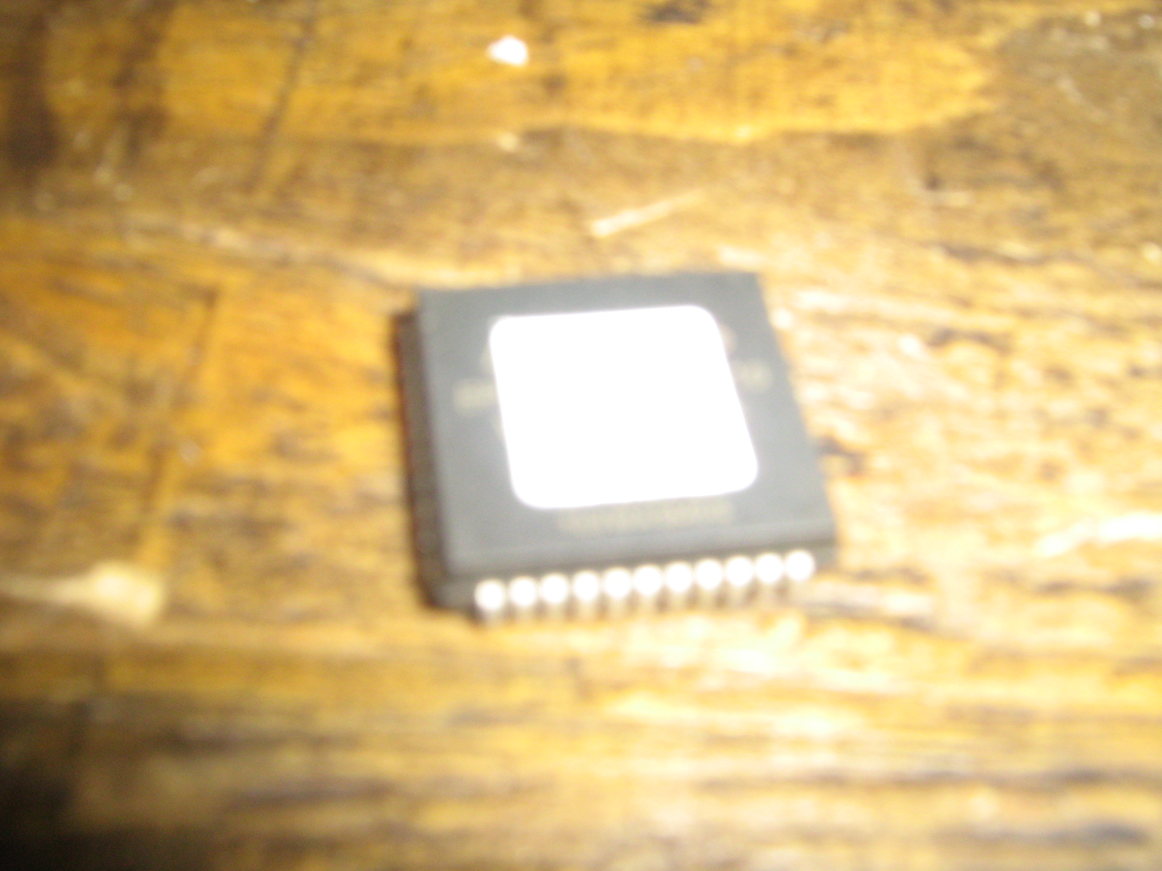

here are some pics i will post what i think with pic want to make sure

here is one more pic

The board on the top left from the credit card reader appears to be peripheral grade due to gold plating. The boards that make up the keypad are either mid-grade or peripheral, depending if there's any precious metal used on the contacts.
The first board you posted would be considered peripheral if the ports have gold plating on the pins. If Boardsort classifies it as low grade, you could remove the ports and sell them with your cable ends.
The second board to me appears to fall in the peripheral category. There are not a whole lot of IC chips on the board and it appears that the card came out of a cable box or cable modem.
The IC chip I couldn't tell anything since the flash or available lighting overexposed the camera. I'm guessing it's just a regular IC chip.
The board below the IC chip appears to be inline with Boardsort's description of a peripheral board.
Your last board if not graded as telecom by Boardsort would probably pass as a small socket motherboard.

I emailed these results to the original posted but would like to share with the forum as well:
I will refer to the last four number of the file name with each grade:
8690.jpg = Low grade board ($0.15 lb). TIP: Remove connectors, sell at Gold Tipped Ends ($0.85 lb). Remove IC chips ($5.00 lb). Properly dispose of what remains.
8689.jpg = Telecom Grade
8688.jpg = Peripheral Grade
8686.jpg = Telecom Grade
8691.jpg = Top two smaller board = Peripheral Gade, bottom board with the buttons will be Mid-Grade.
Thanks for the look!

thank you Chris just wanted to make sure don't want to get it wrong when i send my shipment in soon
