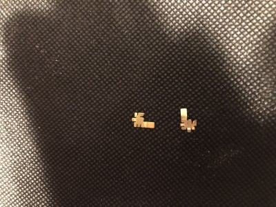

A relative of mine uses the #### (rhymes with mule) pod disposable e-cigarettes. About a year and a half ago, I asked him if I could look at the "pod". What I saw, appeared to be gold plated contacts inside each disposable pod. I asked him if he'd save those for me instead of throwing them away. He agreed.
A while back, I saw one of MooseScrapper's videos, and he confirmed what I originally thought to be true over a year ago. That the plating on the contacts inside these pods was indeed, gold.

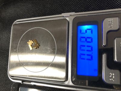

To start with, the pair of contacts from each pod, washed and dried, tipped the scales at .075 grams up to .085 grams per pair. This was from a random sampling of 10 pairs of contacts. Six sets of pairs came in at .080 grams a pair, three sets of pairs came in at .085 grams a pair, and one pair came in at .075 grams.

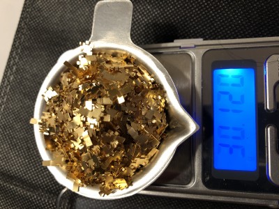

In the end, wound up with 30.120 grams of cleaned, dried contacts. I used .080 grams as an average weight per pair of contacts from the pods and divided that into 30.120 grams total weight, to discover I had scrapped 376.5 pods. This process took 4.5 hours.
Was it worth it? I have no idea, I don't care. This is a hobby for me, not a get rich quick scheme. I was curious what the outcome would be, and honestly, I still don't know since I have no idea as to the purity of the gold, the thickness or amount of gold on each pair of contacts.

As for math. 30 grams at the plating standard of 1/20th at 85% spot is $38.5
That’s Apx $8.50 per hour.
Assuming you go the next step and refine the contacts into gold.
