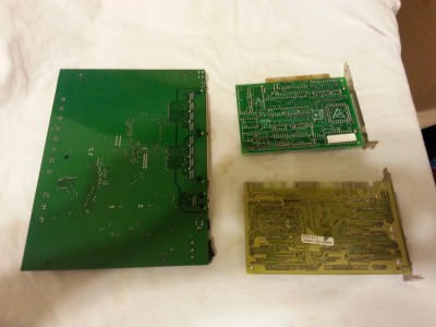

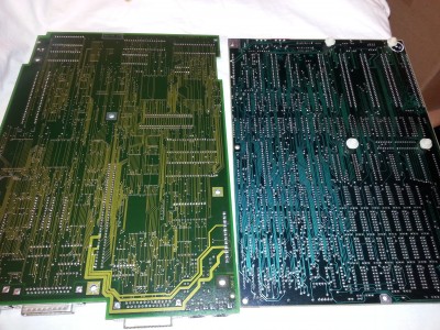

Need to verify these boards. Im pretty sure I know but i wanna make sure.
File comment: Im thinking telecom on these, am i right? and could i trim off the gold fingers without downgrading it? On the second board those top four rows are sockets with no ic chips in them. and is that blue thing a battery?
File comment: Backside.

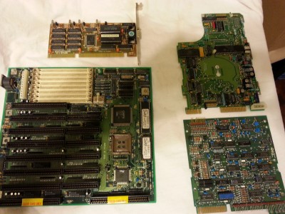

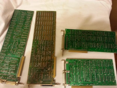

File comment: Bottom left im guessing wont go for more than backplane. top right is the hard drive board from an original IBM PC but its pretty low-tech so gold finger? IDK about the rest

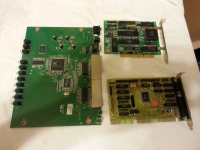

File comment: left is ethernet switch, but no flatpacks so im guessing peripheral. And the two on the right, telecom, even with out the gold fingers?

Here are my two senses. Of course, wait for the moderators or Boardsort to give a final grade.
--In the first pic: the two boards to the left are telecom. You could even remove the gold fingers to sell separately as Clean Gold Fingers. The other two cards for sure are gold finger cards and may pass for telecom with finger attached.
--Third pic: top left board is gold finger card. Bottom left board I don't what motherboard category is. The two boards on the right if they came out of a hard drive then they are Logic Boards if they didn't then Gold Finger Cards
--Fifth pic. Board to the left is Peripheral. The ones to the right are Gold Finger Cards.
