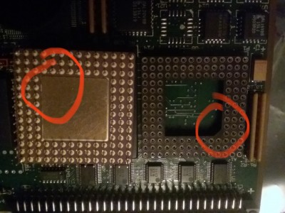

Help, what way does this chip go in this socket? Took it out and now can't figure out how to put it back in.
Came out of the voyager system in the ID forum.

Pardon my comment here but first off if the lower picture is taken BEFORE you removed the chip in the upper one just make the chip match the direction of the first picture.

I’m 75% sure my 25% chance is correct. See photo. This method works for x87 and AM87 chips, VIA, and Sparc so the best advice I can give you.

If it doesn’t boot and doesn’t fry the chip: line up the tab on top of the chip with the not square, right circle, cutout. That works the remaining 25% of the time when it’s different.

I was kind of thinking that the "Tail" on the corner of the gold would correspond to the area on the socket that you circled. But I am not a computer person so I may be wrong.
