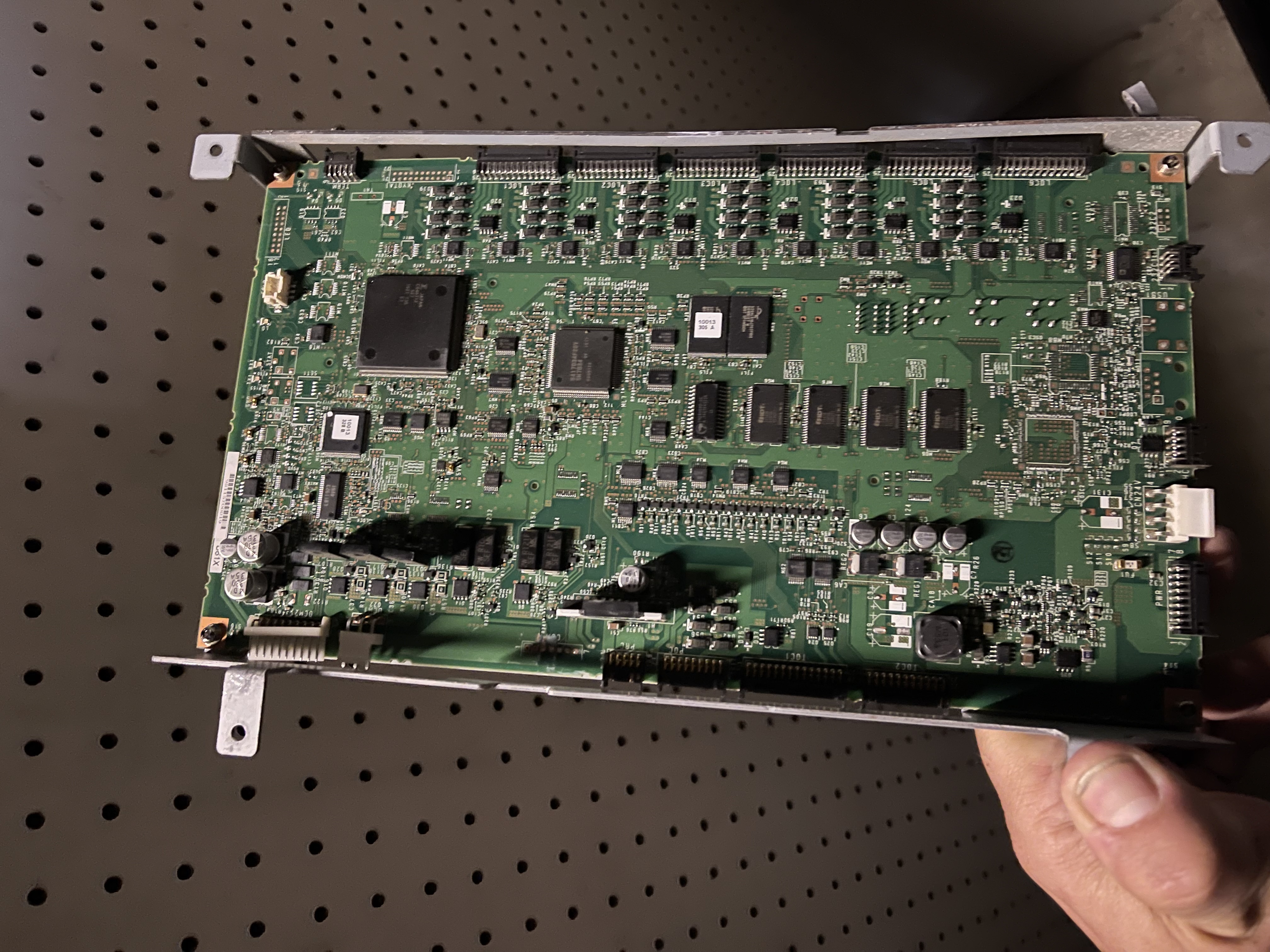

Hey everyone. I am starting a hobby with e-scrapping and need some advise. There is a LOT of information on this forum and many many opinions so I am a little confused. Am I going to make more selling boards whole, or should I remove parts and sell THEM individually? What should I remove from the boards? Gold Fingers? what do I do with the rest of the board if I take stuff off? As you can tell I have more questions then answers. I have attached the boards I have access too for view. Please understand that if I miss a poitn you are making or aska question, it is because I suffer from a traumatic brain injury... So some things are slower for me to grasp.

If you are only dealing with boardsort for your scrap circuit boards then usually these rules apply:
Always remove batteries.
Anything soldered to the board likely should stay on the board.
Anything socketed to a board will probably be removed from the board.
Anything screwed to the the board may or may not need to be removed.
Gold fingers generally should stay on a board.
But of course there's always exceptions to any rule.
img4505 has steel screwed onto the corners of the board and in this case should be removed. This board will be at least low telco grade.
