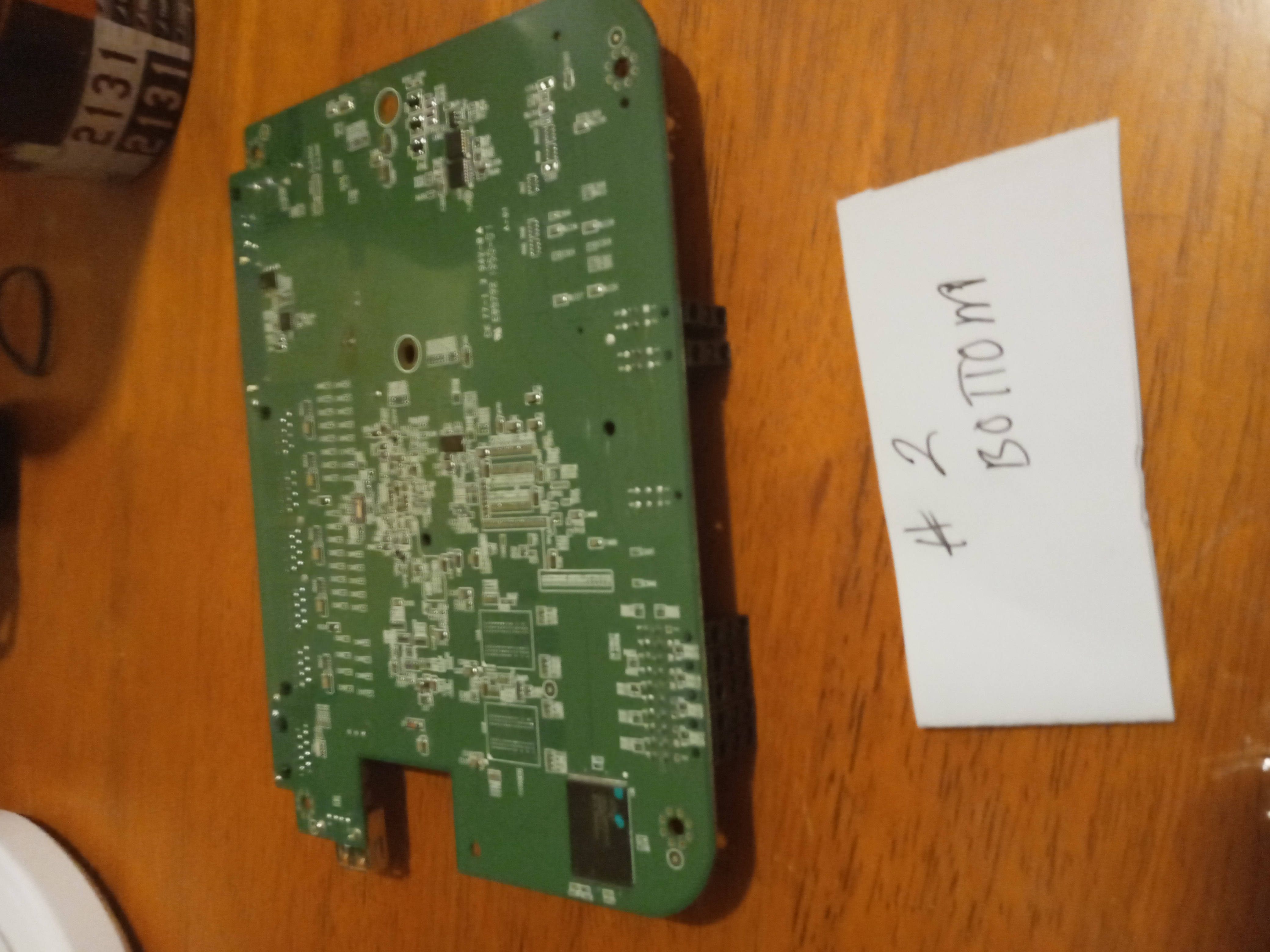

1) Not sure, looks like a laptop board. Then there are missing chips or chips that were never installed, image isn't clear enough for me to tell which.
2) BATTERY! Get that off and, if it comes off easy, the aluminum if you want. I don't think it makes a difference in this case. High peripheral.

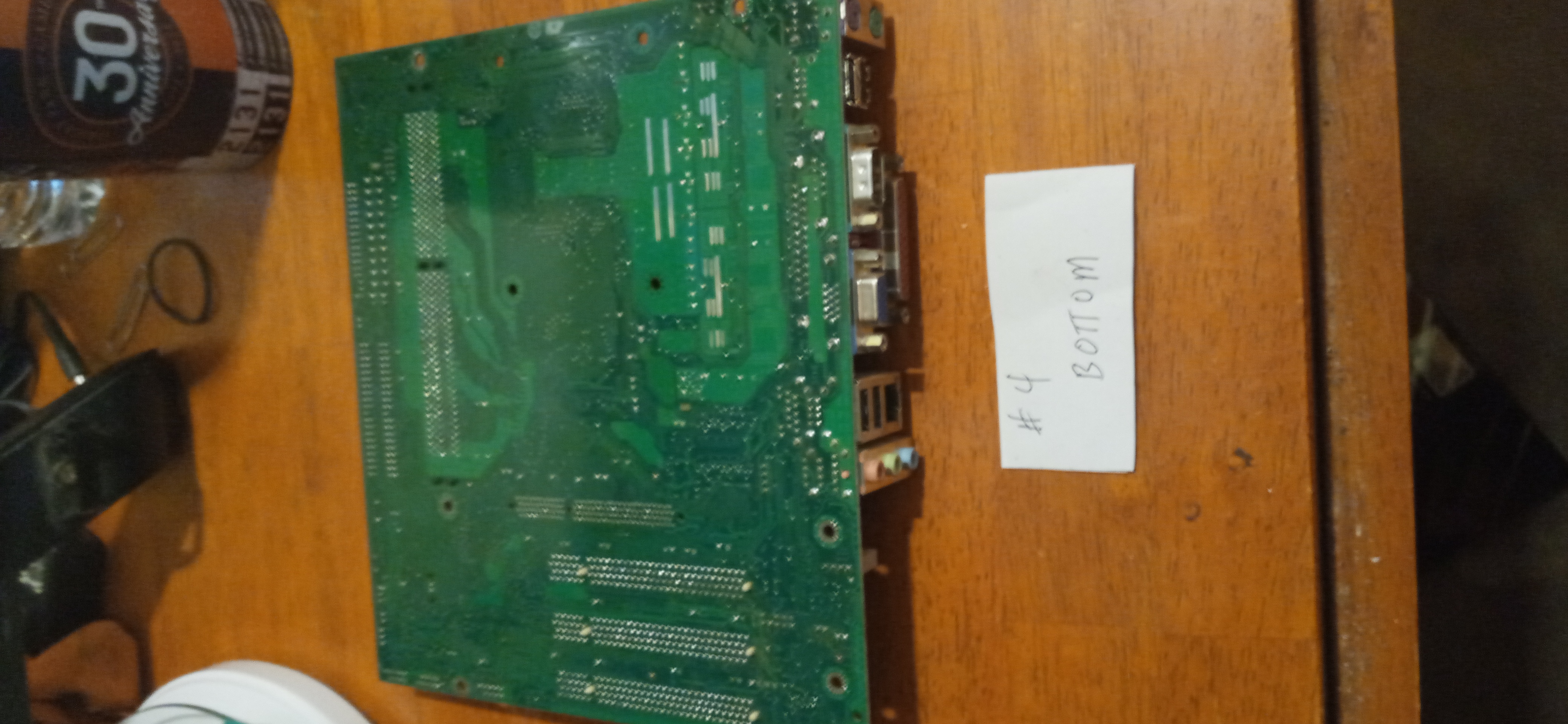

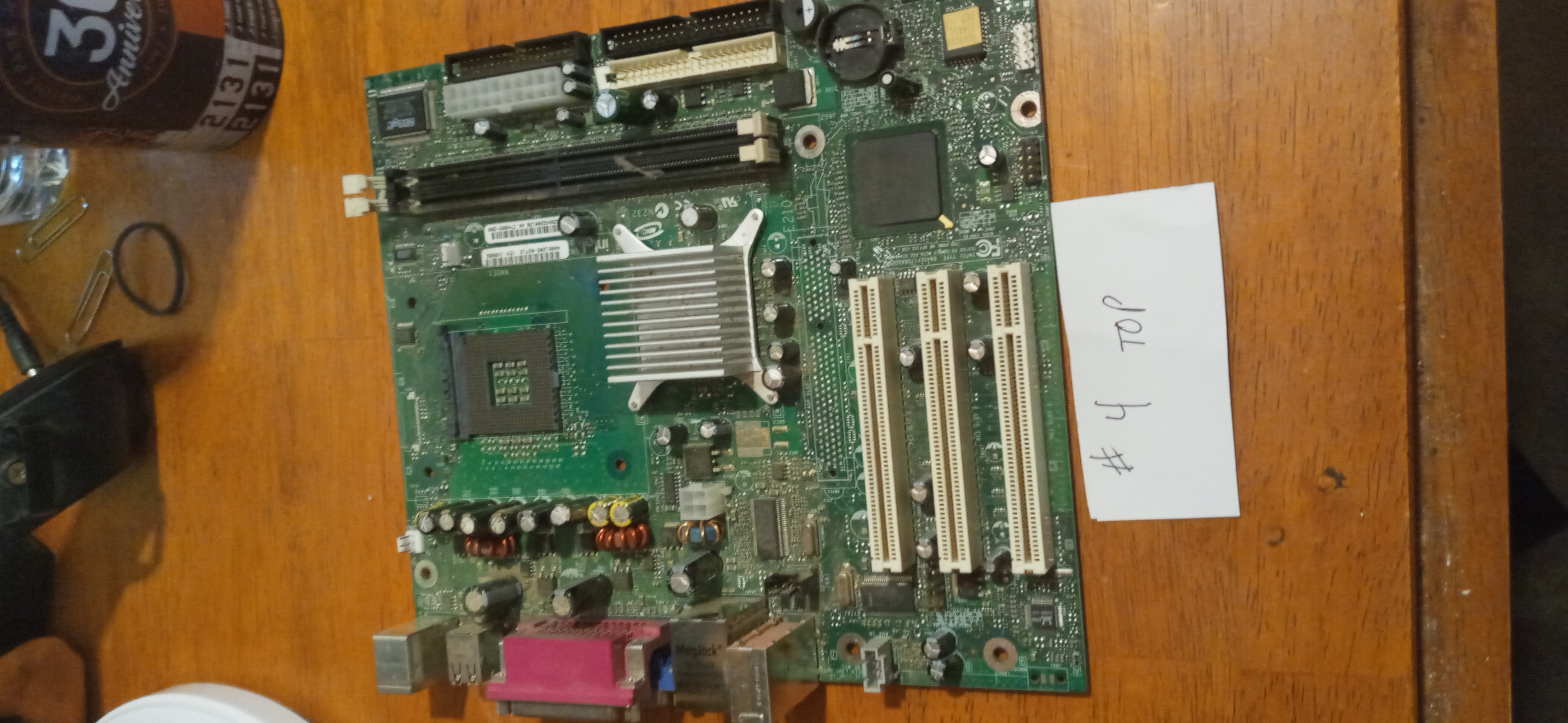

4) Another image quality issue for me. I can't tell for certain what's going on with the socket (which is the primary identifier). Someone with a better memory on MoBo varieties could probably tell you.

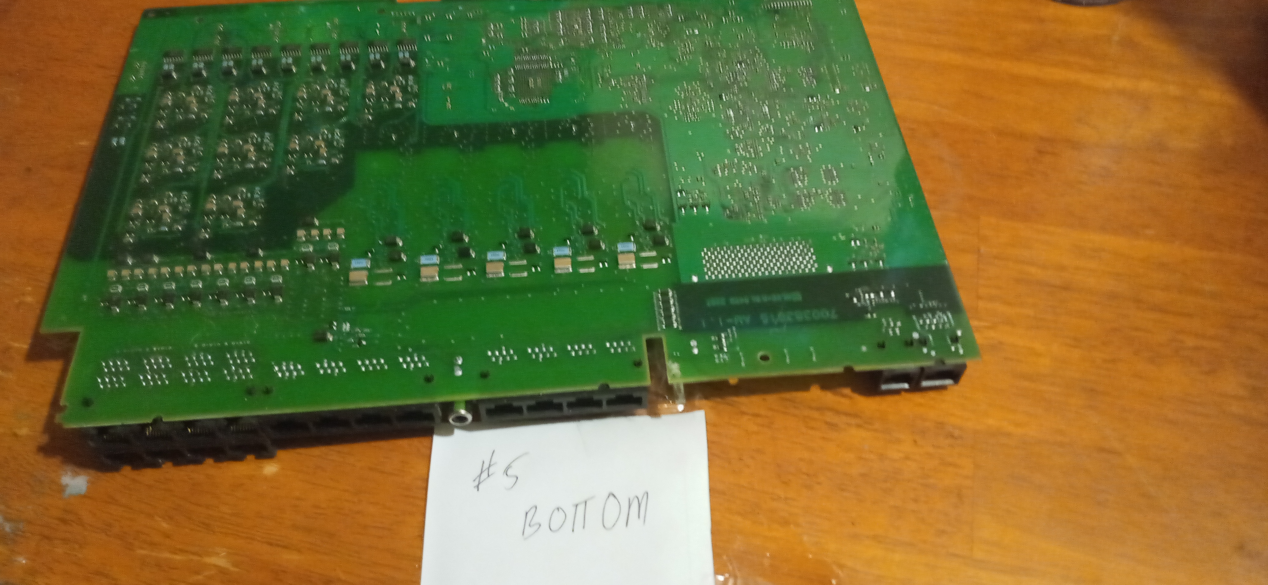

5) Would be okay in high peripheral but I'm thinking low telco is possible.

#4- This is a Green metal socket motherboard, the metal clamshell has just been removed. I assume this remains in its category and does not get upgraded to green small socket but i could be wrong (if i am wrong then i have a lot of metal socket clamshells to remove )
I cant speak on where #2 (router board) or #5 (switch board?) would land outside of saying at least low peripheral.

4) After another look at this I can see the circuit board diagram for the release switch for the processor and the cavity in the gray plastic that set in. So it's a P4 Green Mobo. There's really no reason to yank the white plastic and release lever off the socket; especially if you have a lot of them. Doubt anyone will pay $2.25/lb for it.

As for number 4 upon second look i would agree with you on the small socket mobo, first glance it looked like the black plastic that remains after a metal socket is removed but now i see it has 4 widely spaced holes surrounding it which would indicate a pinned processor as opposed to the 3 closely spaced holes that would be present on a metal socket.
