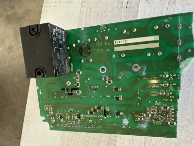

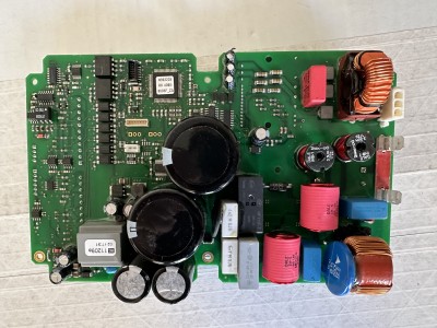

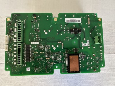

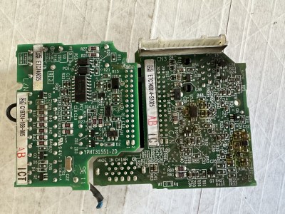

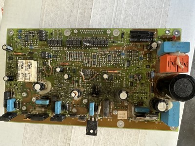

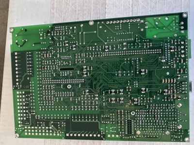

Attached are pics of front and back of a sample of boards I am trying to sort. These are all from commercial grade equipment, drives, inverters, power supplies, etc.
Please let me know if you can judge the grade, and if I should remove the big caps and transformers.

3127/28: High peripheral
3120/29: unplug the boards from each other, side with all the green: midgrade (possible low peripheral but I think the junk weight will be too much), other side: high peripheral
Rest: Midgrade
