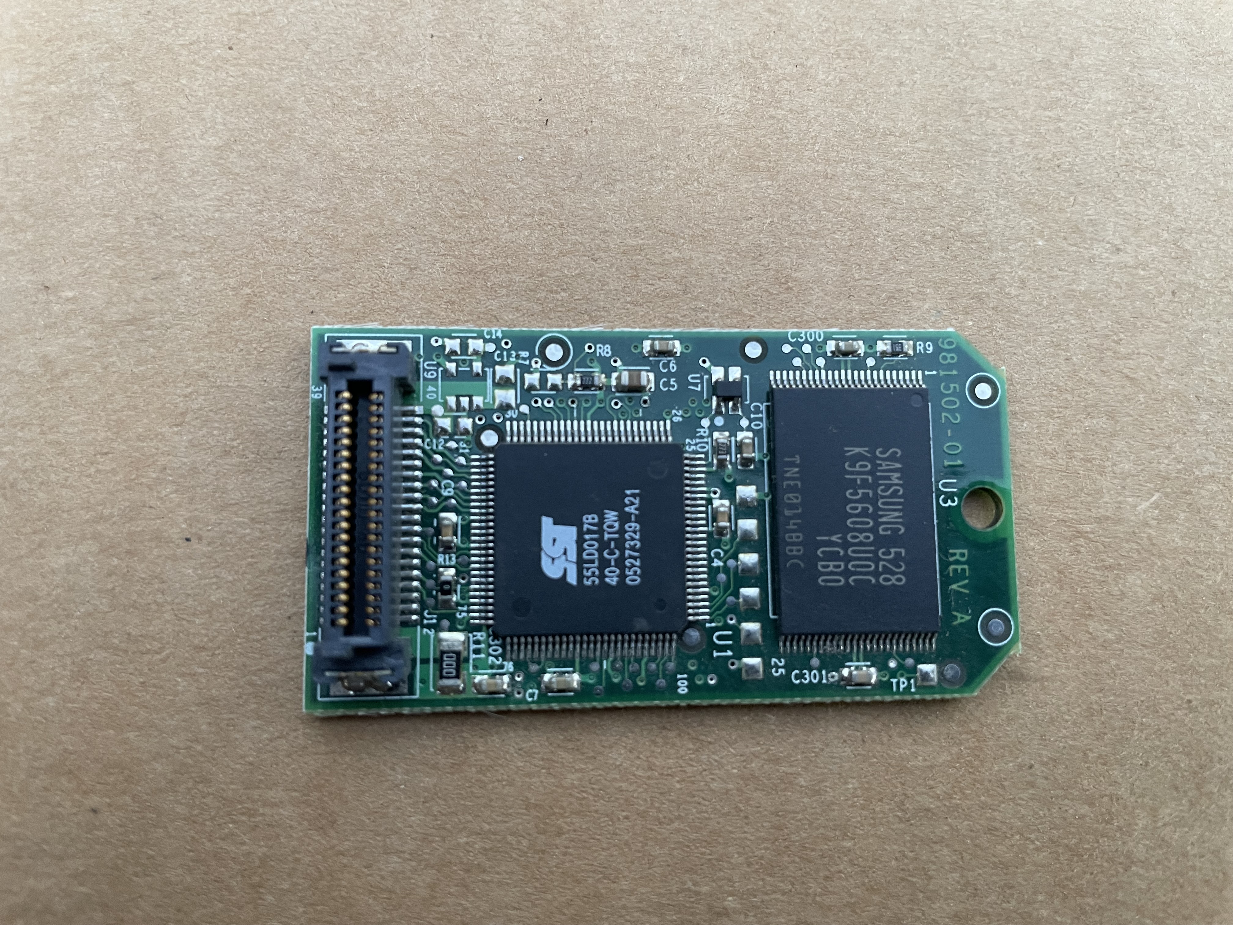

OSCAR is saying both are low grade STAT hard drive boards, how ever neither came from a hard drive.

So. This is my evaluation of your pictured PCBs. Based on pictures and videos. Note. Not based on practical everyday scrapping experience. Or personal interaction with Boardsort.
The first one. High Telecom. Why? Small board with high density and gold connector. Also. No junk on board. Low profile.

The first board I think is some sort of RAM its out of a WYSE terminal. Although it doesn't go in RAM category.

It is most helpful to know where the board came from. But. I have my mystery box of PCBs I can only make guesses at.

Your RAM board. I would not put it in RAM category. It has NO gold fingers. That is important. Just look at the Gold Finger prices. I feel strongly gold fingers better be on a board submission for purchase in the Gold Finger Ram category. So. I am still thinking High Telecom for the other board.

First board high telco. I have sent in many small boards like this with high chip coverage and no junk with no complaints.
As you do more of this you will begin to see ram chips on a lot of odd boards, doesn't make them ram.
Once in a while I find a very old ram board, usually in scientific equipment, with a gold connector but no fingers. Still not sure what to do with them, but as I see so few have just been putting them in high telco and moving on.
