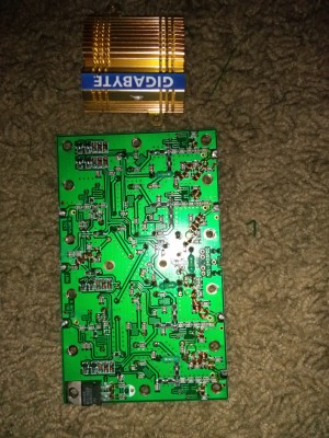

Older boards
 Post subject: Re: Board id
PostPosted: Mon Nov 30, 2015 2:37 am
Posts: 10527
Top 6 peripheral more than likely
Bottom 3 are mid grade and low.

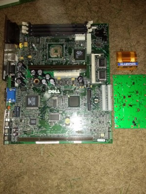

What if some of the chip got stuck on the heatsink. What grade would the big board be. And can i throw that heatsink with my gold pins. I scratched it and it's a different color, so I'm guessing it's gold plated. And the little board I'm thinking peripheral. But not sure.
PostPosted: Mon Nov 30, 2015 2:17 pm
Posts: 10527
The little one is going to be mid grade.
The large one us now peripheral without the cpu :/
The gigabyte heatsync is gold plated. But it's very thin. Gigabyte and AsRock use the same heatsync with a different print on it.
Put it in it's own spot in a bag in your shipment though since the cpu is still attached.
Normally those two heatsyncs would be between 60-80 cents a pound. i usually toss them in my gold connector bag.
