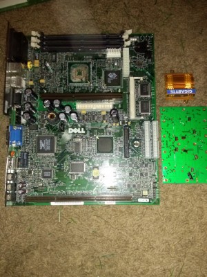

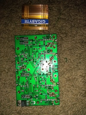

What if some of the chip got stuck on the heatsink. What grade would the big board be. And can i throw that heatsink with my gold pins. I scratched it and it's a different color, so I'm guessing it's gold plated. And the little board I'm thinking peripheral. But not sure.

The little one is going to be mid grade.
The large one us now peripheral without the cpu :/
The gigabyte heatsync is gold plated. But it's very thin. Gigabyte and AsRock use the same heatsync with a different print on it.
Put it in it's own spot in a bag in your shipment though since the cpu is still attached.
Normally those two heatsyncs would be between 60-80 cents a pound. i usually toss them in my gold connector bag.
