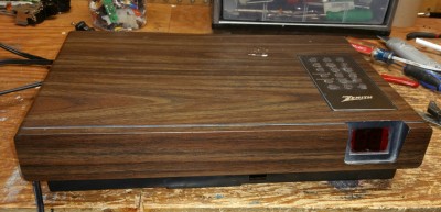

Zenith analogue cable tuner
Look at photo notes for details
File comment: Box

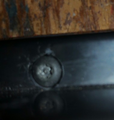

File comment: 8 or 8.5 security torx

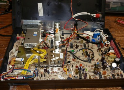

File comment: Inside

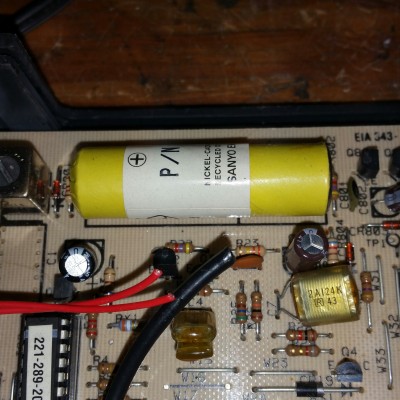

File comment: Watch out. Big nicad battery

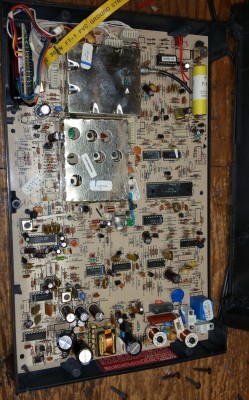

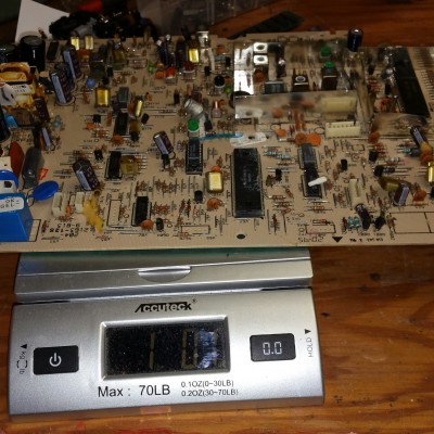

File comment: Big main board

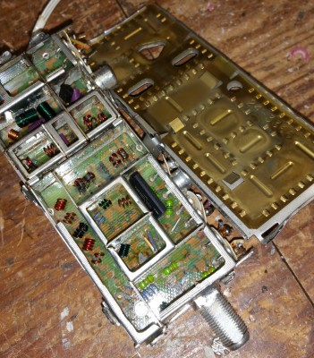

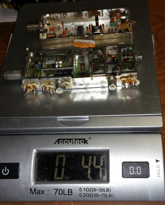

File comment: Pry them open for 400 stainless lids, #1 yellow brass shields and midgrade boards

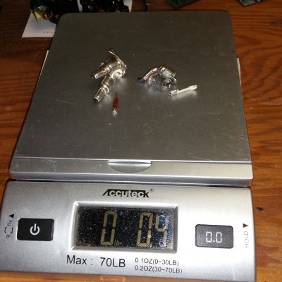

File comment: Silvet connectors

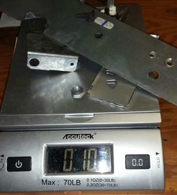

File comment: Steel

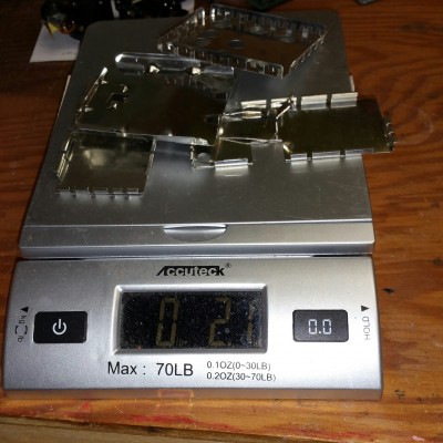

File comment: 400 stainless

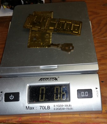

File comment: #1 yellow brass

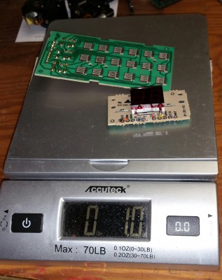

File comment: Peripheral. Large bump ICs on back
