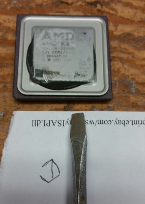

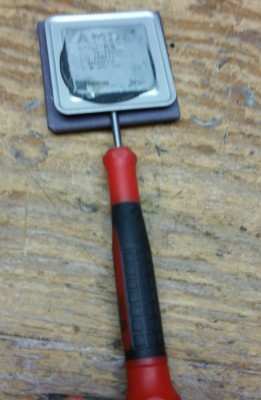

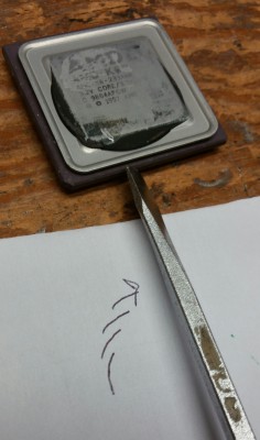

Starting in a recessed corner (where your z is)
Push (gentle for now) a 1, 1.5, or 2mm (000, 00, or 0) diagonally corner to corner as far as light and gental will go.
Remove screwdriver

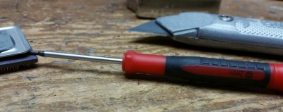

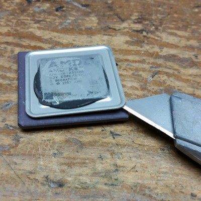

Using a long blade, non-snap-off box cutter run the blade around all four edges in a CIRCLE. This will cut through any edge sealant they've used.
Insert your 000-0 back in this time in the middle through the centre glue. Push hard but gentle
It may pop here for you... if not using a standard #1 pushing in and out with gentle twisting motions.
