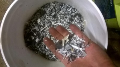

A cheap woodchipper works wonders!
If you're a fan of chemistry, placing the grindings into a sealed container (with a pressure relief) and heating to a very high temperature for a period will "refine" the plastics into a very volatile liquid. (think, making charcoal) If the temperature is too low, it will turn into wax, if air is introduced, an explosion will likely result.
I would not suggest running it through an engine, but it's certainly wonderful for heating!

Yes!
And no!
That's what I was suggesting for our more rural users here;in a way.
Many fuel refiners will take at least some interest in plastics as a source for alt fuel refining.
That stated: you've obviously got a method that's working for you but for the general public I would HIGHLY caution AGAINST running your plastics through a wood chipper . Plastic IS fuel to begin with. An oil product.
Enough heat and enough static discharge and you have one hell of a fireball. .
Personally I'd suggest if you're going that route to use the same method I use to "chip" clean stripped low and midgrade boards: a shredder.
Specifically a high volume a14 bank shredder. Like a fellows bulldog. Info on getting that method to work if anyone asks but again I believe you're asking for trouble in general to mix powdered plastic plus heat plus petrol fumes.
