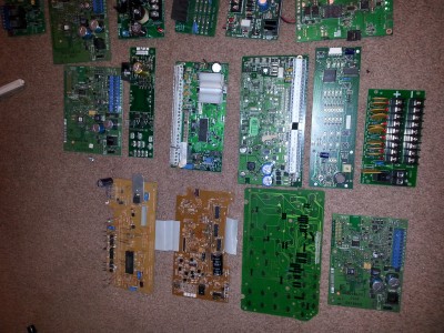

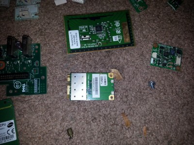

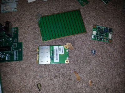

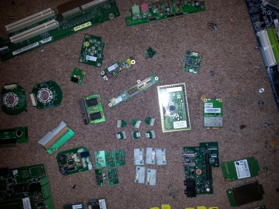

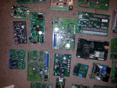

Okay, I have a bunch of random boards. Some from PC'S a lot from fire alarm panels, some that I really dont know. lol. I have not dealt with selling these as scrap. Ive been looking around a little bit and can't find a whole lot of info on my stuff. I have a ton of pictures. I'll upload them and hopefully someone can help me (board)sort everything lol. I appreciate any help received! I know I dont have very much money here, but chrismas is coming up and any little bit helps. Also, if anyone has suggestions to maximize profits on these items, itd be appreciated as well. I have some power supplies and floppy/cd/dvd drives as well.

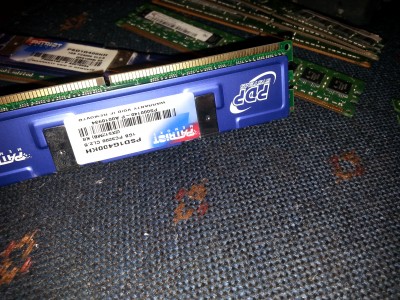

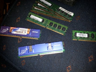

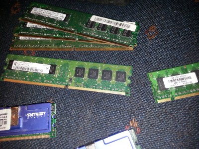

1)gold finger ram and rambus. In this case you can use a #2 standard (flat head) screwdriver To gently remove the friction brackets and pop the aluminium covers off. Giving you more gold finger ram, two steel clips and clean sheet (#1) aluminium.

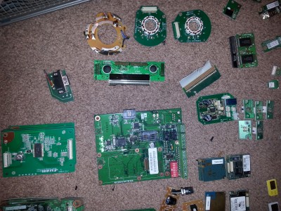

2)totally mixed but mostly peripheral here. You broke the photos up also so see the smaller set below
3)same as number 2 and some telco mixed in

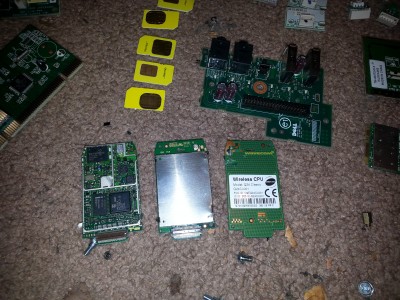

4)telco. As long as it's gold flashed like these and have ICs they'll fall into telco. The switch board is midgrade. You need to remove the shields to get telco though. I'd suggest a #0 Philips to pry them off. just stick it in the outside hole and pry.

6)mixed peripheral and midgrade

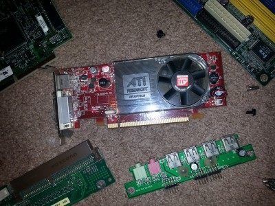

7)left cannot tell. Top --touch pad-- peripheral bottom finger card right peripheral (barely) screw is steel shred.

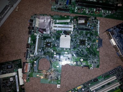

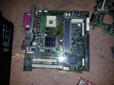

19)motherboard; remove fan and heatsink under it. Probably large socket

21)more gold ram

23)motherboard remove large fan and heatsink probably large socket

28)top I see a cell phone board
Sims are not on the list but you can send them in. Between 20c and 50x depending on factors. Snip the long plastic edge off for better grading
Dell is peripheral gold finger card to the right
Not sure on bottom board from photo

Awesome! Thanks so much. I've made some revisions and took better organized pictures. Would you mind if I posted them and had you take a look again? I think that a lot of the items got skewed in the pictures that I previously posted. Also, in your opinion, what do you think all this stuff is worth? Approximately.. I also have 5 or 6 hdd's, and some more ram. But, mainly value on just the boards in the pictures. I'm still not understanding how I can tell the difference between mid grade, low grade, peripheral, Telcom, ect. All the boards seem about the same to me.. Also, I made yet another mistake. A lot of the stuff came from security system panels, not fire alarm panels. If that makes any difference. I've been scrapping a lot of metal lately, not doing very good at it either.. Prices are down around here. Again, I really appreciate all your help!

Terms for board classes are misnomers. I primarily work on neglected server rooms, minicomputers and ancient technologies. I get a ton of lowgrade boards from telecommunications (telco) equipment and often find cell phone class boards in server switches, etc. Knowing where it came from is really beyond the basics, best for telling you what it was/did rather than what class it goes in.
I'll eventually get around to making a locked sticky with some discriptive breakdown suggestions since I seem to do this every few weeks or so. Lol
But basically low grade boards will always be brown, or coloured but empty/blank.
Good examples are power supply boards from standard computers. The non video output mainboard from old vcr units. And similar. Commonly have many many components that are under 50 cents per lb. making recycling low value and tedious
Mid grade
Is any low grade board with LESS low value items and some items of higher value such as ICs and bridge chips, controllers etc. They're usually green and occasionally blue but a rare brown board may pass into this category as well.
Peripheral is anything that has gold, or platinum group metals (not counting nickel) that is easily (relatively) removable such as I/o ports and sockets; that is not valuable enough for a higher grade
Telco is the single hardest classification to make. Always was and always will be. It's a class for high grade boards that aren't any of the higher classes above it.
Basically and not inclusive they have majority weight in IC chips or massive amount of gold (gold flashed gold sandwich boards with gold pins and ports); or some combination of both.
But none of that is hard and true in every case. Most telco equipment is actually peripheral class or lower. Server and ultra high grade consumer power supplies are peripheral because of the large amount of gold connectors. Laptop ram cards that use pin ports instead of fingers are telco not ram.
Direct pin (fingers) to cell memory cards are gold finger ram but cells on a board with fingers are telco. Etc.
As for photos post as many as you like. Just try to keep rows even or label the individual boards (numbers or letters) in the photos.
Also try searching the forum posts. TML spider gives an estimate of over a gigabyte of non text data, photos, in the tree so there is a fair amount of pictorial information here. I'm not going to spider boardsort to find out for sure but that's a LOT of photos.
In your case posting new photos of your remaining boards would be a good idea since you run the range from low grade to cell class.

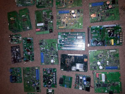

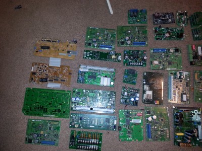

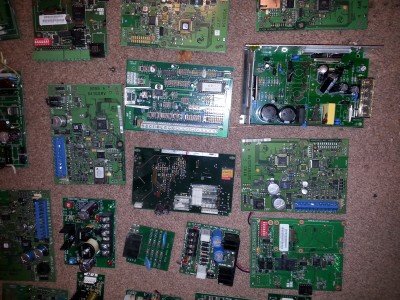

New revised pictures. I got most of the multiples out of the lineup. So, that decluttered quite a bit.
PostPosted: Tue Nov 15, 2016 8:16 pm
Posts: 10528
01) green with, green with, pinless, green with green with
02)pinless pinless pinless green with green with
03)can't tell from the top
04)finger card finger card finger card
Finger card peripheral finger card (remove fan)
05)small socket
06)large socket
Measure sockets to be sure I'm guessing
07)large socket (laptop class)
08)metal socket
09)measure socket
10)midgrade midgrade midgrade
Peripheral peripheral midgrade
11)Midgrade mid peripheral (remove heatsink)
Midgrade mid mid
Midgrade mid mid
12)peripheral telco peripheral midgrade midgrade
Cell boards telco peripheral midgrade Lowgrade
Gold connector, rest midgrade
Midgrade mid mid peripheral midgrade
Midgrade mid lowgrade telco peripheral
13)backplane midgrade wire
Backplane peripheral (fudging guess on these two)
14)lowgrade lowgrade
Midgrade midgrade
15)lowgrade midgrade
Midgrade lowgrade
16)repeat
17)repeat
18)repeat
I missed a photo somewhere sry. I'll fix it later

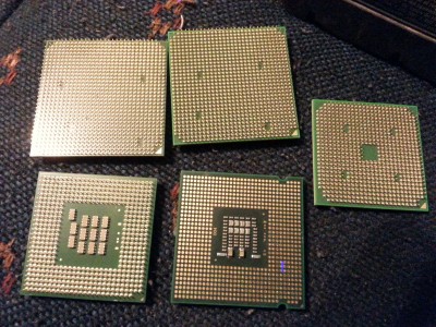

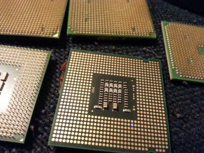

As far as the cpu's go, what class do they fall in? All but one has pins (the little spiky things).
PostPosted: Tue Nov 15, 2016 10:26 pm
Posts: 10528
Pins with metal top are green fibre with metal
Pins no top are green fibre
No pins is pinless
