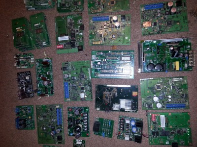

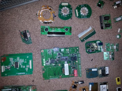

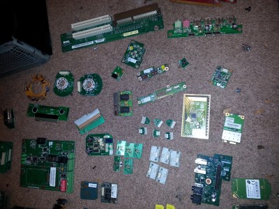

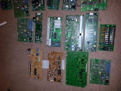

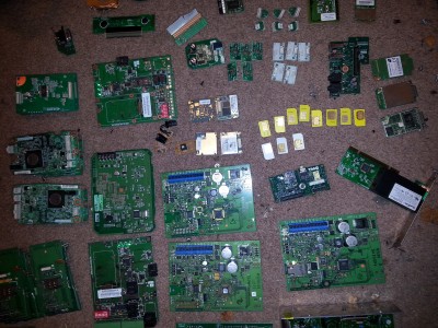

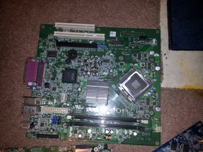

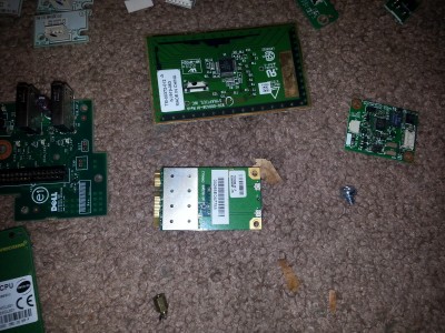

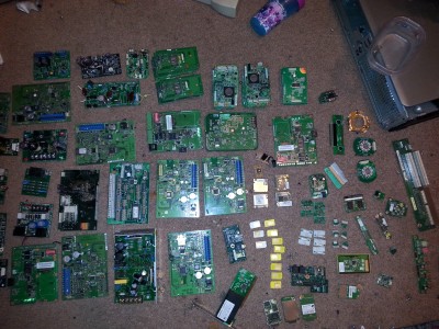

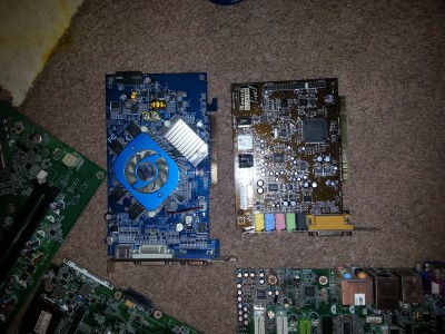

Okay, I have a bunch of random boards. Some from PC'S a lot from fire alarm panels, some that I really dont know. lol. I have not dealt with selling these as scrap. Ive been looking around a little bit and can't find a whole lot of info on my stuff. I have a ton of pictures. I'll upload them and hopefully someone can help me (board)sort everything lol. I appreciate any help received! I know I dont have very much money here, but chrismas is coming up and any little bit helps. Also, if anyone has suggestions to maximize profits on these items, itd be appreciated as well. I have some power supplies and floppy/cd/dvd drives as well.
PostPosted: Tue Nov 15, 2016 12:26 pm
Joined: Tue Nov 15, 2016 8:06 am
Posts: 9
Sorry, some of the pictures might be out of order. Having a hard time uploading them. Also, if possible... Please use Non-techy terms for me. I know some stuff, cpu, heatsink, hdd, ram, ect. but a lot of the stuff is a mystery. Thanks!!!

Ideally the suggestion is to keep photos to 5 or items to 10 per thread to make it easier for everyone to follow without counting pictures to find the match in the reply.
That being said hang with me as I run through this list

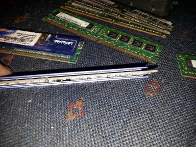

1)gold finger ram and rambus. In this case you can use a #2 standard (flat head) screwdriver To gently remove the friction brackets and pop the aluminium covers off. Giving you more gold finger ram, two steel clips and clean sheet (#1) aluminium.
2)totally mixed but mostly peripheral here. You broke the photos up also so see the smaller set below

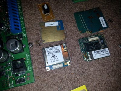

3)same as number 2 and some telco mixed in
4)telco. As long as it's gold flashed like these and have ICs they'll fall into telco. The switch board is midgrade. You need to remove the shields to get telco though. I'd suggest a #0 Philips to pry them off. just stick it in the outside hole and pry.
5)metal socket
6)mixed peripheral and midgrade
7)left cannot tell. Top --touch pad-- peripheral bottom finger card right peripheral (barely) screw is steel shred.
8)large socket (laptop class) board
9)top row is cut off so I'm not going to try
Middle: peripheral mid peripheral peripheral mid mid
Bottom: all midgrade
10)duplicate
Stand offs are usually 308 or 304L stainless if only slightly magnetic. Nickel/zinc if highly magnetic.
11)small socket
12)mixed
13)top left corner looks peripheral top right not enough to tell
Anti gold finger card
Bottom left peripheral or backplane not sure from photo
Bottom right, normally peripheral but in this (rare) case I'll go with backplane due to the number of USB 2.X ports and nickel pins on the other edge.
14) mixed
15) mixed
16) mixed
17) can't tell on the surrounding but two nice gold finger cards
18)mixed CPUs. Green fibre with metal and pinless
19)motherboard; remove fan and heatsink under it. Probably large socket
20)more mixed CPUs
21)more gold ram
22)another large mix

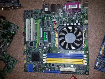

23)motherboard remove large fan and heatsink probably large socket
24)more mixed CPUs
25)Peripheral as is. Snip cover off for telco or fingerless ram
26)Peripheral as is. Snip cover off for telco or fingerless ram
27)duplicate
28)top I see a cell phone board
Sims are not on the list but you can send them in. Between 20c and 50x depending on factors. Snip the long plastic edge off for better grading
Dell is peripheral gold finger card to the right
Not sure on bottom board from photo
29)more mixed CPUs
30)rambus see above for ideas
31) mixed
32) mixed
33) mixed CPUs
34) mixed
35) mixed
35) mixed
36) mixed CPUs
If you really want to do as many boards in a photo as you can i don't mind but it makes my reply easier if you can get somewhat even rows and I can go left to right by row.
PostPosted: Tue Nov 15, 2016 3:09 pm
Posts: 9
Awesome! Thanks so much. I've made some revisions and took better organized pictures. Would you mind if I posted them and had you take a look again? I think that a lot of the items got skewed in the pictures that I previously posted. Also, in your opinion, what do you think all this stuff is worth? Approximately.. I also have 5 or 6 hdd's, and some more ram. But, mainly value on just the boards in the pictures. I'm still not understanding how I can tell the difference between mid grade, low grade, peripheral, Telcom, ect. All the boards seem about the same to me.. Also, I made yet another mistake. A lot of the stuff came from security system panels, not fire alarm panels. If that makes any difference. I've been scrapping a lot of metal lately, not doing very good at it either.. Prices are down around here. Again, I really appreciate all your help!

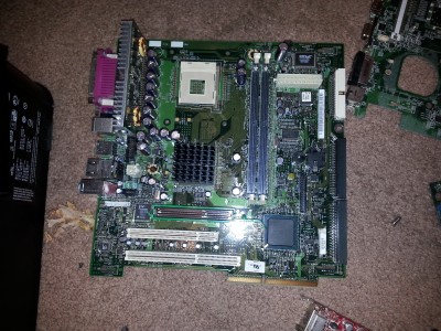

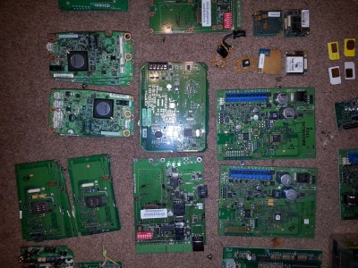

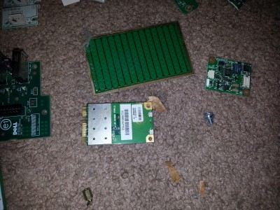

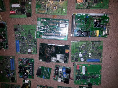

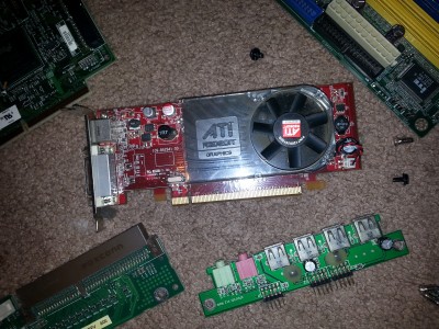

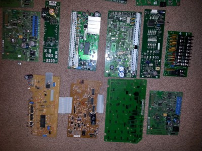

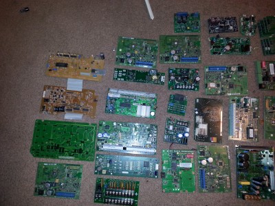

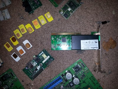

New revised pictures. I got most of the multiples out of the lineup. So, that decluttered quite a bit.

PostPosted: Tue Nov 15, 2016 8:16 pm
Posts: 10053
01) green with, green with, pinless, green with green with
02)pinless pinless pinless green with green with
03)can't tell from the top
04)finger card finger card finger card
Finger card peripheral finger card (remove fan)
05)small socket
06)large socket
Measure sockets to be sure I'm guessing
07)large socket (laptop class)
08)metal socket
09)measure socket
10)midgrade midgrade midgrade
Peripheral peripheral midgrade
11)Midgrade mid peripheral (remove heatsink)
Midgrade mid mid
Midgrade mid mid
12)peripheral telco peripheral midgrade midgrade
Cell boards telco peripheral midgrade Lowgrade
Gold connector, rest midgrade
Midgrade mid mid peripheral midgrade
Midgrade mid lowgrade telco peripheral
13)backplane midgrade wire
Backplane peripheral (fudging guess on these two)
14)lowgrade lowgrade
Midgrade midgrade
15)lowgrade midgrade
Midgrade lowgrade
16)repeat
17)repeat
18)repeat
I missed a photo somewhere sry. I'll fix it later
19)

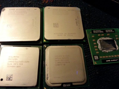

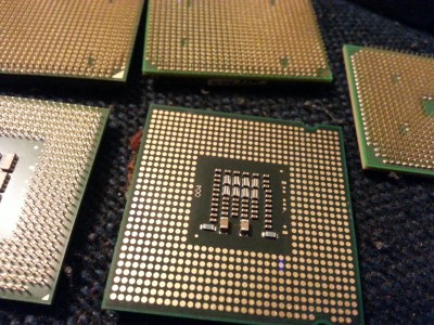

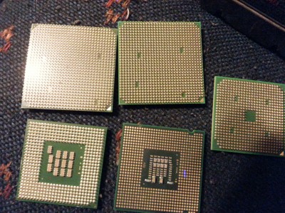

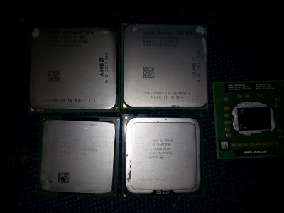

As far as the cpu's go, what class do they fall in? All but one has pins (the little spiky things).
PostPosted: Tue Nov 15, 2016 10:26 pm
Posts: 10053
Pins with metal top are green fibre with metal
Pins no top are green fibre
No pins is pinless
