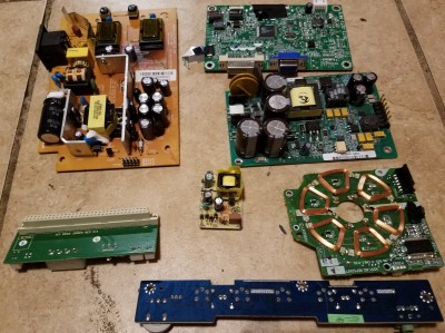

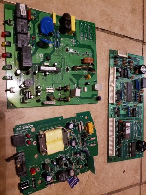

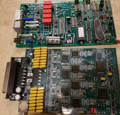

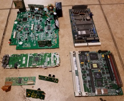

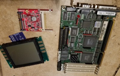

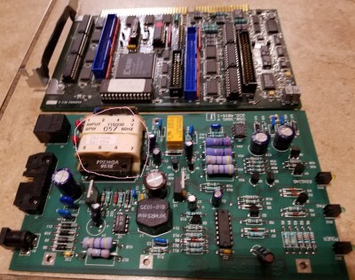

So I have an array of boards from various places that have been ripped apart over the last year. It'll cost me about 50 cents a pound to ship these in, so economically makes no sense to deal with anything here that isn't peripheral or better it seems.
For that, the board is going to need to be green on both sides at the least, yes?
Any brown board such as comes out of a power supply, CRT monitor, VCR, etc would be low grade, yes? I dump it off for a couple pennies at the local yard.
I've removed the batteries I know about in all the attached pictures, but browsing through the forums I see comments about batteries in pictures that I don't even see. If you spot one let me know.
I've attached pictures for any further questions:
large if the contacts are copper or gold, peripheral; other 3 peripheral
top don't know, flip it over, midgrade gold finger card, low grade
the two network boards are peripheral, please pop the shields and heatsink off. The lower one MAY have a battery box on it. rest are midgrade.
left top low grade
left bottom peripheral
right top peripheral
right middle up midgrade
right middle down peripheral
right bottom, depends on back, flip it
centre low grade
left
peripheral
peripheral
peripheral/midgrade
midgrade
right
telco
telco
left (switch)
peripheral
centre
peripheral
low grade (remove the copper, yes)
peripheral
right
peripheral
low grade
peripheral

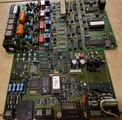

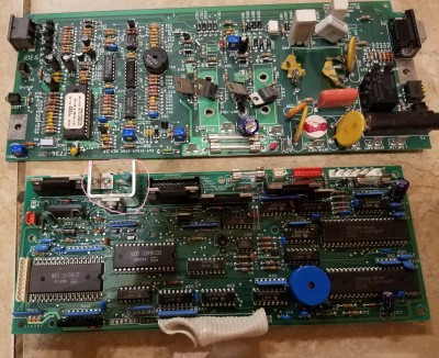

This has gotten me through most of the pile. Found a couple more questions. This stuff looks equivalent to what I'm understanding is peripheral, would you agree?
And not sure about these ITX boards. Are some of these peripheral (the ones with the CPU hard mounted) and some metal socket?

20180922_135804.jpg)
peripheral, just barely
20180922_135606.jpg)
peripheral peripheral
telco midgrade (unless lots of ICs on back
peripheral
20180922_135503.jpg)
peripheral/midgrade (unless gold pins or ICs on back)
peripheral/midgrade
peripheral/midgrade/(top to bottom gold pin connector peripheral)
