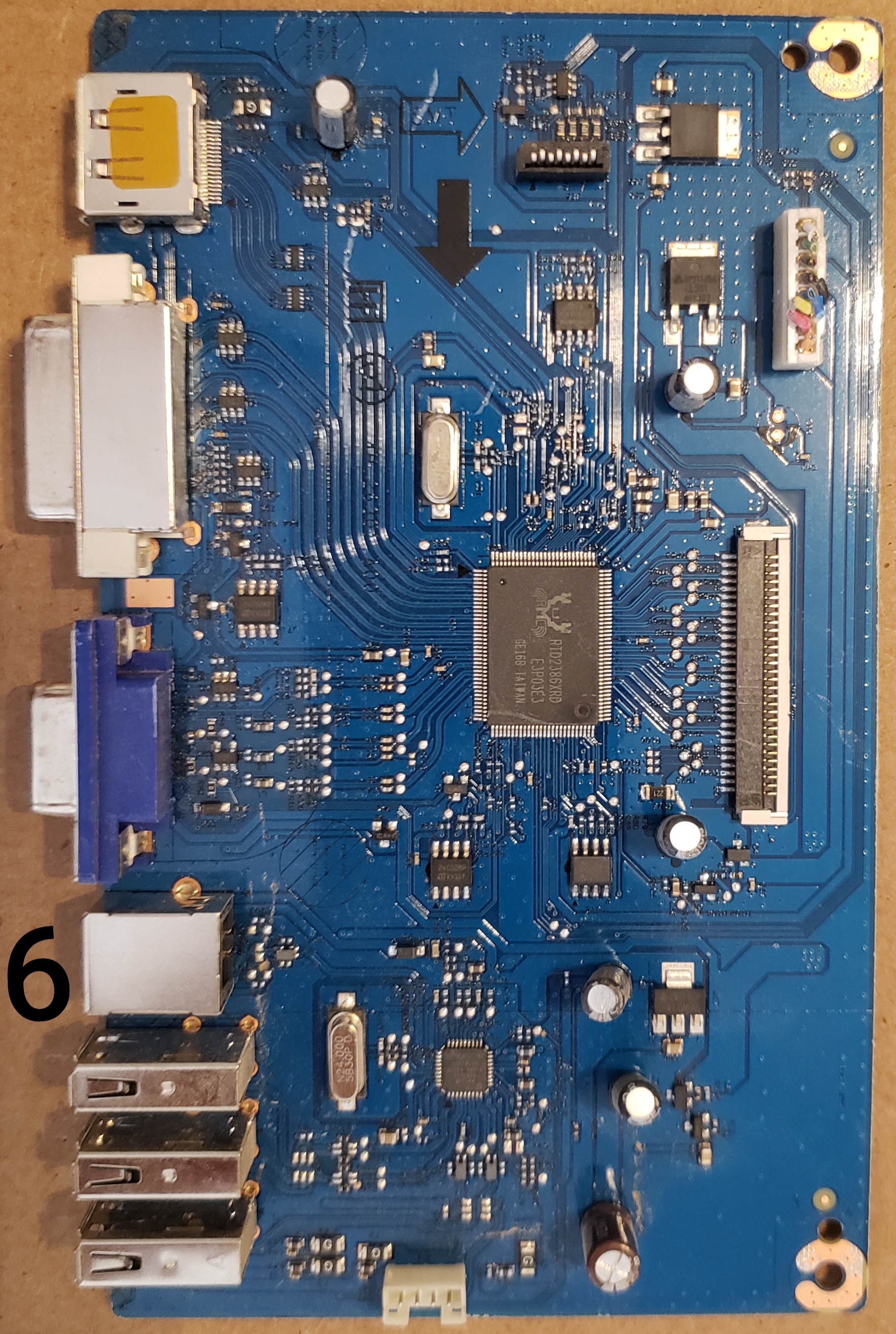

6) High Grade Peripheral

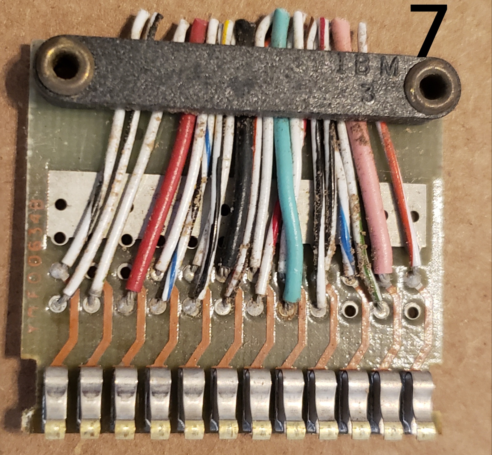

7) Low Grade

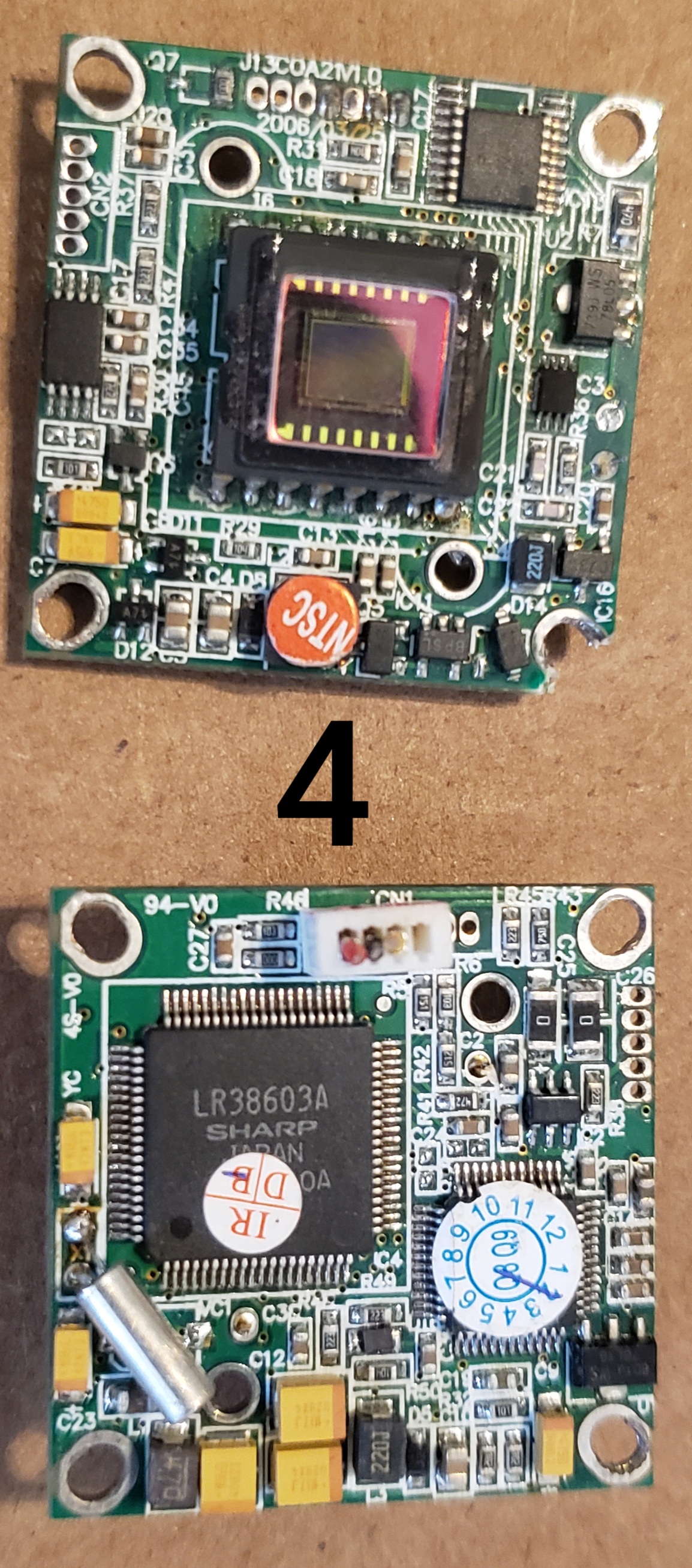

Are (4) out of mobile vision camera?

@rdw1121 #4 is from a camera. I will also trim gold fingers on #5.
