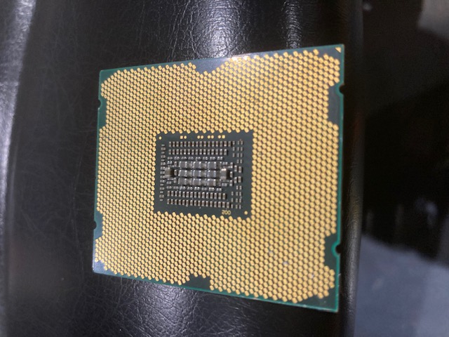

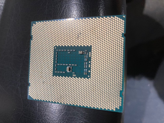

Would this be considered a P4/Green Fiber With Metal or a No Pin CPU?
Just want to be sure I understand how these would be graded.
Here is a closeup of each one.

These are always considered no pin CPU's. Unless of coarse they are i series and can be tested for sale to boardsort as working CPU's.

Fantastic tip. Thank you for your help!
