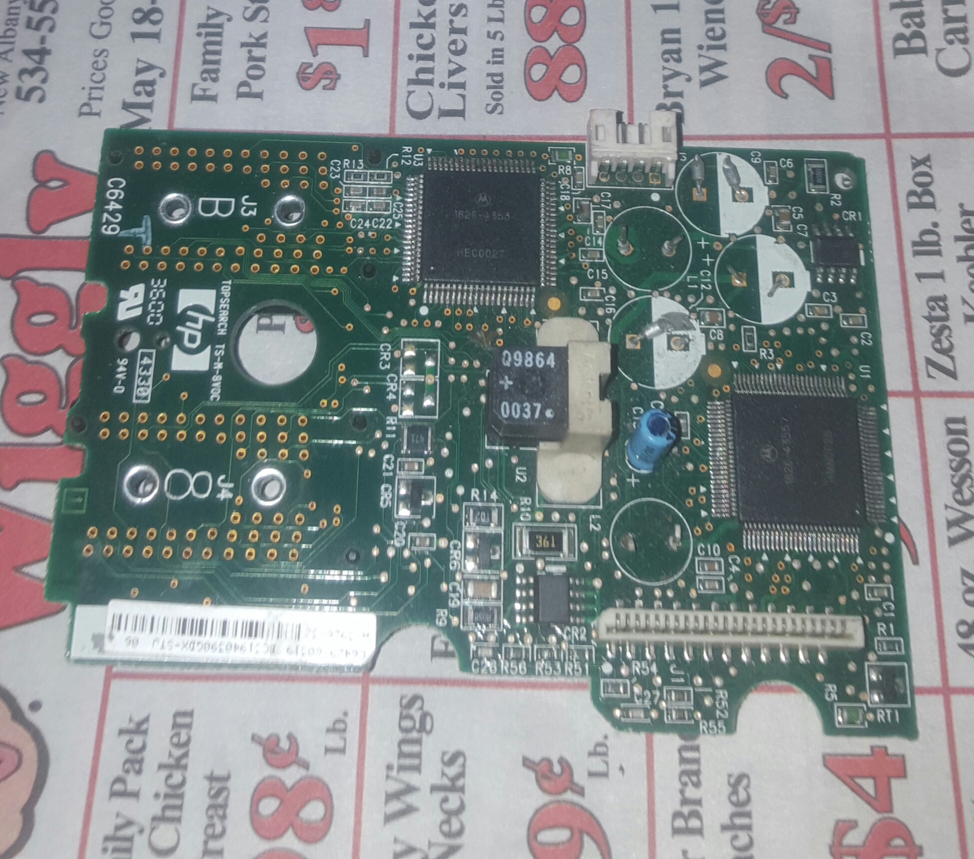

board #20 has that hard round black circle...is there something in there? you need a chisel to open that up....thanks...not bad boards...not low grade

Looked like a hole in the board. Am i wrong?

i googled it...its called a COB or chip on board...its an ic covered in black epoxy...i see them once in a while but the black epoxy is almost like cement...never able to open one

Ohkay, what your referring to is what is commonly called a bump ic. And no there's no easy way in.
The polymers bond with the chip carrier itself.
Any attempt to get in will probably crack the chip. When I clear tv remote control boards I usually heat/scrape the resin — ic and all – whole and toss The chip in peripheral.

That said, 20 still looks like a hole in the board. I could be wrong, but... ?

i think your right as usual...the color of the hole matches the fabric...good CSI by you...but i always wondered about those black bumps

That's absolutely awesome thanks, I've been under the weather, why I haven't been able to respond. I'll get on this and sort them out and try to find #20. Thanks again
